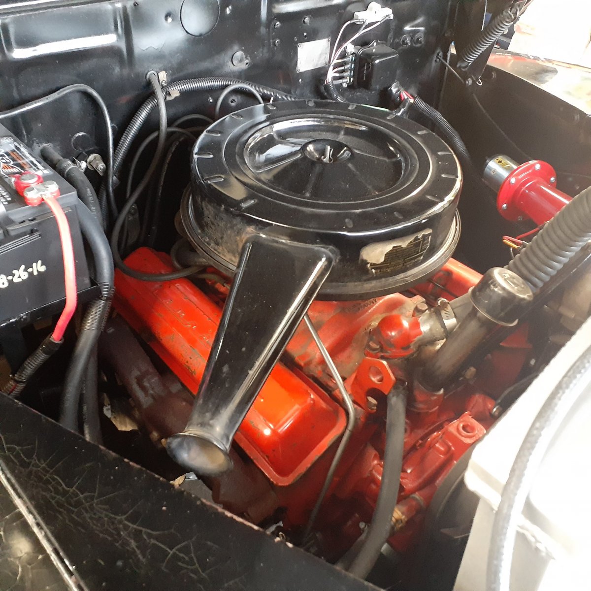

    Ok Hambers. Getting ready to put dual exhaust on my 46. Engine and exhaust are too damn quiet. Can't hear it run. Want to run it all the way back. Would like a quiet idle, but a bit of noise from the loud pedal. Any ideas ladies and gentlemen ? The engine is running two p***enger side cast iron manifolds. 20200601_181811(1) (1).jpeg

    Thanks all. Turbos sound like the winner.
