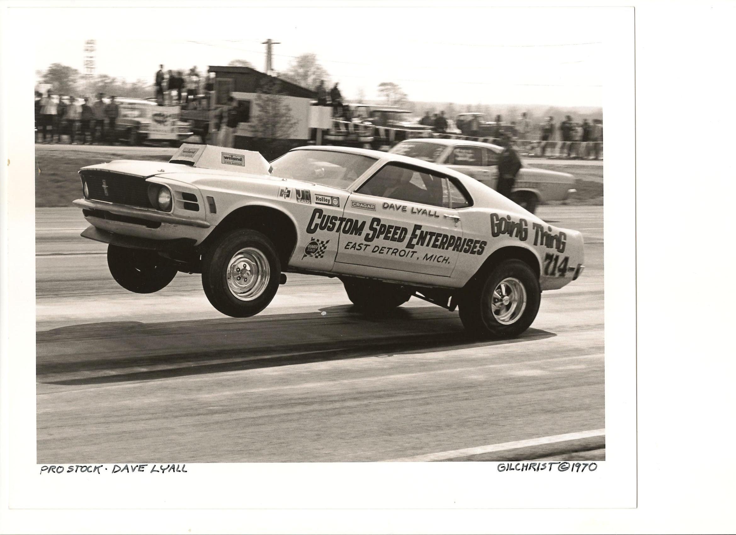

    Can anyone offer any information on these two photos found on another site? The person who posted them hasn't any information, track, the cars, etc.? I'm wondering if the Ex-Gulf one is the Expressway Gulf team that ran one of the ex-Bob Ford T-Bolts in '65.
    Joel

    I ran the 427 Tunnel Port engine in the original '69 "Going Thing" through about mid-season, setting an AHRA record 9.98 et a Bristol, Tenn. in the AHRA Springnationals, (1st attached picture) winning a big "Heads-up" (the preceding cl*** for pro Stock) Super Stock at Evansville Indiania, and the UDRA Nationals at Gary Indiana. Wayne Gapp and I were friends, neighbors, co-workers at Ford, and shared the same shop in Dearborn which would later become Gapp & Roush. I was working on the Boss 429 development program at Ford, and watched with great interest as that work progressed. Wayne, who was running a Boss 429 in his Heads-up Nascar Gas Funny Car, and who had several spare used NASCAR Boss engines in his shop, offered to provide me a Boss 429 if I would switch from the 427 Tunnel Port, which I accepted. Despite our good intentions the result was slowing the mustang down by .3 to 10.30's. The Boss 429 was mounted 3'' farther forward than the 427, it was also over 100 lbs heaver than the Aluminum Head Tunnel Port, and all on the front End. I worked the rest of the '69 season getting that .3 back, finally running a 9.90 with the Boss Engine in a match Race with Mike Fons early in 1970 (2nd attached picture). It took a full port and polish by Elkins Porting, machining the heads to full hemi, using a crower roller cam, a fabricated tunnel ram (3rd attached picture) intake by Antieau's Welding (which was used as the development model for the Weiand 429 Tunnel ram) and moving the engine back in the ch***is to located the flywheel where the 427 was mounted to get that .3 back. However, I never was able to make up for the lost 1969 season, and I was behind the curve for the rest of my big block Pro Stock career. If I had it to do over again, I would have stayed with the 427. I believe if I had done the same modifications to the 427 as I did to the Boss 429, I would have been running 9.70's by the start of the 1970 season. There were things about the Boss which were better than the 427, but it would take an aluminum block and lighter rotating ***embly to outperform the Tunnel Port, at 427 inches in a drag car.

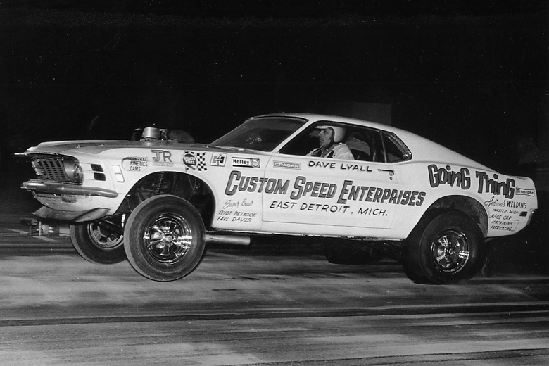

    Kevin: There were 4 "Going Thing" Mustangs, two '69s and two '70s. One of the two 70's was built up using the modified '69 body shell as a parts donor, as this '69 car, which started life as a 428 CJ, (the one I modified the spring towers on) had been originally built for the very liberal NASCAR drag race division Ultra Stock rules, and was over 200 pounds lighter than the Kar Craft Mustangs. These modifications were also allowed in AHRA, which took over the NASCAR Drag Circuit. When NHRA started Pro Stock, they followed the base AHRA body and powertrain rules, but would not allow lexan windows and many of the other NASCAR/AHRA allowed body and ch***is modifications. The 2nd '69 Going thing was a real Kar Kraft Boss mustang, and it is the only one of the group that survives today. The first two pictures in the above article are the reworked CJ car. The 3rd picture was the real Kar Kraft Boss Mustang. The surviving '69 Boss car has just undergone period-correct restoration by Dave Walters, (the 3 pictures below) and is owned by a collector who also has my '68 428 Cobra Jet, also period-correct as I raced it in 1968. I attached pictures below of the restored '69, and they show the Kar Kraft modified engine bay. In fact, I believe this car was the first Boss of the line, as shown in the 1st picture below, used in several period publications regarding the Boss 429 Mustangs. I used the Kar Kraft Mustangs in NHRA Pro Stock and the NASCAR modified CJ car in AHRA and match races.
    I started my racing career in circle track racing, and recognized the principals of suspension bias and weight jacking. When I started drag racing, I used these principals to get even real wheel traction, even before "lockers" were available, and to dampen out wheel hop. By '61 in the jack Gray/Bob Ford Galaxy, I had an air lift to bias the RR tire, and a 2nd set of shocks attached mid point in the front of the rear spring to dampen wheel hop. I had a racing buddy, Bill Sidwell who raced a '61 Pontiac independently, and he had the only Detroit-Area Pontiac who did not smoke the rear tires, and who I could not get at least a car-length out of the hole. He crawled under our '61 Ford to see how we had modified the suspension, and as he was both a friend of Jack gray and not on the factory Pontiac team, he showed me how he had modified his. He had made the upper bar of the 4-link inoperable by removing the bushings, and had made the lower bar solid to the axle, so it captured the rotating force of the rear axle housing (Newton's 3rd law of motion, for every action in one direction, there is an equal action in the other, so the axle housing rotates opposite of the axle shaft, with the same torque applied to the tire) This rotational force is transferred to the traction bar, which attempts to lift the rear of the car, which fights the "squat" of the weight transfer to the rear of the car. the result all these opposing forces is increased weight on the rear tires. I then fabricated lift bars on every Bob Ford S/S car I drove through 1963. As we were working closely with Ford engineering, who had our car at the test track and experimental garage from time to time, saw what modifications were done to our '63, and the same type of bars were used on the Thunderbolts, including the '63 pilot model which became the Tasca Car.
    So Bill Sidwell, a very clever and resourceful Pontiac Racer, is the one who is actually responsible for the Thunderbolt design. I was only the one who showed the concept to Ford. These T-Bolt bars morphed into the "ladder bar" which I used from 1964 untill my '74 Pinto, which had the Tom Smith Wolverine Ch***is 4-link.<O:p
