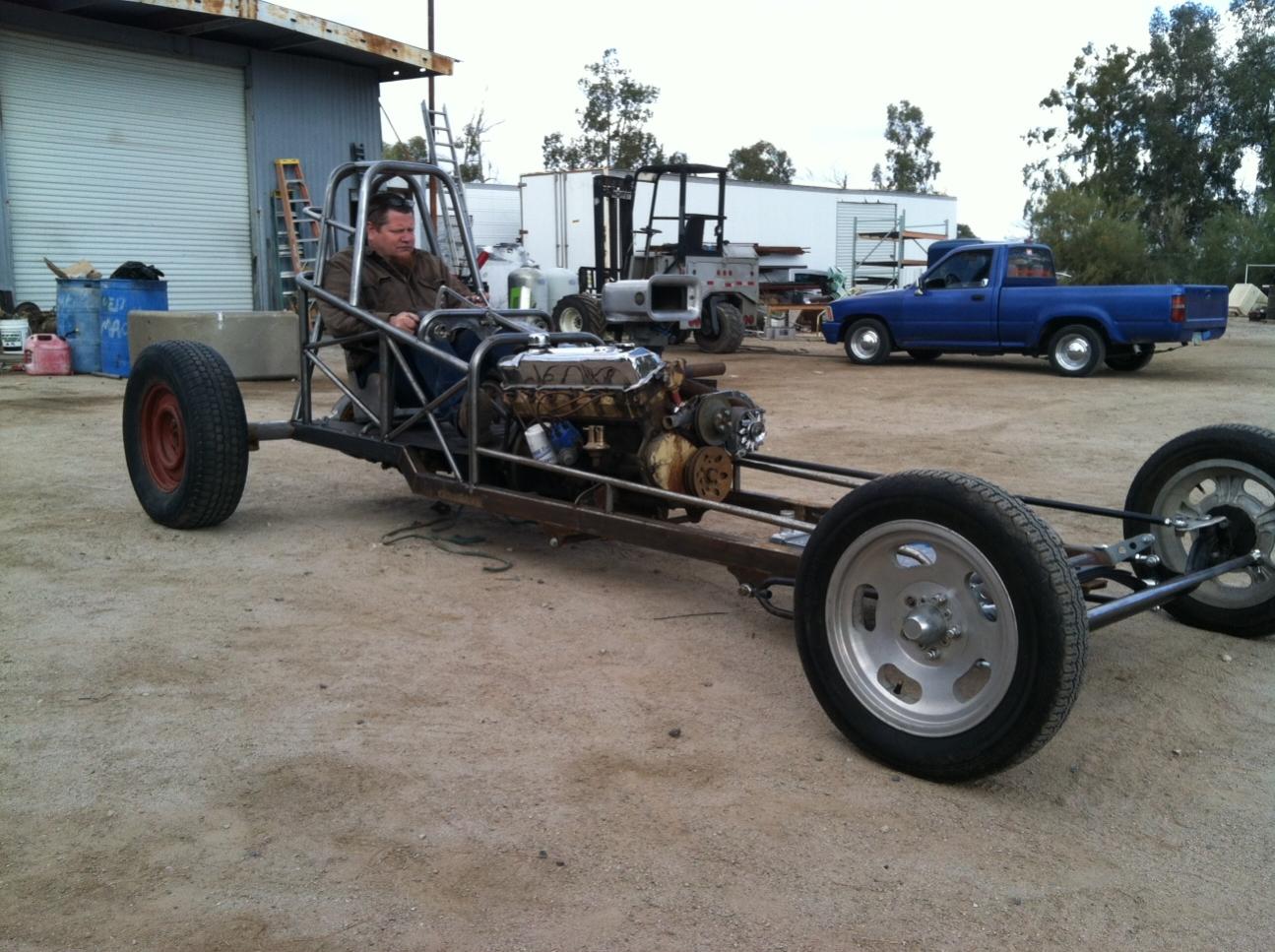

    Mike, you guys have got a lot done in the last week. Side bars look real clean. The front end with rims and tires looks right in place. I most like your floor and trans cover, lots of foot and leg room. You did a fine job on it.
    You can Google Barona Drag Strip to see were the place is at. Nice 1/8 mile strip and the race on 10/6 will be a lot of fun.
    Sure hope you can make the ANRA opener April 20-21 in Bakersfield. Keep up the good work.

    Congratulations Guys on having your first SDRA roller.:D
    Always look great the first time on wheels & out of the shop.;)
    Your going to need a bigger trailer !!!!!!!!:rolleyes::)
    Keep up the great work.
