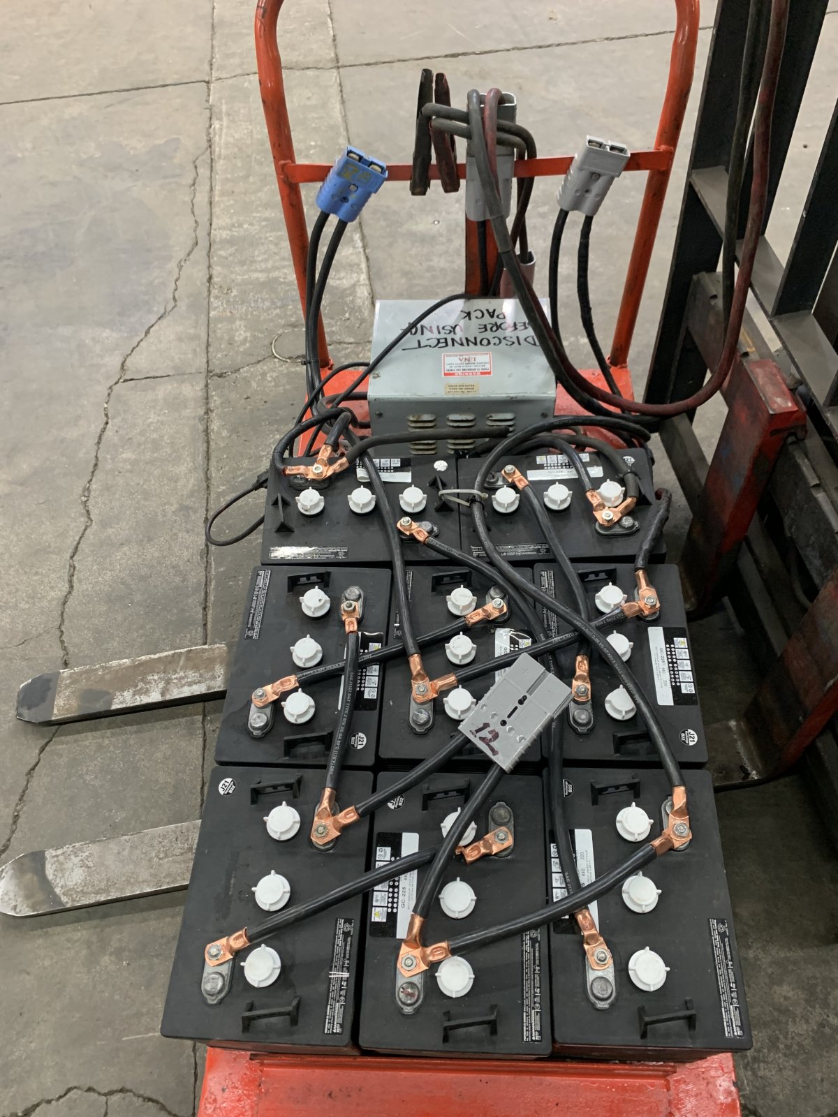

  1. about a year ago I had an apprentice make a battery slave cart 8 ,6 volt batteries wired in series ( positive , negative , positive , negative all the way down the line with differ connections down the line so you can connect 12 , 24 , 36 and 48 volt forklifts and test / drive them around when you have no battery or a bad battery , all bolted down to a push cart with fork pockets .
    anyways I tell him to wire them up positive , negative down the line ……… well he hooked them up right into a circle !!!!!! BOOM !!!!!!! The smell was incredible and just burned your sinus throat eyes etc .
    luckily ha did not get hurt, big white spot on the floor , ( probably a brown spot in his shorts) but nothing more then that and my boss was out about 1300 bucks in batteries and wire !!!!
    batteries are neglected, abused , and most often overlooked by most everyone. But caution should always be used around them .
    I can take a pic of the new cart on Monday if anyone is interested .

    How about the old cart? Yeah, let's see the new one. Did he notice all the cables glowing red hot right before the KaBoom? Woof. Batteries are nothin' to fool around with that's for sure.
    Here’s the slave cart

    thanks for posting, - and now I can see how easy it would have been for an apprentice to get that wrong…..
