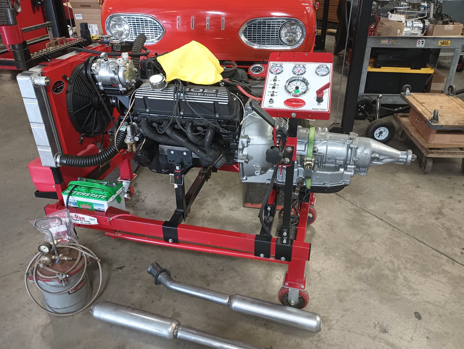

    I just finished breaking in the cam on my newly rebuilt 302. But due to more extensive rust repairs than initially anticipated it will be months until it gets installed in my Ranch Wagon. I've read several threads about prepping the engine for an extended storage. The engine is complete and the carb will be removed. The intake will be taped off along with the exhaust ports and water inlets and outlets. Question is what if anything to use to lubricate the cylinders? I'm thinking MMO but not sure. And should the engine be turned over periodically? TIA Test stand.jpg

    Instead of removing parts and storing stuff, I'd just put something over it to keep dirt/dust off it and start it every month or so. I think that works best. I've got an older engine on a run stand, and I fire it up every few months for about a minute. That way nothing in the carb dries up and the sound of a running engine is a great motivator.;)

    Thanks for all the replies. The run stand isn't mine so the engine is just sitting on a cart.

    You can still run the engine on a cart.
