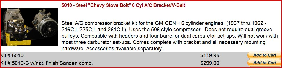

    Here's the bracket I was looking at

    Here's how it would look but I think this is a 235, with 1/2" belts?
    I realize I could change my waterpump and crank pulleys but not sure how that works on the 216?? That's why I was hoping to keep the motor pulleys stock??
    Sweet looking 6 huh?!

    Just spoke to the guy that makes this bracket and says I should(but check for myself) be able to run a 17 series belt in those old 5/8 belt pulleys.
    His set up uses one belt that runs everything!
    Just looking at those pulleys, they look really wide like the 17 series belt will bottom out and slip.....but.....well I guess I'll go out and fit a belt and see.
    Anyone run a 17 belt in these with success?

    If you switch to a '54 235 water pump and balancer, then you can run the smaller belt. You don't want to run the small belt on the large pulley from what I've seen.
    I also have A/C, PS & Alt brackets designed for the '37-54 and '55-62 engines, but I don't have them in stock yet.
