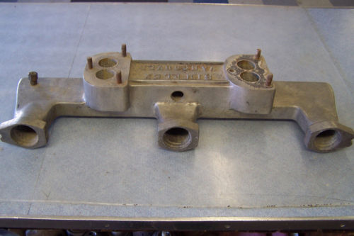

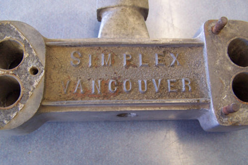

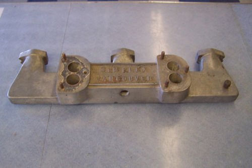

    anyone know anything about a Simplex?

    Ok, I am going to ask one more time.....Has there ever been a dyno comparison for all the dual carb intakes to see which one is the better performer?

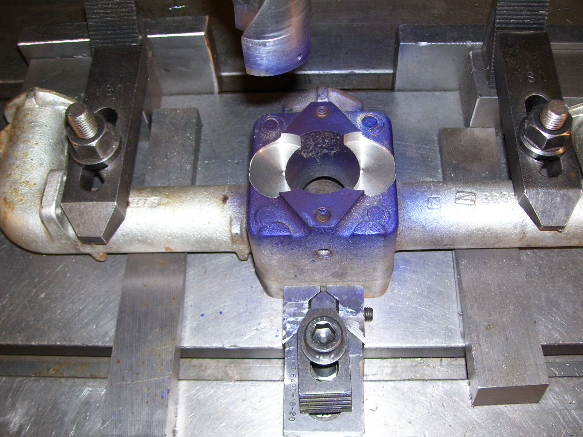

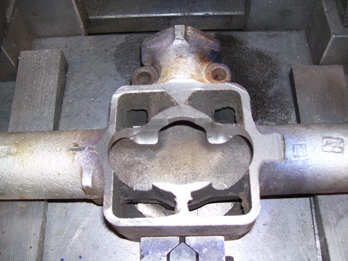

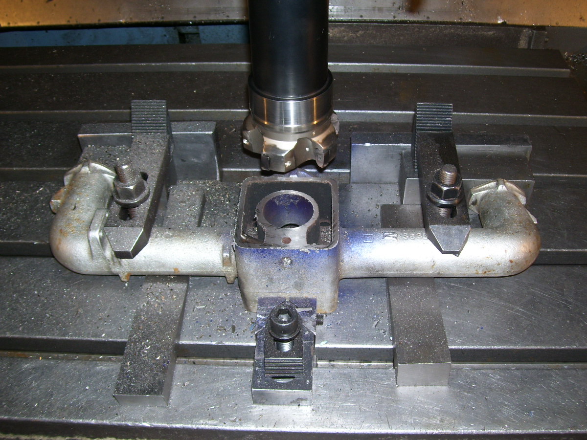

    I converted a toyota landcruiser intake to fit the 216/235. It was about a 1/4" or so longer on each end. Cut out a slice and re-welded it together. ground the welds down and no one knows the difference. the owner put a weber on it and ran it his '32 chevy coupe.
