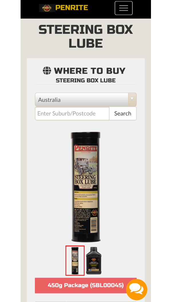

  24. Torana68
    Joined: Jan 28, 2008
    Posts: 1,445
    Torana68
    from Australia
    Just use a grease that’s designed for steering bix’s, seems like the thing to do
