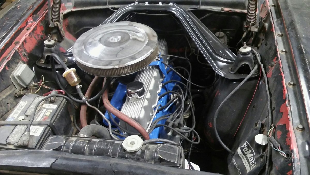

    200 almost ready to start - Jun 2017.jpg Thanks for opening this old thread, it's exactly what I want to know..
    I have my 60 Ranchero with a 200 inline six. I recently rebuilt the motor and put on the stainless header with split outlet that you can buy on ebay. Now I need to finish the exhaust system and have been looking for ideas or what others have done. I don't want too much noise. I had a glass pack on my old system with the stock manifold. It was too much on long trips, I'd have to crank up the radio and it would be hard to hear if I was using my phone when driving.

    For an otherwise stock 6 cylinder borrow a trick from Dodge's Super Six. This was a factory optional slant six, it came with a 2 barrel carb borrowed off the 318, a stock exhaust manifold and a stock appearing single exhaust, but 1/2" larger than the 1 barrel version.
    So, have the muffler shop make up a new exhaust 1/2" over size with the muffler of your choice.

    Flowmaster hushpower is by far the best sounding muffler for a six. Forget all the split manifold crap, it doesn't help performance. Run a single exhaust system the same diameter as the manifold outlet. Or run a header. Used mandrel bent pipe. Run it all the way to the back and exit it past the body.
    I have had a couple of sixes this way and it is loud when you want it but won't melt your brain from drone on long trips.

    My last system did exit past the rear bumper through a single glasspack. I liked it for the most part but was a bit too much on the highway. People told me they could hear me coming quite a ways away.
    As I understand Flowmaster mufflers, the higher the series number, the less noisy they are. Maybe 50 series is what I'm looking for.
