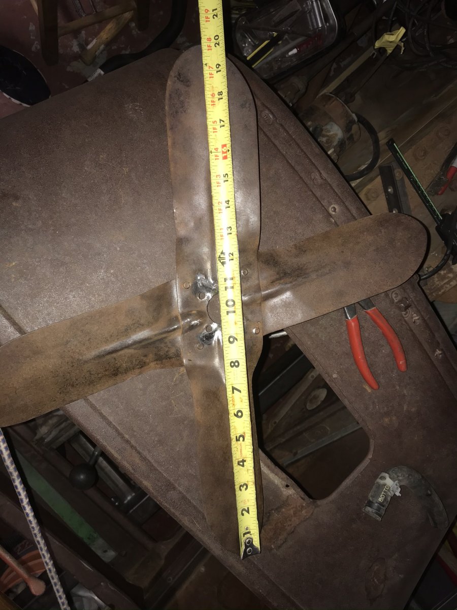

    Murphy's Law once again holds true. Just when I thought I could make some progress life slapped me back down.

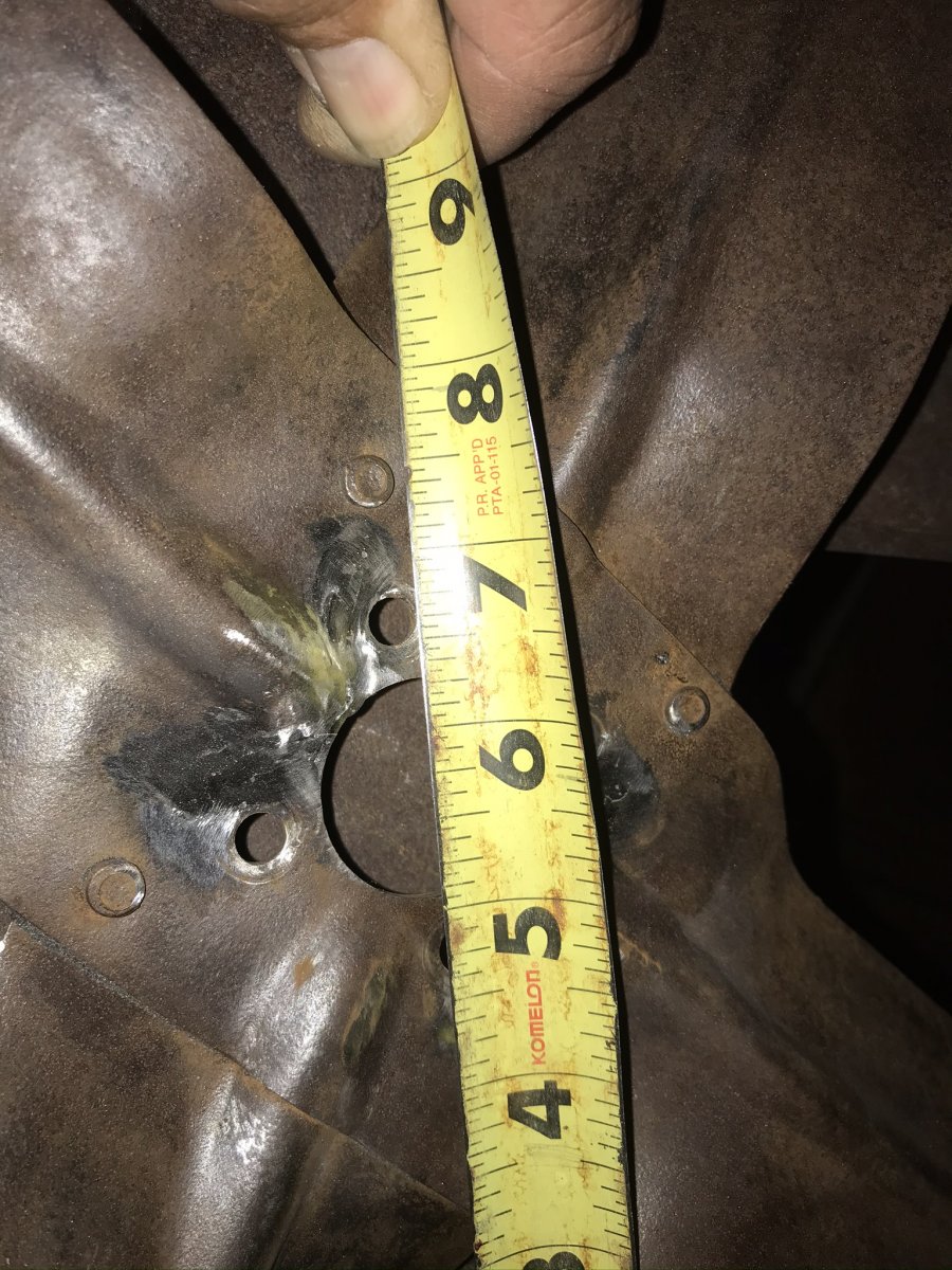

    I still haven't managed to fire my engine up. While rigging up a temp radiator I noticed several stress cracks on my fan blades. So, I decided to pull the fan and make some repairs. Naturally I snapped off all 4 fan bolts. No biggie, plenty of bolt sticking out of the water pump flange, I figured I'd be able to weld a 1/4" nut on the stubs and then back them right out......LOL. Nope. Broke them all off again. Long story short I ended up having to drill each one of them out.
    I managed to drill all 4 without damaging the threads.
    Today I finally had some time to tackle the fan repairs. There were 4 stress cracks near the hub where the 2 fan blades are riveted together. I drilled a small hole at the end of the cracks, beveled the edges of the cracks and welded them up. A bit of grinding and smoothing and its good to go.
    No pics of progress as it was rather mundane stuff. No promises on when I might get things rigged up to start the engine, hopefully soon.

    Speaking from experience don't use the repaired fan, buy a new one. It's not worth risking the damage when a blade comes off. Been there done that, cost me a radiator. Also had a friend with a '59 Bel Air 409 car lose one, it cut the wire loom on the way out through the hood. Not pretty and expensive to repair.

    send me a photo of the fan blade next to a ruler and ill look thru my heap for one that isn't cracked

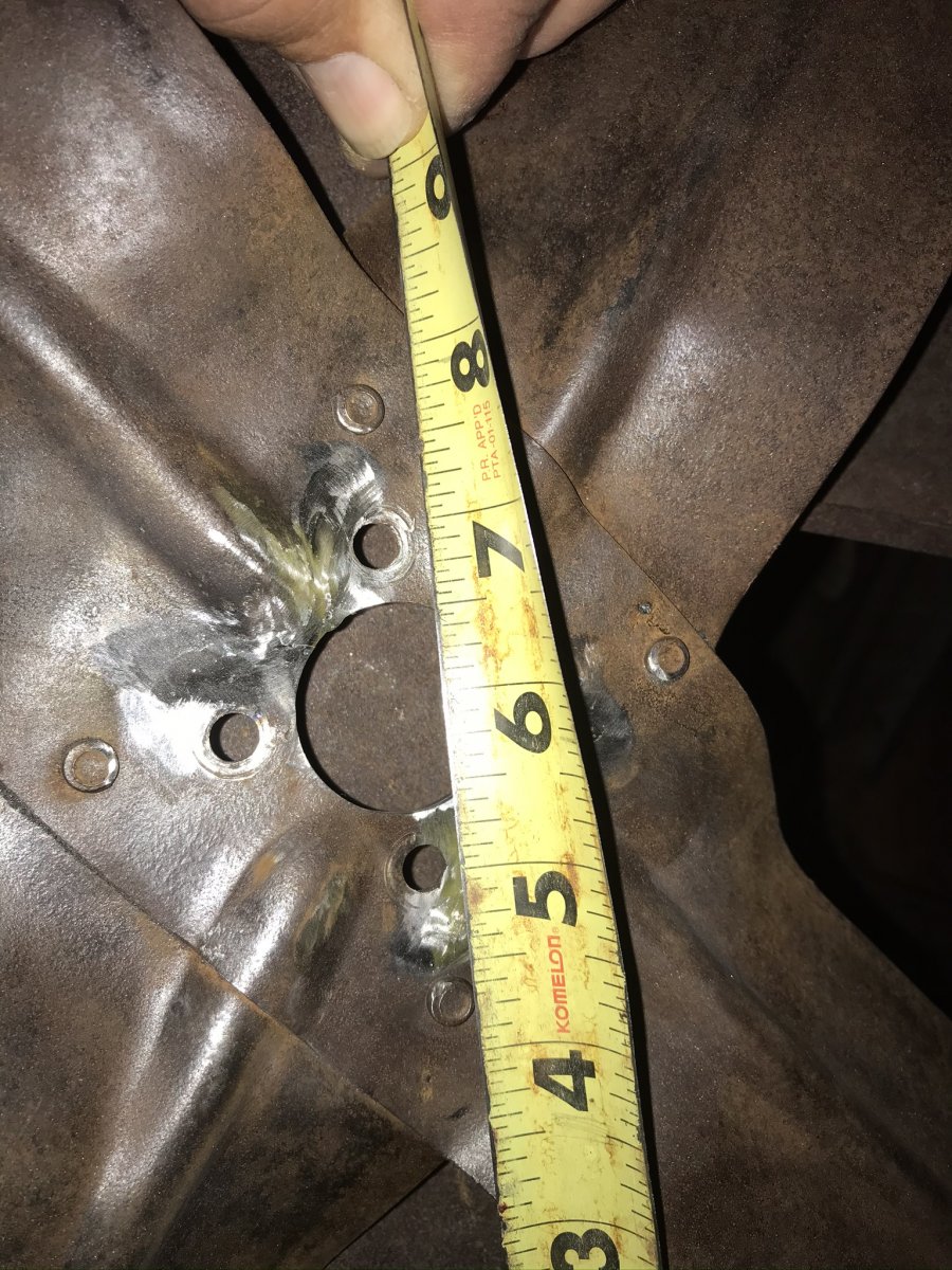

  9. bobbytnm
    Joined: Dec 16, 2008
    Posts: 1,829
    bobbytnm
    Larry,
    Here are a few pics of the fan. It's approximately 20" across, the center hole is approx. 1 1/4" diameter and the bolt spacing is approx 1 7/8"

  10. brading
    Joined: Sep 9, 2019
    Posts: 850
    brading
    If I had to use the cracked/repaired fan then I would make up and weld on a support ring something like the picture on the back side of the fan.
    loudbang, LAROKE and bobbytnm like this.

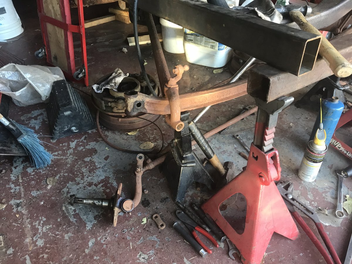

  16. bobbytnm
    Posts: 1,829
    bobbytnm

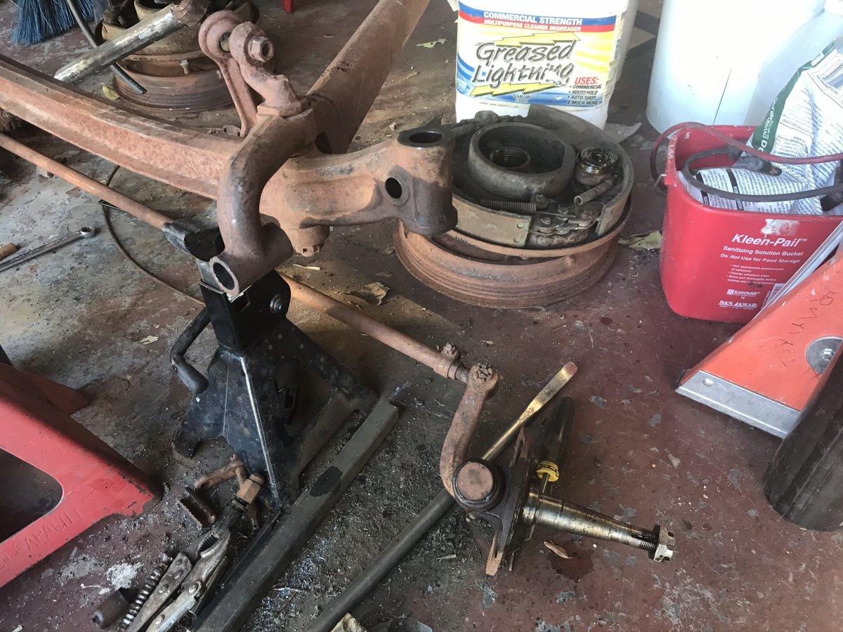

    A new phase has begun...

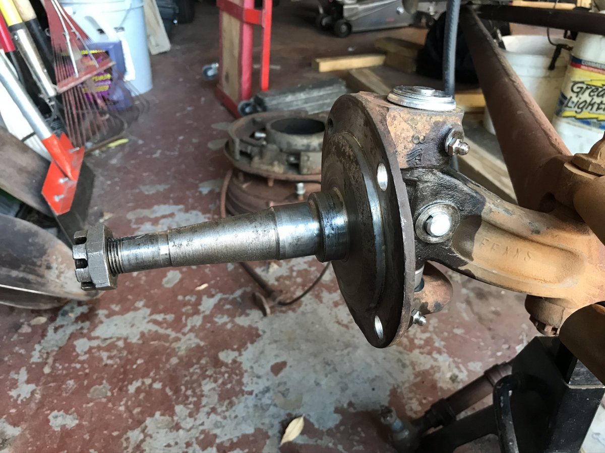

    I decided to jump into the front suspension. My front spring is in horrible shape; broken leaves, badly replaced leaves, etc. I dug around in the yard and I had another front spring and 40 Ford axle laying around. The spring looks pretty good overall and only has the top spring busted. It should be easy enough to freshen up.
    I started banging out the old worn out bushings. Surprisingly they didn't put up too big of a fight. Then I attacked the wishbone. One side came out easy enough, the other side was a different story. I finally got it.
    While I got the front end apart I figured I'd better replace the king pins so I pulled the hubs and backing plates. I was able to drive the king pins out without too much cussing and sweating. I was just sure I was going to have to pull the axle and go borrow a press, but no, I was able to bang them out.
    The only thing I couldn't get loose is the steering tie rod. So now I have the spindles off the car still connected to the tie rod...LOL. I have parts on order; a king pin and bushing kit, tie rod ends, various brake hoses and fittings, etc. I'm sure I'll need tons of brake hardware. I guess I should dig out my hydraulic backing plates and start making a list.

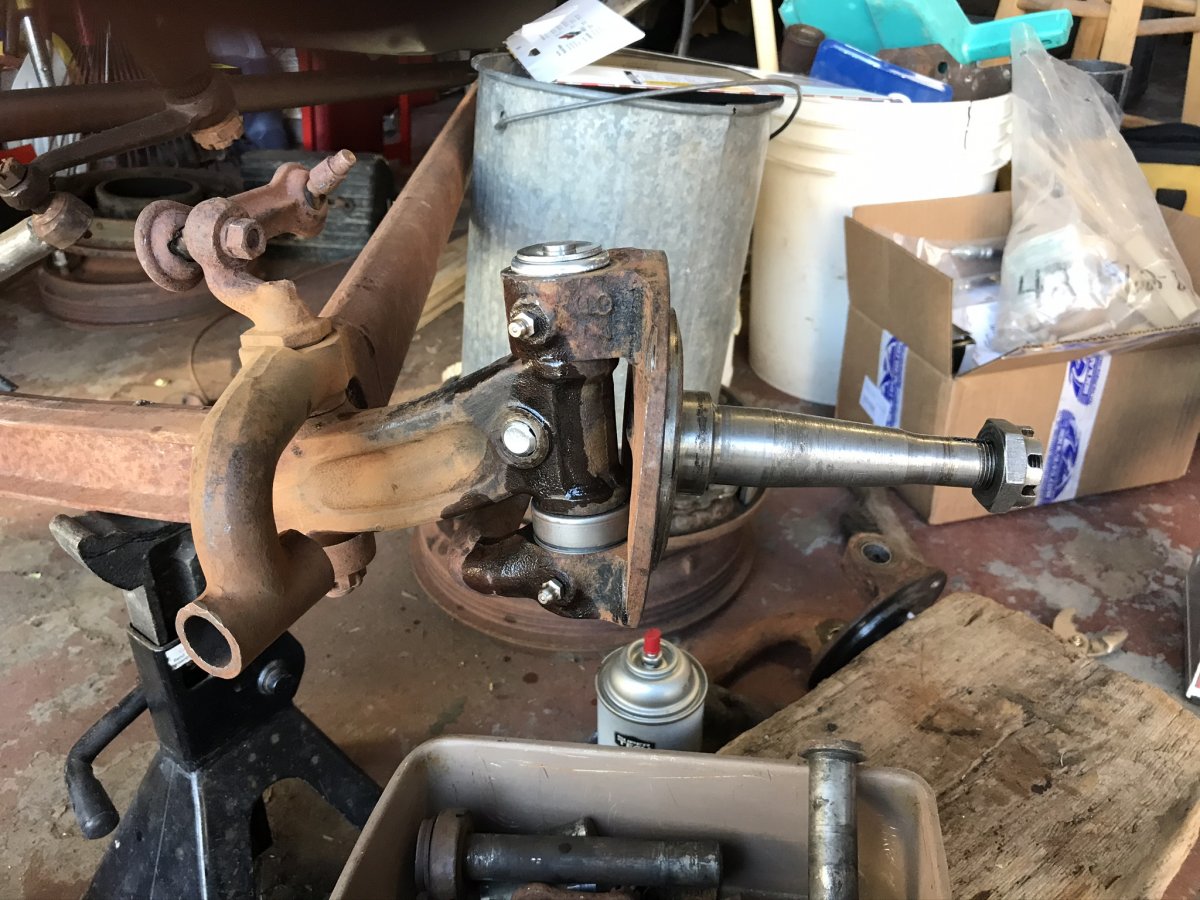

    I got the new king pin bushing installed. Then it took me a little while a a few phone calls to located a bushing reamer, but I finally found one and got the bushings reamed out to fit the king pins. I managed to get the spindles back on the axle this afternoon. I'm hoping to get the tie rod ends on the steering link this weekend and dig around in the shed and try to find all of my hydraulic brake parts so I can get them cleaned up and ***essed and see what parts I need to order.
    Slowly but surely I'm making forward progress...

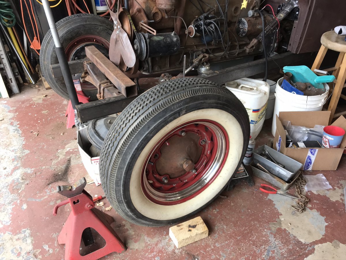

  20. bobbytnm
    Posts: 1,829
    bobbytnm
    Out with the old, in with the new(er)...
    I got the front end back together. I installed some new spring shackles in my new(er) spring and got it back on the wishbones. I found my hydraulic brake parts and got the new(er) backing plates installed on the spindles. I'm using my older drums so I can retain the wide 5 bolt pattern
    I still need to hit everything with a wire brush and slap on a coat of paint (and grease everything), but... ...its all good, and everything works together.
    I even hit the wheel cylinders with compressed air and everything works.

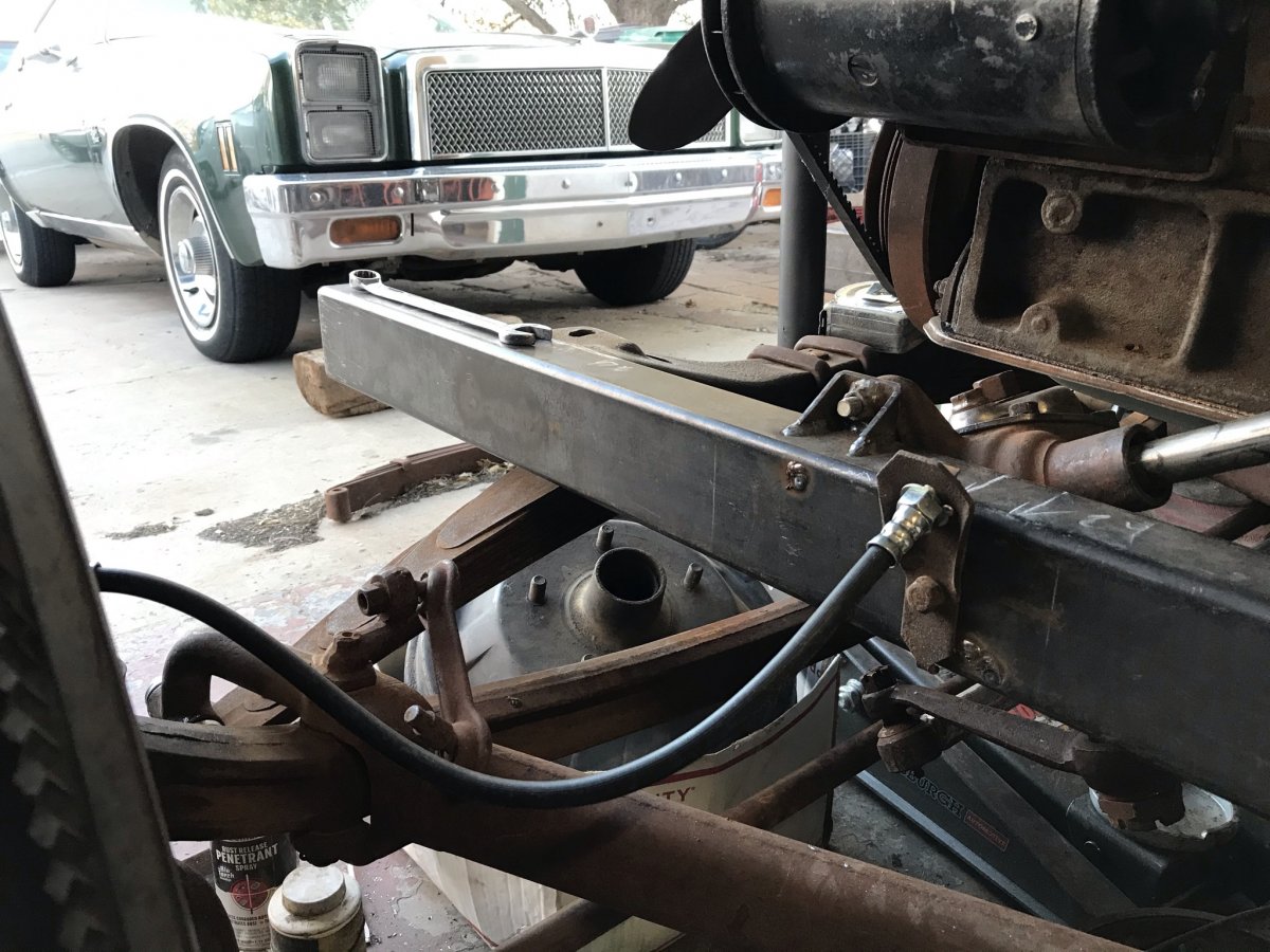

    I dug through the s**** bucket and found the brake line brackets from the 40 Ford frame. I drilled and tapped a couple of holes and... ...voila... ...rubber lines mounted.
    I need to do some head scratching and hand wringing and figure out where to run the hard lines. Consistent with my nature I might have done a few things different if I had thought about brake lines way back in the beginning. Now I'll just have to figure out a clean way to route them that will work with what I have.

    I managed to get the front brakes plumbed up. I bent and ran that hard lines from the master cylinder to both front brakes.
    I have the original brake lines from the rear wishbones. I'll have to shorten them up a bit but that shouldn't be an issue. Hopefully within a couple of weeks I can have the entire brake system plumbed up and ready for to add fluid.

  27. brading
    Joined: Sep 9, 2019
    Posts: 850
    brading
    Out of curiosity what did you do about the cracked fan.
    bobbytnm and loudbang like this.
  28. bobbytnm
    Posts: 1,829
    bobbytnm
    I went ahead and repaired it. I drilled small holes at the ends of each crack and then beveled the edges of the crack with a Dremel tool before welding it up and grounding it smooth. For now I think its OK.
    But, just in case I did locate another fan. My buddy had a spare fan from his 1956 Packard 352ci that is identical and he donated it to the cause.

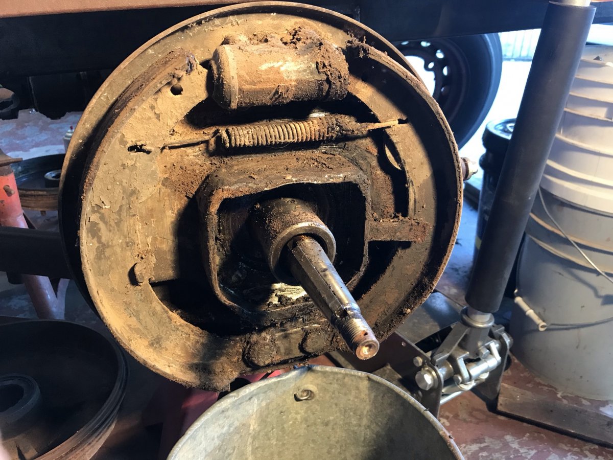

  29. bobbytnm
    Posts: 1,829
    bobbytnm

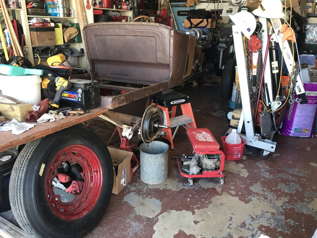

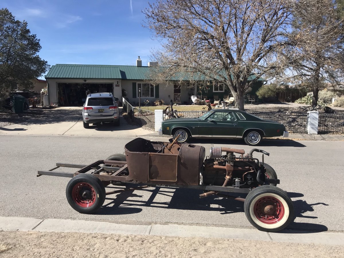

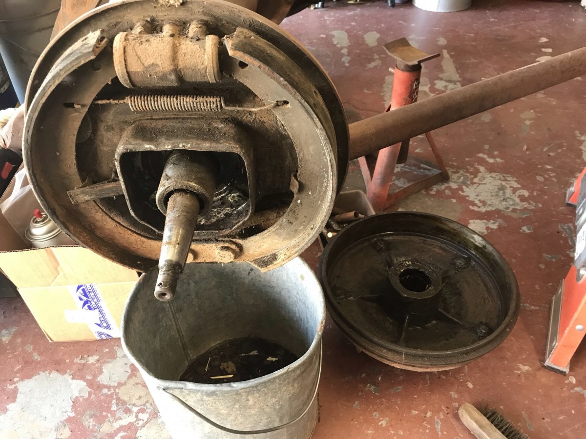

    So, I rolled the roadster out into the sunlight today. I needed to get it turned around in the garage so I can tackle the rear brakes. After I rolled it down the driveway I drilled into the concrete and set some 1/2" drop in anchors so I can attach an anchor plate to attach a winch to. My driveway has a decent incline so its nice to be able to winch things back up into the garage.
    I got the car nosed into the garage and tool the rear hub off to see what I'm up against. I've never had a banjo diff apart. Do they have an outer axle seal?

  30. bobbytnm
    Posts: 1,829
    bobbytnm

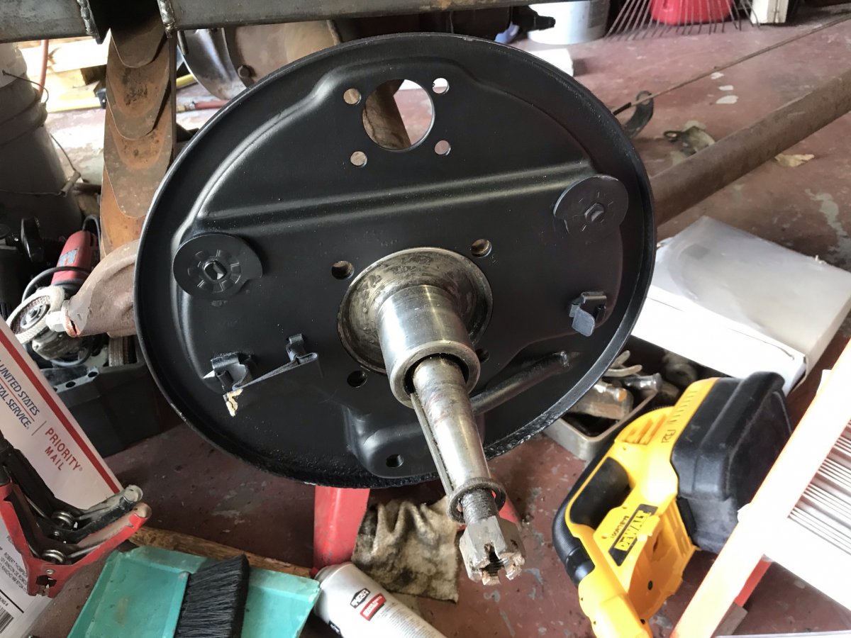

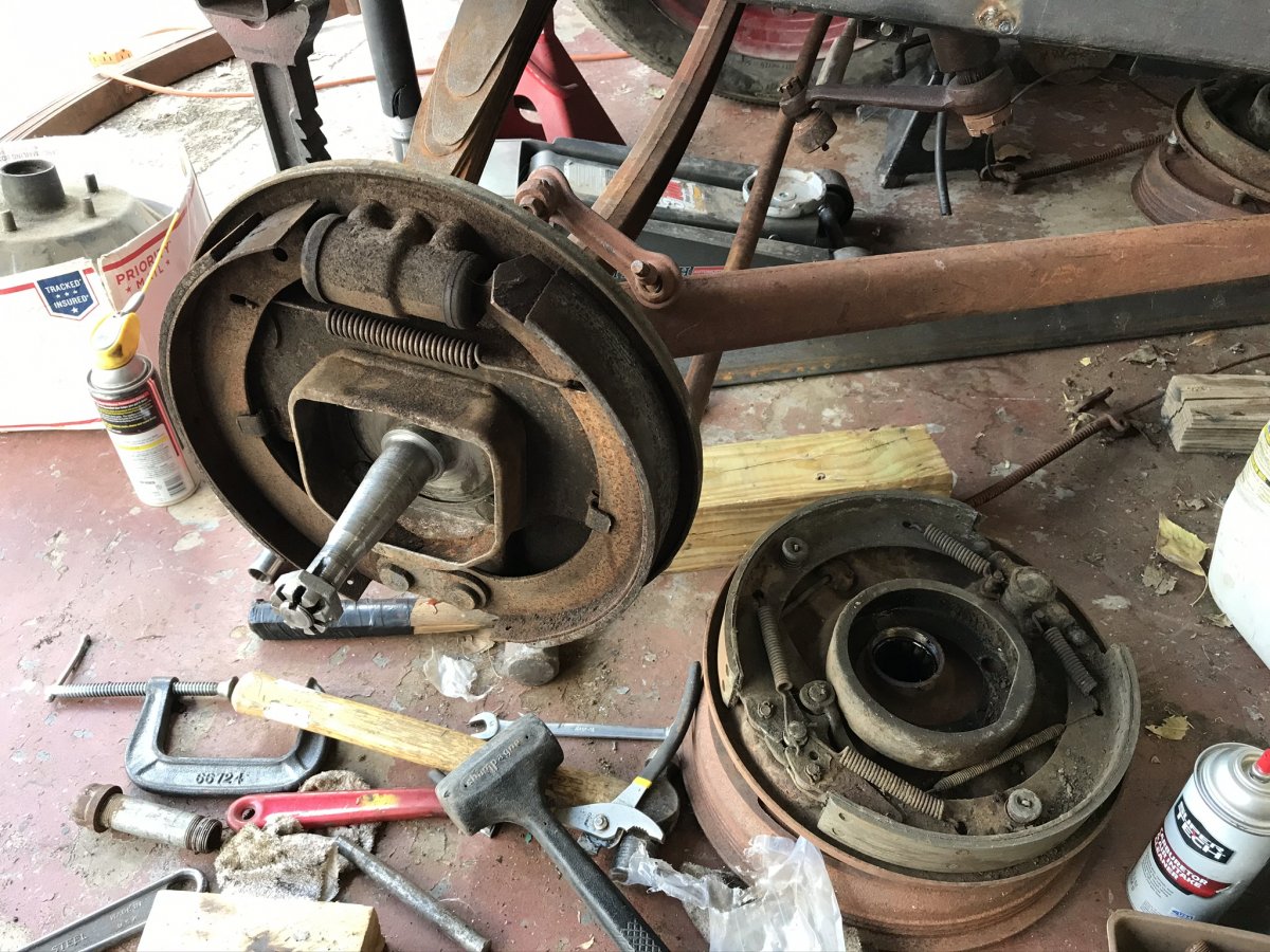

    Still poking along in fits and spurts.....

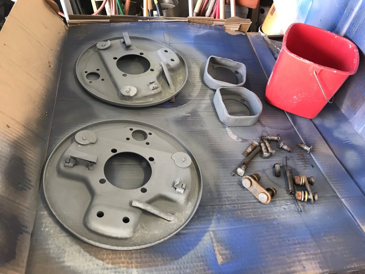

    I had to order some brake shoes, hub seals, and some replacement lower brake shoe anchor bolts.
    Helpful tip: If you need to replace the brake shoe anchor bolts for your 39-40something Ford it's cheaper to buy the anchor bolts for a 1943-1950something Jeep. All the Ford suppliers want to sell you the bolt only (no nut or lock washer) for anywhere from $10-$25 each. For an early Jeep you can get the bolt for around $8 (including nut and lock washer). I ended up buying 2 complete sets with connecting links on Ebay for $15.
    Right now I'm still waiting on my seals to arrive. I've cleaned up the backing plates, etc. and gave them a quick coating of paint. Everything is just about ready to go back together once I get the seals.
