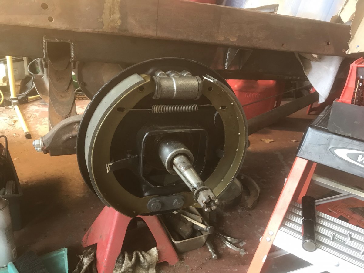

    I did get the brake ***emblies put back together and back on the axle. It was after I got things back together I realized that I didn't even consider the emergency brake. I don't have any of the hardware or cables for the E-brake.....oops.
    For now, It's going back together and I'll deal with that sometime in the future.

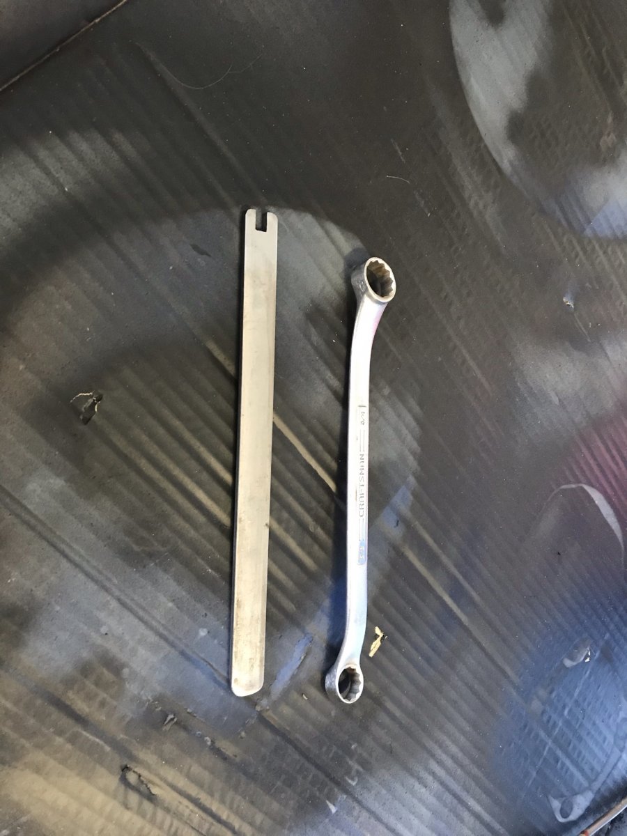

    For the record, the early Jeep/Willys brake shoe anchor bolts were indeed identical to Ford parts.

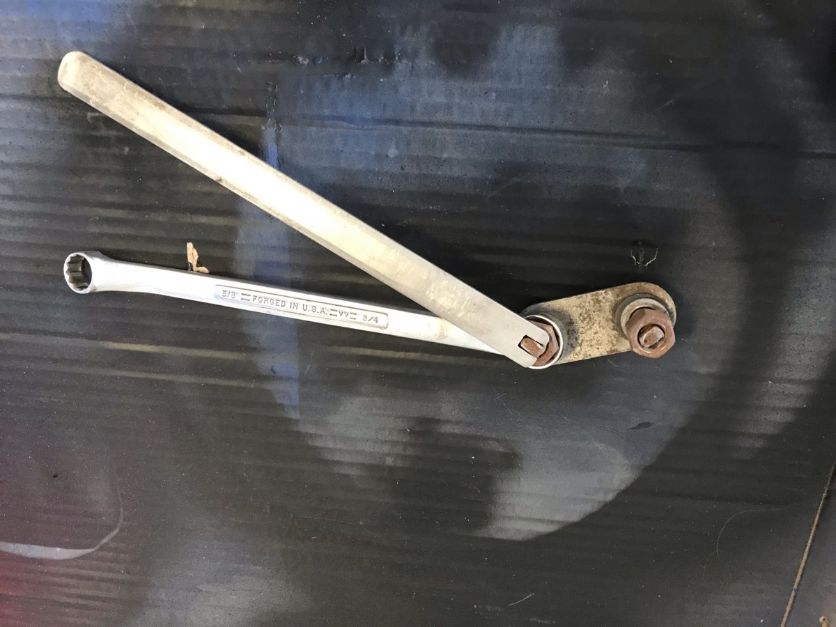

    I took a few minutes to fab an anchor bolt adjusting tool to help get this dialed in once I get drums back installed.
    I was going to turn the drums but... ...I'm not sure how to mount them on the brake lathe. I haven't had a chance to run by my buddy's place and eyeball his lathe but from what I remember the main shaft is at least 1". The Ford hubs taper down to approx 3/4" diam. How in the heck did they mount these drums on the lathes back in the old days?

    I put my rear drums on the axles and turn them together.

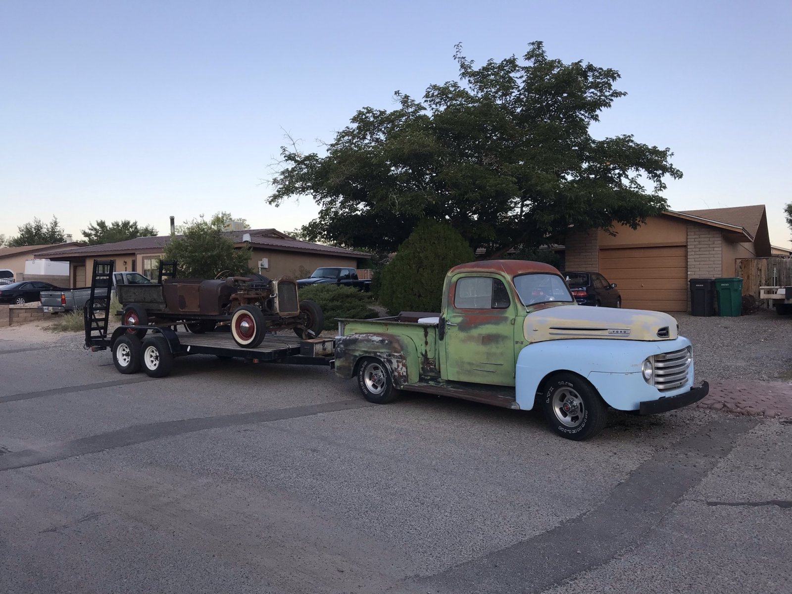

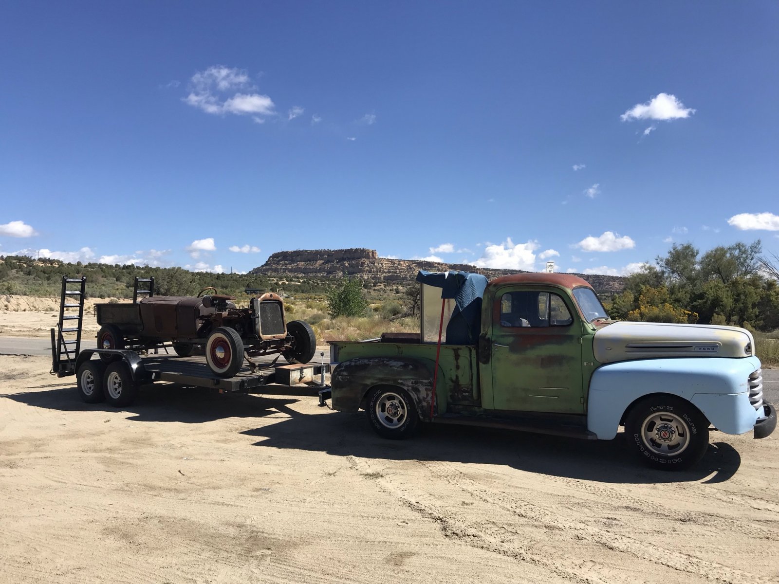

    I haven't made much progress, but I was heading out to the 4 Corners area of NM to the San Juan Chapter of the ATHS show in Aztec, NM this past weekend and decided to take the roadster. I at least got to blow the dust off of it out on the open road. While at the show I fired the engine up and ran it for a bit.

    hey, at least you put some miles on it! Is that a beer fridge in the back of your truck? Always go prepared..............:D

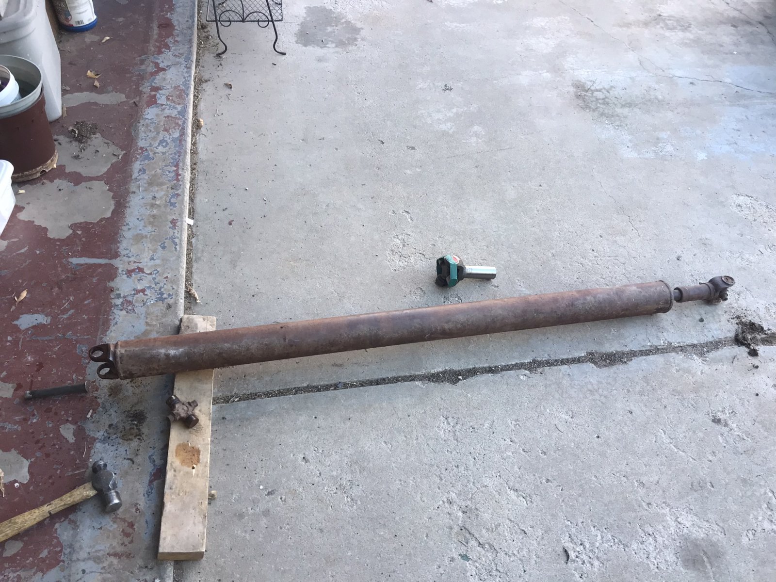

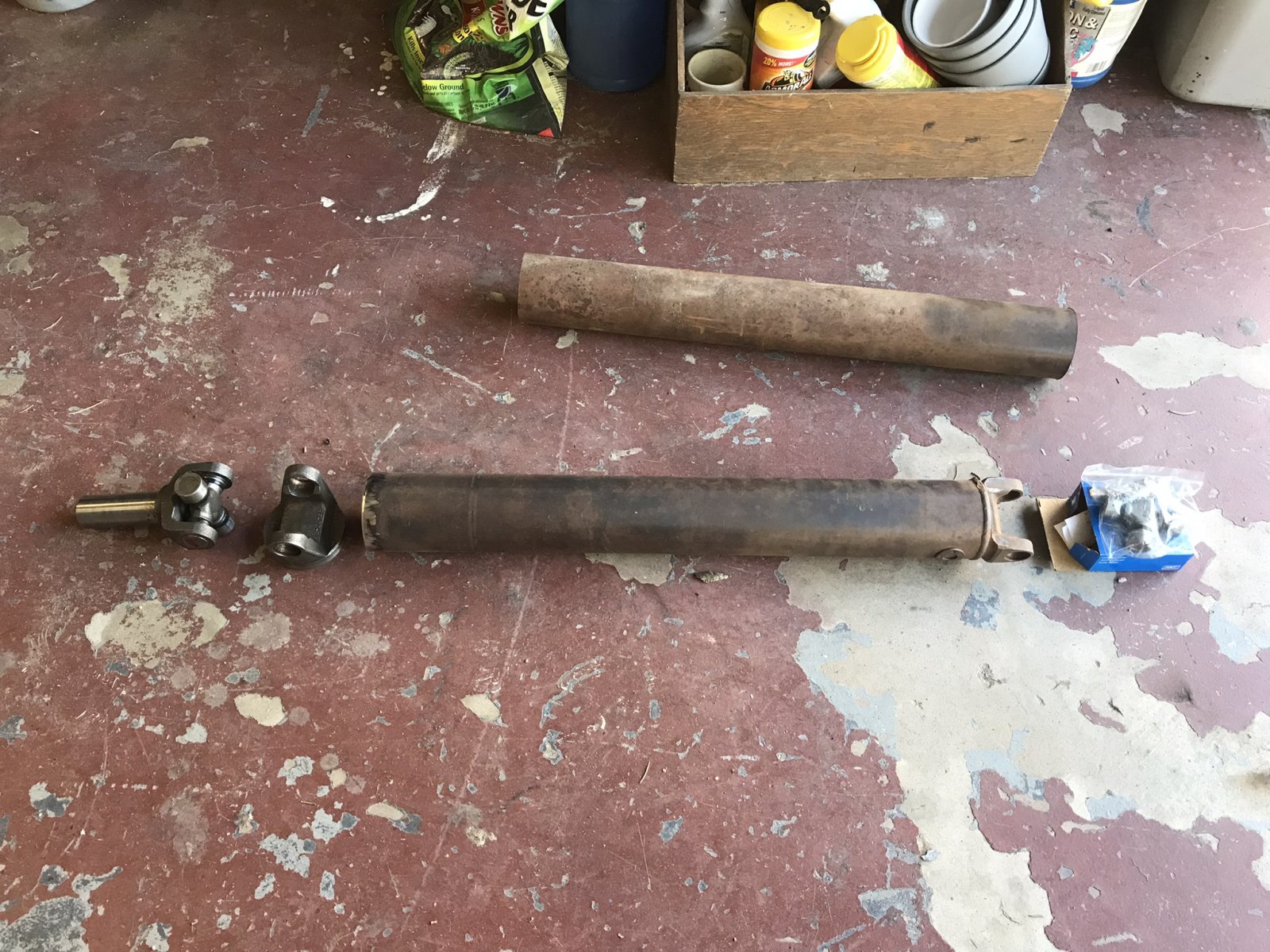

    Finally, a little something to report....

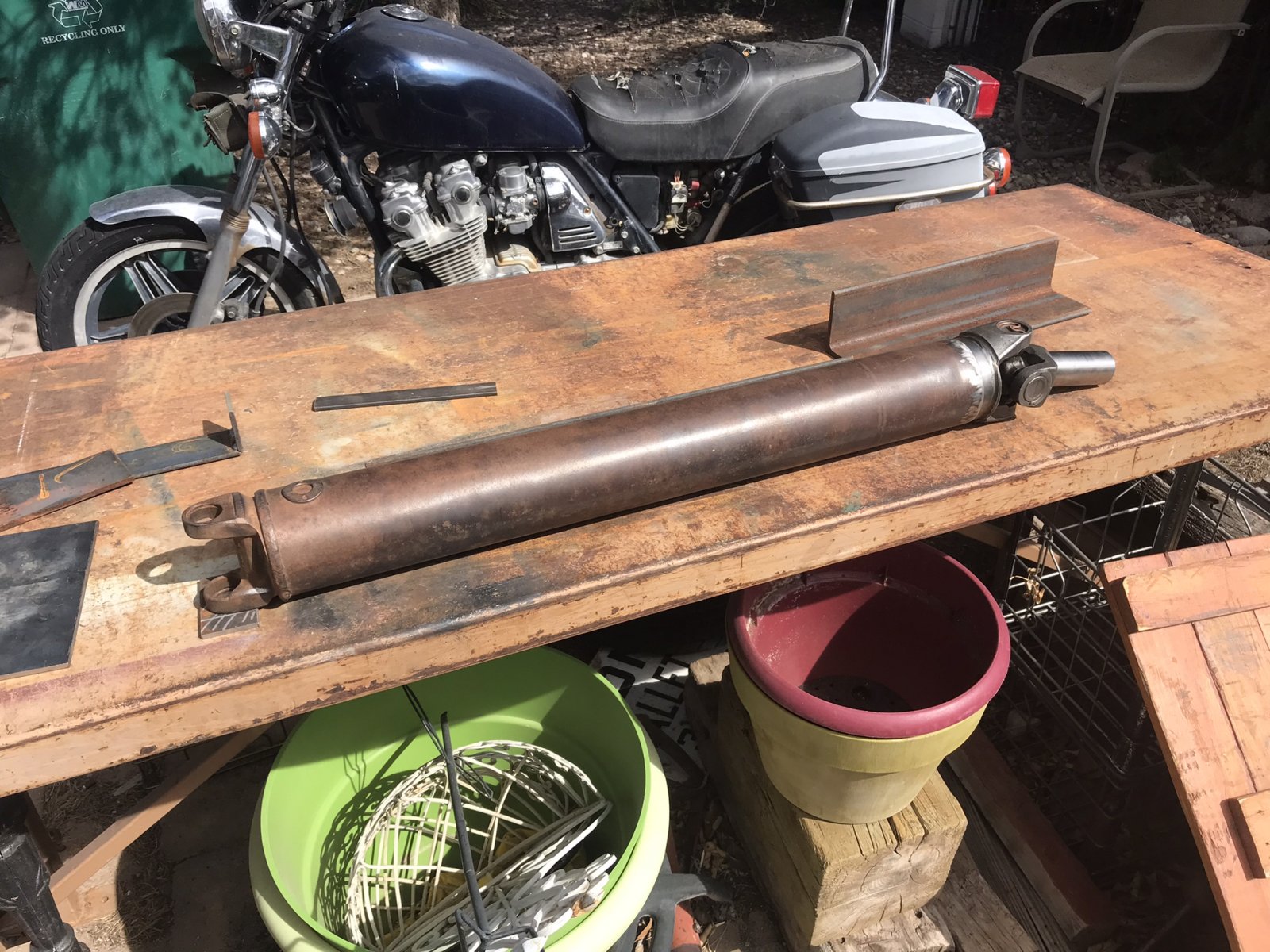

    After receiving a ridiculous quote on fabbing up a drive shaft (~ $300) I decided I'd try my hand at putting one together. I dug around my parts piles and found a decent candidate that had a matching rear yoke to my differential. Even though I have to shorten this quite a bit I went ahead and used a cut of wheel and carefully removed the front yoke. I took my ****** slip yoke and the tubing dimensions over to the drive shaft shop so I could get a front weld in yoke. The drive shaft guy had a good used front yoke that he let me have for $10...woohooo. I picked up a new rear "U" joint for another $15.

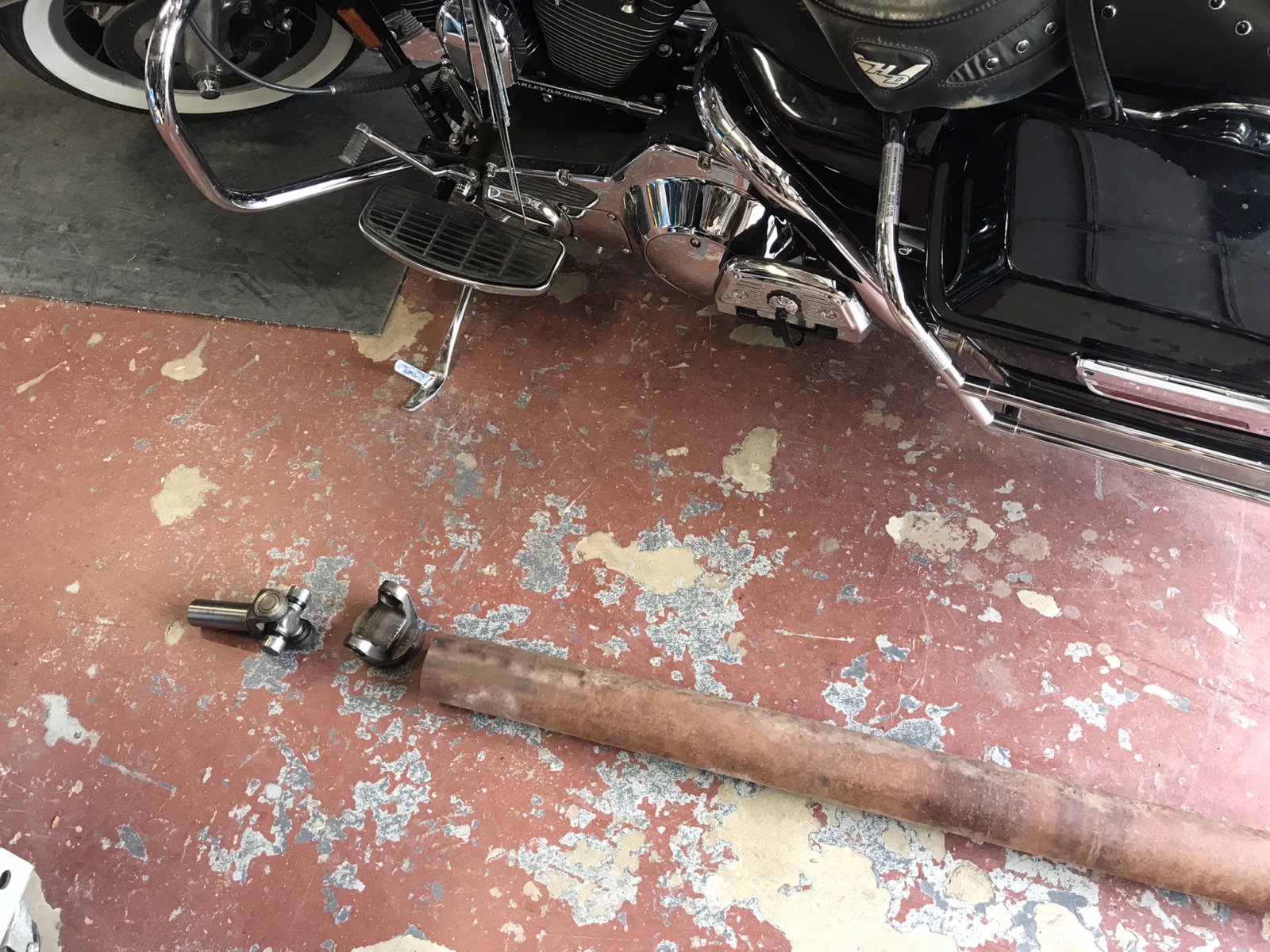

    I then make dozens of careful measurements, re-measurements, etc and cut my drive shaft tube to size. I think my game plan will be to fully ***emble the driveshaft; "U" joints in the yokes, weld in yoke pressed into the tubing, etc. Then I'll mount it into my roadster so I can use a dial indicator to get it straight. Once straight as I can get it I'll tack weld it in several spots. After that, I can remove it from the car and weld the tar out of it.
    Worst case scenario is that I'll have to bite the bullet and have one made. I might also have to have this balanced once its welded up but I'll wait on that until I'm driving the thing to see if it actually needs it. Best case scenario is that it works as it should without any vibration.

    Looking good Bobby! I built the DS for my COE, not that difficult. Just make sure your u joints are perfectly in phase...

    I have shortened driveshaft and rewelded without any need for balancing. Just make sure it all lines up as accurate as possible. I left a little gap between the tube and the yoke so the weld could penetrate down in. I left the factory balance weights, as i only shortened it about 4 inches, but it seems to be fine.

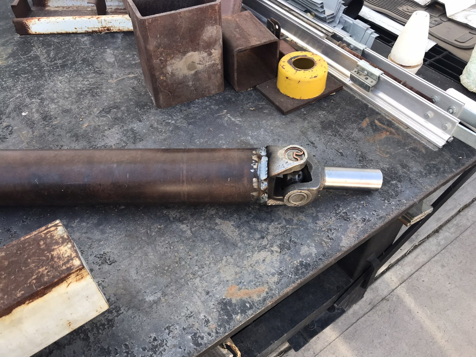

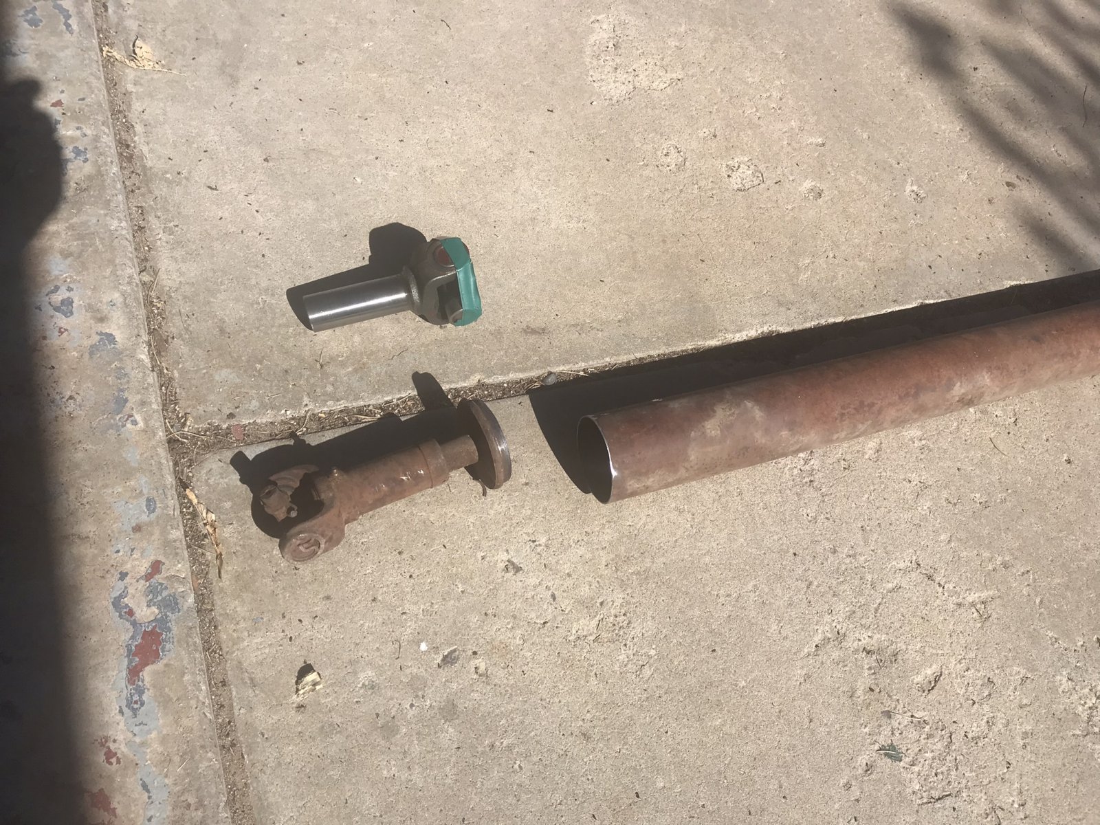

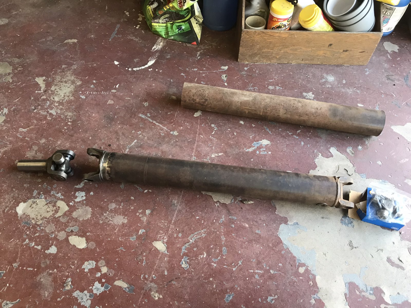

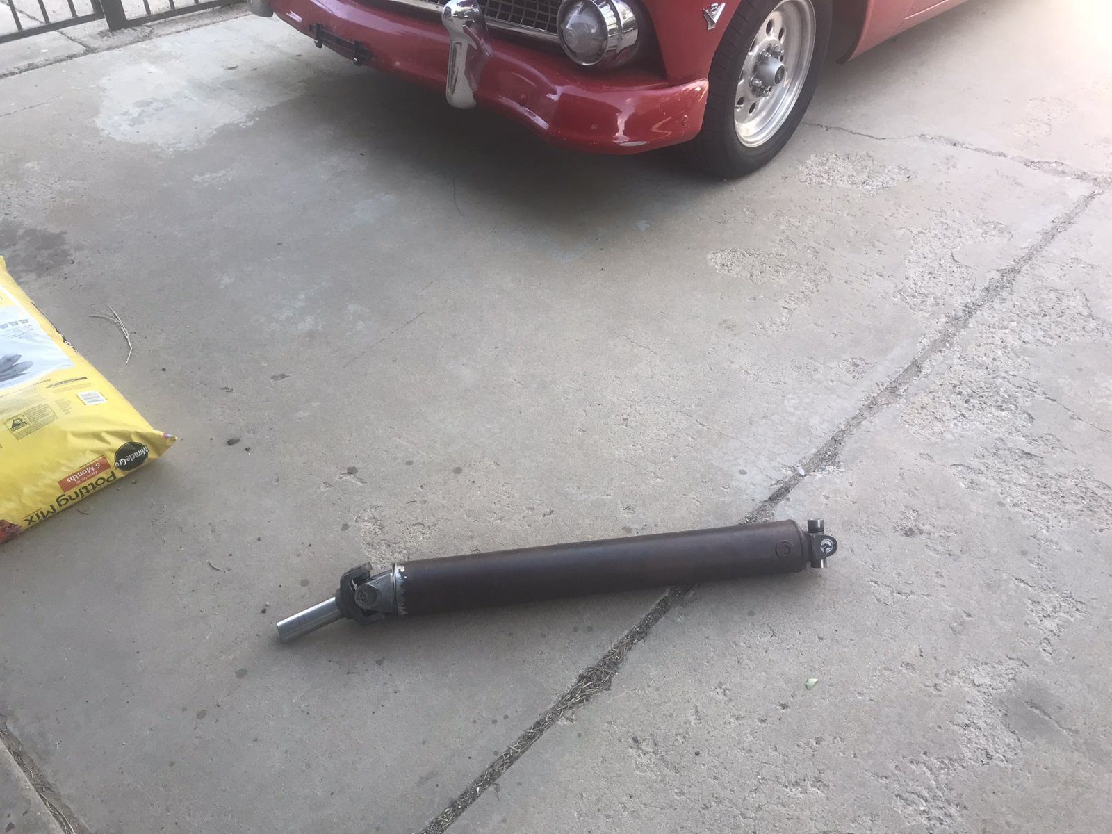

    I know its been awhile. My progress is slow as other parts of my life keep my crazy busy. I have managed to squeeze is a bit of roadster time here and there.
    So, I dug around my piles of parts and came up with an old driveshaft with a rear yoke that matched my open driveline conversion. I carefully cut through the weld on the front weld in yoke and removed it. This way I could get a good measurement on the tubing thickness. Next I measured, and measured, and measured. Then I measured a few more times and then measured, and measured, and measured, made some calculations, measured again, and then cut the driveshaft down to size. I was able to pick up a front weld in yoke from a local drive shaft shop. The guy didn't have a new one in stock but had a used one that he let me have for $10....woohoo.
    I installed the front "U" joint and my slip yoke into the new weld in yoke. Installed a new "U" joint into the rear yoke. I then lined everything up and banged the new yoke into the driveshaft tube. After that I mounted it in the ch***is and rigged up a dial indicator so I could see how much run out I had.
    After a frustrating couple of hours and not being able to get the run-out less than 20 thousandths I took a break. After a frosty beverage I realized that as I was leaning over and against the transmission I was inducing movement into the dial indicator. I then stood back where I could see the dial indicator and rolled the tire with long stick. Much better and it didn't take me long to get the run-out down to about .005...I think I'm good so I tacked it in a few places. Hopefully next weekend I can get it welded out. I won't worry about balancing until after this thing is up and running. Who knows, it might not need it (yeah right...LOL)

    If it were me I'd tack it in place and get the driveshaft mob to weld and balance. Save you chasing a vibration later on.

    I had a few minutes so I welded up the driveshaft. I won't have a chance to try and get it installed until next weekend.

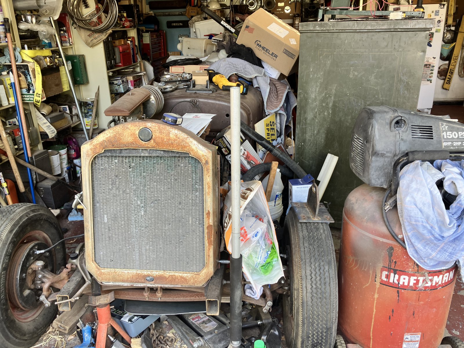

    This is a bit embarr***ing, but here is what I'm up against right now: IMG_7262.JPG ;

    Yup, life happens. At least you still WANT to work on it!
