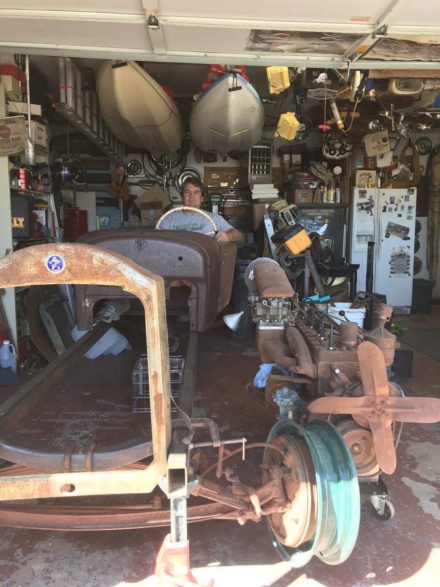

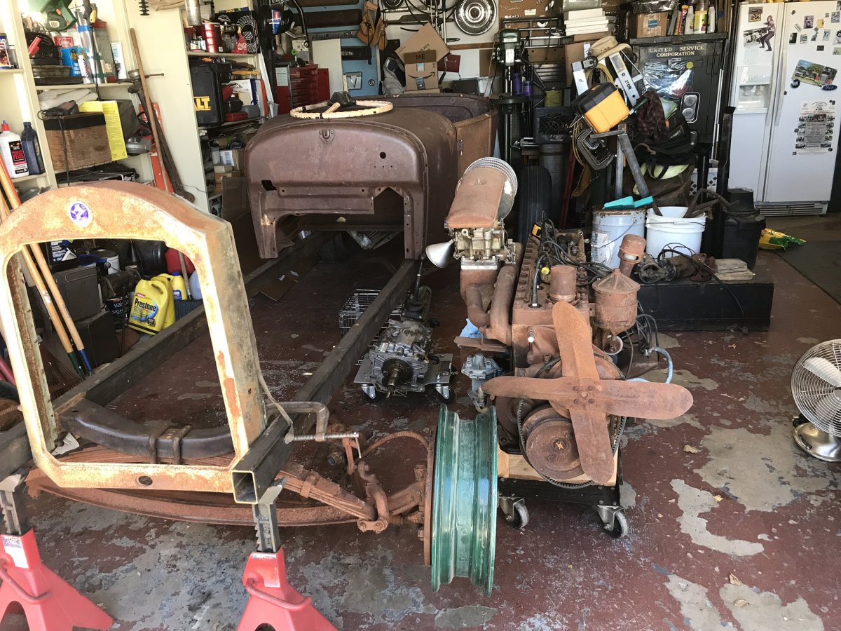

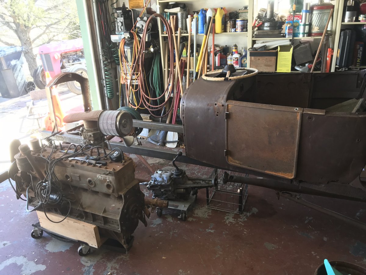

    A little progress.... OK, very little, but to me it felt huge.
    Last fall I had to move the whole shebang out to the back yard. Since then I've been trying to clear space in the garage so that I could bring it indoors and close to the tools. Yesterday I decided I'd stuff in the garage no matter what. So this morning I brought the rear axle around, then the frame and front axle and finally the body. I got it all tucked into the garage.
    I also managed to fab up some engine lifting plates to give me a couple of good places to hook a chain to the beast. Now that its inside I'm hoping to be able to get some time in the evenings to start swinging the engine over the rails and start fabbing engine mounts etc.
    Naturally, after I set the body on the rails I had to climb in and make the obligatory "vroom vroom" noises. In my head I put a few hundred miles on this thing today.

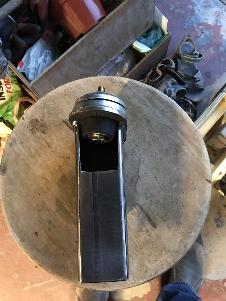

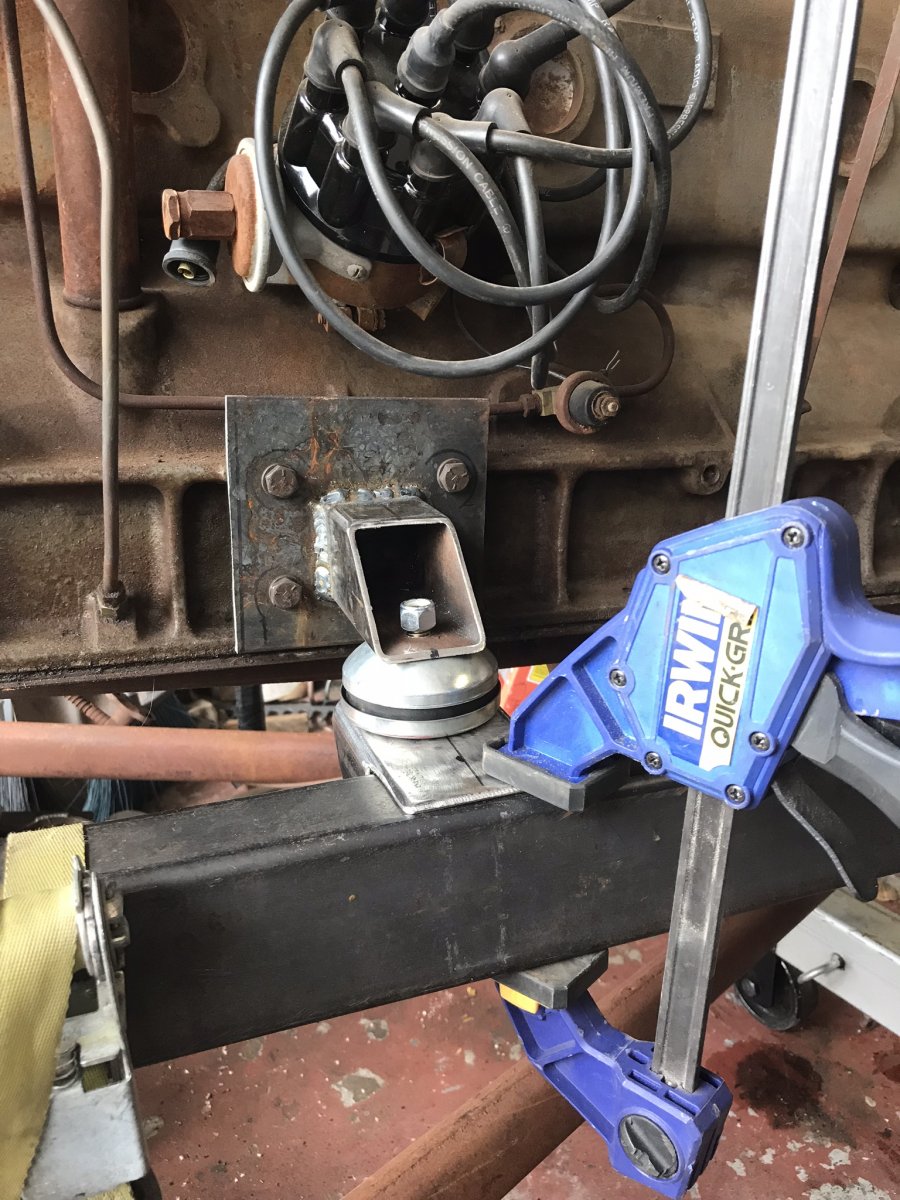

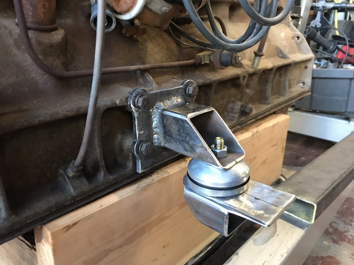

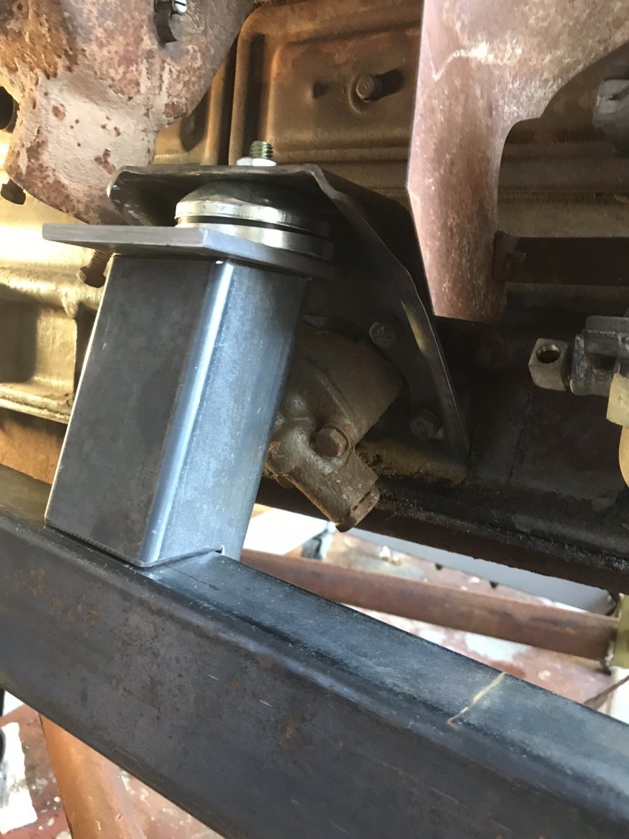

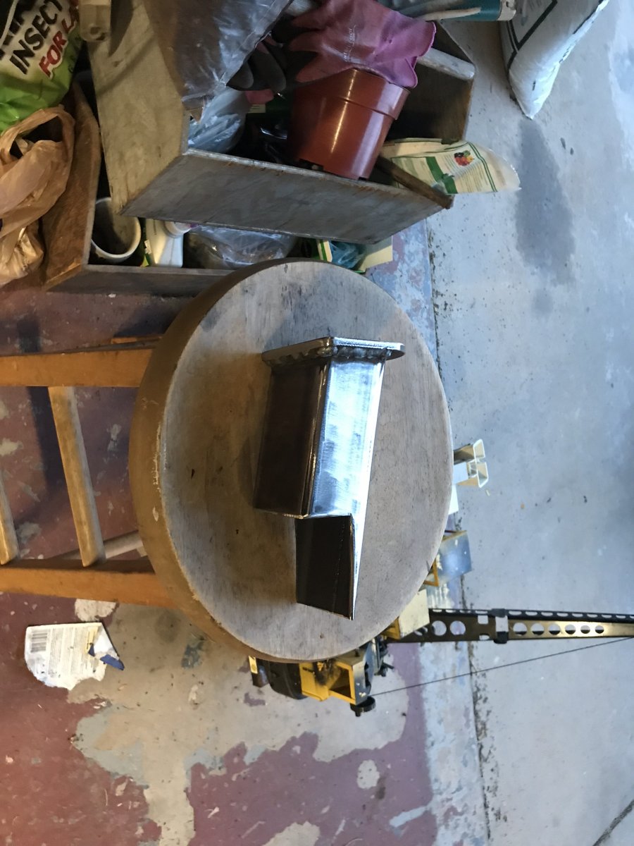

    Something to report. I've finally made a few steps forward. I have managed to fab up some engine mounts. The driver's side was pretty straightforward, I just had to bolt a flat plate to the engine block and a couple of pieces of tubing with the old standby biscuit type mount.
    The p***enger side took a bit more as the oil pump sticks out the side of the block right where the mount goes. So, for the p***enger side I used the original Packard bracket to bolt to the block and then fabbed up a tower to come up from the frame to meet it.
    It only too 3 tries to get the p***enger side built. I first fabbed it up using 2" tubing. I was just about to weld it to the frame when my neighbor came over and we started in on the frosty beverages. I'm sure glad we did and I didn't get it welded to the frame as I had to s**** it. There wasn't room for the lower part of the biscuit.....oops.
    So, I started over with 2.5" tubing. This time I had it all set to go and managed to cut the tubing to length at the wrong angle...DOH! The third time it all worked, got the tubing cut, fish-mouthed, cut at the right angle, recess for the lower biscuit, etc.

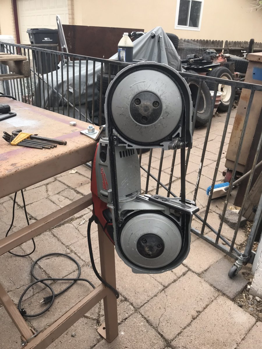

    To make all of these cuts I bolted my porta-band to my table and put a zip tie around the trigger mechanism.
    The next step will be to weld both sides the frame.....Hopefully this weekend.

    I have a Milwaukee like yours but it has a work platform bolted to it for a bigger surface. I would be lost without it. Mounts came out nice! Keep at it.

    Looks like the metal cups on the rubber mount will hit each other with weight on them.
  29. bobbytnm
    Joined: Dec 16, 2008
    Posts: 1,843
    bobbytnm
    I hope not. If so, maybe I can file them back a little bit. Once I get the brackets welded to the frame Ican test it with weight on it and see what happens. Hopefully soon
