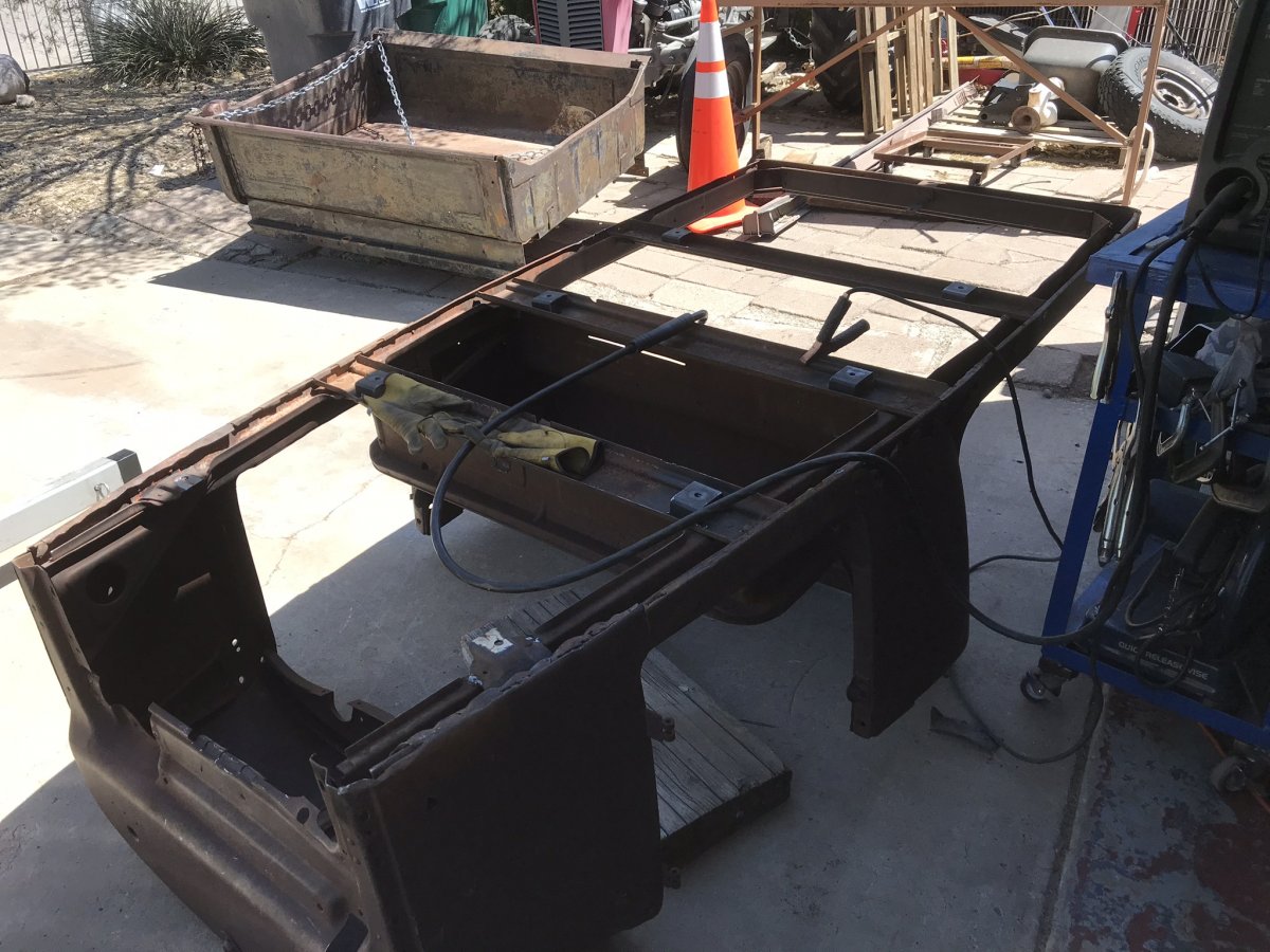

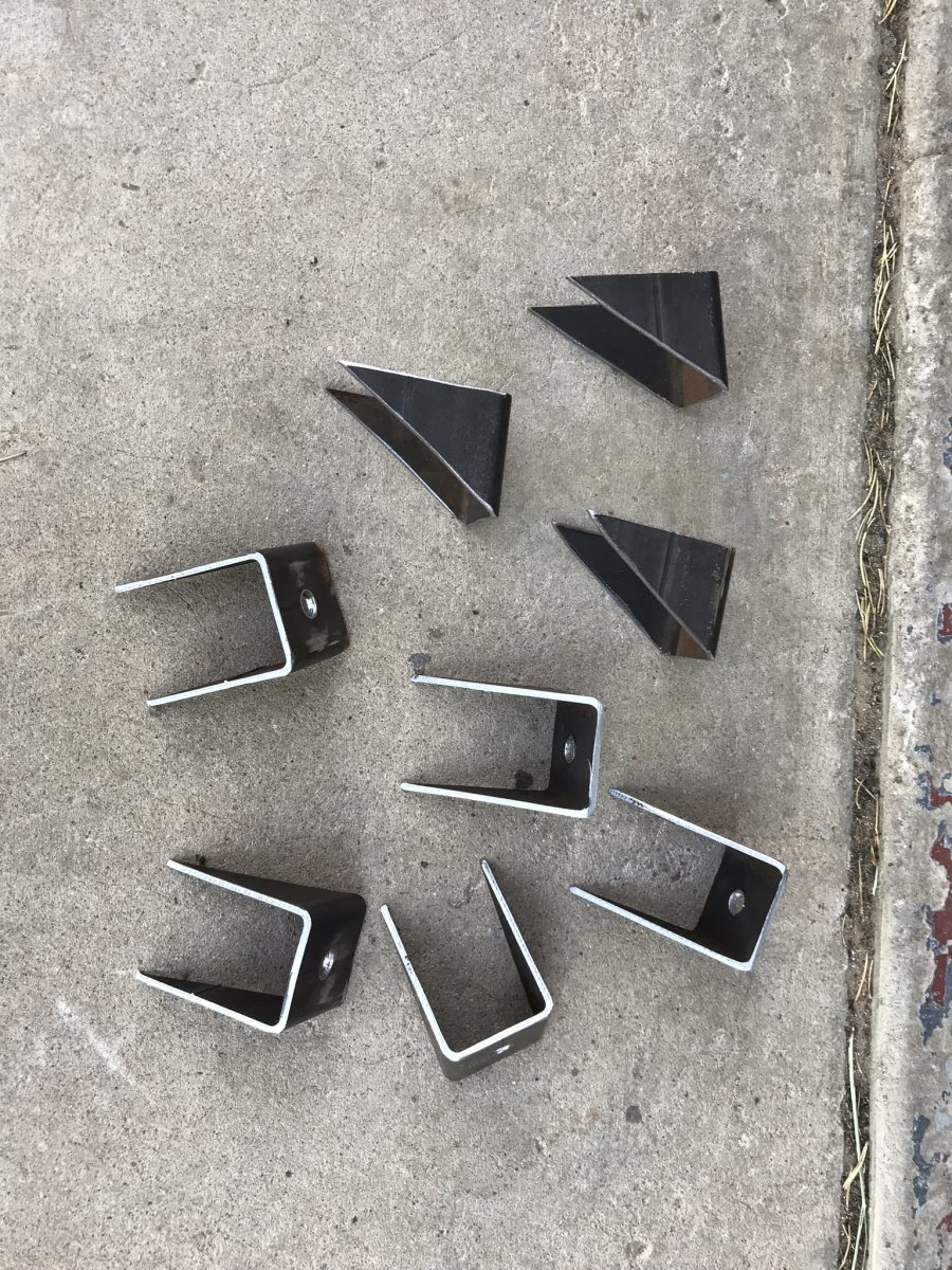

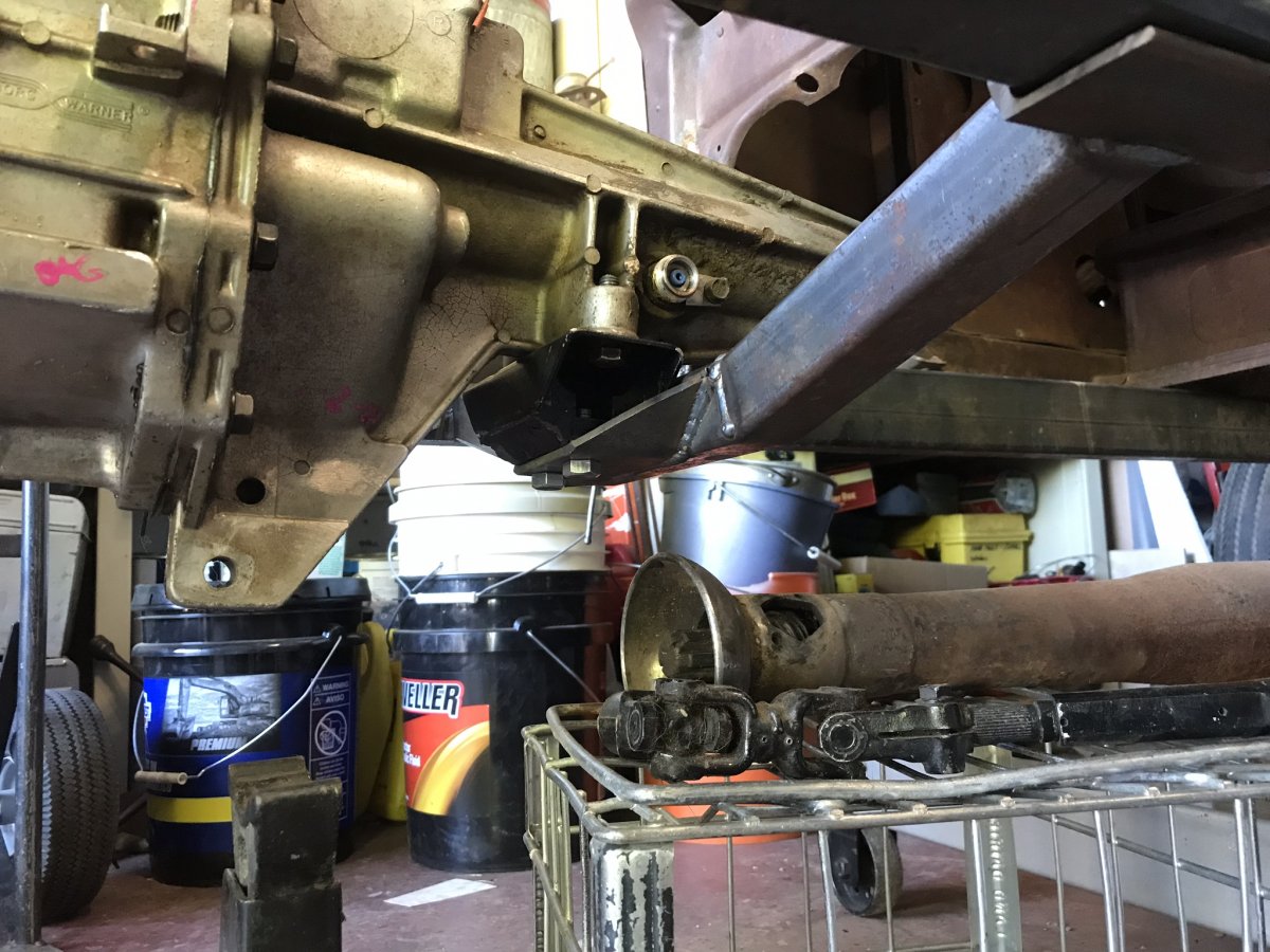

    Things are progressing. Slowly but at least I'm moving forward.
    I fabbed up a transmission crossmember and have it bolted in place so now the engine and trans is sitting between the frame rails.
    Since I gat that handled I started attacking body mounts. I cut out some mounting tabs from some 2x4 rectangular tubing. I have a chunk of old conveyor belt that is 7/16" thick reinforced rubber that should make some pretty body mount pads.
    I also managed to dig my bed out of the backyard and bring it around front to start ***essing it.

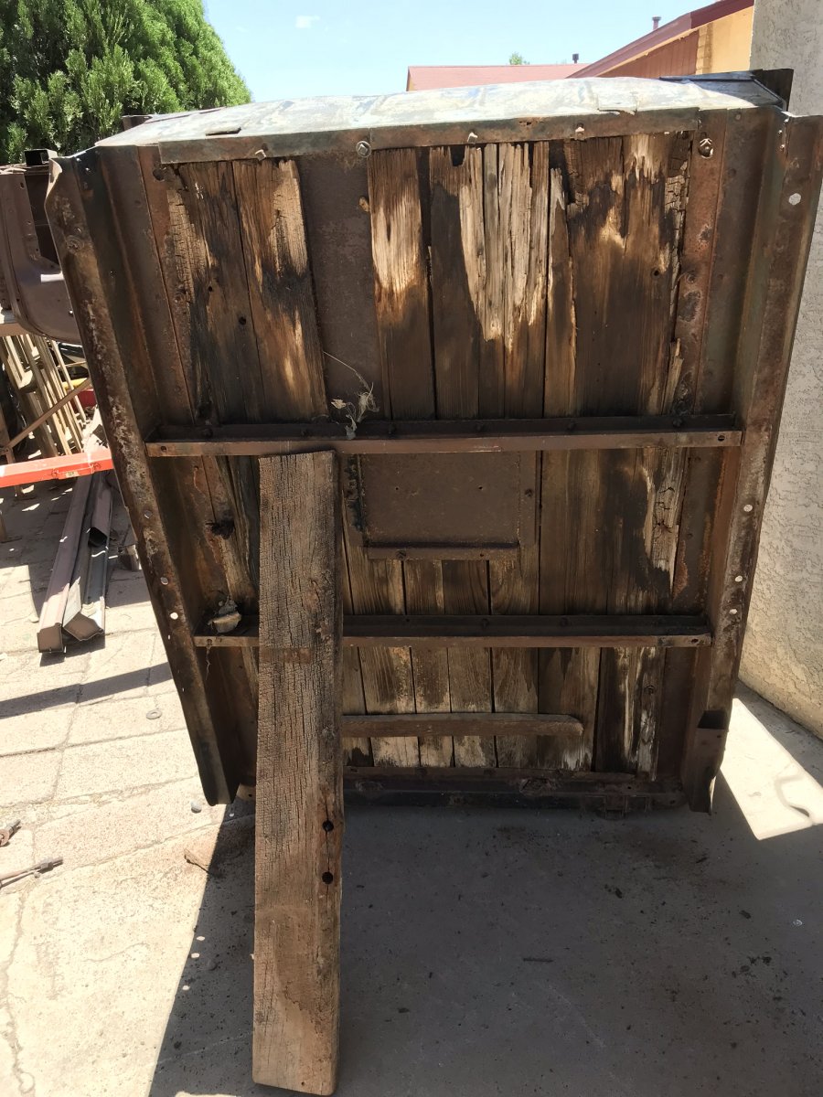

    When last we checked in I had started fabbing body mounts. Naturally I ran into some complications. The front body mounts on my 26 body were a bit tweaked. With some judicial application of heat and pressure I was able to get them bent back to mostly stock configuration. Due to using 2x3 tubing for the frame rails the mounting holes interfered with the frame so I filled the original holes and redrilled them and cut some tabs to weld to the frame to match.
    So, I've located the front 2 body mounts and welded them in place. Now I can lay out the remaining body mounts. I've fabbed some pads that will weld to the body, cut some reinforced rubber, and fabbed the frame mounts. Not I have to lay it all out and weld it together.
    I have a small hiccup with the bed. My bed is a Model A or newer and my body is a 26 model T. The rear section of the body structure on the Model T has an area that flares out beyond the valances of the bed.
    So, do I cut off the rear body section of the Model T?
    cut off the lower flange of the valance?
    cut off the flared out part of the body structure and make it all uniform?
    I'm thinking cut out the flare section.....ugh.
    Does anyone have any tips of mounting a later model bed on a Model T body??
    thanks all

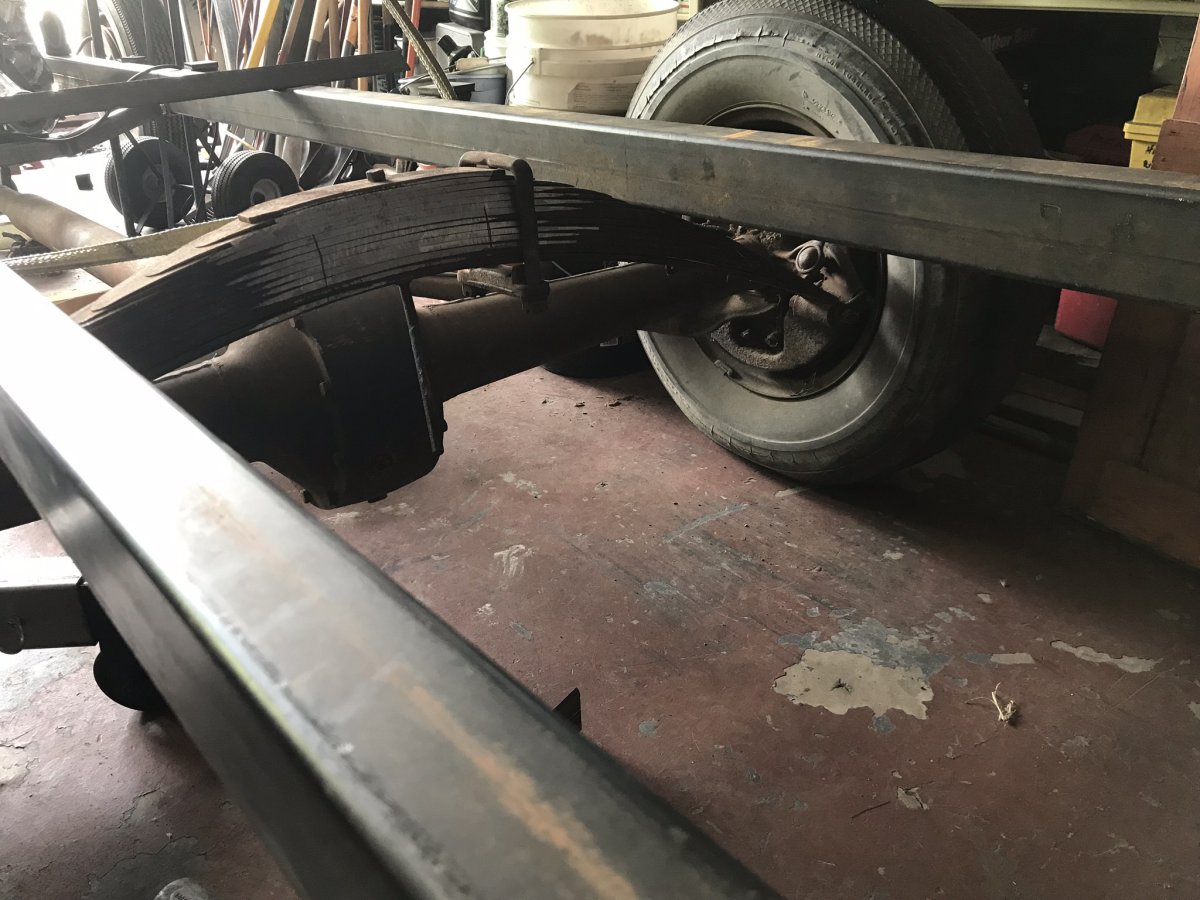

    Does anyone know the distance from the banjo rear axle centerline to the centerline of the rear spring? From a quick eyeball measurement it seems to be 7.25 inches but I'd like some verification.....thanks
    First, I got to preface this by saying that I have no idea on what I'm doing. I'm kind of wingin' things.
    I got a hunk of 2.5x2.5x3/16' square tubing that I'm going to attempt to use for a rear x-member. I think I'll have to grind the outside of the spring a little bit to fit inside the 3/16 tubing. The spring would fit inside 2.5x2.5x1/8 tubing but I don't that would be stout enough for a rear x-member so I decided on the 3/16".
    Now the next question is where to mount the spring in relation to the axle. I'm not lowering this thing, its gonna be a high ridin son-of-a-gun. I'm running a 1940 Ford truck rear banjo and spring.
    Again, just kind of by "eyeballing" it would seem like the top of the spring should be about level with the bottom of the frame. With that in mind I took my trusty carpenters square and some soap stone and drew it out on the floor and started cutting and bending.
    Here's what I have so far. Before I weld anything in place I set it all in the frame and see how it sets.
    Bobby

    I decided to rough fit the x-member. So, I tapped it into place between the frame rails (slightly to the rear of where it will eventually live) just to have a look. I think its going to work out.
    I have the frame marked for the centerline of the rear axle and what I think is the centerline of the rear spring. The next step is to pull the body back off, verify my axle and spring measurements (or at least make sure they are square with the frame) then position the x-member and tack weld the pie cut areas. I think weld it up on the bench so I can run every weld flat. While it's out I need to drill the locator hole for the spring pack and cut out the bottom section of the square tube and figure out how to make it slip over the spring pack (grind down the edge of the spring pack a bit? Heat it with a torch then Heat it with a hammer?).
    Once it fits over the spring pack then I can position it in place between the frame rails and set the rear suspension in place. I'll bolt on the tires and wheels, body and bed and see how this thing sits before I commit to welding the x-member in the frame......whew.....

  25. RMR&C
    Joined: Dec 26, 2009
    Posts: 6,509
    RMR&C
    from NW Montana
    Looks like it's going to sit really high. You could probably make the X member flat(no dip) and be fine.
    Depends on how high the front is and how high you want it I guess...

    Yea, that's why I'm not going to commit to welding it in the frame until I can get everything situated and get it sitting on its own 4 wheels. Then I can adjust as needed to get it to match the front.
    I have to decide on the spring as well. The spring I have is a 40 Ford truck spring....tons of leaves. I can probably pull several leaves out or maybe find a car spring. I haven't got that far yet
    Bobby

    Scott, You were right. Way too high. I'm not wanting any drop at all but this was a bit ridiculous.
    So, if at first you don't succeed... ...fab, fab again. Time for some rethinking and some handwringing and maybe the careful application of some frosty beverages.
    My stock 40 Ford truck rear spring has 14 leaves, the danged things is 3" thick. I think I can pull 6 or 7 of them which will buy me an inch. Then I can start over again fabbing a flatter crossmember.

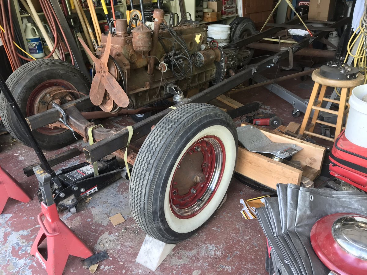

    On a brighter note... ...I bolted my front wheels on the front axle pulled it off of the jack stands to get an idea of what it looked like. Woohoo. I'm liking it!

    Bobby, that looks great sitting on four wheels! I keep doing stuff over till I'm happy with it....then later do it over again cause I still don't like it. LOL
    You're doing fine.....you may have to swap in a different spring. If you flatten that one too much it will get too long.
    I had to walk away from my project for a few days, was losing focus.
    loudbang, Unkl Ian and brEad like this.

    My son suggested the same thing, flipping the x-member over. It doesn't look like it will work that way either...too low. No worries, fabbing the x-member was a learning process and was fun.
    So, right now the front end is sitting on the ground under its own weight. In the rear. the frame rails are resting on the spring pack and the rake looks about right. So, Plan B will be to remove some leaves from the spring pack and fab a new, flatter x-member. There is a small chance that I might have to notch the frame slightly for spring clearance.
    Bolting the front wheels on sure helped overcome the disappointment of my failed rear x-member. I might have to set the body back in place so I can sit in the thing and make silly "vroom vroom" noises.
