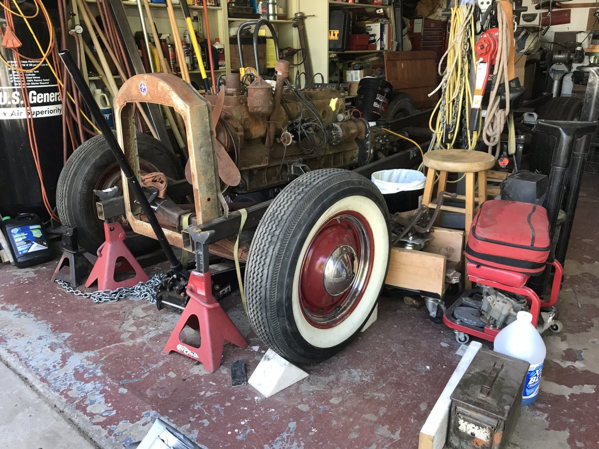

    What a great weekend!
    On Saturday I decided that I HAD to do something about the mess in the garage. I started cleaning and putting stuff and tools away. I had to focus on one little area at a time but before long I had things mostly straightened out and swept up.
    Well, once I got all cleaned up I decided I better set the body in place to see how the ride height turned out. Its awesome!!! After putting the body and bed on, I hung the doors, grabbed a steering wheel and proceeded to make "vroom vroom" noises and put some miles on it. My mouth got so dry I had to have a frosty beverage to rehydrate.
    I'm pleased with the way things are looking.
    Now I need to figure out a wishbone mount for the front and rear wishbones. I'm going to try my best to not spit the front wishbone, I think I can do it. So, once again I'm back in the handwringing and head scratching stage. This could take several frosty beverages to conduct proper planning.
    I had my trusty helper in the shop for a little bit

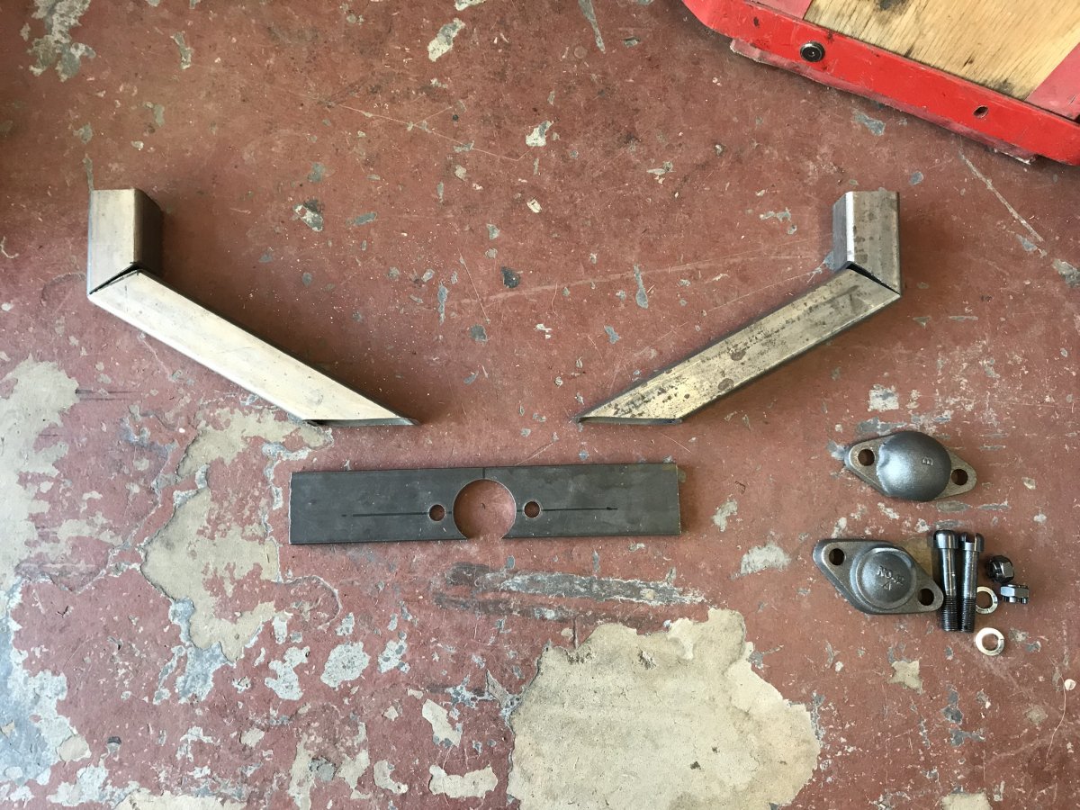

    I decide to revisit the front suspension and figure out a wishbone ball mount. What I'm thinking is welding a couple of tabs to the inside of the frame rails that the wishbone mount will bolt to. I had some 1 1/2 square tubing and some 3/8 flat bar so I started cutting, bending, and drilling.
    I need to clamp it all in place in the frame to see how its all going to fit. I might have to recut the square tubing to get the angle right but here's where I'm at.

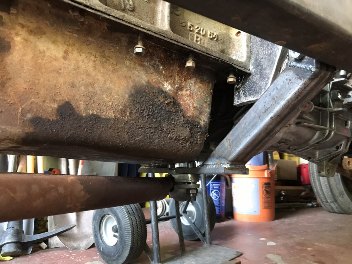

    I've still been battling the wishbone mount. I had to remake the square tubing pieces. I didn't do a good job of making the pie cuts and I didn't have the angles quite right. I drew it all up on some poster board, figured out the angles, and started cutting, bending and then matching up to my poster board. I got it all welded together and then made some brackets to weld to the frame.
    Naturally, after hours and hours of measuring and scratching my head I tacked my brackets to the frame and tried to bolt it all together..... ...nope, wouldn't work...LOL. I had to break my tacks and knock the brackets off the frame.
    I did some research to find the dimension for the distance between the spring pack center bolt and the center of the wishbone. I came up with 44 1/2". Today I laid it all out again. The 44 1/2" dimension didn't look right but got me close enough to get it set where I needed it to be.
    So, after several false starts and just as many backward steps I think I have the front suspension in place (well, I still need to finish welding the brackets for the wishbone x-member and finish up the ends of it)

    I welded in my bracket tabs this morning and bolted the wishbone in place. I then dropped it off of the jack stands and jumped up and down on the suspension. Woohoo!! it all appears to function like it should, no binding and no parts fell off or broke so I'm going to call it a success (I still need to trim the top of the bracket and cap it so its flush with the frame and I think I'll tube the bolt holes to prevent crushing of the square tubing)
    I'll be on vacation next week so every thing is on hold for a bit. When I get back I guess I'll finish up rear suspension; weld in rear x-member and figure out what to do with the rear wishbones.

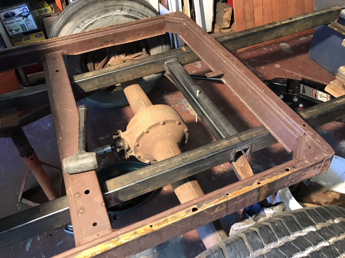

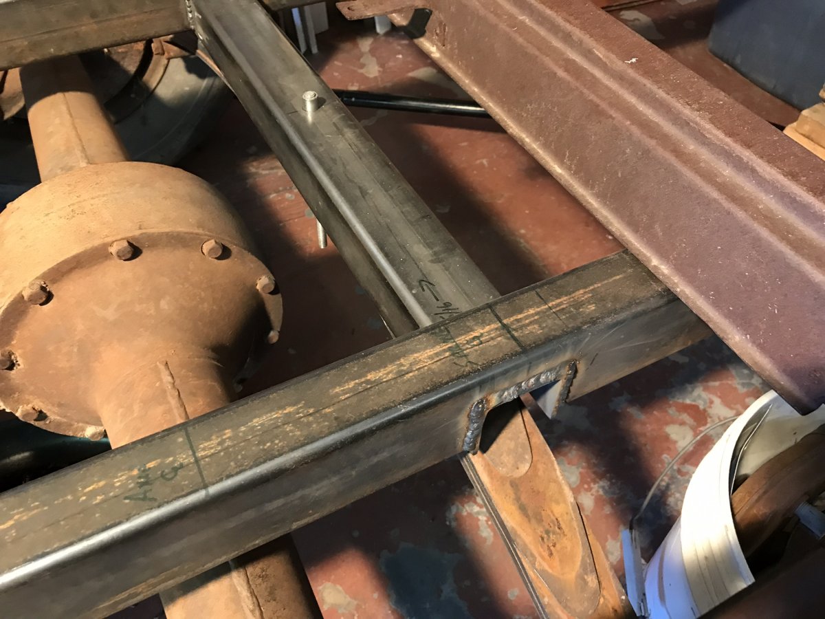

    It's been a long time since I had anything to report. Life has been nuts and a bathroom remodel has been eating up any garage time I had. I got lucky today though. I went down to buy the new bathtub and there wasn't one in stock....dang. That left me some time to mess around in the garage.
    I was able to remove the bed and weld in my rear suspension x-member. I know its not a lot of progress but it felt good.
    The next hurdle will be to figure out the rear wishbone mount. I think I'm going to have to shorten the rear wishbones about 8" but it should be too tough.
