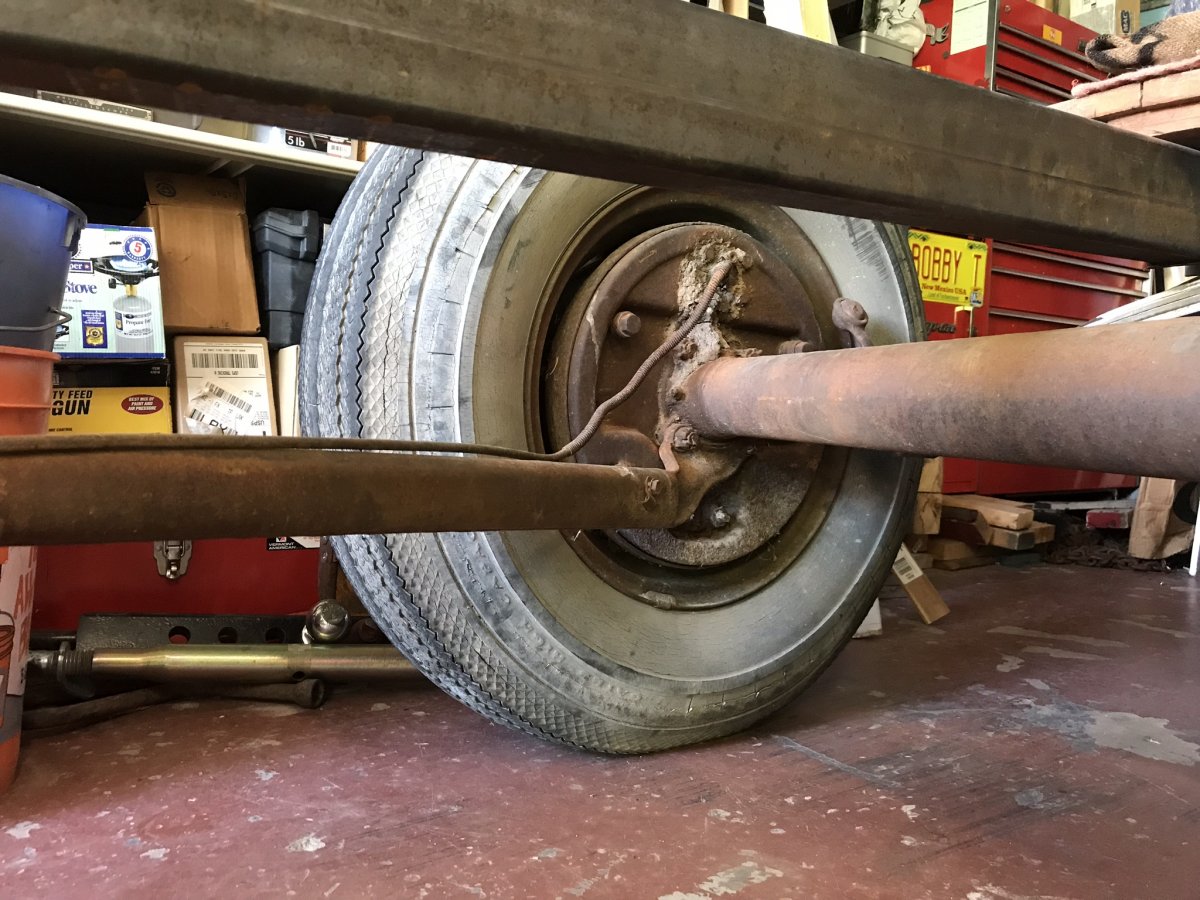

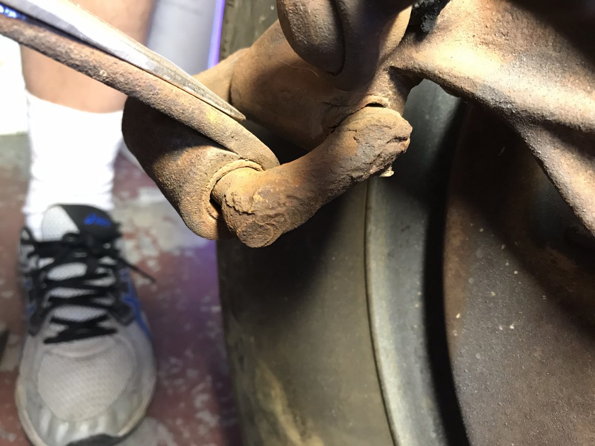

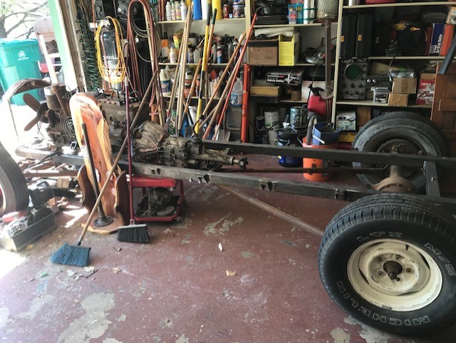

    I probably should have kicked the frame rails up a bit, but in the end I decided this was going to be old school. So old school that school is still spelled with a "ch" and not a "k". I didn't want the dropped on the ground look.

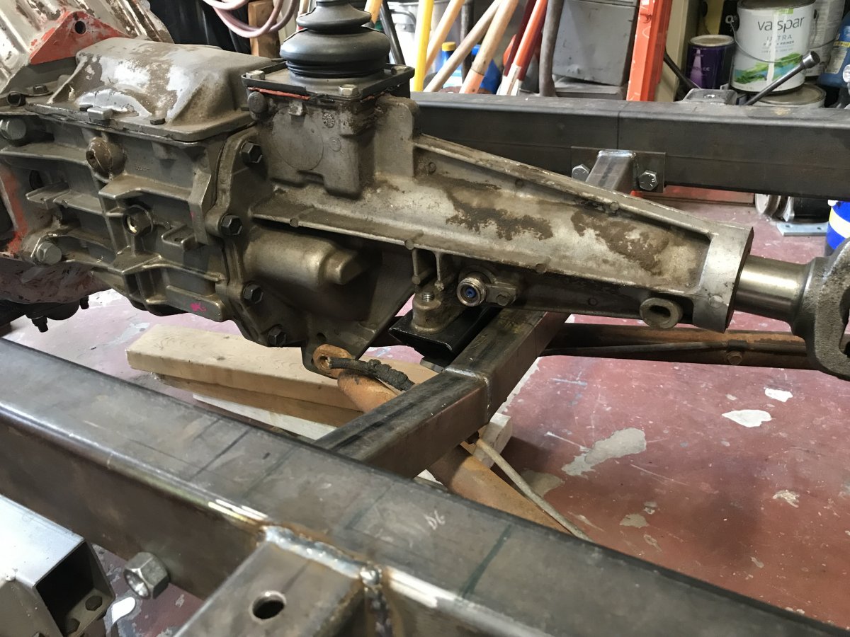

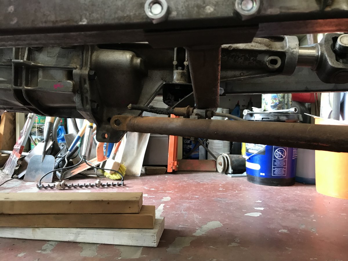

    Well, the trip to the Hot Rod Dirt Drags in Monte Vista, CO did wonders for pushing the motivation ****on. I managed to sneak a bit of time in the garage yesterday and excavated down to the roadster (its amazing how much **** can get piled on top of a project...sheesh). I got it excavated and then pulled the bed and body off so I can have easier access to the rear suspension. When last I left off I had fabbed a rear spring mount but haven't figured out what to do about the rear wishbones.
    I'm going to fabricate an open drive conversion so I will have to figure out a front wishbone mount. My initial thoughts were to use the ball mount from an old set of front wishbones and make the rear mount just like the front.
    Due to the length of my engine the rear of the trans extends back about a foot beyond the front of the wishbones. With my T5 trans the wishbones will almost bolt directly to the bottom of the T5. Its close enough that I think I might fab a bracket with a heim or Johnny Joint and bolt it to the trans.
    Any thoughts on this?

    As I said, my initial plan was to shorten the wishbones and adapt a ball mount from an old set of front wishbones and modify my transmission crossmember to include the wishbone ball mount on the back side of it.
    I'd appreciate some input on it
    Thanks

    I have always been told that the trailing arms should pivot with the rear ****** yoke. Reviewing other builds seems to indicate that many follow this design. In you case you would have to shorten the arms and bend them to meet with the yoke pivot angle. After that you will need to strengthen those arms for the torque that 8 is going to p*** thru to the rear when you get aggressive:rolleyes:

  6. Hey Bobby, I've been following since the beginning, having a personal love of the big Packard 8. I have never done what you are asking about so these are just observations.
    First, the ear cast into the bottom of the S-10 T5 was not engineered to handle the loads it would see by attaching the rear bones to it. I believe the case would fail prematurely if you went this route.
    Second, Henry's rear suspension design depended on the rigidity of the three triangles formed by the torque tube and the rear radius rods to keep the rear axle from torque rolling with acceleration and deceleration, a**** other functions. Eliminating the torque tube with an open drive takes away two of those three triangles which you must try and replace. This appears to be what Mr. VTW is accomplishing with the webbed bones he has shown. I ***ume these attach to the rear axle top and bottom, restoring the three triangle mount of the axle.
    Try and duplicate that system and try and pivot everything near the same point in the ch***is and you should be rolling reliably in no time.

    Thanks for the replies. Great advice! Yea, deep down I knew that the ear on the ****** wasn't the best solution....
    ...besides, that would have been way too easy...lol
    Thanks for pointing out that the wishbones should pivot with the rear ****** yoke, I hadn't considered that.
    I'll go back to Plan A. I have an old ball mount from a set of front wishbones. I think I can fab a mirror image of my existing ****** mount, tie them both together and be able to bolt the wishbone mount to it.
    I'll have to shorten the wishbones about 13" but that shouldn't be a major deal. I will also fab a bar from the top of the banjo rear forward to the frame to help prevent the diff from trying to roll up.

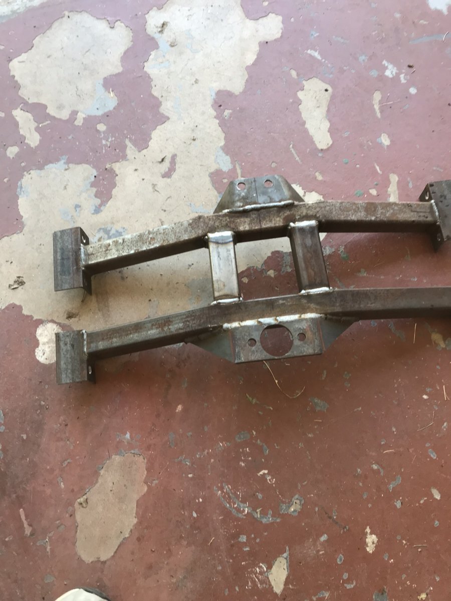

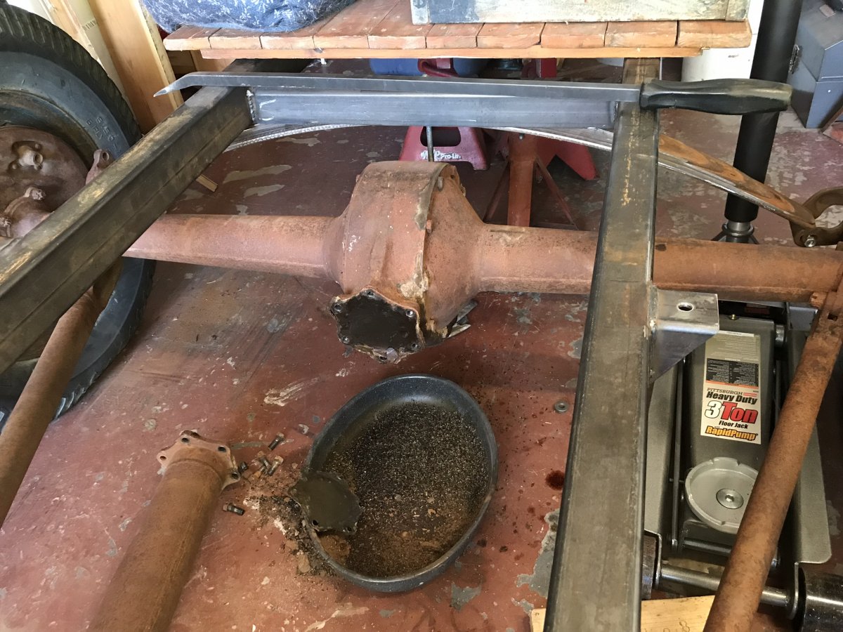

    So, taking the proffered advice, I had some time this evening to dig around the steel pile to see what I had to work with. The plan is to make another x-member as a mirror image of my ****** x-member but with a mounting tab for a wishbone ball mount. I'll get it positioned so the ball mount is in line with the front driveshaft U-joint and then tie the 2 x-members together.
    I cut and bent some square tubing to match the ****** x-member, then cut and drilled a mounting plate for the ball mount. I still have to bend the ear back on the ball mount and fabricate some ends for the x-member but its coming together. I had to stop tonight as I ran out of time and the next step requires a bit of the garage hokey-pokey to dig my torches out.
    Once this is all done then I'll tackle shortening the wishbones and adding the ball
    fun, fun, fun...

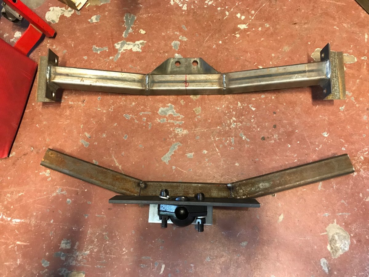

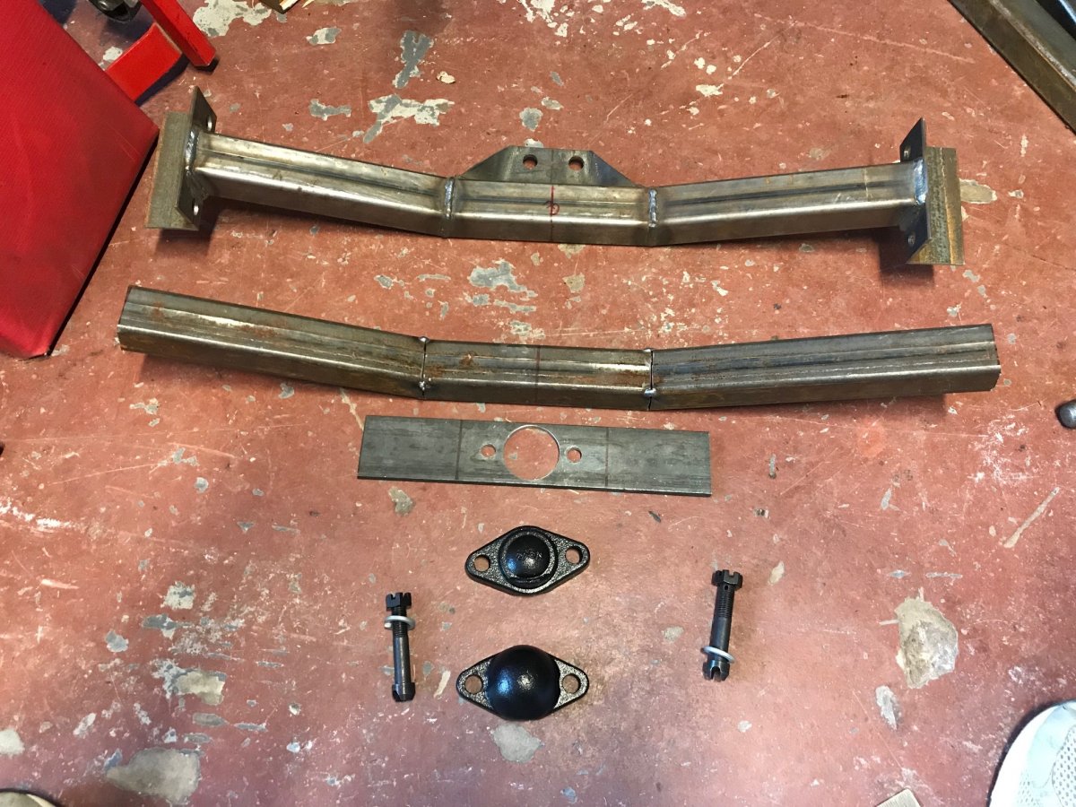

    I managed some more garage time. I think I have the x-member pretty much finished up.
    Before I jump in and start hacking and bending on the wishbones I need to make a decision. I want to keep the wide 5 bolt pattern but I want hydraulic brakes. I think I have what I need to convert my 38 Ford front axle to hydraulic. Right the rear axle that's sitting under my frame is a '40 Ford banjo. I was just going to swap on my wide 5 drums and call it good. But, looking a the wishbones there a bit of a difference. At the end of the 40 wishbones there is a small cast piece that bolts the backing plate flange whereas the earlier 38-38 wishbones seem to have a large cast piece that bolts to a flange on the axle tube. The set-up looks a bit more robust than the 40.
    So, do I keep the 40 and swap the drums or go with the earlier and convert to hydraulic? I'm thinking the earlier wishbone set up looks beefier and I should probably go that route.

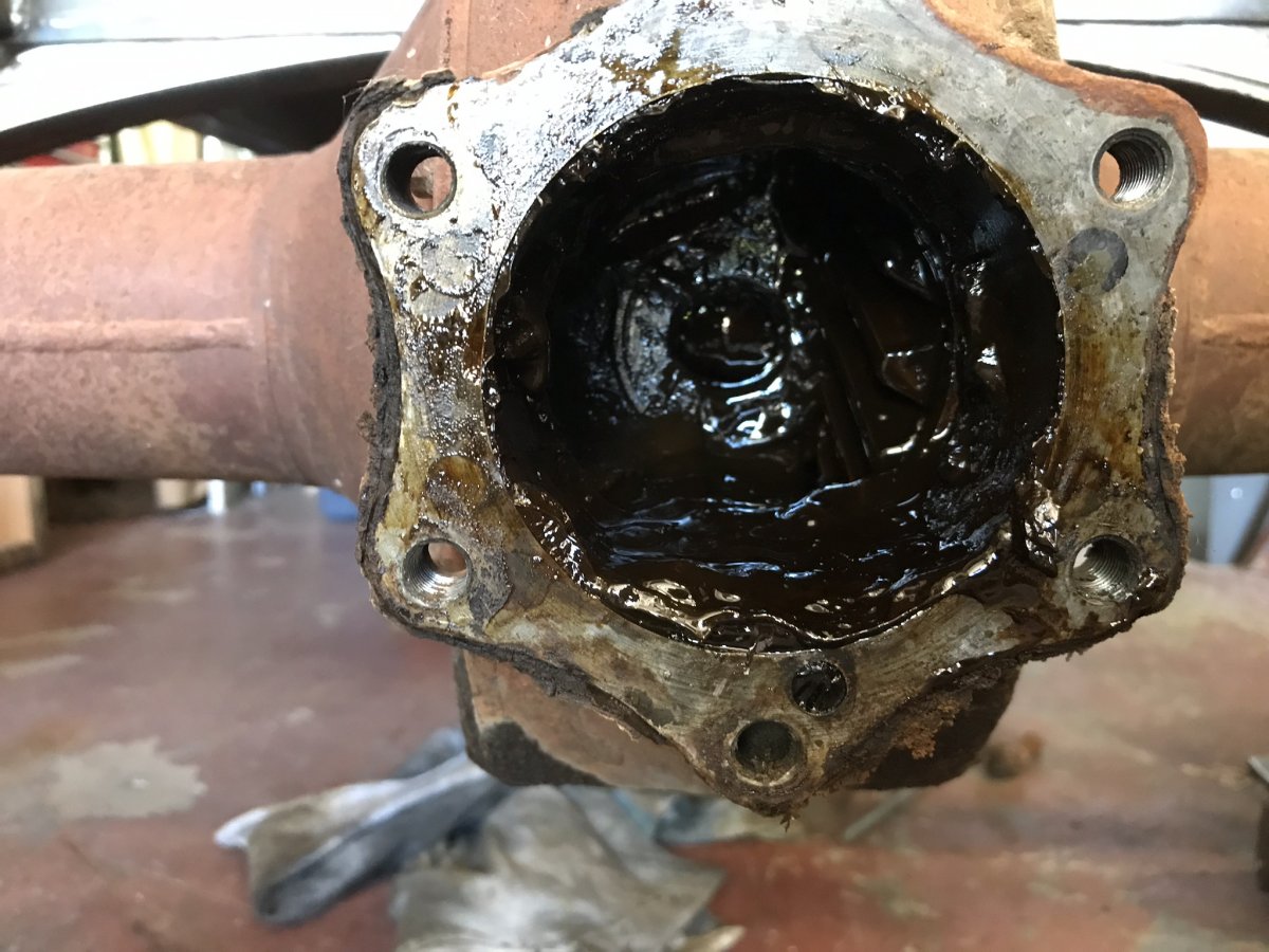

    This banjo rear came from a small trailer that I picked up several years ago. I pulled the torque tube off this afternoon. I was a little surprised to find that there is no driveshaft inside, there is a block off plate at the diff and the pinion shaft is missing....ugh.
    So, now its decision time;
    Do I stay with this rear diff and tear some of my others banjos apart to make this one complete?
    Do I go back with the 40 banjo and abandon this beefier wishbone set-up?
    Do I keep these wishbones and fabricate some mounting brackets on the 40 banjo axle tubes?
    Every time I think I've conquered a build issue it seems like several more issues pop up and set me back....ugh.

    You can just swap the bells onto the 40 rear end; they are the same width. It's not really all that difficult to do but it's helpful to be able to stand them up when you do this.
    https://www.hotrodworks.com/technical-information/rear-axle-measurements/
    Get some new gaskets; you will need them. While you've got things apart it's a good time to inspect things. You will want to read up on rebuilding these too but for mockup you'll be fine just ***embling what you need to get the car laid out.

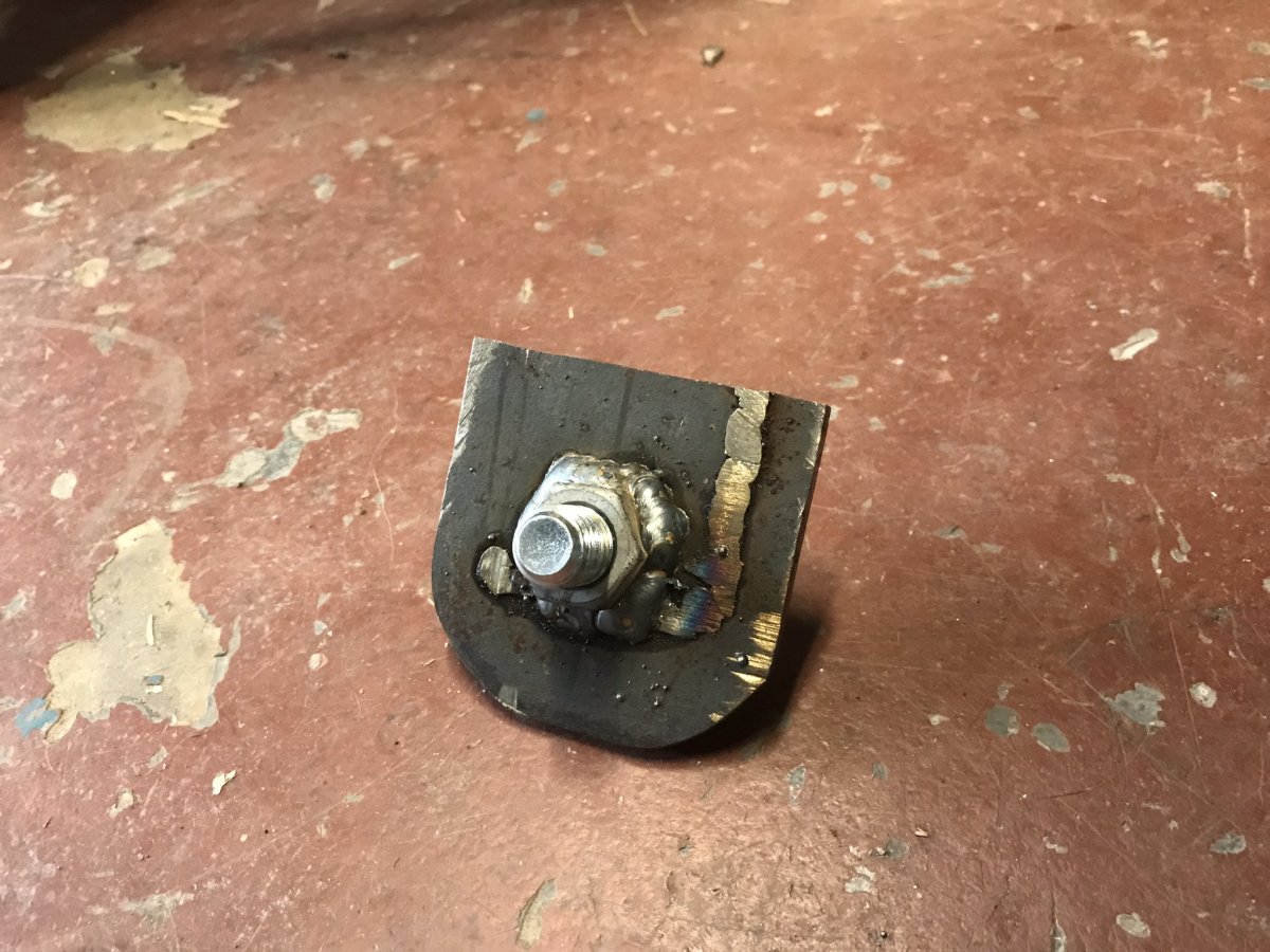

    I think I've decided to fabricate some brackets that will let me use the 35/36 wishbones on the 40 banjo. It just seams easier to me that to try and dis***emble several banjo and piece one back together. I can just imagine how much of a mess I could make in my garage with that stinky old diff grease....yuck.
    So, in the meantime I decide to at least break the hubs loose on my pile of banjos. I called up an old friend and fellow HAMBer to see if I could borrow a hub puller. Winduptoy was generous enough to lend me the puller and I got to spend a pleasant afternoon drooling over his toys. The downside is that I now have serious engine envy. Unfortunately the hub puller didn't help. Its the style that goes over the lug studs and won't stretch out far enough for the wide 5 axle.
    So, I dug around in my s**** steel bin and am***ed some stuff and figured I'd try my hand at fabbing a puller. I used some 3/8" plate for the bottom, some 2.5x2.5 square tubing, some 1/4" plate for the top and a 5/8" bolt and nut. I took a 3" square piece of the 3/8" plate, poked a hole in the middle and then cut it out into a slot. This plate will slip over the shoulder on the hub. Then I notched a window in one side of the square tubing. I drilled a hole in the 1/4" plate and welded the 5/8" nut to it before welding both plates to the tubing. I still need to grind the 5/8" bolt into a point so that it will engage in the end of the axle shaft. But, after I welded the whole mess together I was anxious to try it out so, after flushing up the axle nut with the end of the axle I slipped my puller in place and used a washer between the end of the bolt and the axle nut. I started tightened the pulled bolt. Once I had some good tension on it I gave the bolt a good whack with a hammer. I had to repeat the process twice before the hub came free but it works great. I have 3 more banjo rears to try it out on. I hope it holds together.
    All in all I was able to put this together in a couple of hours with stuff that I had laying around. Not a bad way to spend an afternoon

    That's a pretty spot on replication of the Ford puller you got there. Did it work?
    I actually just mangled one I got off of eBay; it was of the multiple piece variety that you have to ***emble around the collar.

    Nice job on the homemade hub puller!

    Thanks guys. They say necessity is the mother of invention. I disagree slightly, I say being broke is the mother of invention (I guess it helps to have a need as well)
    So far the hub puller works like a dream. I've only pulled 2 hubs so far. Hopefully this weekend I can give it a real stress test. I took a few minutes tonight to grind the tip of the bolt down into a point so that it engages in the end of the axle shaft and I dolled the whole thing up with a coat of paint.
