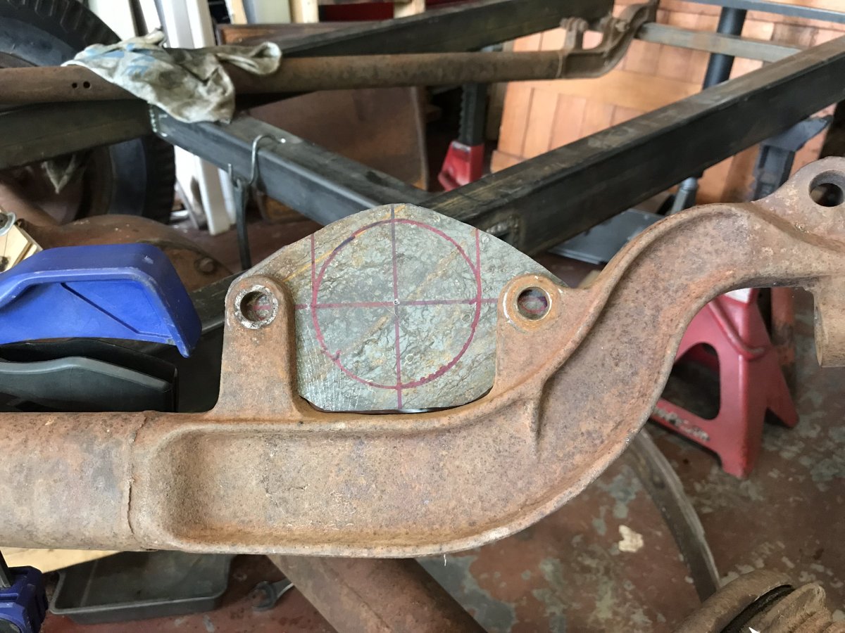

    I managed a little bit of garage time this weekend. I used some poster board and a few frosty beverages to make a template for the 35/36 wishbone brackets. Then I clamped my port-a-band to my bench and started carving out the brackets from some 3/8"x4" flat bar.
    I couldn't finish them up since I couldn't find my 2 3/4" hole saw. Either I misplaced it or loaned it to someone, either way, I got tired of looking for it. I'll use transfer punches to mark the bolt holes and once I find my hole saw I'll poke some holes and get these finished up and ready to weld to the '40 banjo.
    baby steps, but its forward progress

    Great start, but you will need a kind of oval hole to go thru that plate as your radius rods I ***ume will be on a slight angle to meet at the center of your ****** mount location.
    Maybe a die grinder could help you tailor out the final shape to fit.

    fiftyv8, yea, I figured it would take a bit of m***aging to get the angle right. My plant is to drill it out with a 2 3/4" hole saw, notch it to fit over the axle tube and then "m***age" it to fit the angle I'll need. I'll kind of have to play that part by ear as I'll need to cut the wishbones down to length and mate them to the Model A ball mount.
    That might take a bit of planning (which usually entails sipping some frosty beverages, pacing back and forth and furiously overthinking things)

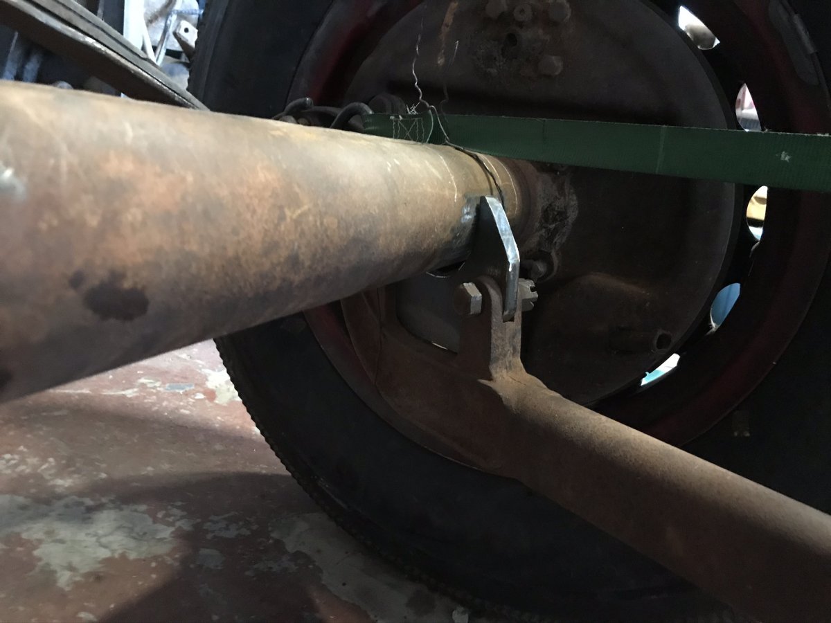

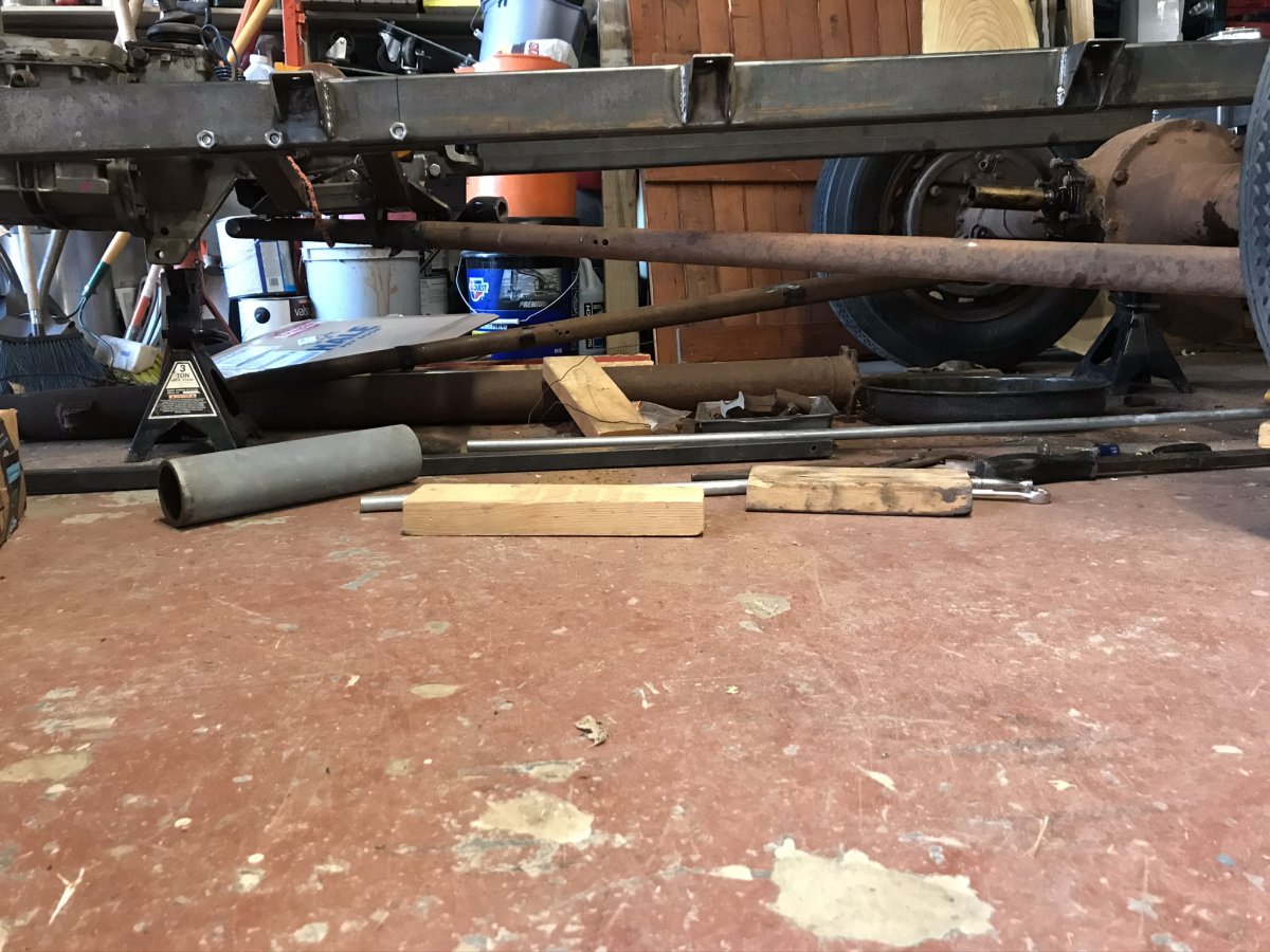

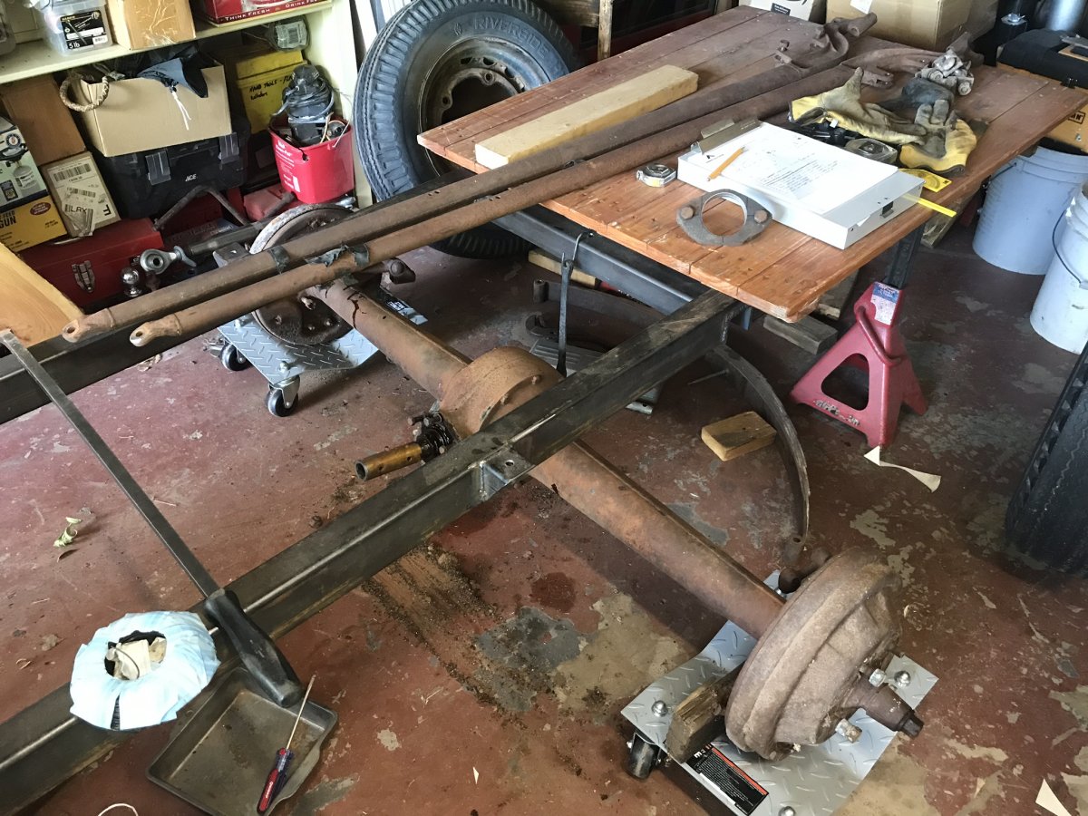

    It's been awhile and I don't have much to report. My progress has slowed to a snails pace. Sometimes life just gets in the way...
    Here's what I got done. I got the 36 banjo out from under the ch***is. I need to pull the drums and wrap the axle stubs to protect them and put the thing out back in the parts pile. I drug the 40 banjo our from the parts pile and brought it around and stripped the wishbones and brake lines off of it and now have it under the ch***is. I used my homemade hub puller to break the drums loose in preparation for replacing them with the wide 5 drums.
    I also cut the slots in my wishbone mount brackets. Its going to take a bit of grinding to fit them to the axles but I expected that, no biggie.
    So, the 40 banjo has the spring mount as part of the hub ***y. The 36 wishbones have the spring mount as part of the wishbone. What would be better; cut the spring mount off of the wishbones or cut the spring mount off of the axles?
    My initial thought is to cut the spring mount off of the wishbones, as that would give me a bit more flexibility on where I can weld on the wishbone mounts.
    winduptoy, AndersF and loudbang like this.
  18. bobbytnm
    Joined: Dec 16, 2008
    Posts: 1,825
    bobbytnm
    Wow
    I can't believe I haven't had anything to post since August. Where does the time go?
    Even now, not much to post. I have made a couple of steps. Even though they are baby steps they were quite a hurdle.
    When last we met I was busy fabricating wishbone mounting tabs for the banjo rear axle. I have the brackets made but not yet tacked in place. I figured I better get the spring mounted to the rear axle and the rear axle in the frame first so that I could get a better idea on where the wishbones are going to live.
    I played hell last Sunday beating the old spring bushings out of the spring and the carrier. I installed new spring shackles. Then I had to figure out how to get the spring mounted on the axle.
    I took the spring pack apart. I put some lumber across the top of the frame and with a ratchet strap on each side of the spring I was able to get it spread out enough to install the shackles. After that I set the rest of the leaves in place and cranked them down with a couple of big spring clamps and got it all in the frame...whew.
    This afternoon I pulled the wide 5 drums off of my 1936 banjo and put them on the 1940 Banjo so that I could bolt my tires and wheels in place. Looking good.
    My next big adventure will be to roll this mess outside and do a major cleaning on my workspace. Then I will roll it back into the garage nose first so it will be easier to work on the rear suspension. Then I can get the whole wishbone thing figured out. Man, this rear suspension is taking its toll.....
    Here's a couple of pics, you can see what a mess I have going...ugh

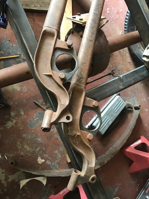

    Situation normal.... ...one step forward, a couple of dozen steps backwards.
    I've been doing a lot of "hand wringin" and worryin, and driving my self crazy with this whole rear suspension thing. Part of the problem is that the 40 Banjo has the spring mount attached to the end of the axle tubes. The 36 wishbones have a spring mounts cast into them. So, I either had to cut the spring mount from the 40 axle or the 36 bones. Either was a no going back commitment.
    Well, today I took the plunge and cut the spring perches from the 36 bones. No going back now. My plan was to cut the spring perches off, bolt the bones to the 36 banjo and then weld a piece of s**** across the bones to maintain the correct width. Then I could take the bones, bolt my fabricated mounts to them and clamp in all in place on my 40 banjo. A good plan, but it won't work.
    I tried to mock it up and the wishbones would have to be pie cut to bent in a bit to line up with the Model A ball end. If I put more angle into my fabricated axle brackets the wishbone mounting bolts interfere with the axle tubes.
    So, after much contemplation I think I have a solution. I'll refabricate the wishbone to axle tube mounting brackets to lower the mounting point a little bit. This will allow me to put more angle to the wishbones without interference with the bolts and will let me use the bones without having to pie cut them. Once that is done I can then cut the wishbones to the right length and get them splice to the Model A ball mount and get this danged thing all bolted together.
    Bobby
    temporary tacking the wishbones together to hold the dimensions...
    no going back now
    wishbones need to come together a bit more to meet up with the Model A ball mount
    if I lower the rear of the bones about this much it will allow me to put more angle into the bones without the bolts or the mounting ears hitting the axle tubes
    I'll have to shorted the bones about 16"

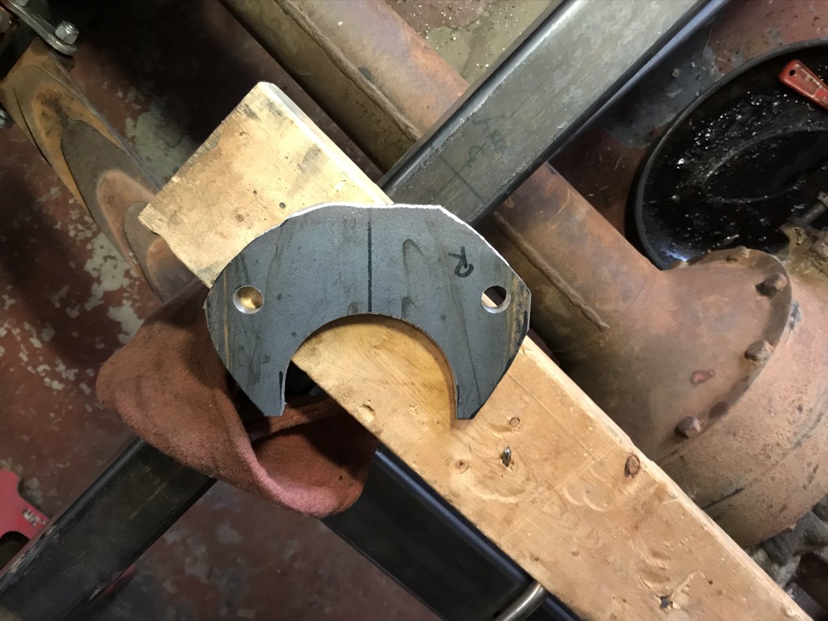

    A few more little teensy steps forward. After measuring, head scratching, measuring, measuring, measuring, a little more heady scratching and some more measuring I cut the wishbones down to length.
    Now, I'm really committed. It's going to work.
    I need to take the ball mount and clean out the inside diameter to accept whatever I'm going to use for a splice between it and the wishbones. I'm guessing either 1" pipe or 1" round stock.
    Then I'll just need to hold the banjo at the right angle to maintain the correct pinion angle, hold both the wishbones and wishbone brackets at the correct angle and orientation to the axle tubes while holding the splices at the front of the wishbone to the ball mount in alignment...
    ...what could possible go wrong?

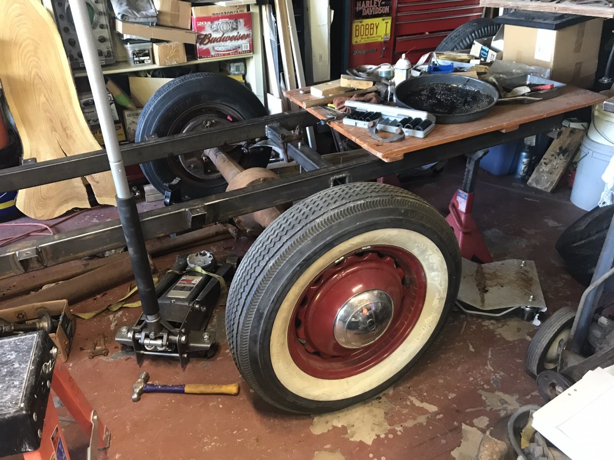

    I haven't quite crested the hill for this rear suspension, but the peak is in sight and the climb has gotten a bit easier.

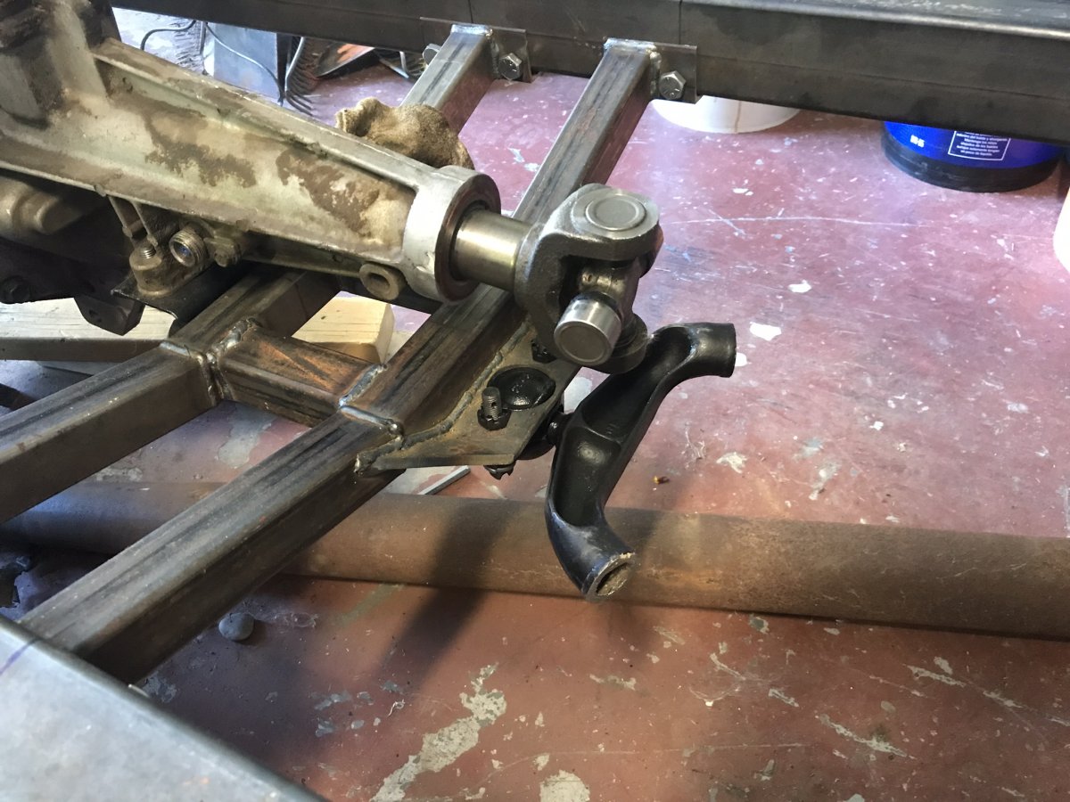

    I cleaned up the ends of my Model A ball mount and fabbed some pins that I can use to splice between the ball mount and the wishbones. Now I need to get some final measurements for the wishbone lengths, cross drill the ball mount and wishbones for some plug welds and then glue this whole thing together.
    I think I'll do as suggested and get the ball mount and wishbones joined up as a unit and then tackle the wishbone to axle brackets.
    My goal is to have this portion of this done by the end of the year (famous last words.....)

    To continue my prior metaphor....
    I am a few small steps away from the crest of the hill and will be sliding on down the other side shortly.
    I did some more measuring, cutting, t*******, fitting, finagling, hand wringing, cussing, etc and think I finally have everything ready to go. I cross-drilled the Model A ball mount and dressed the ends so that they are ready for the splice pieces. I trimmed down the length of the wishbones, cross-drilled them, and dressed the ends so they are ready for welding. Then I fit everything back in place and made a bunch more measurements. Today I'll get it all tack welded together. On Wednesday I've made arrangements to take the whole mess over to my buddy's shop to burn it all in place (I'd rather use his larger welders instead of my little 110V unit).
    So, by Wednesday I should officially have a rolling ch***is!! Woohooo!!!!
