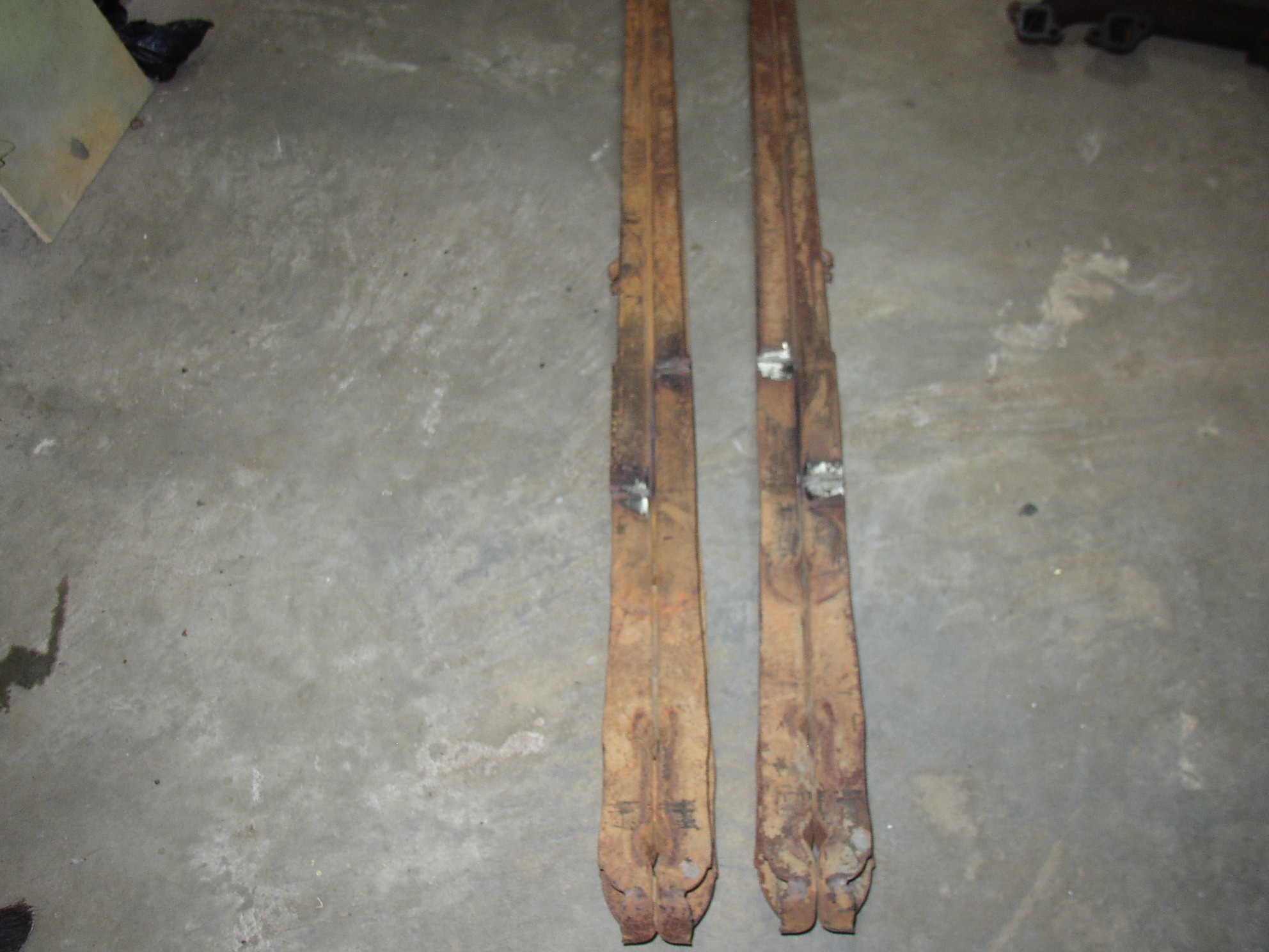

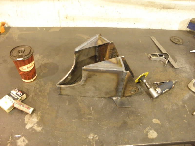

  2. mount.jpg I am doing the same in my 40. If you want to keep the 5 on 5 bolt pattern, a 58 Edsel big car rear is the right width at 59". If not concerned about the wheel BC, any rear in the 57-59" range will work. 99 Explorer 8.8 rear is the right width and has discs. Because of the rear coil springs and frame design, there are limited options- GM truck arms, parallel arms, or triangular arms. I opted for the GM truck arms. The stock arms are a little long unless you cut part of the X-bracing on the frame out, so I shortened my arms 3". A fabricated front arm mount is required. I copied a design from another member. Since the springs mount slightly behind the centerline of the axle, a fabricated adapter that sandwiches between the arms and axle perches works. I can offer some more insights if you PM me. trackarm 2.JPG

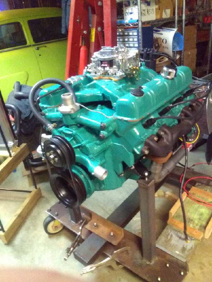

  4. You can use the half ton front pivot point crossmember if you remove part of the x-member. I didn't want to do that, hence the fabricated bracket and shortened arms. I too am installing a healthy 401 in one of my coupes. Just a regular Th400 behind it. Buicks used the torque tube rear axle up thru 60 13961.jpeg . Unless you are going to run headers, start looking for a set of 61 LaSabre 364 single exhaust manifolds. They dump in the right spots to miss the steering box.
