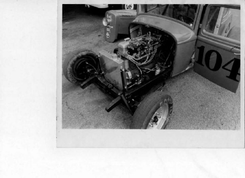

    I don't know nearly as much as most of the people who answered you here already. But I do know I used a Pinto R&P on this car in '78 and it is still on the car and works fine IMHO.

    That is what I have on my 32 pictured on page 1. SCTA didn't like it, but I pointed out the millions of Pintos running around. Bumping curbs. Hitting pot holes. And never heard of a failure. After I retired the car from SCTA events and took it to the nostalgia drags SCTA banned them from further use. Never heard a solid reason. They just didn't like the look of it, I guess. Still on the car 38 years later.

    Yeah. I remember all those Pintos going off the road because the flex shaft failed. Sometimes I would see two or three on the way to work. I should add that I mounted my R&P behind the axle, as I thought in front was ugly. This required a reverser box so that the steering wasn't backwards. I used oil return pump gears from a CF6 General Electric engine that had been removed and replaced. Had a lot of them available at the time. Mounted solid to the frame at the bottom of the steering column. At the same plane as the rear of the hairpins. So the flex shaft would move in the same arc as the hairpins and axle. Otherwise some of the wear speculated about above may have been a concern. But it seemed common sense to do it this way and lacking learned persons to tell me it would not work. I just did it. So far so good.
