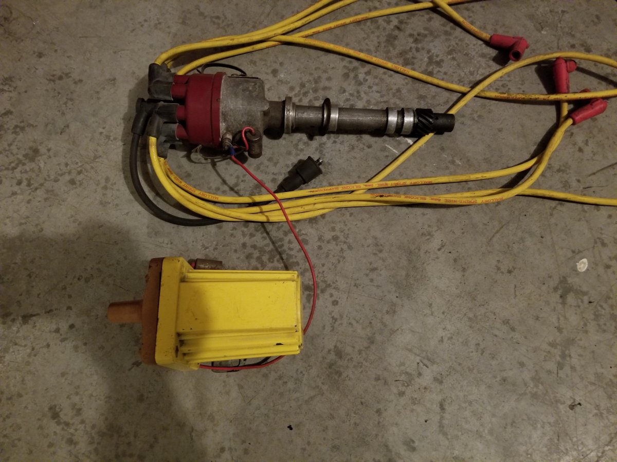

    Found a few more goodies to add to my growing pile!
    Cast iron chevy bellhousing.
    Mallory points distributor (thought it was a dual point but not the case), coil and wires.
    Holley 3310-1, 780cfm carb from a 65 chevelle, 396 - 425 hp.

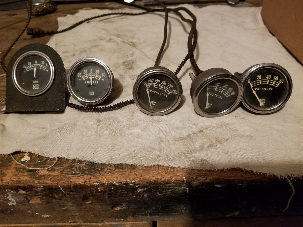

    Vintage Stewert Warner gauges - oil pressure, temperature and amps. Very cool stuff!

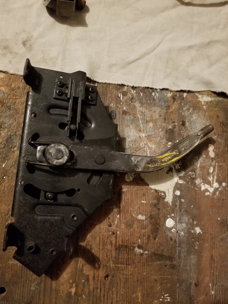

    Mr gasket auto shift - missing parts but cool!
    j-jock, Deuces, JUNK ROD and 5 others like this.
  3. 56sedandelivery
    Joined: Nov 21, 2006
    Posts: 6,694
    56sedandelivery
    Your bell-housing is from a truck; possibility the center hole will be larger than a p***enger car bell-housing, but they do make adapter rings to take care of that. Some truck bell-housings were set up to take a slave cylinder for the hydraulic clutch ***embly. On truck bell-housings, the two lower transmission bolts go from inside the bell-housing, into the transmission; bolts/washers/nuts can be used however.Auto shifter and manual trans bell-housing; is there a Clutch-Hydramat or Clutch-Flite in your future, kinda like the early Funny Cars used? I am Butch/56sedandelivery.

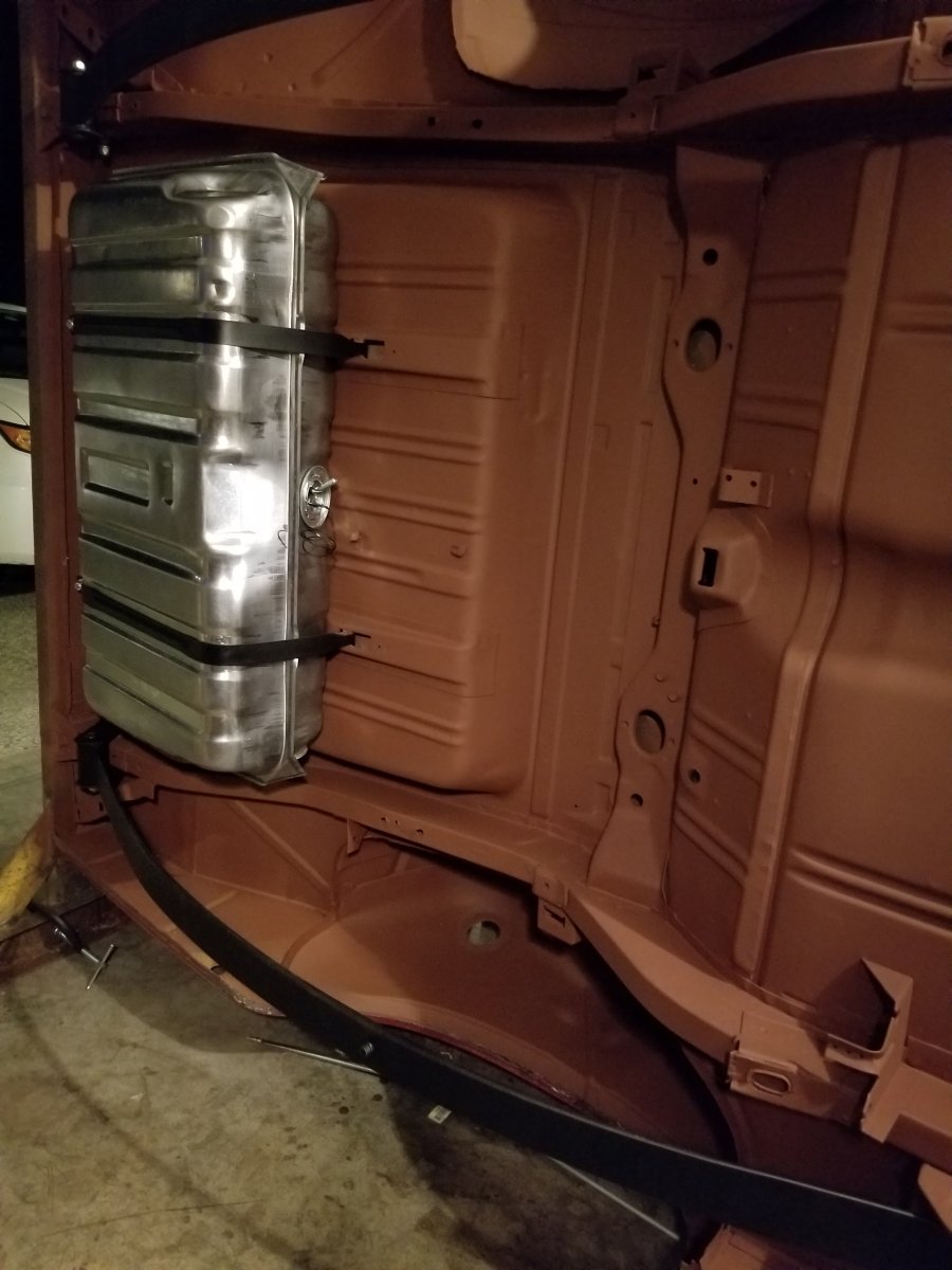

    Well progress being made during this uncertain time. Bushings and leafs are in (still have to monkey around with the front leaf mount and anchor washer - they don't seat well with upgraded polyurethane front bushings). Also got the tank and sender installed, on to brake/fuel lines and e-brake.

    At this point I am finished working on the underside of the 63. Rear brake hose and lines are in, still waiting for delivery of the proportioning valve I ordered. Fuel lines are in. Main e-brake cable also installed.
    At this point I need to flip the car back over, unfortunately with the current covid situation we are following the social distancing requirement, so will have to wait on that.

    Found some time to make an aluminum dash bezel to hold my three cool old stuart warner gauges!

    looking good! btw that three gauge panel would fit right where the radio goes... :)
  26. DanVI
    Joined: Feb 14, 2020
    Posts: 129
    DanVI
    Yes squirrel! I did think of placing them higher up in that space so the gauges would be easier to see. I do have a factory radio delete panel and I like the way it looks and it should clean up well.
