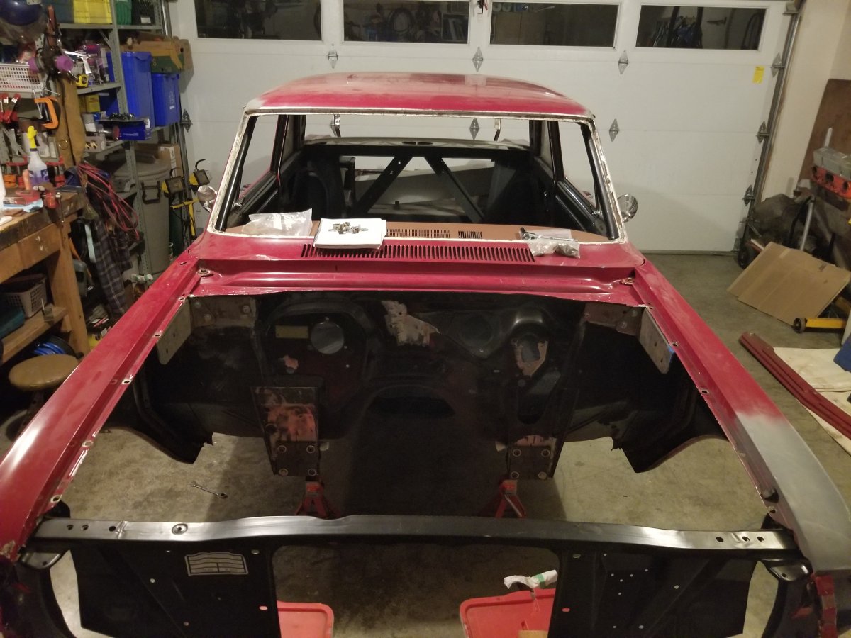

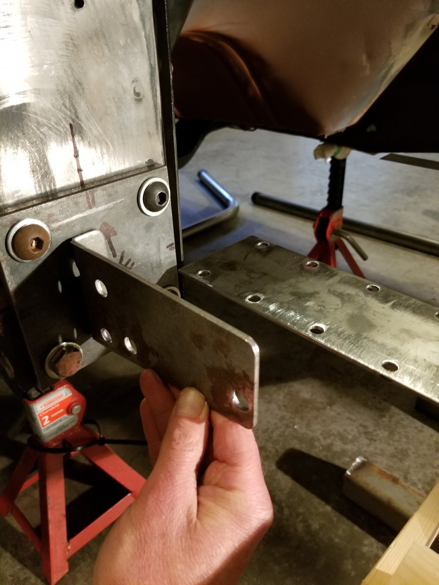

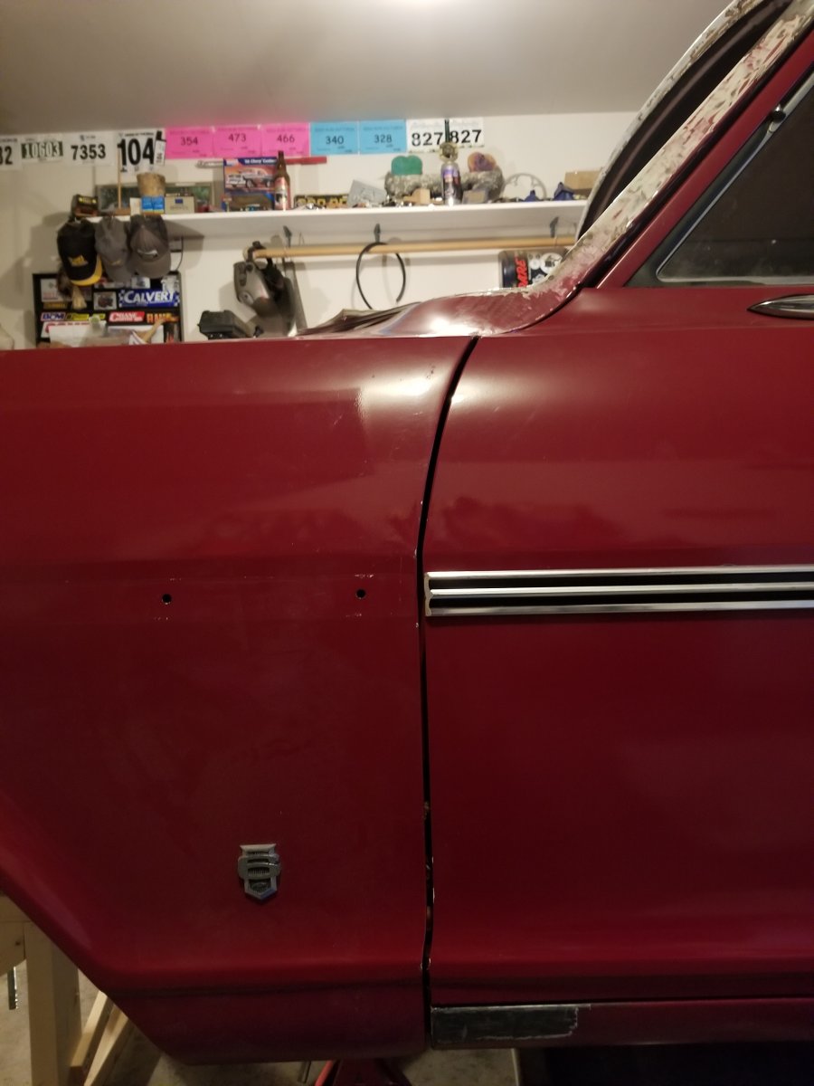

    Spent some time this week leveling the 63 front to back and side to side. I reinstalled the doors and set the gaps, if the car twisted or racked when flipped over I can't tell. Door gaps look great and a few random measurements tell me things look very good. Once I accomplished that I hung the fenders and made a make shift perch for the rad support. I had originally measured the TCI subframe before selling it but I wanted to be sure, things were square and that those measurements worked for my set up. A few tweaks and a lot of scribbled notes and drawings and I now have what I need.
    The front end was taken back apart, I drilled the 1/2" holes in the 3/8" firewall mounting plate which will be the basis of my subframe. Dont mind the black marker lines they highlight the more accurate scribed lines. I continued and built a cradle for the subframe. This has adjustment points on each corner for fine adjustments and to be sure all is level and square. Honestly the cradle took longer to make then it took to get the subframe square and level...... overall I am very happy with the fitment. I will take it all back apart to drill holes to rosette weld the lower plate to the hat channel subframe extensions along with a good clean up of the steel for welding. Progress!

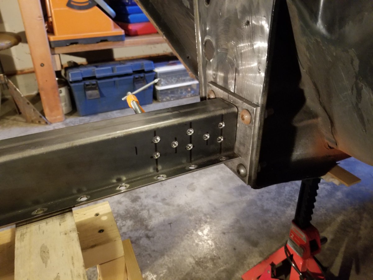

    Well made a few tweaks on the 63 over the last few days. Adjusted the body height and re-leveled it. Drilled a whack load of holes in the subframe rails. 148 to be exact, on two inches centers staggered top to bottom making a rosette weld ever one inch. Should be strong enough!
    I made upper firewall mounts from 3/16 plate. I still need to radius the corner, hopefully that won't take long.
    I also made up two support brackets that will be both rosette welded and perimeter welded to the 3/8 firewall mount. It extends roughly 6 inches towards the front of the car. I will drill holes in the side of the subframe rails to again, rosette weld for added strength.
    The downtubes were purchased and they are NICE!
    I am still debating in my head where exactly I will be placing the cross member. Once I get the subframe rails tacked in place I will likely locate it but not fully weld it in until after the rad support, engine and steering set up are in.
    I still need to trim the fronts of the subframe rails to accept the rad support. Otherwise some serious metal clean up and prep and I should be able to get this this tacked in place soon-ish....

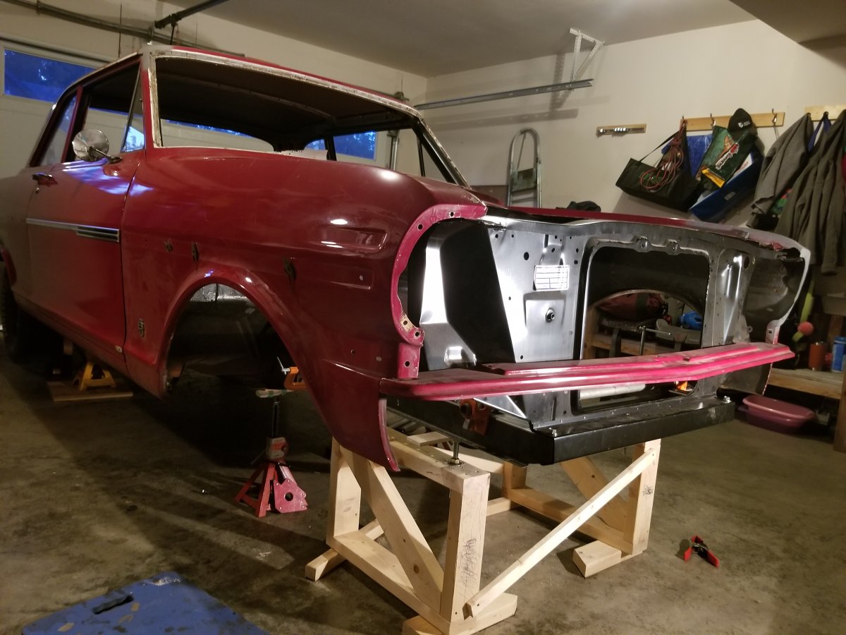

    Still working away. I managed to weld the inner supports to the 3/8" thick lower fire wall plate. Cranked my Miller 175 up as high as it goes. Overall happy with the results although that material thickness is at the machine's limit. I also welded in the rad support mounting nuts.
    With the inner supports and the rad support nuts welded in place I re***embled the front sheet metal to be sure my measurements were correct and all aligned. Much easier to get together being able to bolt and clamp things in place.
    The Fender gaps to the doors look great, I did not install the hood although i took some measurements everything is square and looks like it will fit together without issue.

    Well in a bit of a holding pattern..... waiting for my radiator to arrive so I can confirm the cross member location and be sure there are no interference issues with the lower radiator hose. I think it will be ok but better to wait then have to cut out freshly welded steel.
    I decided to tackle the upper front fender brackets that mount to the rad support. Rusty and almost none exsistant..... I drilled out the spot welds took some measurements and created new brackets, I will add a angled support so it doesn't flex once all fastened together. Otherwise the fit is good.
    Some holes and a little t******* and I will be able to weld em in.

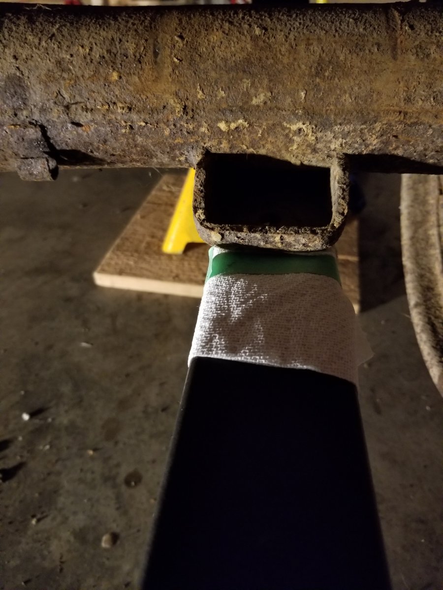

    I have a very cool sprint car axle that had been p***ed along to me, this thing is beefy. I am not sure the wall thickness but I am sure its 3/8", its heavy! I had some king pin bushings machined up to accepts early ford p***enger car spindles. It should work well!

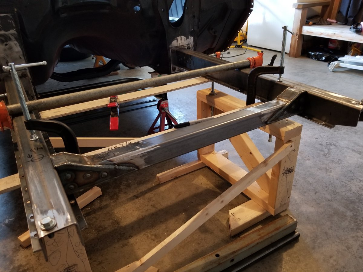

    I managed some time on the front cross member and welded in the "boxes" that step up to the height of the subframe rails. They are a little smaller then I would have liked but this is done to clear the lower radiator hose. The top plate will be welded in place to secure the rails to the cross member and will provide the perfect spot for the tubular firewall mounts which are next on my list.

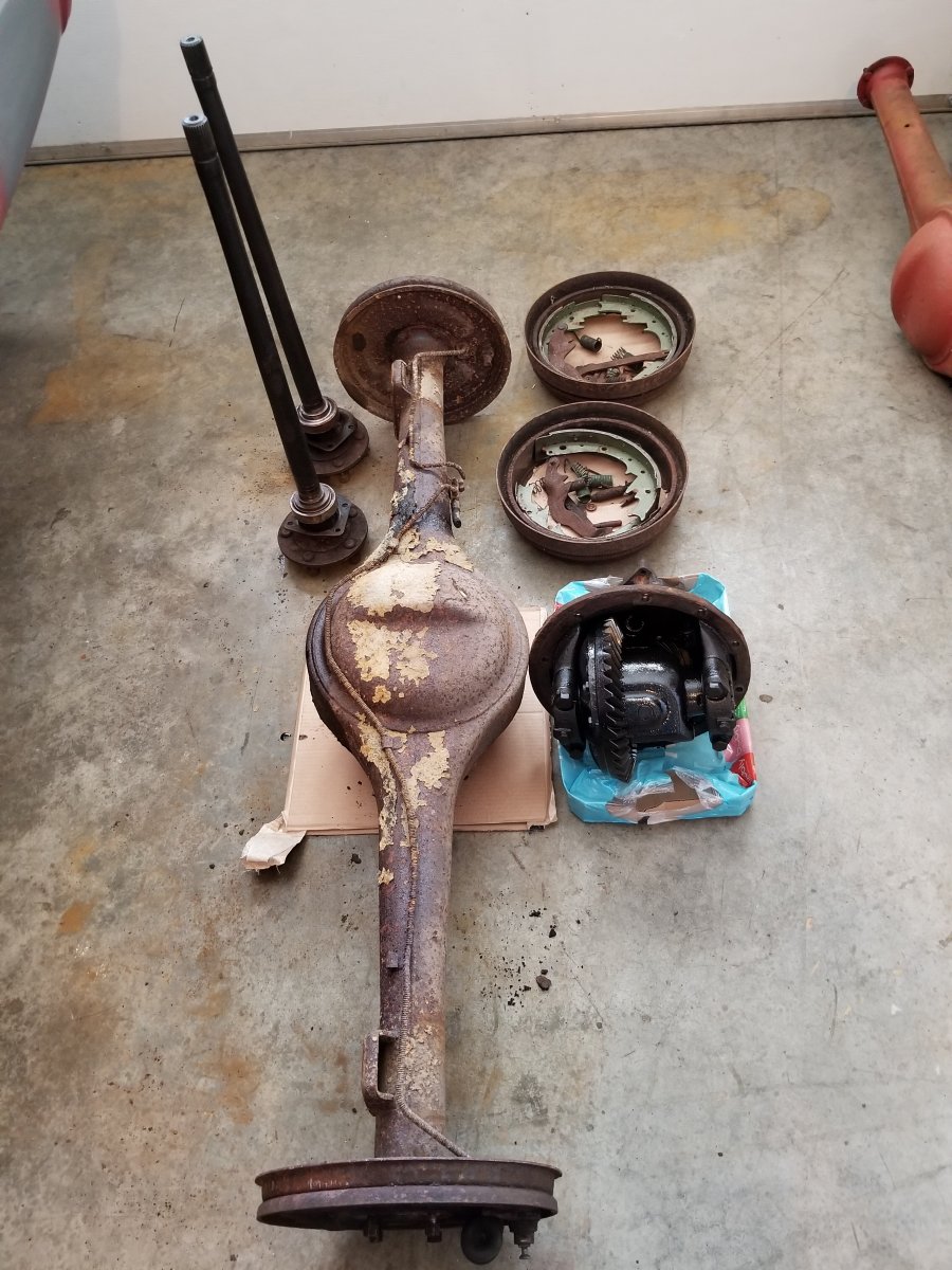

    Well got a little side tracked.......... by a 57/58 Olds diff. I am very excited about this piece! Thanks again to Duncan and YG.
    It is a beast, 9.3" ring gear, 3.42 gears and a m***ive housing. I look forward to cleaning this thing up and getting it bolted into the 63. Oh did I mention the leaf spring axle perches are spot on and it will bolt in! Let's hope the pinion angle is something I can work with when it comes time to install the engine/trans.

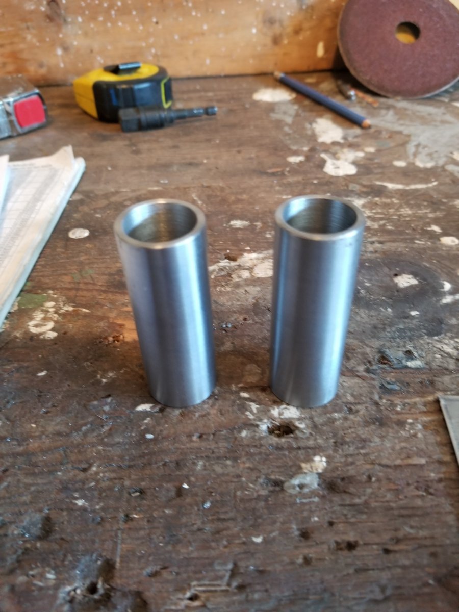

    Still distracted by the big olds..... I tossed it up on the leafs and again it fits good! The overall width is a touch wider the the stock gm 8.2 but nothing the proper offset wheel can't take care of.
    The pinion angle looks at a glance like a number I will be able to work with.
    While I was tinkering on the rear I installed the aluminum/steel bushings I had machined for my make shift cal trac type bars. The aluminum bushing spent a few days in the freezer and squeezed in perfectly. Drew up some template for the brackets I would like to use too. Progress, sorta, slowly..........
