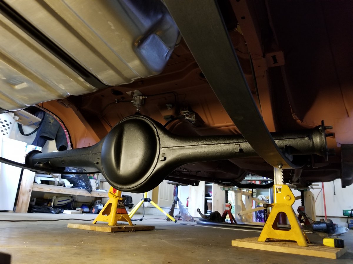

    Well, cleaned and painted the big olds housing. Currently have it sitting in place awaiting a set of u bolts. I think it turned out well. I remade and welded in place one of the 4 brake line brackets but otherwise a thorough cleaning was all it needed.
    With the olds diff I was able to take the original lower leaf spring plate/shock mounts which allows me to utilize the original 63 chevy ii shock mount location and shocks. The plates are heavy duty at almost 1/2" thick, definitely don't make things like they use to! Off to a buddies house tomorrow to cut my traction bar brackets, he has a plasma cutter which will help me trim the 3/16" plate to shape.

  4. Man that housing looks good in there.

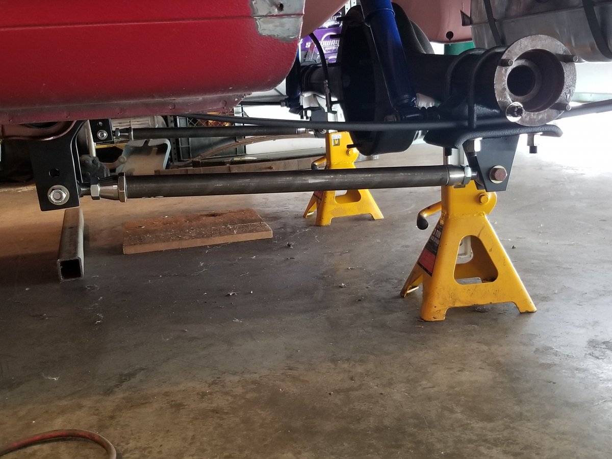

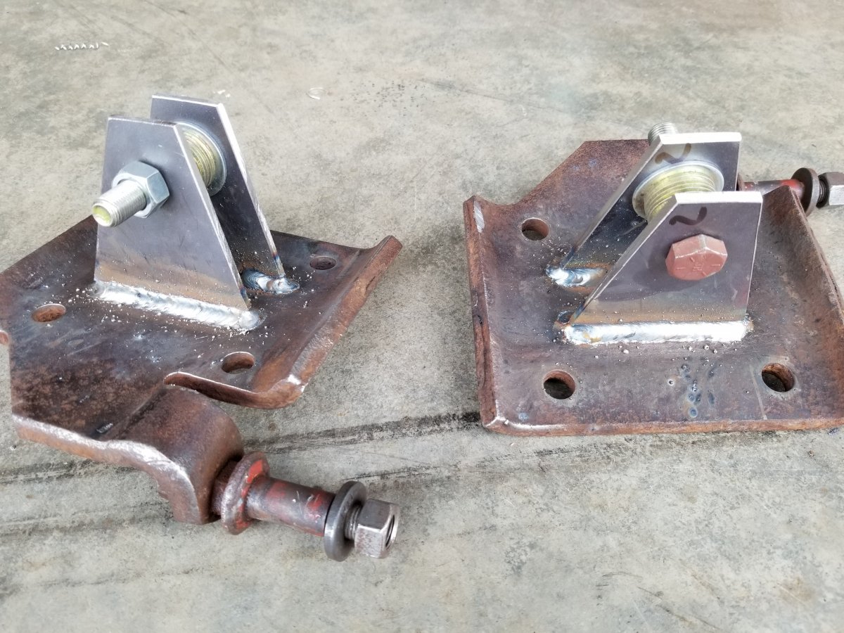

    Spent a bit of time today t******* 3/16" plate to form the traction bar brackets. I tried my buddy K' plasma cutter but no dice, we decided we could get a cleaner cut with a zippy wheel, which made short work of it.
    A little clean up with the bench grinder, and a few drilled holes before I welded the rear mounts to the 1957 oldsmobile shock mounts. Pretty happy with the results.
    I still have some forming and shaping on the front brackets, also waiting for a 1" stepped drill bit I had ordered. Otherwise the traction bars are nearing completion!

    neat design!

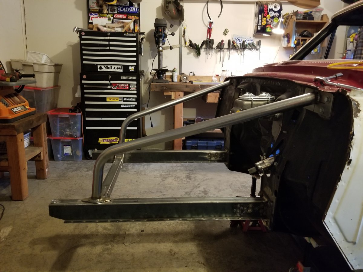

    Well finally thought through a plan for the front subframe...... as I wait on ubolts for the rear end....

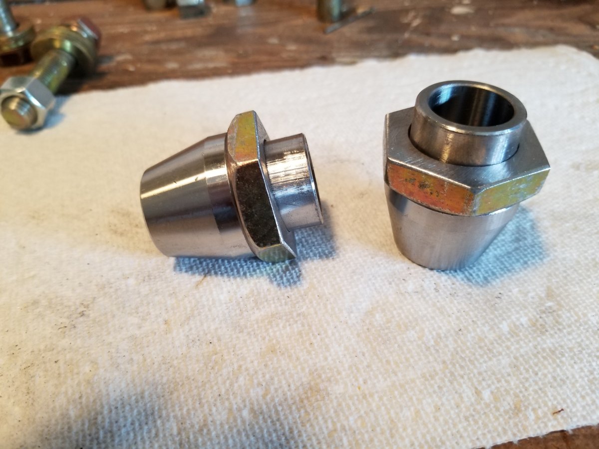

    The traction bars are nearly completely and need final welding once I set the ride height but I cant do that without ubolts which I should have on Monday.
    I split a large 1 1/4" nut in half to use as adjusting nuts on the traction bar arms. Otherwise a couple of cuts once I determine the length and I can final weld and install!
    The front subframe is now partially welded up. I will remove it for finish welding and the lower rail plates. Everything is square and plumb and depending on my set up there is plenty of room to decide on my steering and engine mount location. Progress!

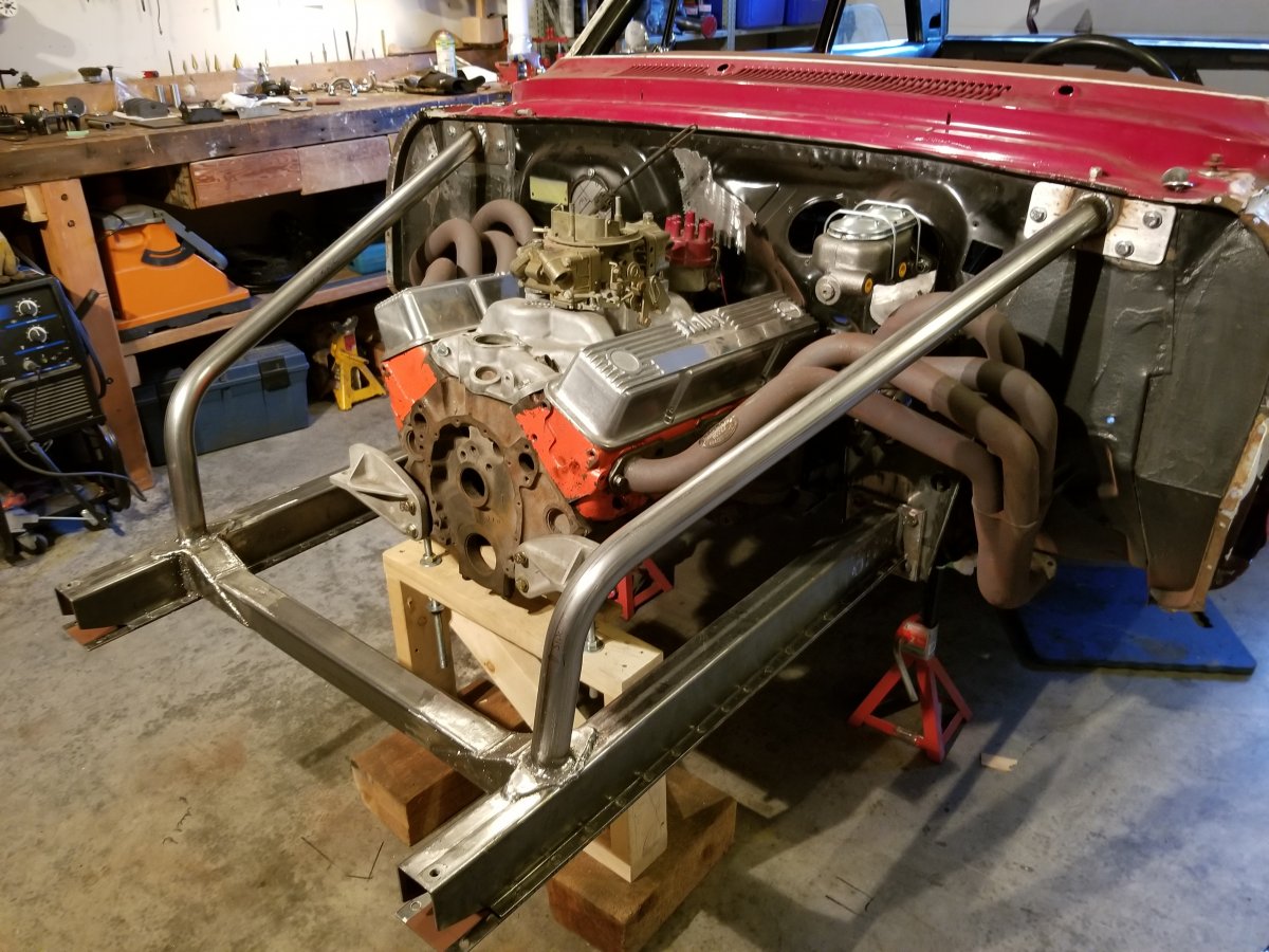

    Today I removed the subframe and finished welding the subframe rails, cross member and firewall downtubes. Nothing wild to report here although I am going to touch up a couple of the less crucial welds once back in place on the car.
    I finished off by prepping and painting the inside of the rails before I rosette weld the lower plate in place.

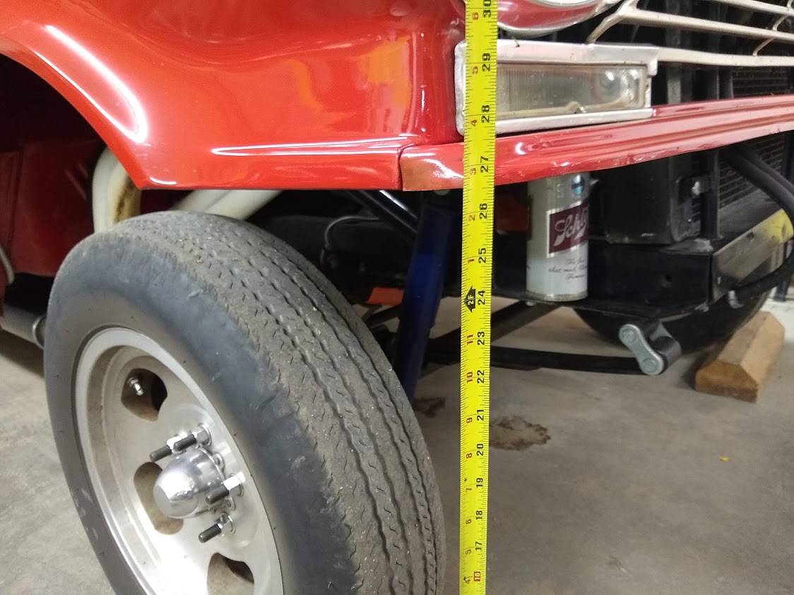

    Oh boy........ dont give me more crazy ideas! Out of curiosity what is the measurement n your chevy ii from the ground to the front fender lip? I am at 32.5 inches (measured inline with the axle) and cant decide if it's to high, to low..... or just right.

    These are 33" eye to eye springs that came with my axle kit from Speedway. I took several leafs out. I don't know exactly where you measured, I guess in the wheel opening? I showed you where I measured, so you can compare accurately.
    If you leave the springs with a lot of arch, it will ride real rough...if they are flattened out most of the way, that means they will give a soft ride, which is nice if you put a lot of miles on the car. And it makes the rear suspension work better if you go racing.
