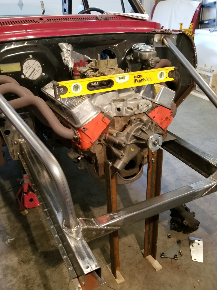

    The stock steering box location, and cross steer, kind of requires the drag link to go through the pan. I think you're on the right path, there...

    A bit of tinkering on the frame engine mounts today. I decided go use the side engine mount set up as it appears to align my steering much better. Chopped up some 3/16" steel and tubing and tacked the upper mount into position. I will work on the angled support tomorrow, the drivers side will be notched to provide clearance for the steering shaft.
    I also picked up some old low back bucket seats from an 80's Ford Bronco. Will need recovering but the price was right!

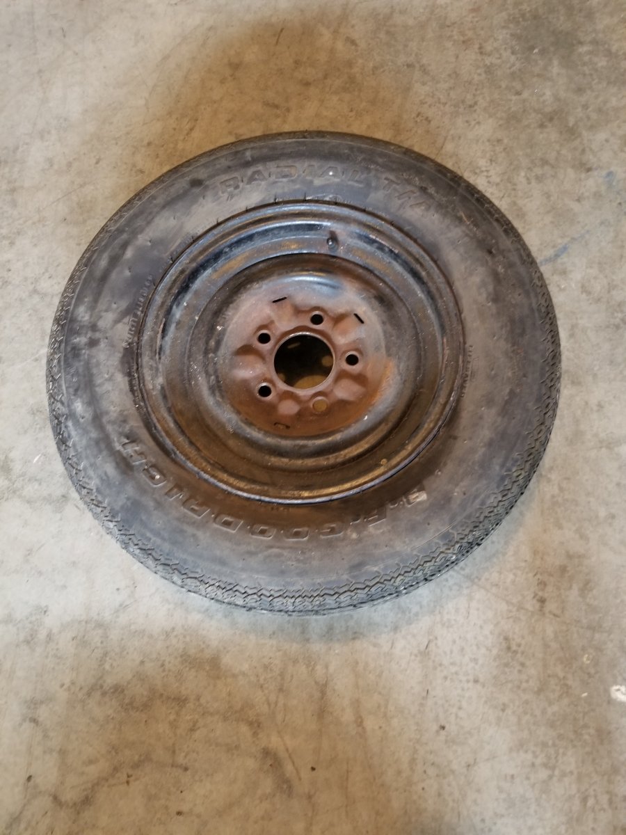

    Well acquired some old school rollers for the 63 today. Old bf g's with a great tread pattern I had mounted to the old Olds steel wheels. Nothing I will use on the street, but they hold air and will be used as rollers. Also got a pair of skinny front tires. Both the front and rear are shorter in height then I plan on using for the road, they are equally short in height so it works it self out down the road.

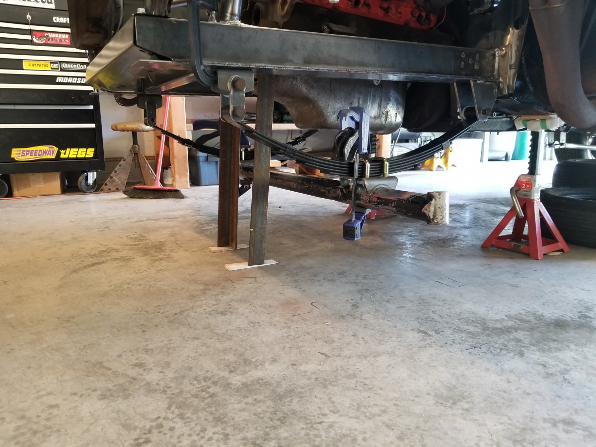

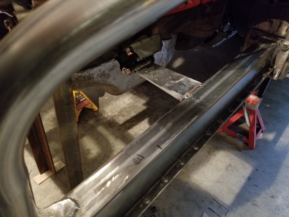

    Been a busy week around the house this week so not as much progress as I had hoped.....

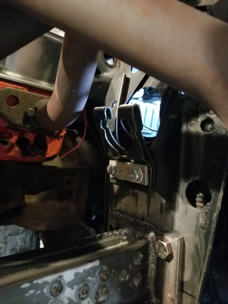

    I cut out and tacked in the engine frame mount support which includes the steering joint notch. I roughly mocked the steering box in position and it seems at this point all will clear well including the drag link when the suspension is in.

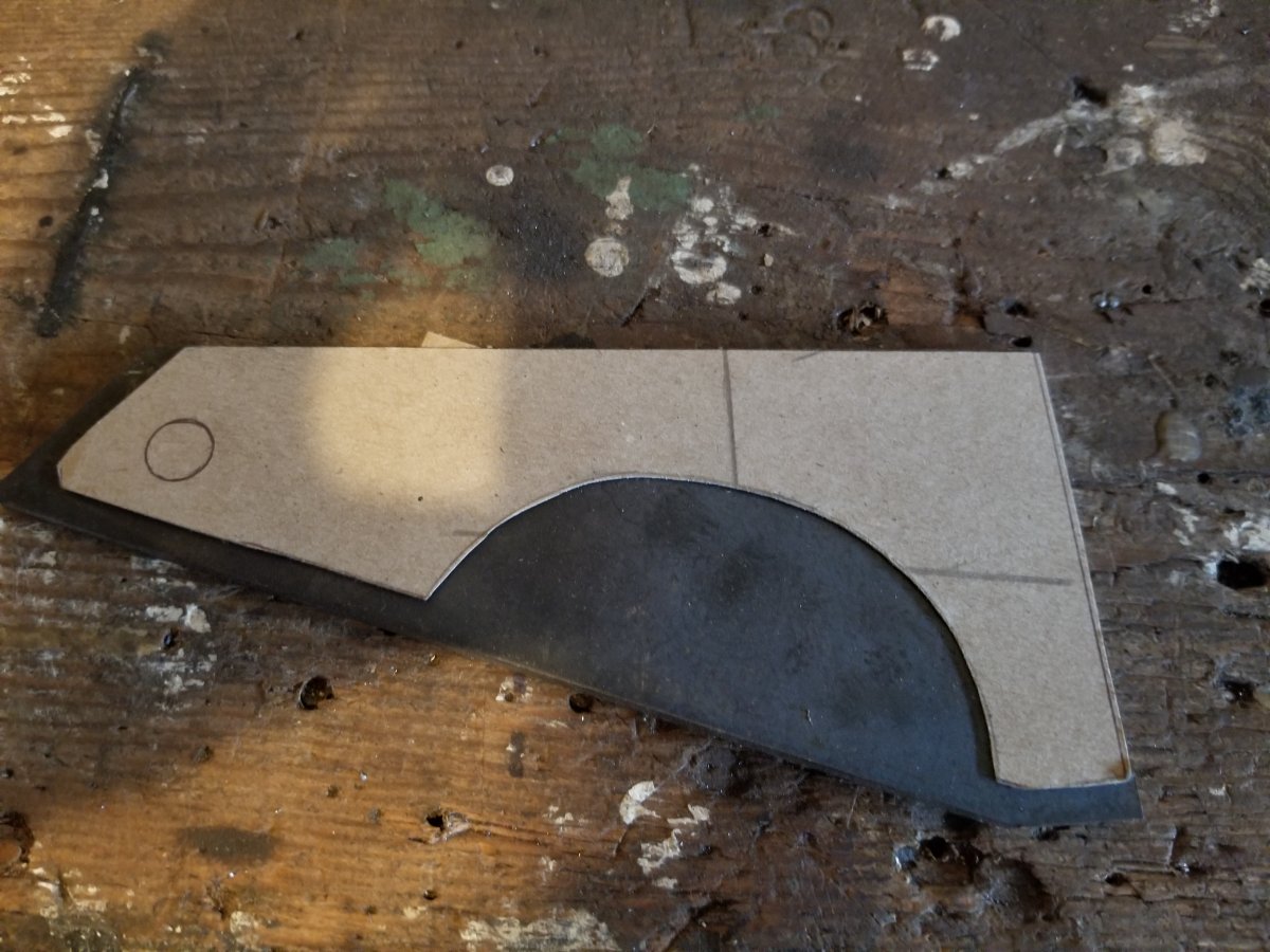

    I also spent some time working out the leaf spring mounts. Using cardboard I worked out the mounting bracket drop and shackle length which gets everything aligned nicely.
    The rear leaf mount will pick up the 3/8" firewall mount further supporting the subframe rails, should be strong. I am ready to tack in the rear spring mounts although that'll be another day....

    Well another busy week...... I was only able to get a small amount of work done on the front leaf spring mounts and shackles.
    Hopefully tomorrow I will sneak some time to get the leaf mounts tacked in place on the subframe....... hopefully....
    Check that. Got some time today. Rear leaf spring mounts tacked in place. Fronts are temporary and clamped for now. All is square and aligned. Tomorrow I will tinker with the tube axle!

  11. Excuse me if I am incorrect here.. But should the shackles go to the rear of the spring?
    I know the CJ guys do it on there Jeeps to help with bump steer and better ride characteristics, When they move the shackle to the rear from front of springs...
  12. DanVI
    Joined: Feb 14, 2020
    Posts: 129
    DanVI
    Nope shackles can go front or rear. Typically Chevy's ran em up front back in the late 60s which is the era of build I am aiming for. This will be the second axle car I have built, shackles up front.
    My understanding is that 4x4 folk run shackles at the rear which allows for better articulation when bashing against rocks and hilly terrain.
    chryslerfan55, loudbang and Thor1 like this.

    Wouldn't front or rear steer dictate where the shackles go?
  14. DanVI
    Posts: 129
    DanVI
    I have read people's thoughts, theories and suggestions on shackle location which as you may know all differ. My own experience is what I draw on, I built a 56 chevy axle car years back, it was a bbc/4- speed car. I used an old 50's chev truck I beam axle and leafs. I ran it the same way I am building this car, shackles in the front, steering box/drag link out front, tie rods behind the axle ensuring that everything is parallel to the axle and level to the ground. The 56 had zero bump steer and I could cruise that car along the hwy at 100km/h all day.

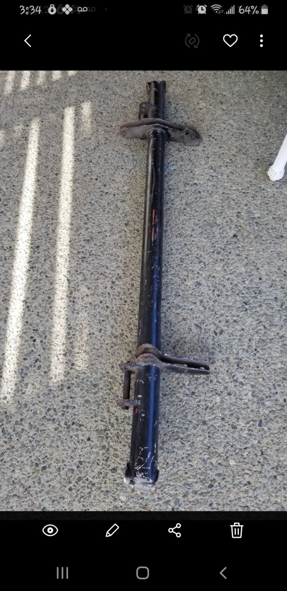

    Well I spent some time today on the tube axle. It's an old sprint car axle and needed to have the brackets removed............ it took waaaaaaay longer then I expected. First I cut the brackets off, ground a portion down with a grinding disc before using a flapper wheel. The remainder was done by hand with a file. The results are good. Still some more filing but very close.
    I hope to keep the original paint layers and chips on the axle and will try and match the areas I cleaned up for the axle pads.
    Otherwise I trimmed the axle pads to fit the larger diameter, 2 3/8" axle tube. I am not overly happy with the fitment so a bit more work is needed.

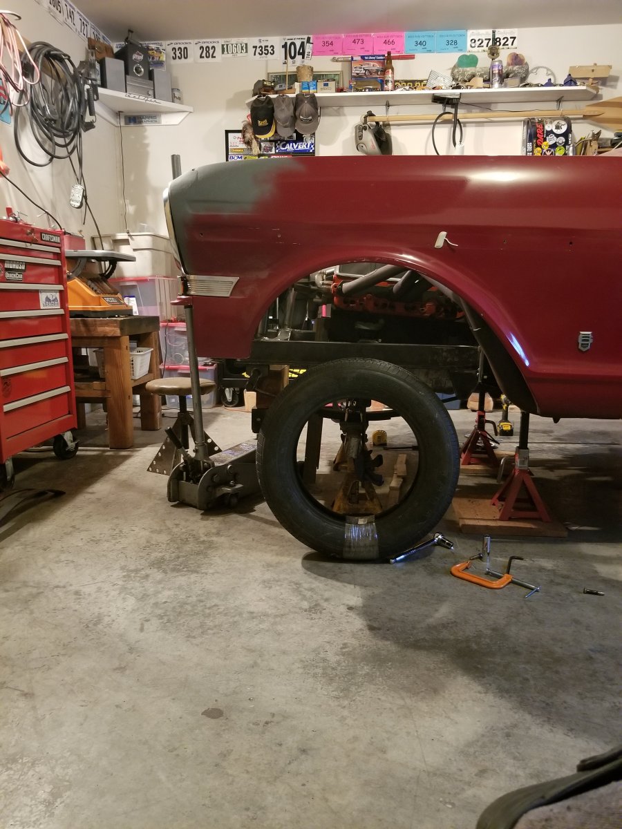

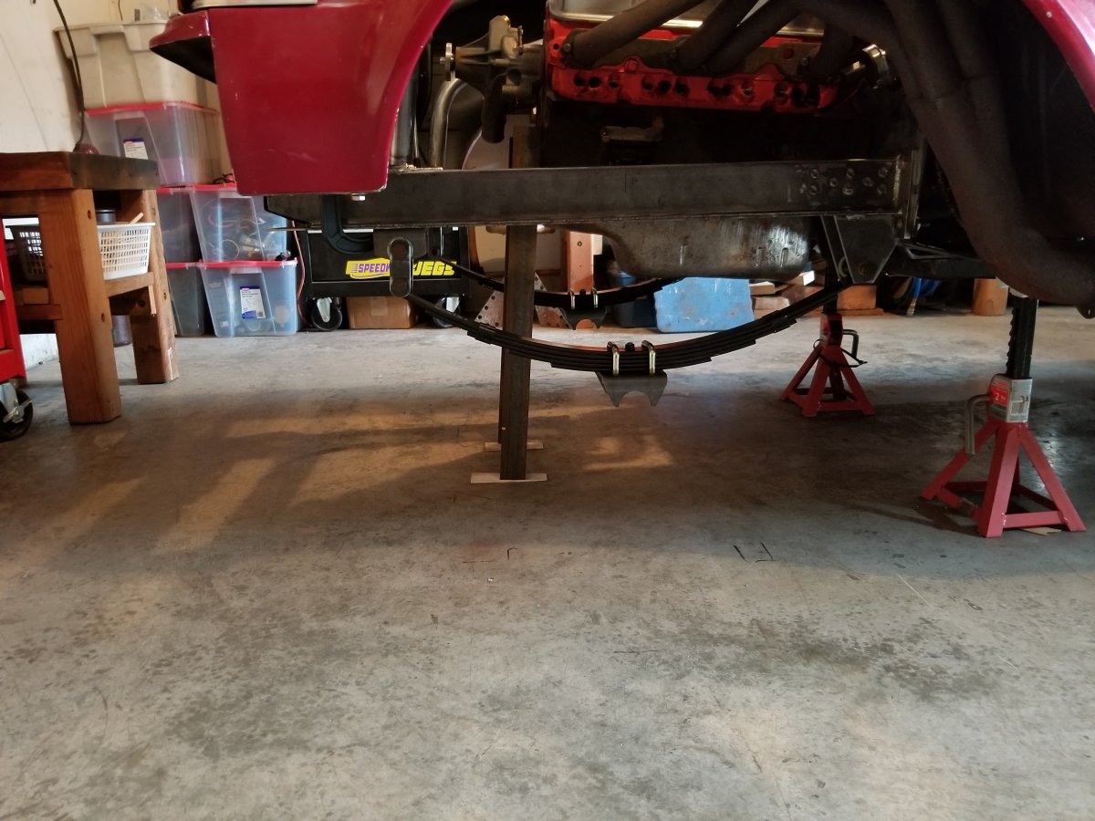

    Well pretty sure this is what people call a street freak........lol (the pictures are deceiving, it's up there!) we are about 4 inches taller then I had hoped. I kinda knew this would be the case though. With some tinkering and adjustment with the spring pack I am about 1" away from my target height, this is with about 100lbs packed on the nose to compensate for the radiator, bumper, hood, fluids and such.
    I think with some adjustments including lower profile spring perches and replacing the temporary shackle mounts with the one I made, I should be very close......... to be continued!
  19. squirrel
    Joined: Sep 23, 2004
    Posts: 61,018
    squirrel
    on my Chevy II, I took out leafs until the springs were almost flat. It works great. Give it a try. Although you might have the shackle mount too far back?

    Yah I have removed one as well. The leafs are relatively flat and that last pictures is unloaded so they do flatten out more. I am using temporary front shackle mounts so I can clamp them in place, easier to move vs the weld, grind, move weld method.... should have er pretty close soon enough.

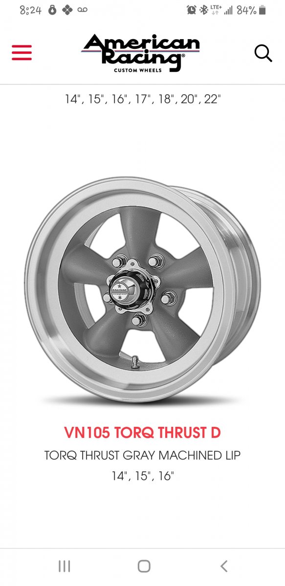

    Well I managed to get the 63 down on its four wheels today, despite incorrect parts sent from Speedway. My GM disc brake conversion kit included calipers brackets for a ford F150....... besides that everything else was correct.
    I am extremely happy with the stance and placement of the wheel in the fender opening. Oh couldn't help myself and ordered two american racing cast finished torque thrust d wheels 15x4's....... on to mounting the shocks!
