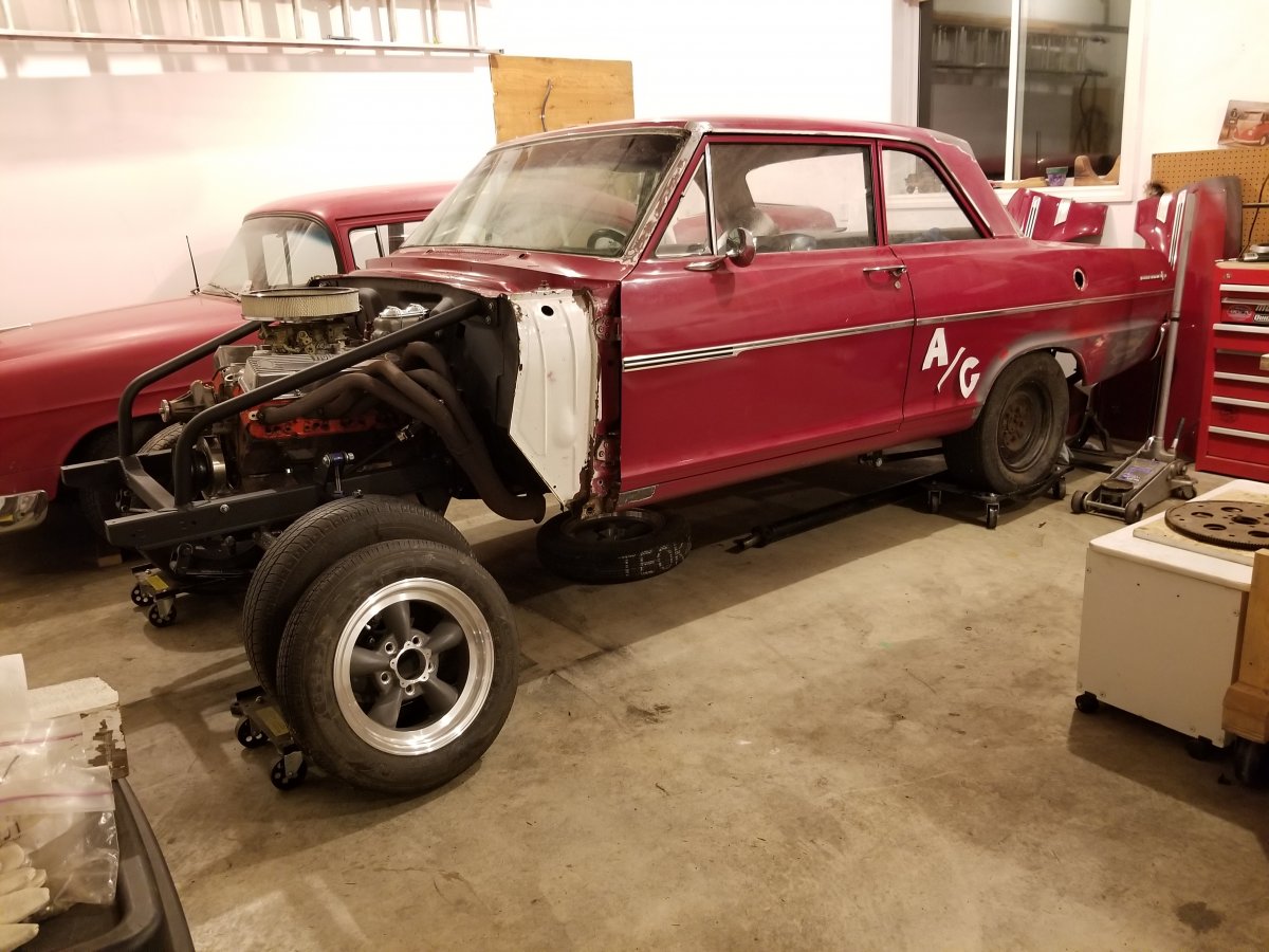

    Finally managed to get moved. A nice three car garage with 11' ceiling height. A heck of a lot more space thankfully.
    Had the 63 towed on a flat deck as my new home is not far. Best part is that I saw the 63 out of the garage for the first time since building the front subframe, to bad the trunk was filled with heavy parts bins and sitting low.
    Overall the transport was a success and best of all it didn't rain!

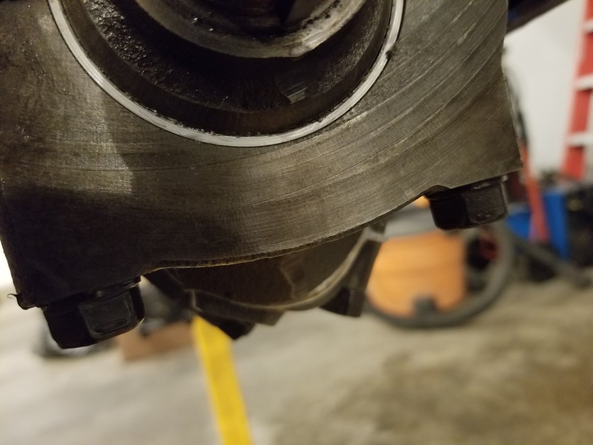

    Since my last post the lifter situation has been eating at me. I can't help but think there has to be further damage to the internals.
    I very closely inspected the short block after removing the timing set, cam and lower timing crank gear. First I noticed a lifter retainer spring in the cam bearing oil gallery. Second, behind the crank timing gear a few very small metal shavings. This prompted me to remove the main cap finding significant damage to both the main bear and the the crank.
    I am glad I found the damage and I am also frustrated and mad at the sellers deception/me taking his word. I understand buyer beware but what happen to the days where you can take a person's word.... long gone I guess.
    I will not be doing this again. If it takes me years to build my dream engine so be it.
