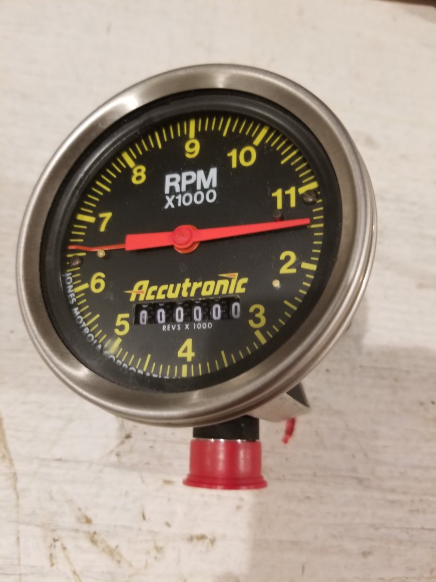

    Found this very cool Accutronic 11,000 (11,500) RPM mechanical tach!
    I can't seem to find much internet information on it. The older fella I bought it off of said he purchased it new many many years ago and never ended up using it. Been sitting on his shelf since.

    cool! That's a rebranded Jones Motrola tach. There is some info out there on them....somewhere...
    they were most commonly sold as Moroso tachs. When you're searching for a cable for it, you'll probably be better off searching for a Moroso tach cable.
    I had one like it in my car for a little while, but it wasn't new, and it had some issues.

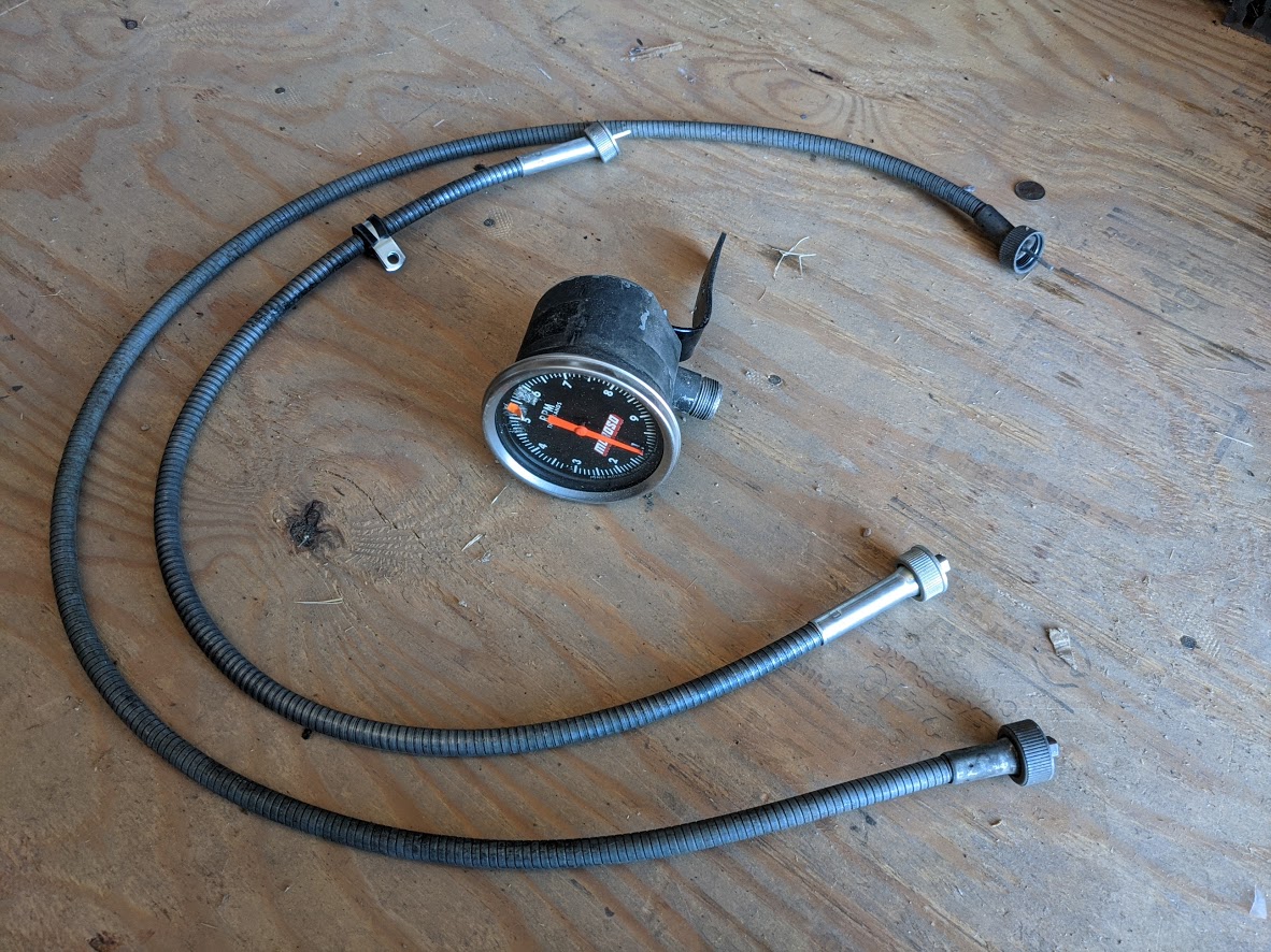

    took a few minutes to find the box, but yeah, I have a 3 ft and a 4 ft and a sticky Moroso tach. The cables have the small square end, which was used on OEM chevy distributors in Corvettes, but some aftermarket distributors use the round with a tang drive.

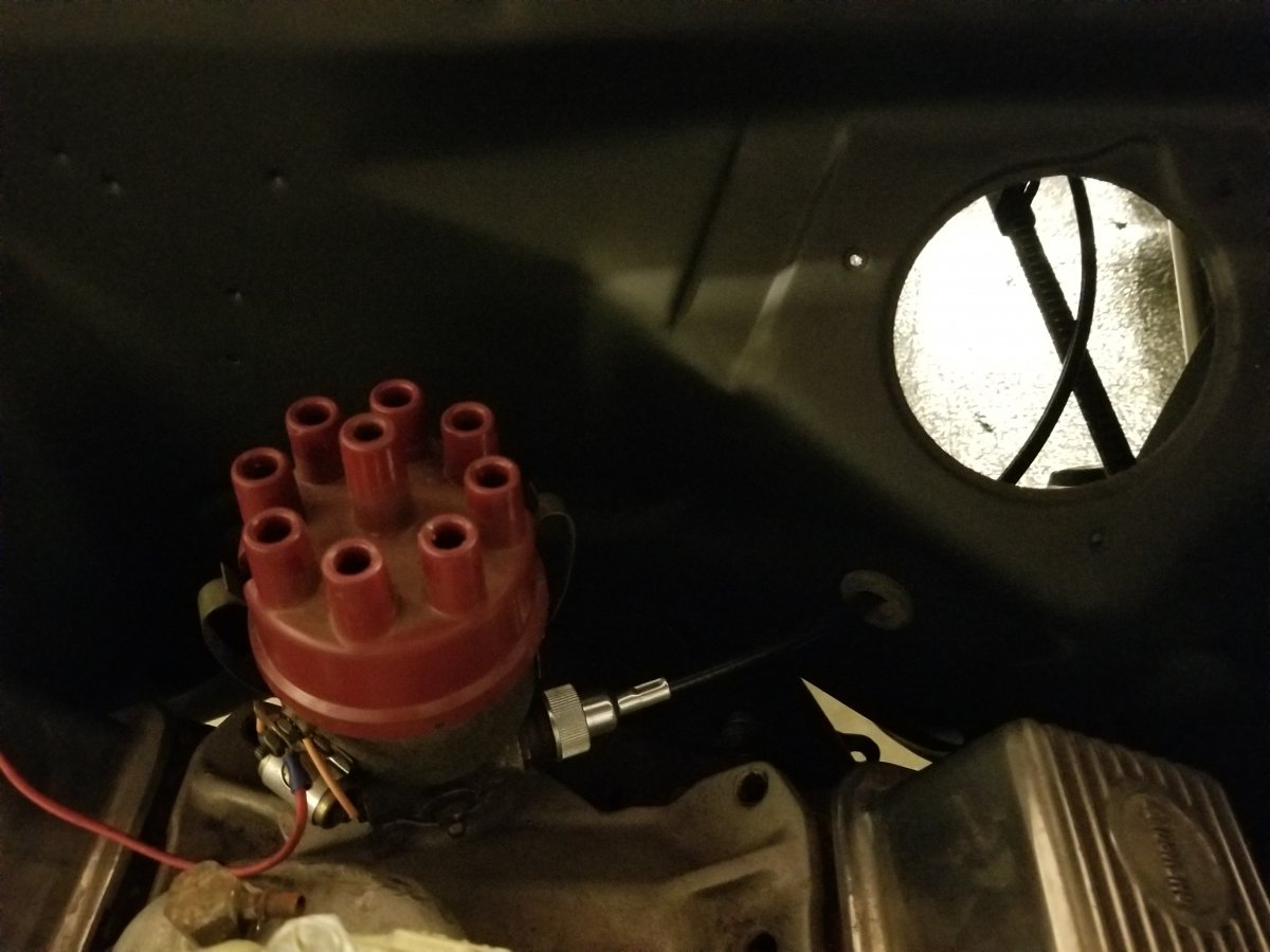

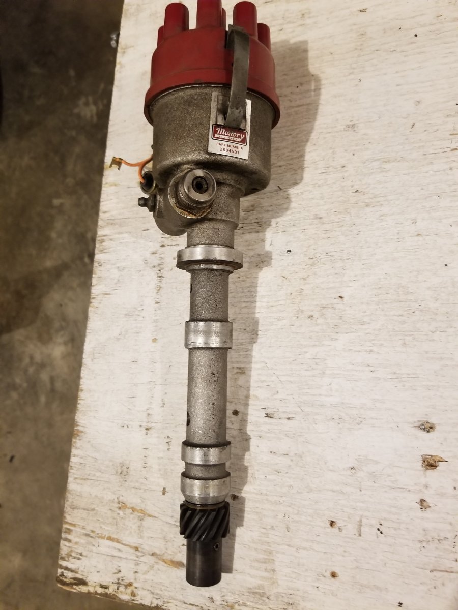

    Very nice squirrel. I found today, honestly by chance...... I was "working" today. A Mallory tach drive distributor. It has the small square end.
    loudbang, mad mikey and Thor1 like this.

    I think that's the same model I have in my car.

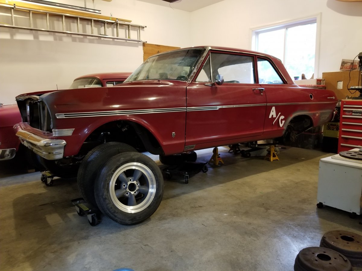

    Nice build Dan, here is a 'era-correct Chevy II.
    Also, when you load your pictures hear you can select the LARGE image which makes seeing your pictures way better for all of us.

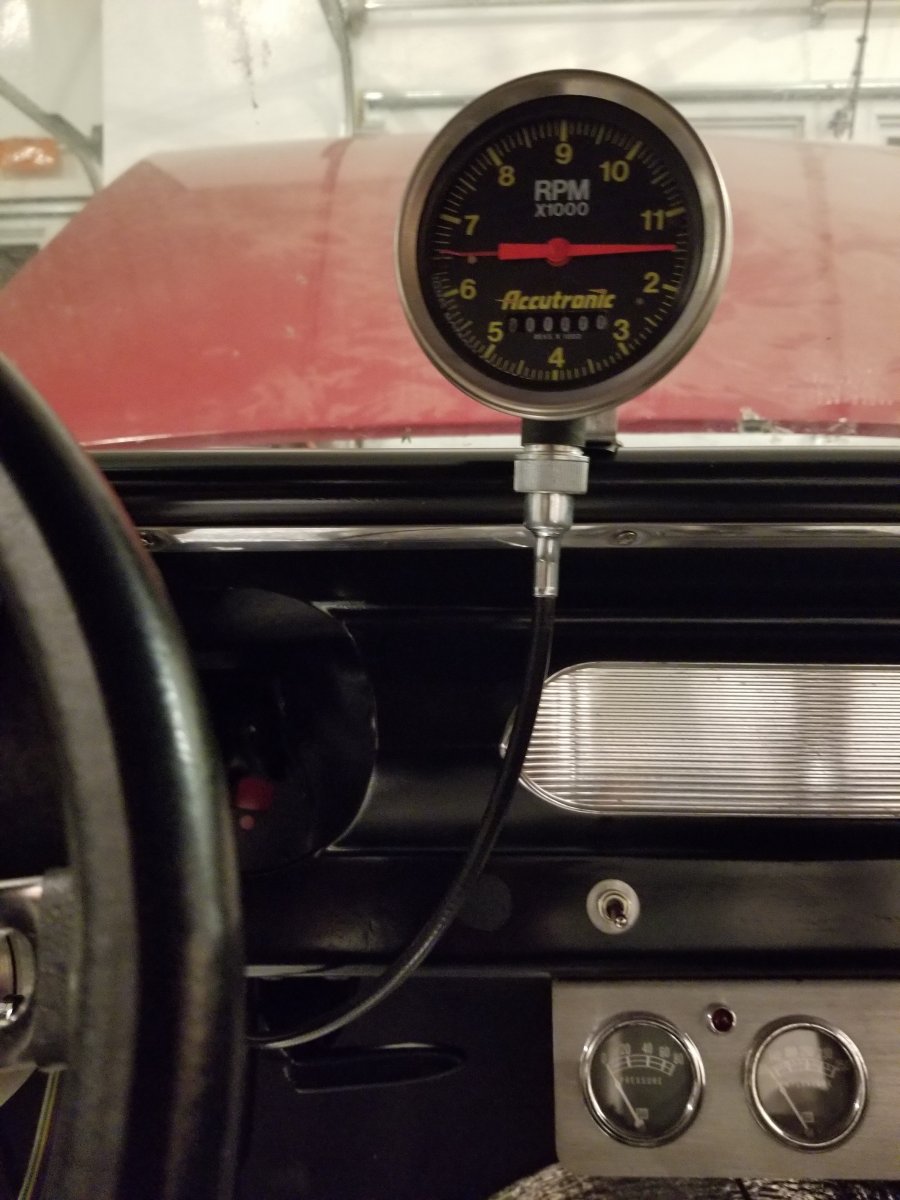

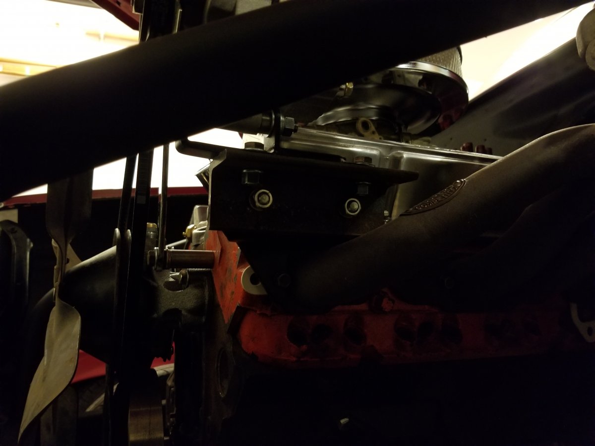

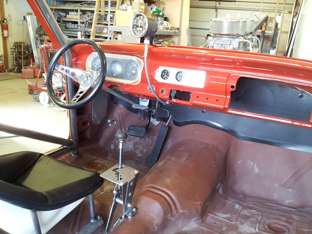

    Spent a late nite tinkering in the garage.
    Mocked the sheet metal (hood maybe later today) back on the car. Did this mostly to free up space in the garage. Hopefully later this week I will finalize the front fender mounts but otherwise everything seems to fit well.

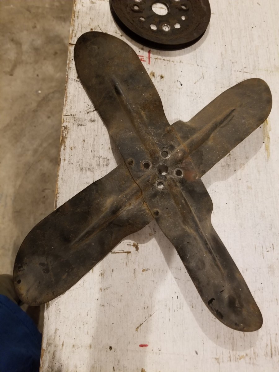

    I did some auto wrecking picking a few days back and found a single groove short water pump pulley and single groove crank pulley. Other then tracking down an alternator bracket the pulley location and fitment are all worked out. Honestly I am glad..... usually (for me) tracking down pulleys is a pain..... I have mocked in an original 4 blade GM fan which I will either space closer (combined with a shroud) to the rad once installed or keep in place along with a big ole electric fan. I want no overheating worries on this ride.
    I mounted the tach and measured the length for the cable. I will get that to e1956v tomorrow.

    Check that fan closely for cracks, I have had them break off and go threw the hood.

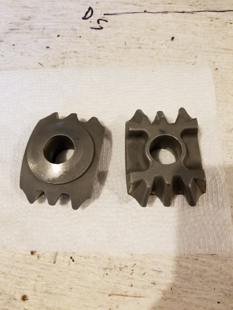

    Been a bit since I posted. Mostly waiting on some parts so in the mean time took care of a few random items on my list.
    I removed the turbo 350 transmission kickdown and made a plate and gasket cover for the hole. Since I had the pan off to remove the linkage I replaced the pan gasket and filter.
    I did pick up my newly balanced driveshaft. Good thing I had two in my shop because the first one I took could not be used. It seems a driveline shop attempted to straighten it in the past.... to far gone.
    I did finish (sorta) off the fan belt routing and alternator mounting location. I thought I had this worked out but I didn't...... not enough adjustment to tension the belt - due to the subframe firewall bar. Using a piece of s**** angle iron I made a mount to raise the alternator. It worked perfectly and there is enough swing to both take off and tension the belt without issue. Now that I know it works I will make a nicer bracket.
    One of the pieces I am waiting on are Ansen lock blocks for the big Olds. The third member is cleaned, painted and ready when they arrive, hopefully later this week. I will install the blocks, get the third member installed and fit the driveshaft. Not sure why but excited about that.

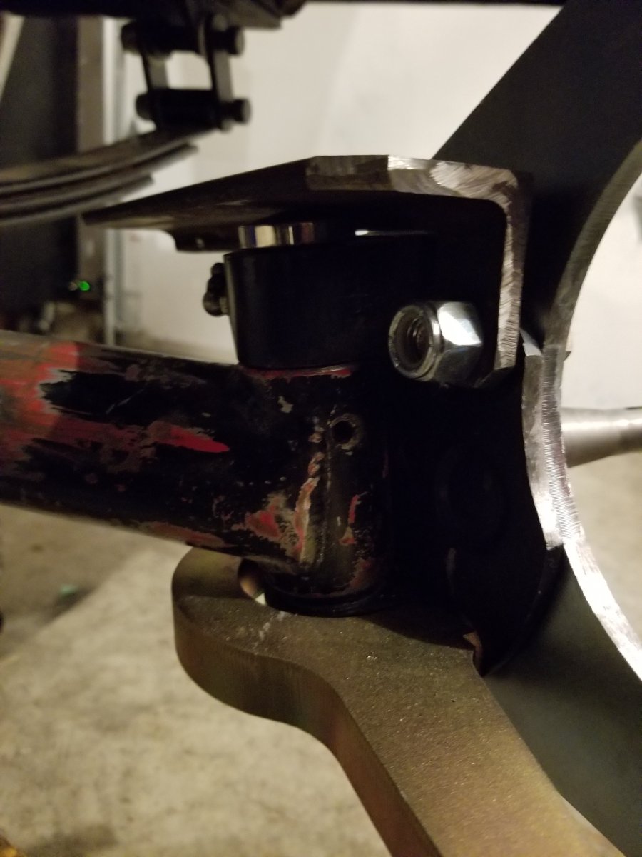

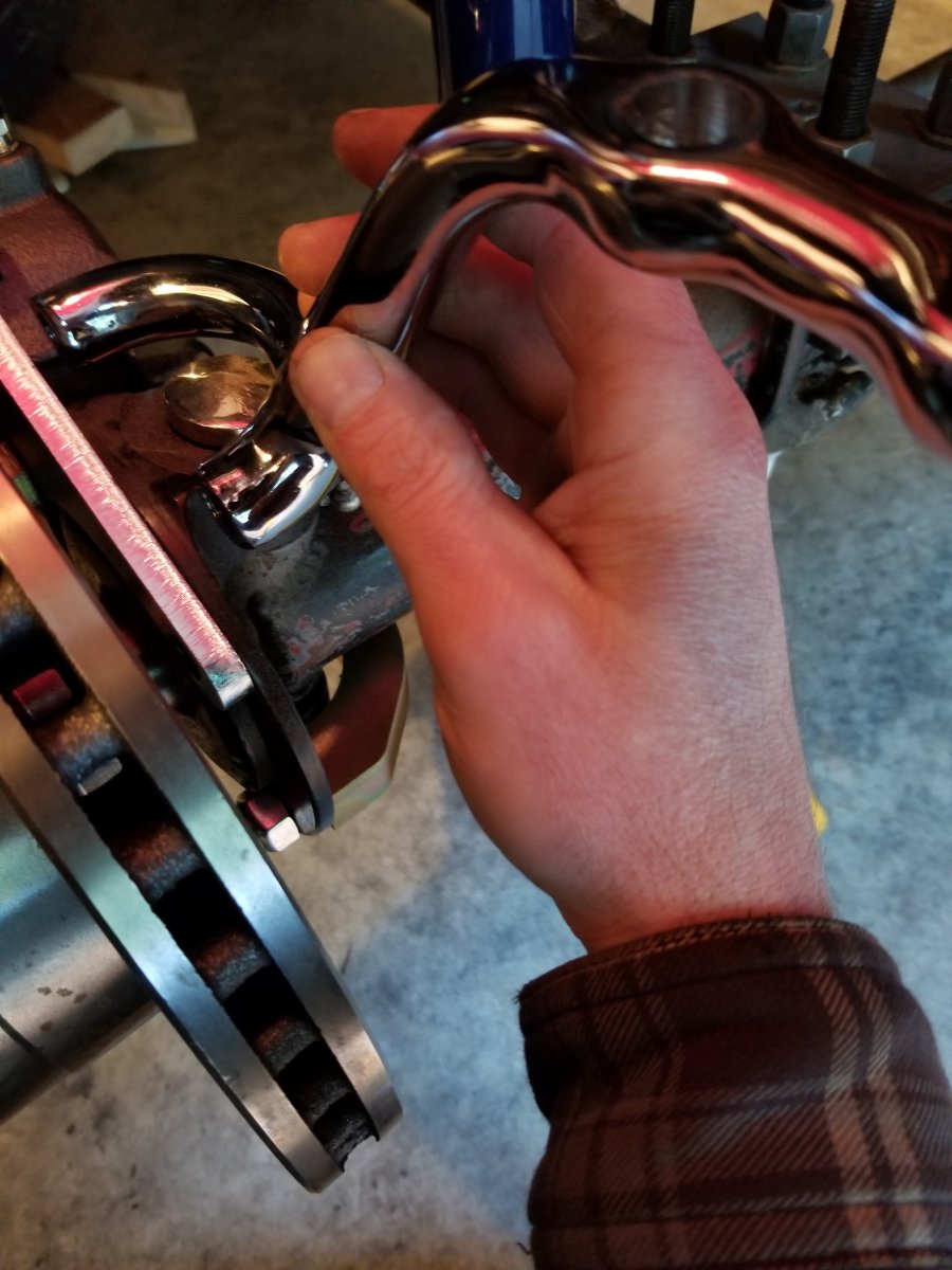

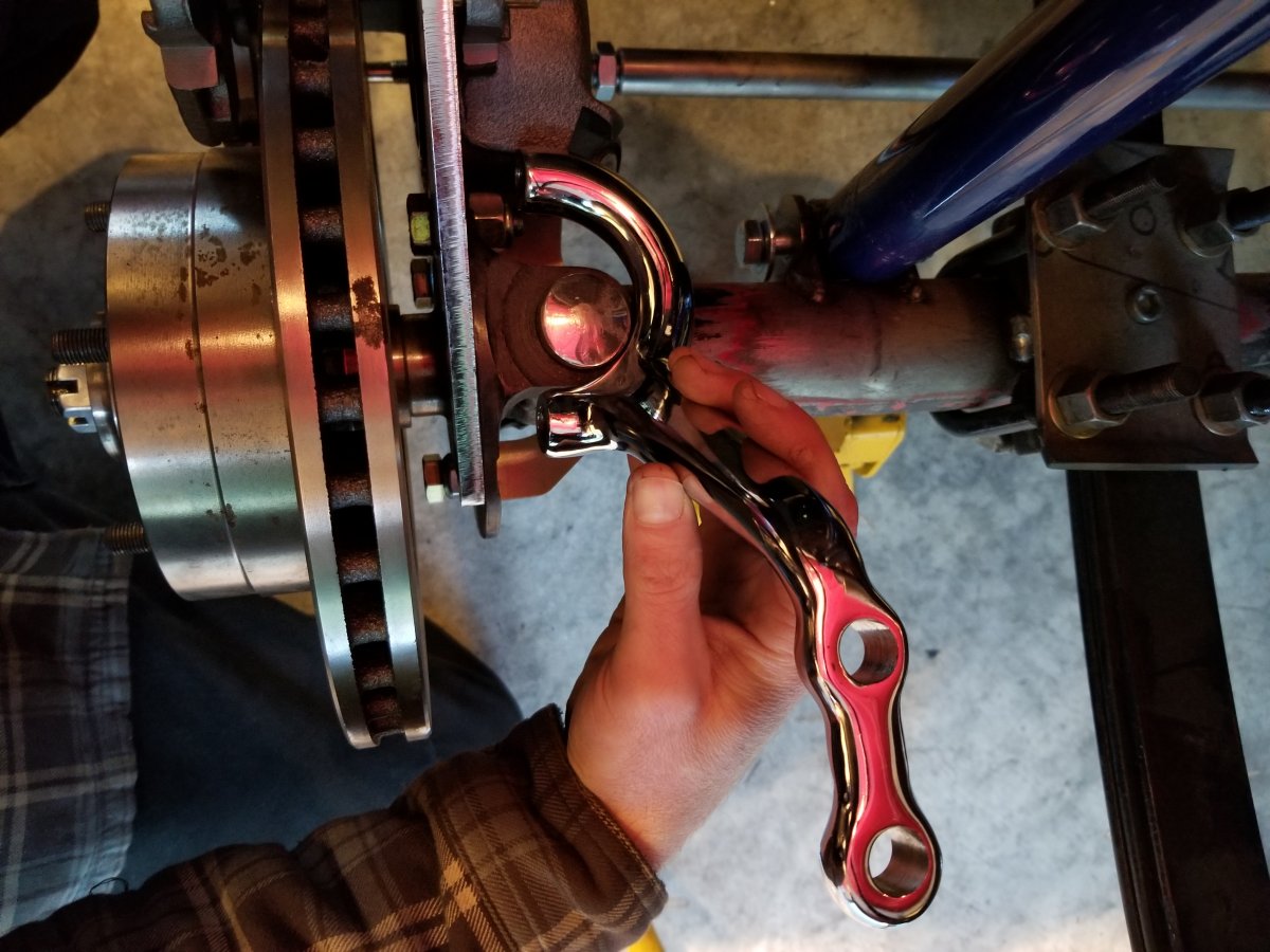

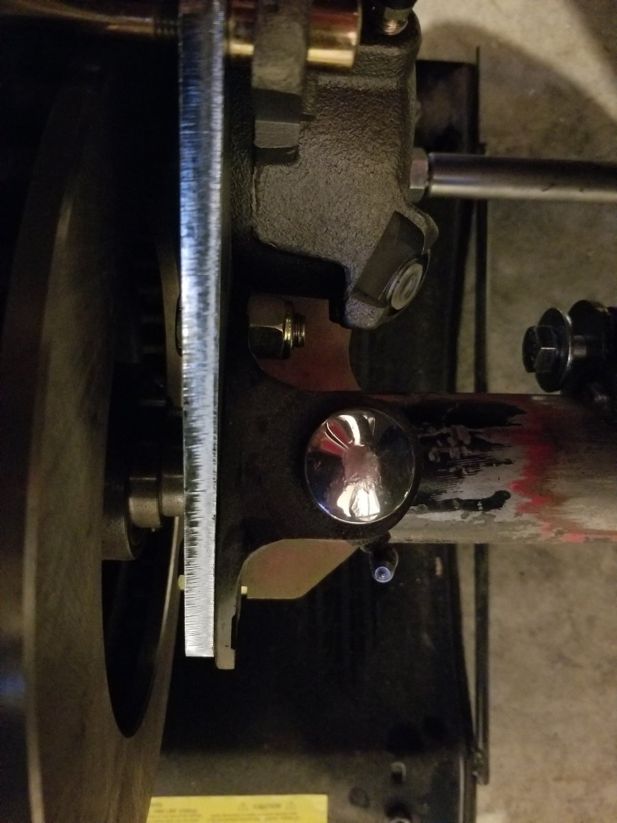

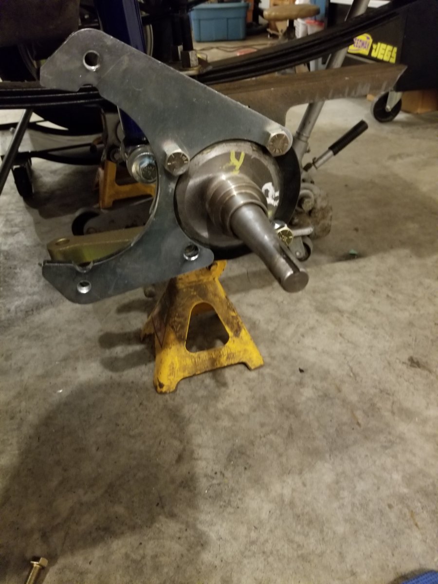

    So today received a few parts I had order a while back. The local hot rod shop has been..... while a pain in the *** to deal with. Great on the phone but there follow up is pretty bad. I moved, they failed to update my address. Parts get shipped to my old house...... not to mention I received parts for a ford 150 brake conversion instead of my gm brakes to ford spindles......... anyway back on track.
    I ordered straight steering arms, tie rods and link, and tie rods and drag link. Got everything together which was a bit like putting together a puzzle. All had to be ***embled loose due to the brake caliper lower bolt interfering with the steering arm(that's my bad). Once everything was loosely ***embled I ackwardly tightened everything up.
    Initially I was going to use an old 3 3/4 drop steering arm flipped and pointed to the front of the vehicle, mounted using the top holes on the p***enger side spindle. It does not seem like it will work, for two reasons. The mounting bolt arch (steering arm) is not large enough to go around the upper spindle king pin mount (I figured spacers could resolve that issue), and two the brake caliper hose mounting location is completely in the way.
    Anyone out there have thoughts on that. Seem awfully tight quarters, something I did not anticipate.
    I know speedway does a g***er ford spindle steering arm although when I look at the pictures online the caliper is very different and there appears to be alot more room. Possible a flat steel steering although the arch to fit around the upper king pin mount seems small. There is a way I am sure just not seeing it at the moment.....

    I think I figured a solution..... I think...lol
    Using a piece of 2" x 2" x 1/4" angle iron I trimmed out a steering arm similar to the flat arms available at Speedway.
    The material is not a thick as the Speedway arms but I will address that in three ways, plate the bottom edge of the longer portion, gusset the two spindle mounting tabs, and I left a portion (greater then 3/8") of the "angle" to further add strength along the length of the arm. I do believe it will be plenty strong.
    Thanks to Hamber: Duncan for p***ing onto me a forged tie rod bung which I plan to flush mount/weld with the top of the steering arm. The tie rod will insert from the top.
    On the pitman arm side I need to ream to a 7 degree ford taper. It will mount from the bottom.
    Having the tie rod sit low into the steering arm along with the correct taper on the pitman arm I do believe the drag link will be close/spot on? parallel with the axle.
