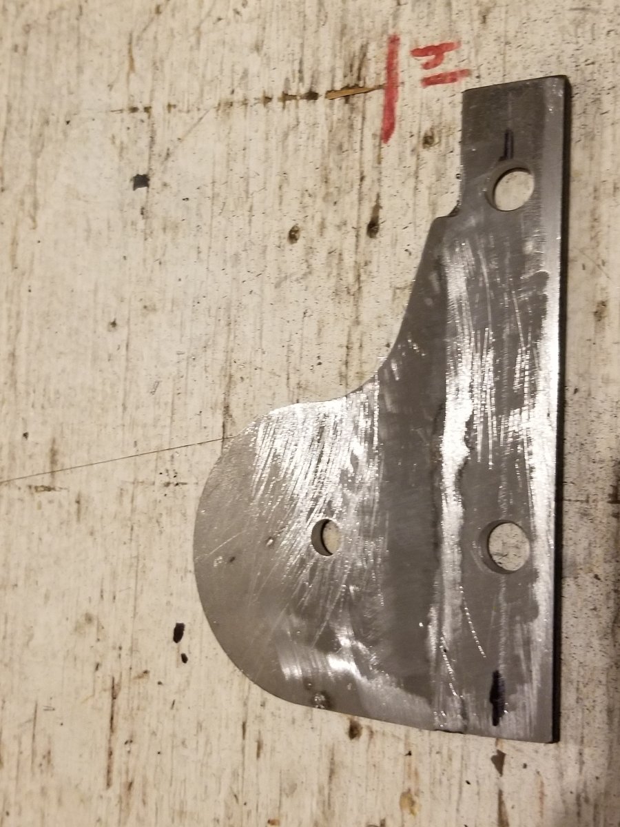

    I need to hit the store for some fasteners and a piece of plate for the alt bracket so since its sunday and most stores are closed I decided to finish off the front fender brackets and install the front end trim components. All fit together well, minus a few trim screws.

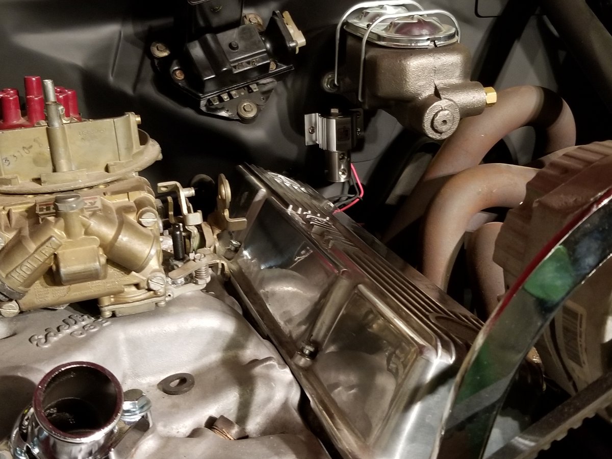

    Instead I decided to finish running the brake lines. Not my favorite job but has to be done. I first started by picking a location and mounting the Hurst roll control. Then began running lines from the master to the roll control and also to the bottom of the firewall where I will connect to the rear lines I ran a while back.
    The pictures look deceiving. Between the header and the lines there is about 1" of air space all around the lines. Trying to decide if that is adequate, if I need a heat shield or if I need to use a heat protective wrap on the lines themselves. Also, unsure about the lines themselves, they were recommended although they seem soft compared to other lines I have used. Will research that too....

    I think I would have gone straight back to firewall then turn to the roll control. The lines might get too hot as they are. Insulation would be a good idea. Nice build, will make a fun car.

    Thanks glrbird. The pictures are deceiving. The number 7 header tube extends up higher then the master cylinder outlet ports. That is the reason I made the quick bend in the opposite direction, or at least the tightest bend my westwood tool allows. Lol. Enjoy

    I just mean by going down it looks like the tubes are getting heat from two header tubes. Just saying.

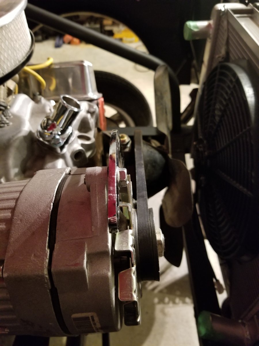

    I did spend a bit of time relocating the alternator to the p***enger side. I will say, it has not gone as smoothly as the driver side installation. It starts with flat bar picking up the header mounting bolts. I currently have it mocked in position, it is close but still requires further alignment. Once I have it perfect I will trim out the brackets to a nice shape.

    I took a bit of time to work on the alternator bracket mounts and alignment. I used a straight edge mounted to the water pump fan mount to base measurements off of and an angle finder to be sure the pulleys are set square to each other. Overall the task was not difficult although when I step back and look at the belt routing something seems off, my measurements tell me it is very close if not spot on. I think what is drawing my eye is the water pump and the alt pulleys are shaped differently in that the v-groove has more material at the front then the back of the pulley itself. I still have shaping and reinforcing to do on the brackets but for now I will keep it mocked up and eye it everytime I work on the car.....

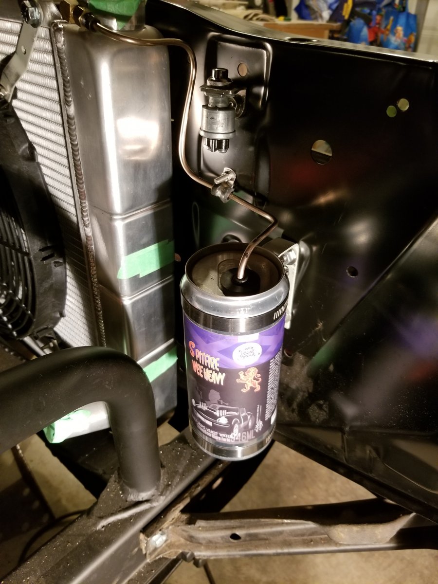

    The last few days here have been wild. Epic wind storm. Tree (and big ones) down around our property. One large Dougl*** fir very close to the house.... so I have been dealing with making things safe around here.
    Otherwise I tinkered a bit on a radiator overflow. I know typically old beer cans are used. I saved a 16oz beer can from a local brewery called, wait for it...... small block brewery. I ran solid line to it because I had an extra chunk I was not using and I an old rubber headlight wiring grommet to contain any splashing around.

  27. triumph 1
    Joined: Feb 9, 2011
    Posts: 604
    triumph 1
    Nice coolant catch can! The label is fitting & I’m sure the brew was great.
