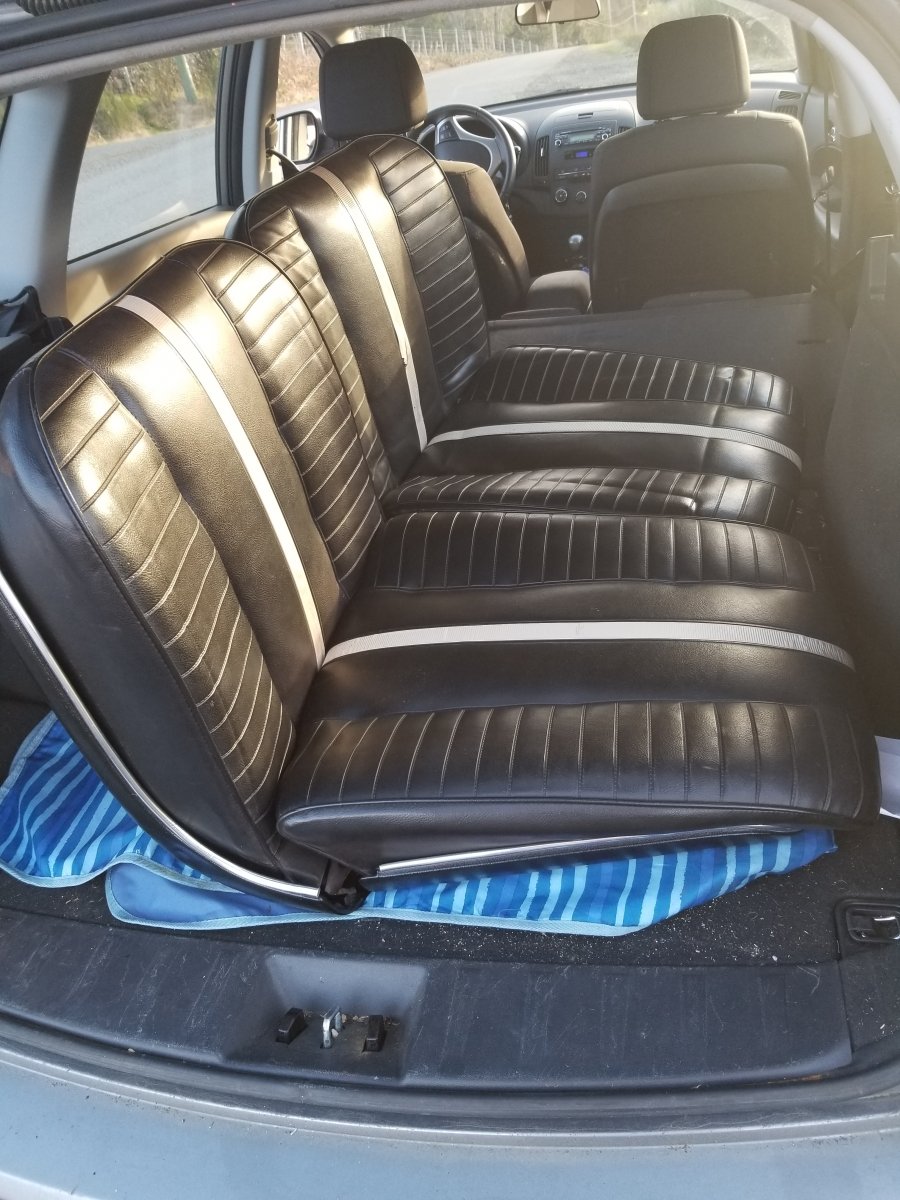

    I have been working out how the interior goes back together in the 63. When I had bought the car it was completely dis***embled and there were parts from a second doner car. The rear bench seat is in amazing shape while my junkie bronco buckets are not...... a facebook in search of, was posted. Thanks to Rick for the response. I got 1967 chevy nova ss buckets in original very very good condition for a very very very good price! Very excited about these seats and will complement the interior nicely!
  20. DDDenny
    Posts: 23,428
    Are you kidding me!
    You won the lottery.
    Do you know that finding even a "ragged" pair of 67 Nova SS bucket seats is a huge find.
    Those are NICE!

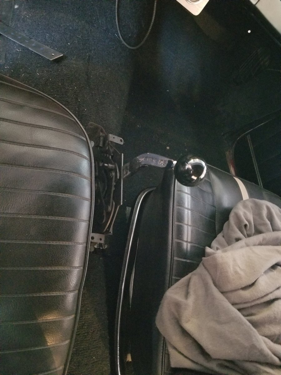

    Well have been busy doing everything but work on the 63.... I managed to get the 67 buckets seat in and mounted along with building another shifter mount.
    I am happy with the location of the seats and the shifter so now moving on to bending up a shifter cover.
    Progress but slow!

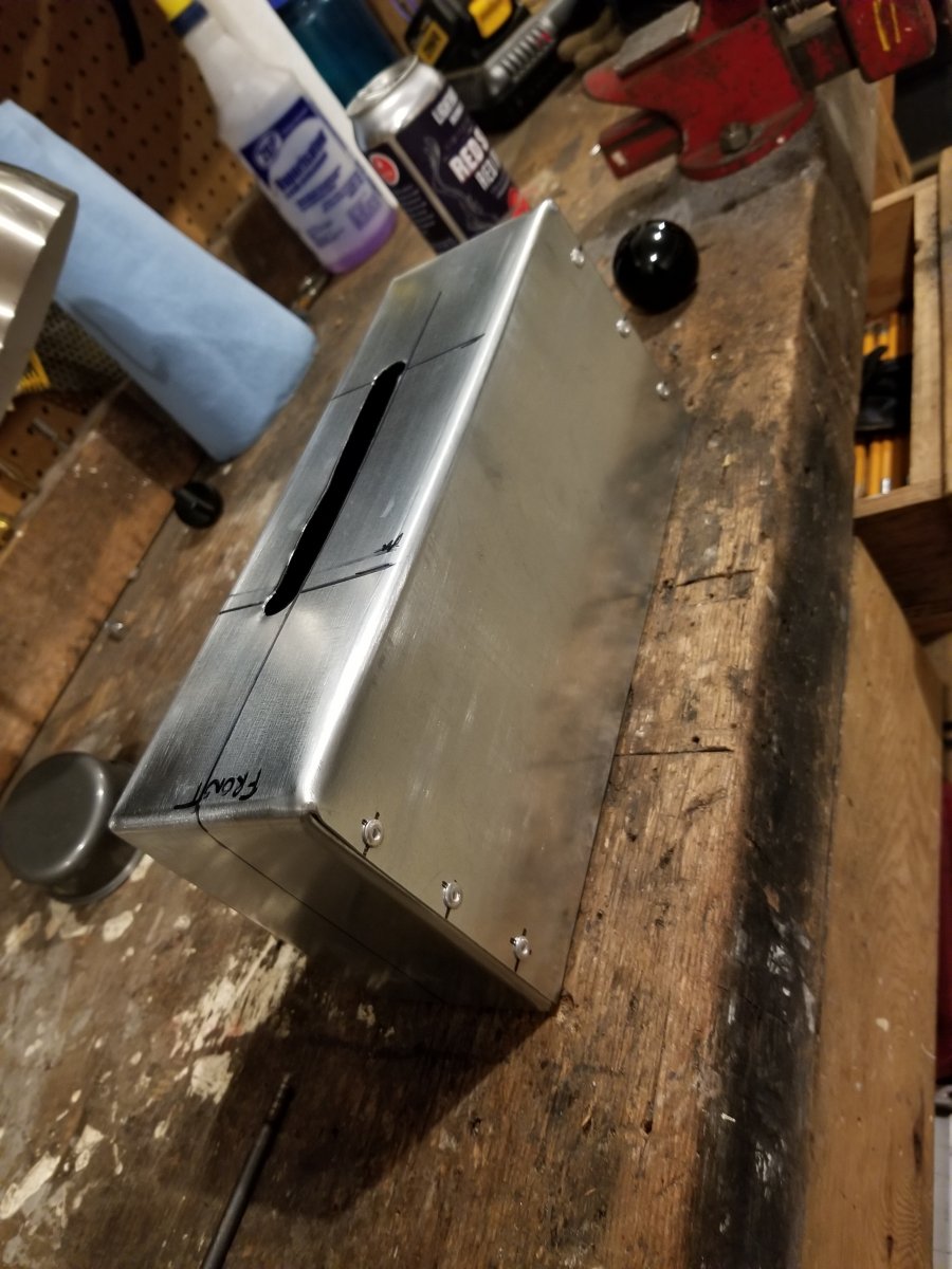

    This evening I tinkered a bit with the throttle linkage and return spring which I was able to repurpose from my single carb c3b setup. The throttle linkage is close. It operates smoothly but I think I am going to adjust it a bit lowering the rear portion to be level.
    Otherwise I spent some time bending up the shifter cover and riveting the corners. Overall I am happy with how it turned out. Definitely learned a lot bending without a nice metal break. I will make a bezel to go around the shifter arm along with a dust shield of some sort to finish it off.
