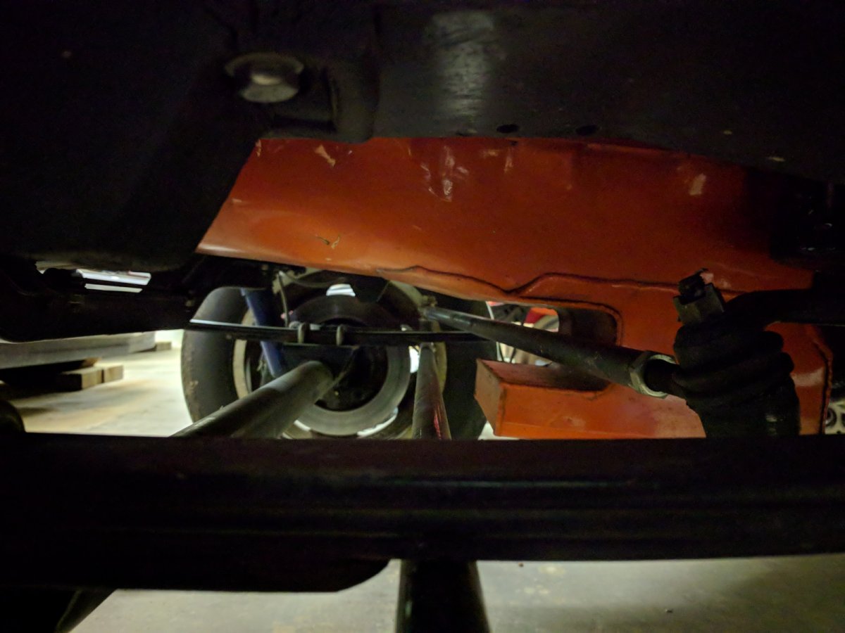

    Slowly getting the axle/ steering set-up mocked in and need some insight from someone who's done it before, this is my first attempt. Everything fits great with the steering box here when the drag link is at this much of an angle from being inline with tie rod. It is horizontally parallel with tie rod but to clear oil pan with drag link it fits in this way perfect....motor height, firewall fitment, angle. etc. Just worried about possible bump steer or other problems.

    If the link is level, when the full weight car is on the suspension, then you'll have minimal bump induced steer, as the driven (opp. side) spindle moves up or down.

    will the tie rod hit the pitman arm when the springs are fully compressed? (like when you hit a big bump going too fast, or land from a wheelie)

    Shouldnt the steering box be moved back so that the tierod and the drag link are parallel?

    Run it back and forth and see if it binds anywhere, otherwise it should be fine.

    This is the common "urban myth".
    If the drag link moves up away from horizontal [eg 1"] or if the drag link was mounted 1" below and moves up 1" to be horizontal, their is the exactly same amount of bump induced steer [just in opposite directions]
    This is basic triangulation [maths]
    By mounting the drag link 1" higher at the pitman end, If there is 2" of travel the draglink arcs through this minimal bump steer range and "cancels" itself back to zero.[at 2'' travel]

    Kerry, your approach is favoring upward movement...a 'level' tie-rod, at rest, burdened by full weight, would offer minimum bump in either up or down movements, no? A slight down-side position as you state, p***es thru center, a sound approach. When however, you crank a left or right turn, my best sense, is to start centered ie: level.

    I set it up with single leaf and compressed it as squirrel suggested and the draglink/tierod clears oilpan good at max travel,still have to mount bump stop. Setting the tierod and drag link horizontally pararell is no problem, just want to know if where the drag link is in pic will be ok being a couple of inches in front of tie rod. If I move it back straight above the tierod I'd have to move the engine back about 4 inches and cut out the firewall, would like to not do that if possible. Nothing seems to bind as is. Thanks for all the info from you guys

    The drag link on my car angles even more than that, but it's all behind the tie rod, rather than in front of it, because the steering box is in it's original location, while the axle is 4" ahead of where it is supposed to be (altered wheelbase car).
    The front to back offset doesn't really affect the steering geometry noticeably, because the drag link is so long. And it doesn't induce bump steer, since it's horizontal, not angled up or down.

    Thanks again squirrel, your pic of your suspension and explaination of the geometry kinda settles my question.Couldnt see why it wouldnt work but gives me a lot more confidence seeing it done on yours. Have a good one... now back to the shop, after I shovel a trail back to it
