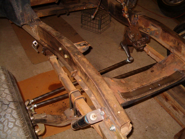

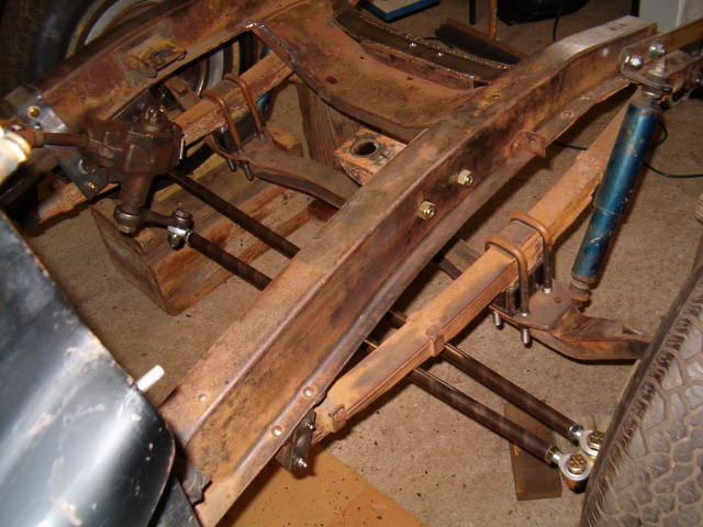

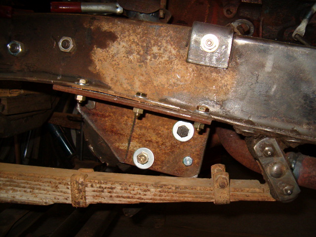

  20. rusty1
    Joined: Nov 25, 2004
    Posts: 13,185
    rusty1
    ...try for a cross-steer set-up like this, used a 525 box, homemade steering box mount, everything else from Speedway Motors....no bump-steer, easy to steer with 2 fingers...
    tractorguy and 54 Chevrolet like this.

    The truck axle I bought already has a disc brake conversion which is a plus.
    I would appreciate if you would get me some pictures of your set up.

    Thanks for the pictures, they are very helpful and the steering and bracket looks very nice.
    I have A 72 nova parts car with manual steering that I'm thinking about trying the box .
