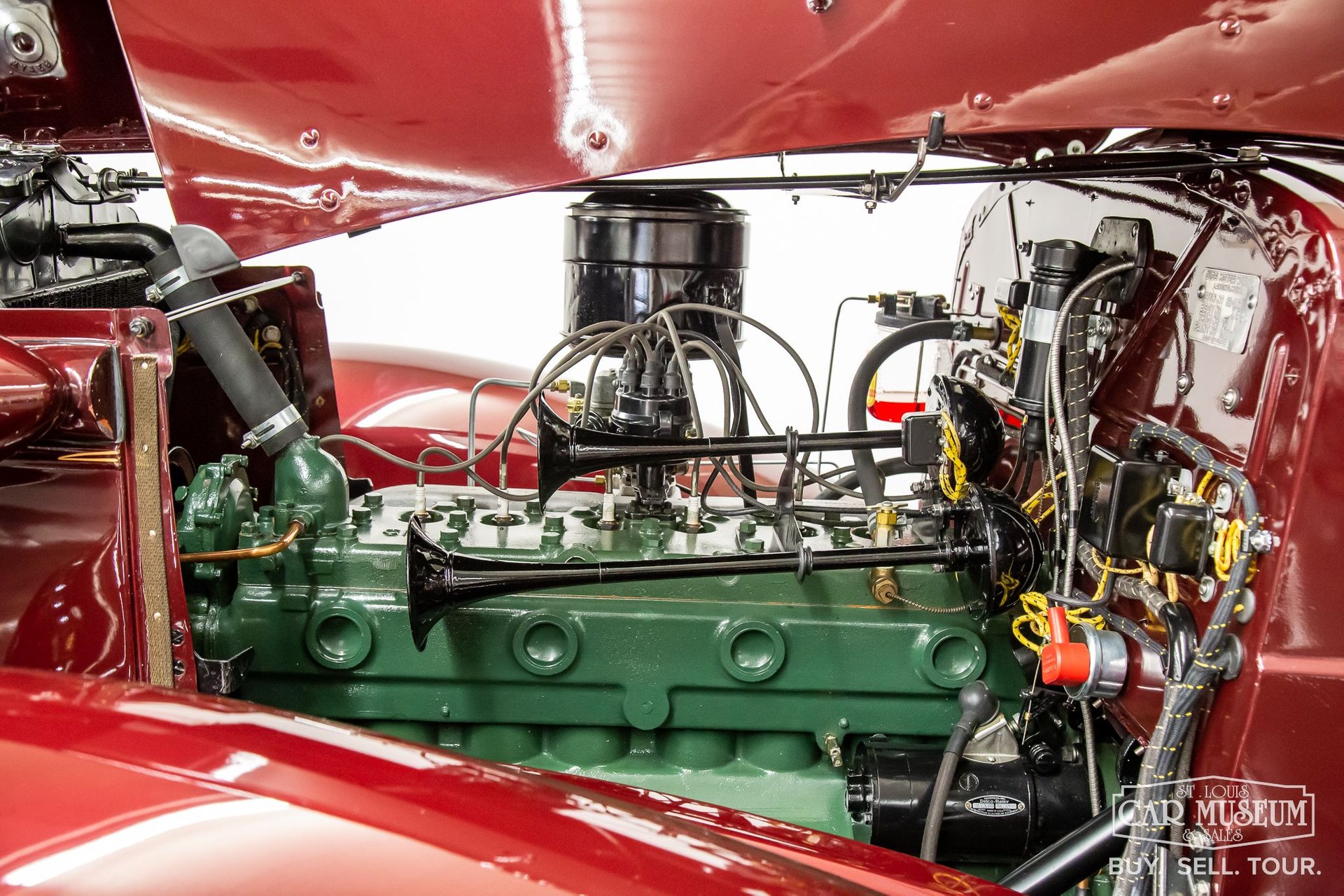

    That is what I thought, but I can't find that number anywhere and the pictures on the innerweb show even spacing of the sparkplugs. Even the Oldsmobile staight eight video has even spaced spark plugs.

    Not the same, but that don't mean the couldn't have been a revision of sorts.. webpicture.jpg

    The picture you posted doesn't look like the right engine, it says GMC on it near the front?
    I found a picture of an Olds engine, the spark plug spacing looks the same as your head, to me.
    L-36 that sold a while ago, on an auction site.

    The picture I posted was a 1932, i.e., L-32. I thought they were the same, but not true. I found a car, L-35, with a postage stamp size picture of the head and I can just about read the serial number 405891. So, they must have changed the plug layout for '35 and '36. Hard to find picture showing the casting number for sure.
