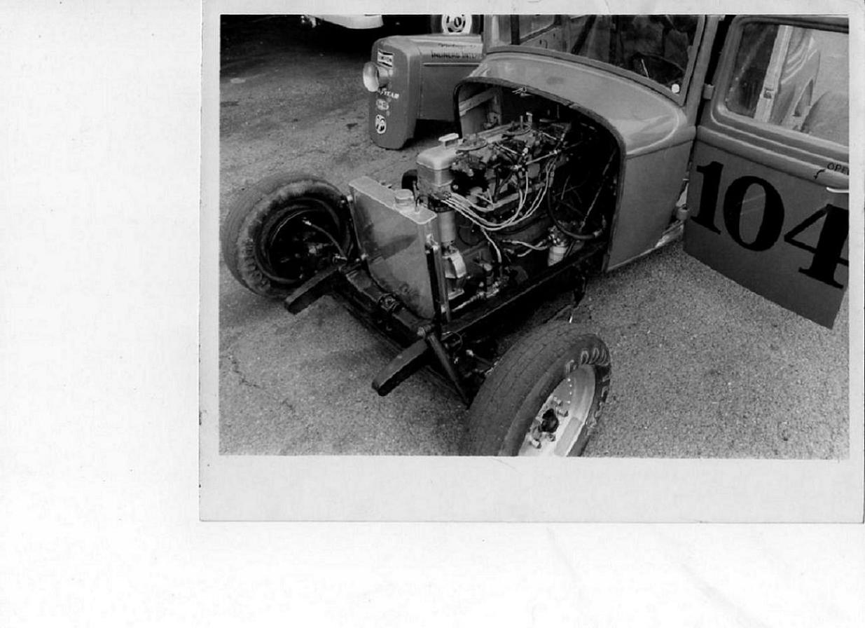

    I'm using a 1960 Jaguar engine and trans in my latest project. The extra length of the engine and the overdrive unit on the trans is proving to be a real bitch. The 100" wheelbase is getting really crowded.
    I may end up adding a couple of inches to the hood and stretching the wheelbase.

  12. I'd like to see what you are puting a Jag six in. Any pictures?
