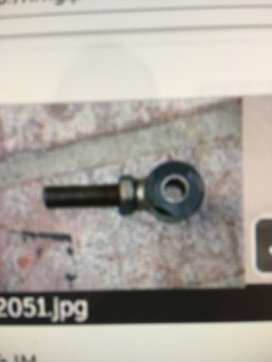

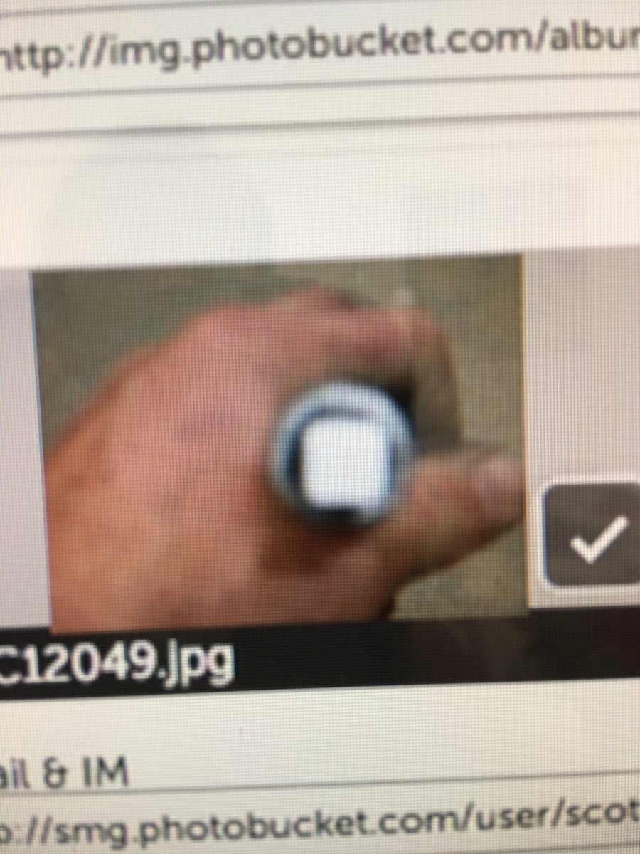

    Heres my technique for starting your tap straight in 7/8 tubing, if you don't have access to a lathe.
    Get about an inch or 2 of 1/2 inch RIGID conduit, it has an OD of 7/8" and ID of 5/8 inch. cut square. Get a 5/8-18 bolt and nut
    Tighten finger tight , the ID will hold the nut true
    Tack the nut to the piece of conduit and remove the bolt
    Go to your local Home depot and get a 1/2"RIGID threadless compression coupling
    Ream the 7/8 156 wall tubing to 9/16 ID this is fine for a 5/8-18 tap(the true tap drill size is 37/64)
    Tighten snugly but dont reef down , your guide to one end and the other to your 7/8 tubing.
    Put the tube in a vice Run the tap in a little at a time going back and forth to get the tap started. Remove the tool and continue tapping the tube 2+ inches
    Your end of choice will go straight in after you have blown out the shavings from the tube
    Thanks for looking I hope this helps
