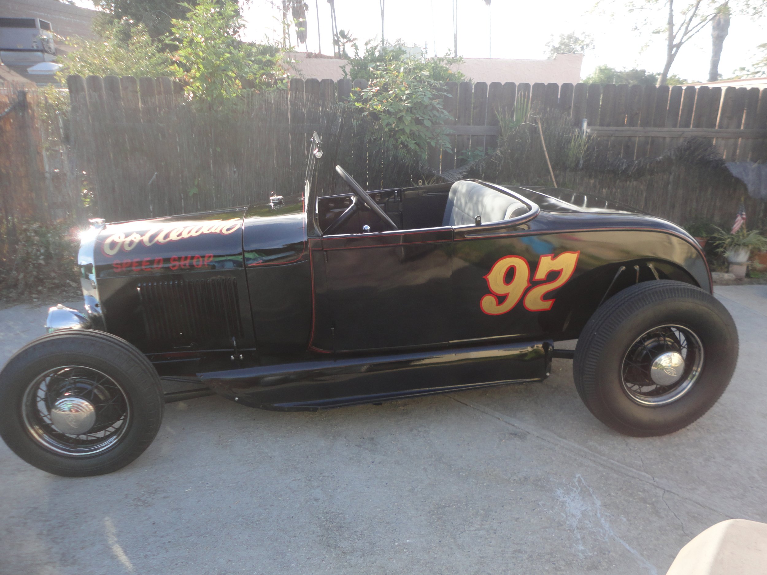

    I pprefer the bent spokes over the straight. Some pics of my roads 97.jpg DSC03443.JPG ter with bent and straight.

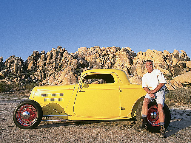

    Good enough for Jake’s coupe, good enough for me.
