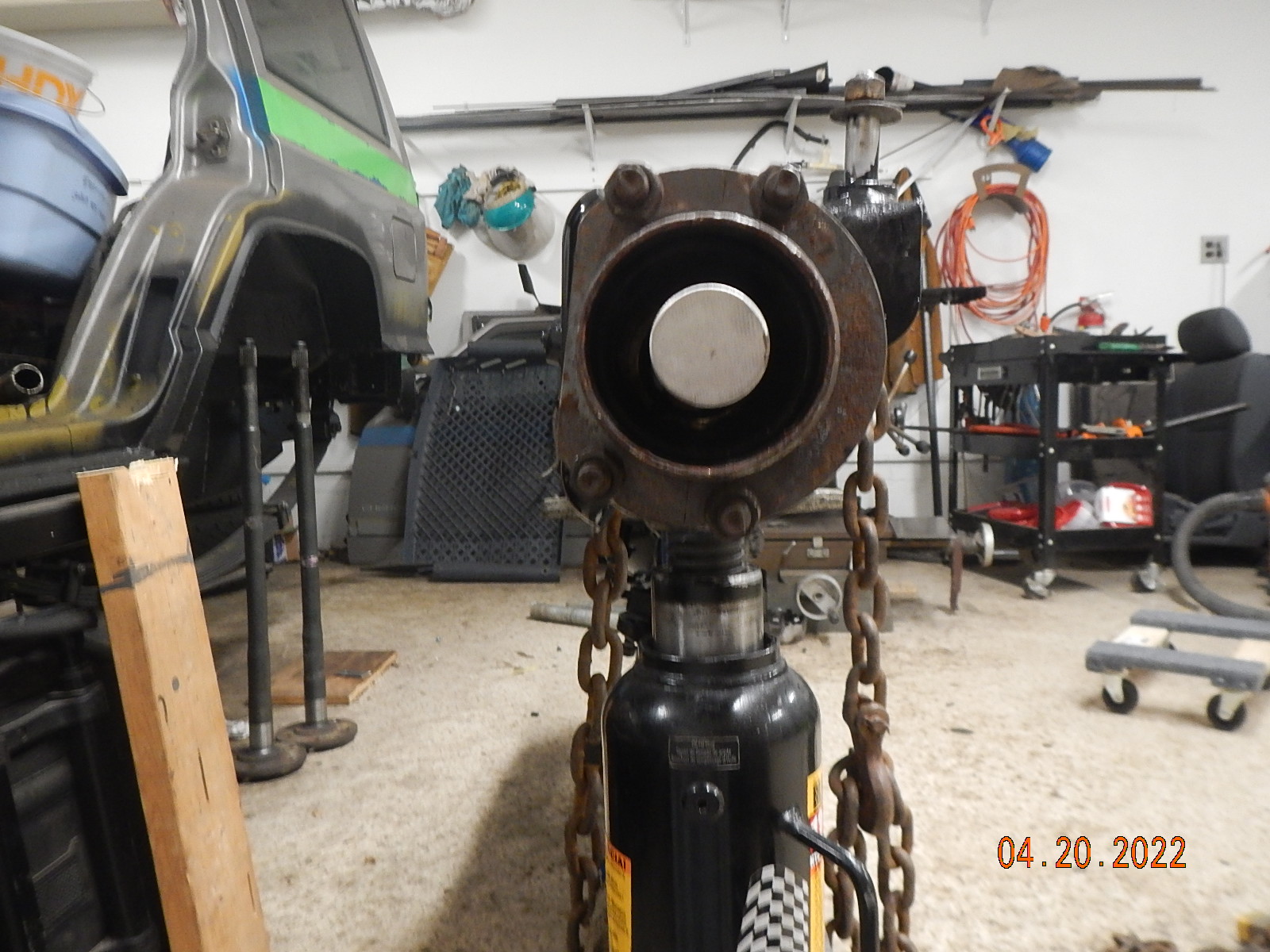

    Did a bit of welding on a Chrysler 8.25 rear axle housing (perches, brackets, etc)
    It warped, I could SEE it with my eye when I looked through the tubes, end to end (empty housing).
    I scrounged up a 1.25" Ground and polished steel bar and checked it on V blocks, then ordered "pucks" for the carrier bearing saddles.
    The bar showed I was off center a good 1/4" on each axle tube end.
    I got an I beam and welded up 2 HD screw jack stand, 12 ton bottle jack, chain.
    I was easily able get the tube straight WHEN I had pressure with the jack but it would flex back when The jack was released. So I heated and cooled the opposite side and it pulled it almost true.
    I have been chasing the last 2-3 thousands of an inch around for an hour.
    My measurements are 2-3 thousands different on opposite sides of the bar, so the bar is 1 - 1.5 thousands from being centered,,
    Close enough ?? Roller bearings BTW.

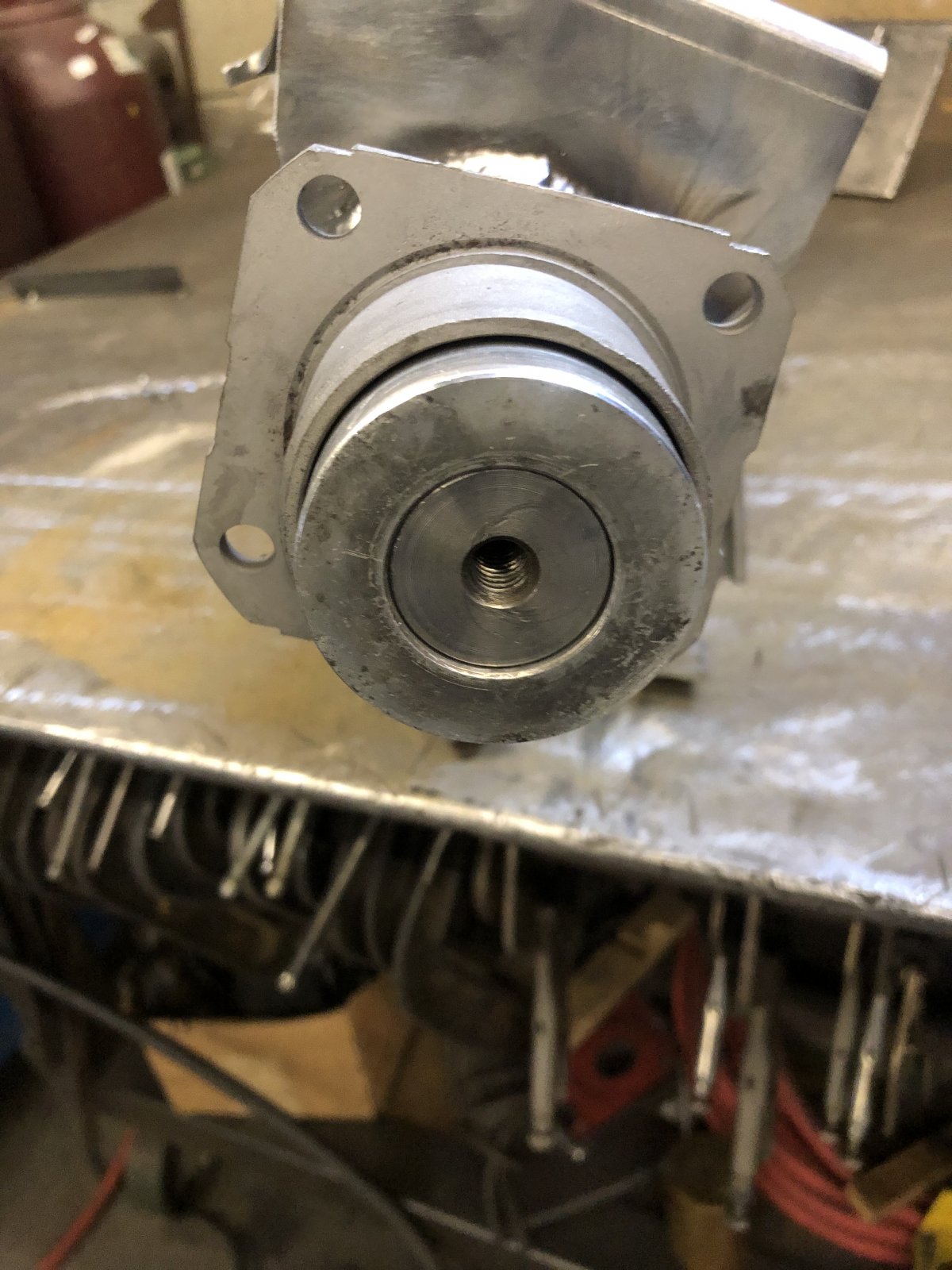

  5. badshifter
    Joined: Apr 28, 2006
    Posts: 3,606
    badshifter
    Just repaired this 12 bolt out of a 69 C*m*ro, it was off about an 1/8 on each side and had 92000 miles on it and no issues. Other than having torn off a spring perch….
    CD666895-DCCB-4002-9FD1-FFF3B2AAC5A8.jpeg F882E202-E8AB-4DE8-9E95-3608CDE91FB2.jpeg

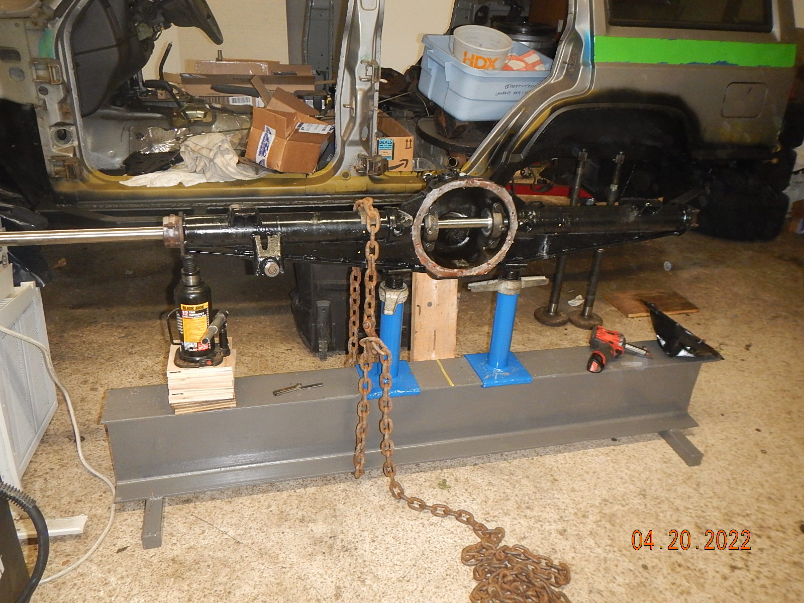

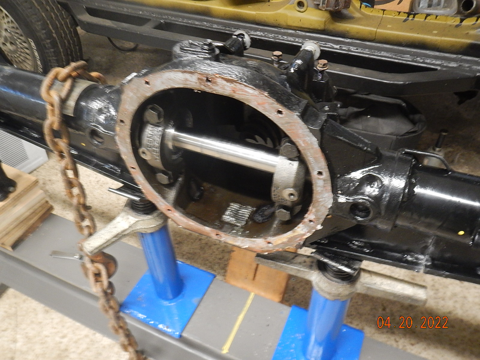

  7. Slackdaddy
    Joined: Feb 11, 2018
    Posts: 21
    Slackdaddy
    from Maryland
    Thanks for all the advice and allowing me to "Tap the brain trust"
    I picked up a 10x6 I beam at the local scrap yard for ~ $40
    I had the shoring screw jack threads/handles and the 2" pipe lying around.
    I did not use pucks on the outer ends, but used a digital micrometer to check clearance between the 1.25" rod and inside of the axle tube.
    The final image is "good" after releasing the jack pressure DSCN1770.JPG DSCN1771.JPG DSCN1785.JPG

  21. Slackdaddy
    Posts: 21
    Slackdaddy
    from Maryland
    I made a thin slice through the gusset (truss) on each side prior to "straightening" the tube.
    When I re-welded the truss web and cord it pulled it 2.5/100 out.
  22. Slackdaddy
    Posts: 21
    Slackdaddy
    from Maryland
    With the bearing back in the end,, the axle slides in and engages the splines like butter, Once I engaged the splines I can push it in with my pinky,, I'm calling it good

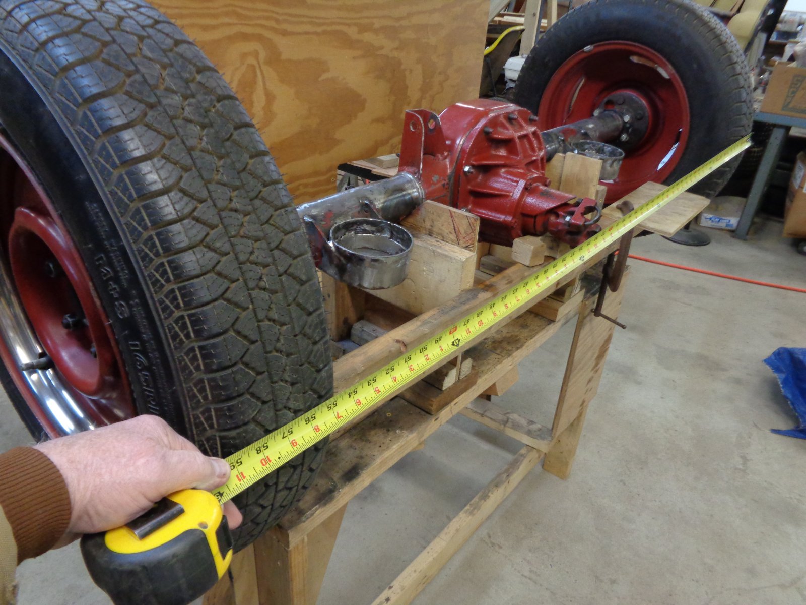

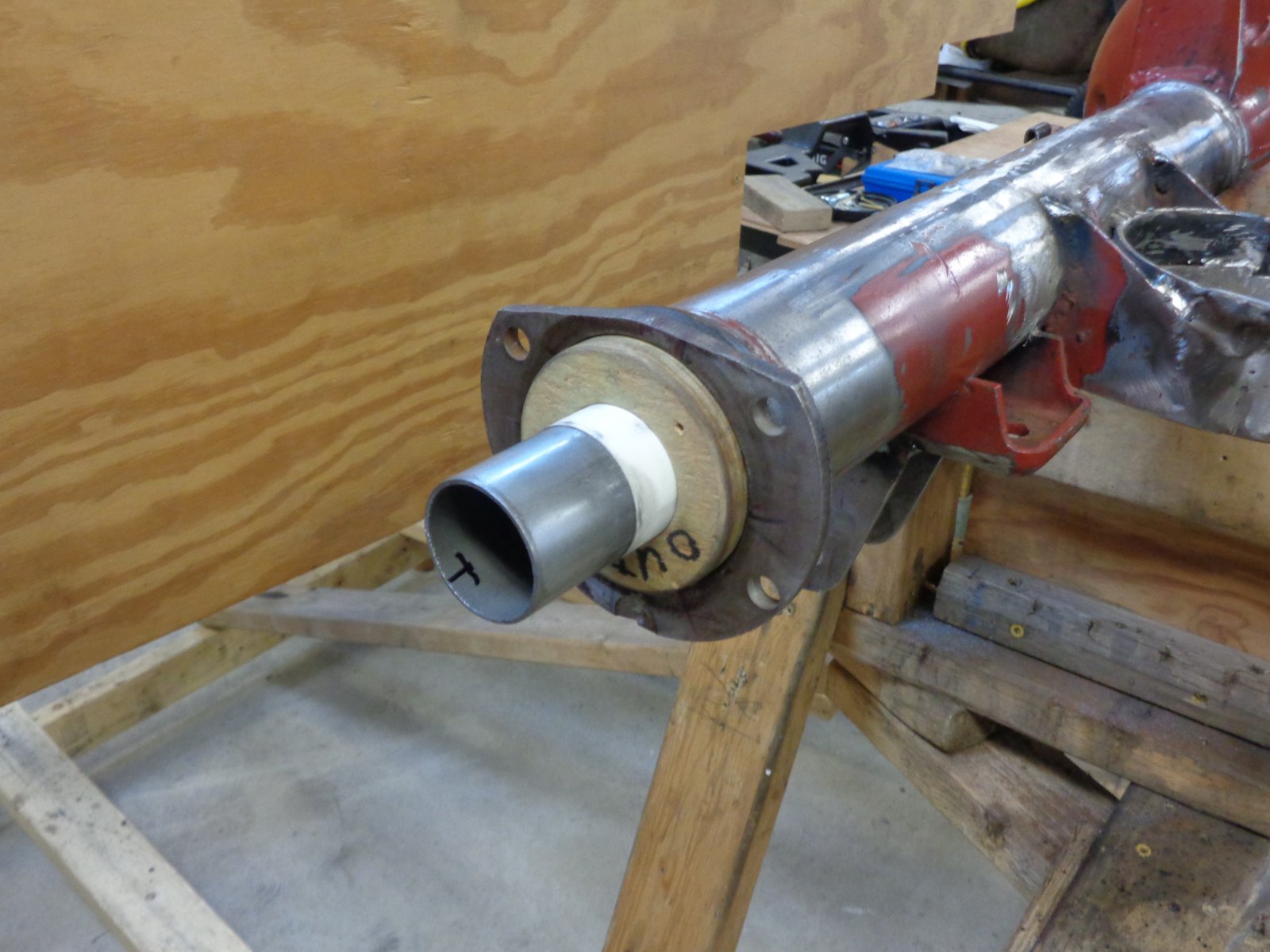

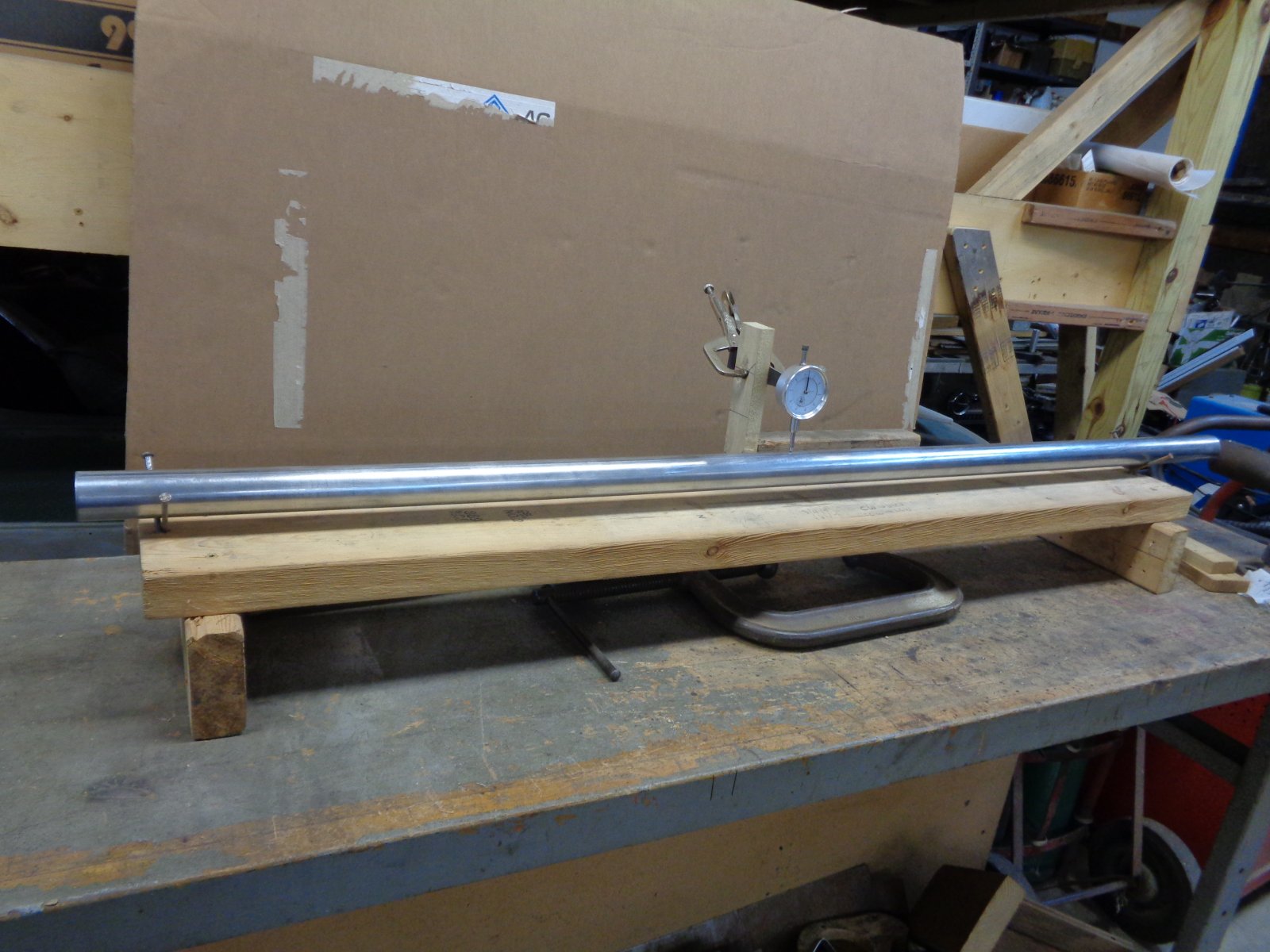

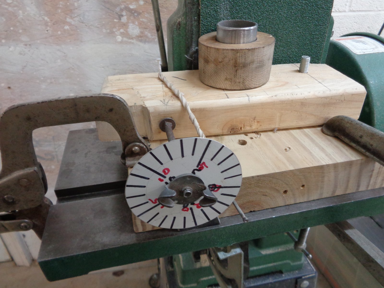

    Here's how I made a bar and pucks to check my rear.
    I used a piece of 1 1/4" galvanized fence post. I filed down the welded seam and polished it with 80 and then 220 grit.
    Checking for straightness.
    Straightening tools
    Needed the mallet to straighten it. Could crank down on the clamp until the fence post almost hit the bench with no change. Amazing amount of spring back.
    Tool for making the pucks, no lathe.
    The object here is to have the outside and inside diameters of the pucks concentric. The top piece of 2x4 pivots on the bolt sticking up in the upper right. The puck holder is a piece of the fence post pushed into the 2x4 half way between the pivot and the adjuster bolt.
    The adjuster bolt is 1/4x20. That means 20 revolutions will move it 1". A micrometer turns 40 times to an inch, hence putting the puck holder half way between the pivot and the adjuster allows measurable movements by the .001". For the scale, theoretically a 2" diameter should have worked. (2" x 3.14 = 6.280 : 1/4" x 25 = 6.250, Not perfect but workable for this.) I actually had to go to a 2 1/32' diameter. The adjuster threads through a drilled and tapped scrap of 1/4" steel. I lightly buggered the threads to provide some resistance to turning. The finish nail is the pointer. The rubber band keeps tension against the adjuster and pivot piece. The corner of the 2x4 is cut away so I would have a sharp edge to read the scale off of.
    When I drilled the holes for the center of the pucks I used a hole saw, but that left the holes a little large. I was able to correct that with aluminum coil stock sleeves. That didn't work out for the pucks in the carrier, so I remade them out of 2x4 and used a spade bit to drill the center holes. Those were a little tight, but a few strokes with some worn out 40 grit wrapped around a 1" pipe fixed that.
    Should have made the base longer, I could have clamped it on the deck closer to the belt. Would have made keeping things parallel easier.
    When I bolted the pucks into the carrier I had the fence post through them to keep them in alignment. While this isn't the most precise set up, I figure if you can rotate the fence post in 90* increments and the pucks still go in the end of the axle and rotate freely, you've got to be close enough to OK.
    One thing i learned is if you are using heat to straighten the axle, it is best to slide the fence post out.
    Measured within a 1/16" front to back and top to bottom, also after rotating the tires some.
