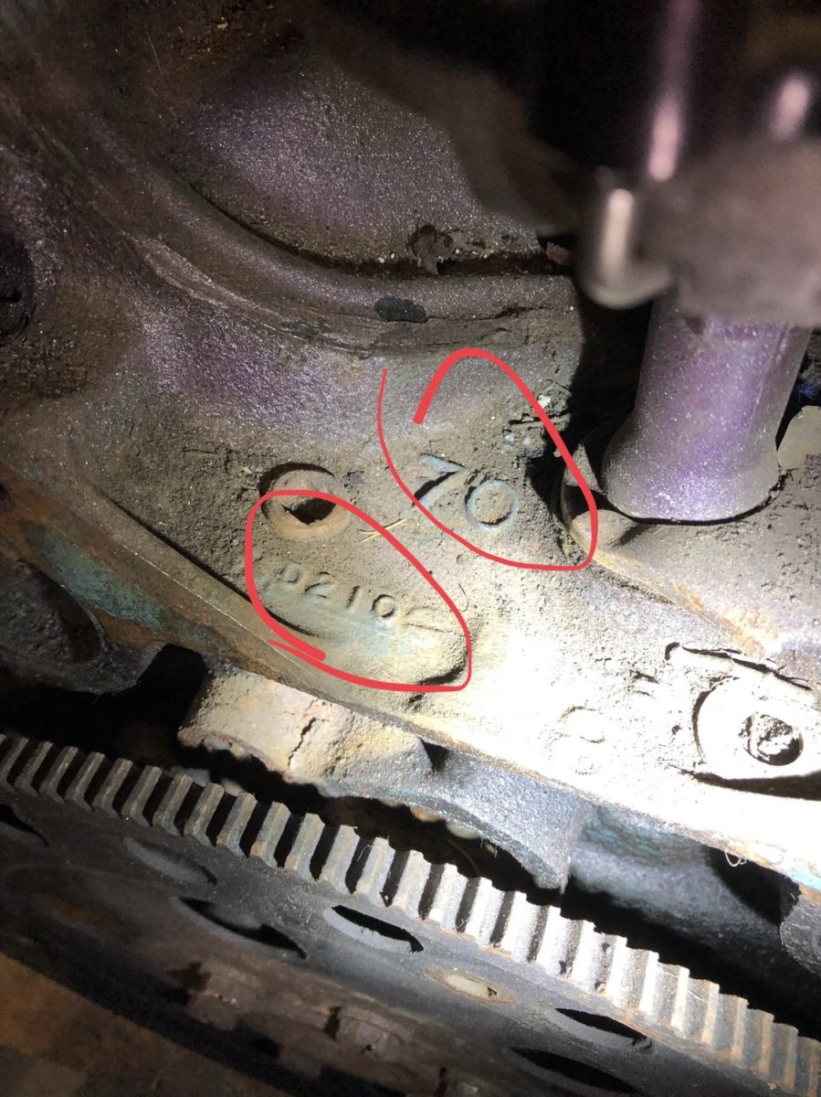

    Hi, I know you guys discussed this in the past but I am stuck. I have a 67 Pontiac Grand Prix convertible that was bought as a 400. It has an original engine with XJ on the block. The previous owner had the engine rebuilt and tells me the engine is a 428. There is a bump behind the distributor and from what he says, it has a 4 bolt main and 268 cam. He also said it has a windage tray. He rebuilt the engine to 428 specs and it runs great. Could this be a 428 from the factory and still be stamped XJ on the block like a 400? I have attached a picture that he took when rebuilding it. I want to badge the car as a 428 but wont do it unless it is truly a 428. Thanks.

    Posts: 22
    gto66pont
    428 was cast on the side of the block between the freeze plugs and the #28 cast in the lifter valley on a true 428 block. Pontiac also cast the size numbers on the left side of the block by the fuel pump on their other motors for identification. Loved the 428 motor. Great tourque. Read guick.

  3. treb11

    78 400

    Joined: Sep 16, 2014

    http://www.phs-online.com/

    Joined: Sep 11, 2019
