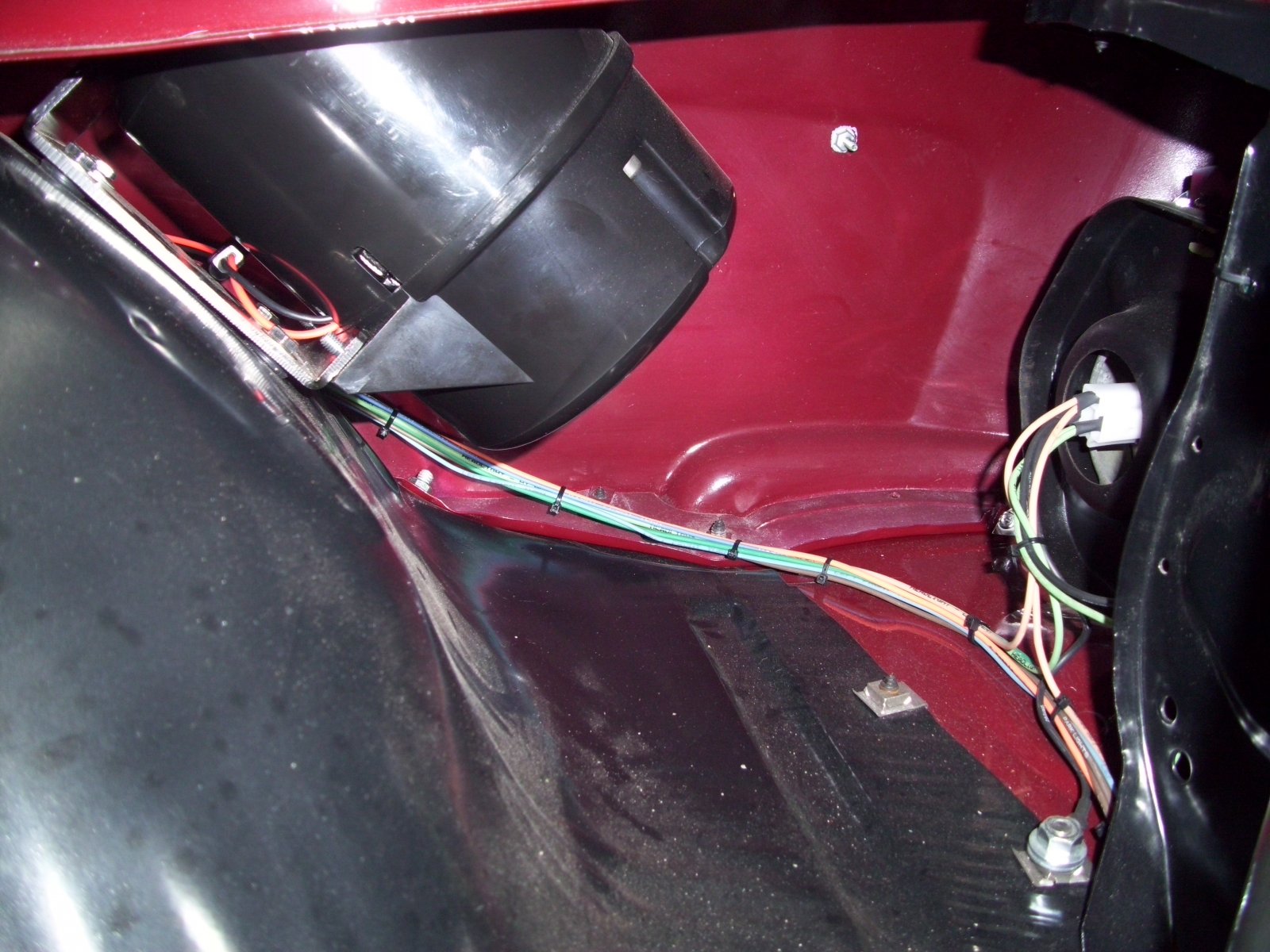

    103_1034.JPG 103_1035.JPG Have good pedal when the vacuum pump isn't running, it's a separate unit from the engine, kicks on at 16lbs and off at 22lbs. As the video shows good pedal without the key turned to the on position. To the floor with it in the on position. Replaced both the booster and master. The brake idiot light is not hooked up to the combination valve. Have never run into this problem and have bleed the brakes numerous times and no air, and the master was bench bleed. Any ideas ??? 103_1034.JPG 103_1035.JPG
