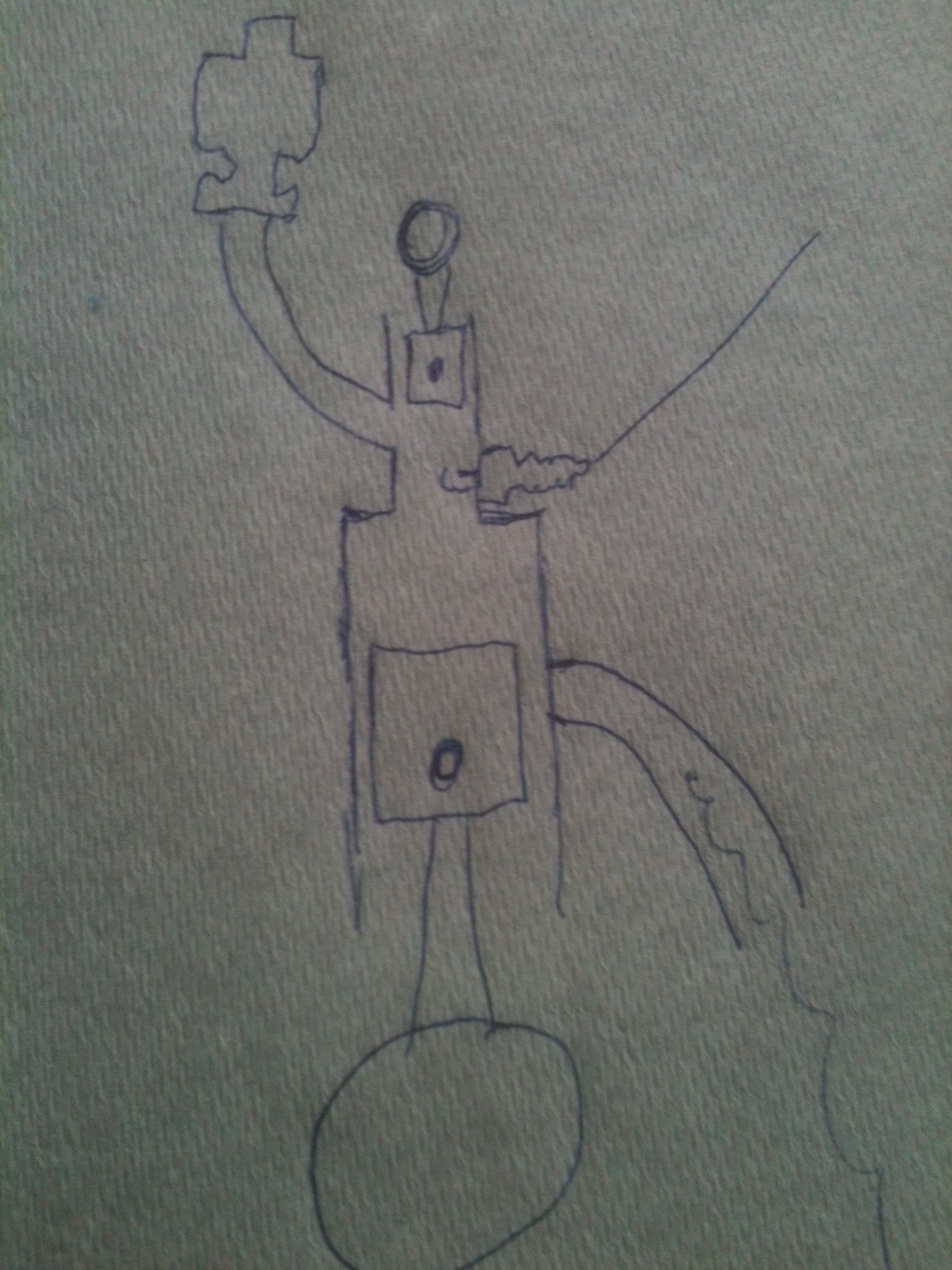

    Ok , you guys are going to have to forgive the amatuer drawing.
    (Years ago my art teacher said I maxed out at stick men)
    But I think this is the basic idea some of you are trying to explain to me.
    The top piston real function is to act like a valve to open and close the intake port and at the same time form a combustion chamber.
    While the bottom crank and pistons act pretty much like a normal 2 cycle and make most of the power.
  14. Relic Stew
    Joined: Apr 17, 2005
    Posts: 1,237
    Relic Stew
    from Wisconsin
    That's my take on it. The separate piston allows better control of intake timing, and can allow for supercharging by closing the intake after the exhaust.
    On a conventional piston port 2-stroke, the exhaust opens first and closes last, so the cylinder pressure is limited by the exhaust port pressure, and remaining stroke after the exhaust closes. They depend a lot on exhaust pulse tuning for maximum power. There tends to be a narrow power band when the engine is "on the pipe", when timed exhaust reflection creates negative port pressure when the intake is open, and positive port pressure after the intake closes until the exhaust closes.
    Grahamsc likes this.
  15. Grahamsc
    Joined: May 13, 2014
    Posts: 466
    Grahamsc
    from Colorado
    Thanks relic , now it makes sense why the went to this trouble to control the intake port, thats the only way you could have positive cylinder pressure with a supercharger on a two stroke.
