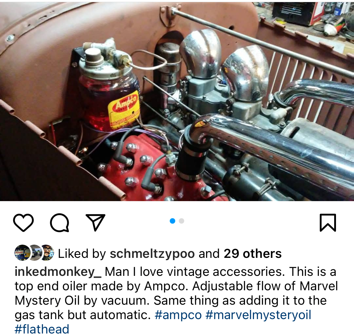

  12. Used to add lead replacement goop while the engine is running. If it has a sightgl*** after the needle valve, 1 drop every 30 seconds at idle. Diesel works fine in these.
    hobag65 and bobss396 like this.

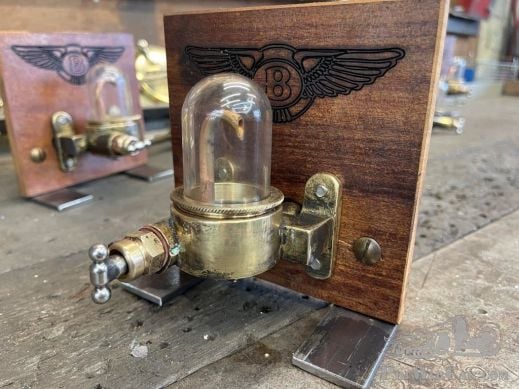

  13. 1952henry
    Joined: Jan 8, 2006
    Posts: 1,594
    1952henry
    IMG_0958.jpeg Does it look like these? Best I can discern, these are from early 30s.
    winduptoy and Tim like this.
  14. hobag65
    Joined: Apr 21, 2010
    Posts: 4
    hobag65
    Yes sir, the one on the left, this 31 was parked in an agricultural building since 52 so surprising they were adding this stuff on in the 50’s?

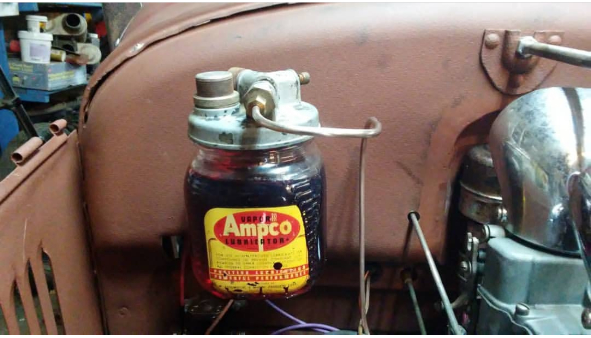

  15. 1952henry
    Joined: Jan 8, 2006
    Posts: 1,594
    1952henry
    I have a small collection of these. A few NOS. The literature of one has the newest cat application as a 54. Another, newest car as 33or 34. Gl*** on that one has turned purple. An Allstate NoS ki has literature dated 52. I believe various makes /designs go back to the 30s from what I’ve seen

  17. 1952henry
    Joined: Jan 8, 2006
    Posts: 1,594
    1952henry
    Mainly for valves. I have a NOS Ampco vacuum plate for my flathead V8 carb. It has the tubing and fittings so it would draw through that. Heck, fill it with MMO, after a cleaning, and let your banger munch on that.
