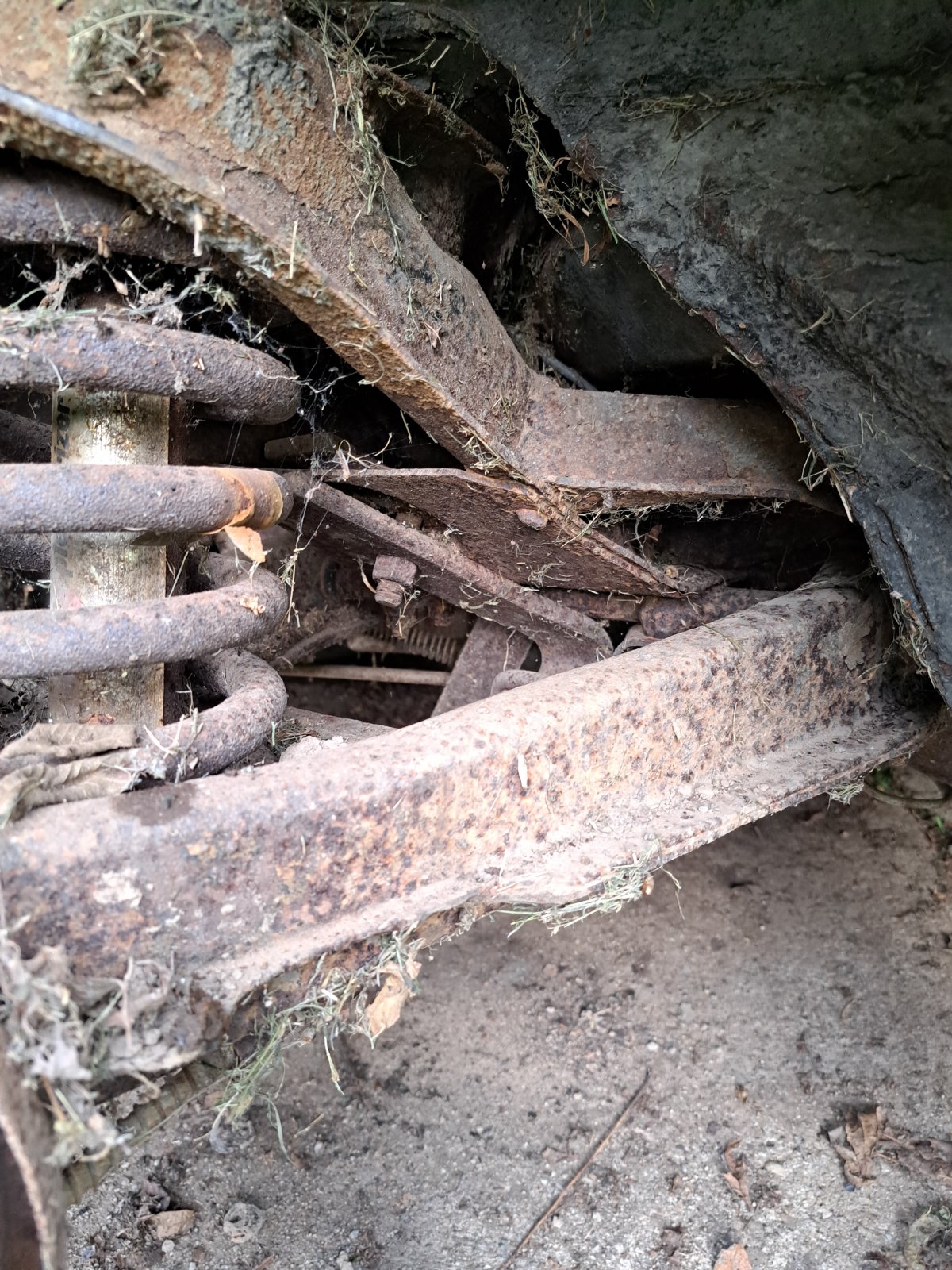

    i will start with what i found underneath the '63 Corvair spyder i picked up, welded angle iron that permanently connects the "frame" to the cross member, and protects the gas tank, it seems to be there so you can flat tow it behind an rv, or some kind of similar setup. there are also what appears to be a "leaf spring" next to the coil in the rear, strange setup. [​IMG][​IMG]

    Sort of a skid plate fab'd up by the rude n crude parts department? Alfa Romeo did stuff like this for their cars with low oil pans. Reminded me of fire place grates.

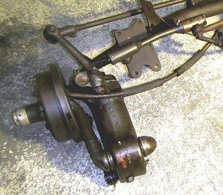

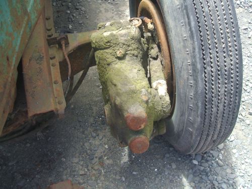

  4. One under-car thing that really fascinates me is the Dubonnet suspension. Saw it for the first time on a 1936 Pontiac Delux sedan I bougth to street rod. I immediately took off the Dubonnet axle and grafted on a M2 front crossmember/suspension. GM put this on several makes in the 30s. Was pretty much a disaster. The huge spindle mounted hydraulic cylinders leaked oil to the point GM recommended checking level every 1000mi. Of course no one did so the front ends of the cars bounced uncontrollably. The ends of the small parallel links on the spindles wore quickly so the wheels splayed out like the car was going to sleep. By '39 they dumped it for conventional A-arm suspension.

    The spring item in the rear was probably an aftermarket deal sold with the idea of reducing the chance of the dreaded "wheel tuck under" that 1960-63 Corvairs experienced under hard cornering. Chevrolet cured it on the '64 models with a "camber compensator" that resembled a single transverse spring leaf.
    Mr48chev and The_Cat_Of_Ages like this.
  6. Which explains why when i jacked it up the wheel didnt hang down at all... unlike the white one which hanged way down.

    That makes a lot of sense and was no doubt what it was there for. Most likely holding the control arm up rather than pushing down on it to add lift.,

    Unfortunately this wasn't a modification, it was made by GM, they must of thought they were on a winner! I remember I had a '37 with this front end, and spent many hours trying to work out how to lower it without killing myself! The fluid would leak out as you poured it in, so it was always dry. When you hit the skids hard it would continue bouncing up and down for quite a while!

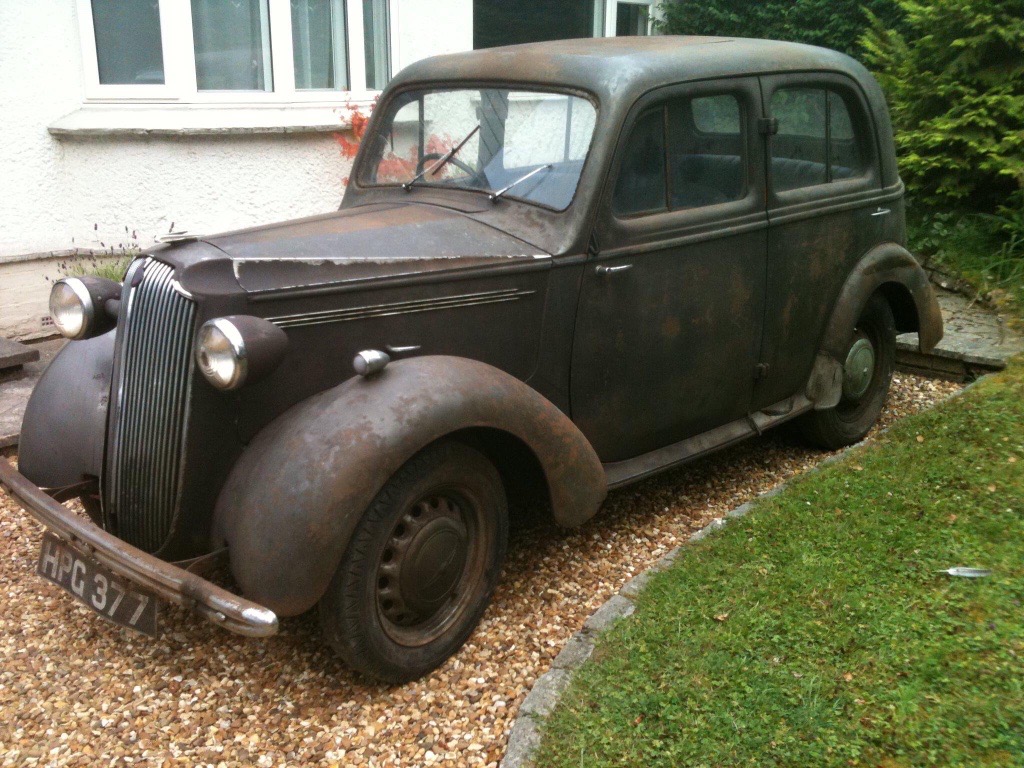

    My father has a 1939 Vauxhall 10 that came equipped with this suspension arrangement, apparently it was the first mass produced semi monocoque car. front end, engine and trans was all on a bolt on subframe. MicrosoftTeams-image (14).jpg

  16. I had a old Vauxhall similar to that over here with a Straight Six. Bought it as a dismantled project from someone who could,nt pay his storage fees. When putting it together to resemble a car the front subframe/chassis rails went up against the floor sills with about 10 bolts each side. So just half a chassis as you say.

  17. hydraulic suspension... thats a new one.
