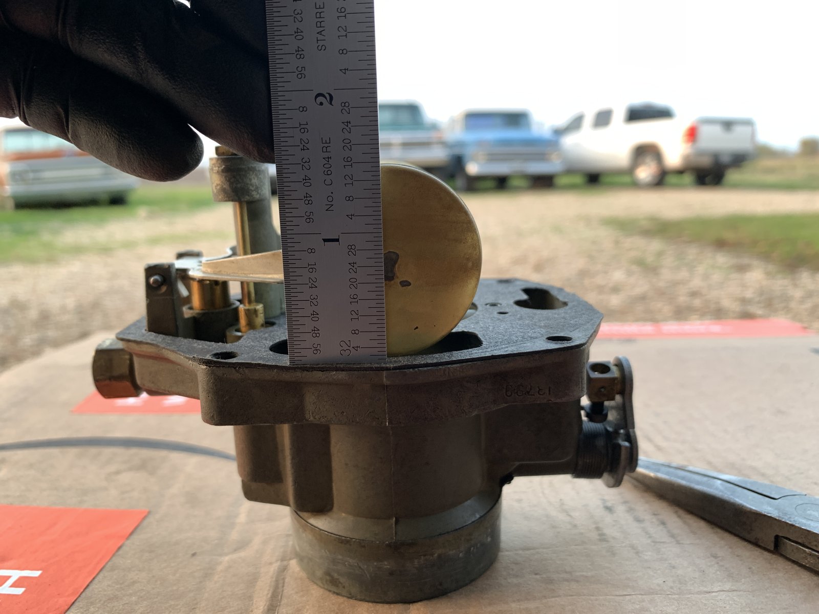

    I spent most of the day with the car, and have verified all the details mentioned earlier. It’s definitely related to fuel slosh, specifically with fore and aft, not side-to-side movement. With the float at 1-9/32” (spec), I can rock the car as hard as I want side-to-side and have a really hard time getting it to stumble. But if I give the car a firm nudge back and forth, it stumbles very easily. I worked the float level down 2/32” at a time and saw improvement every time, all the way up to about 19/32” where it became impossible to get it to stumble, but I lost consistent accelerator pump function since it was starving for fuel due to the low fuel level. I brought the float back to right about 16/32” and the car works almost flawlessly for the setup. Really harsh stops or launches will make a small stumble, but Sunday cruising and everything works great. It doesn’t starve for fuel around curves or during hard acceleration.
    I think I’m going to have to let this one roll like this with a recommendation for a new carb if it won’t reasonably hold the tune.

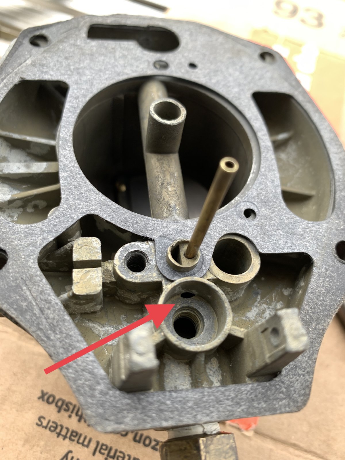

    After days of running well with the modified float level, I decided to put a new set of gaskets in it after being dis***embled so many times. After unscrewing the needle valve seat out, I found a weird crescent shaped hole under the needle valve’s washer. I’m not sure if I just completely missed it during the rebuild, or if it’s a repair that failed sometime after I put it back together, but most importantly I’m not sure if it’s supposed to be there at all??? I don’t remember seeing a hole like this in other carburetors, and I’m don’t see any mention or pictures of a hole like this online yet. Does anyone have any input, or a picture that would confirm whether or not it’s supposed to be there?
    I don’t see a reason why it would be there, and it would make total sense of the sloshing issue.

    996B887E-2CB6-44EB-8A01-E9EF4638FE78.jpeg 996B887E-2CB6-44EB-8A01-E9EF4638FE78.jpeg

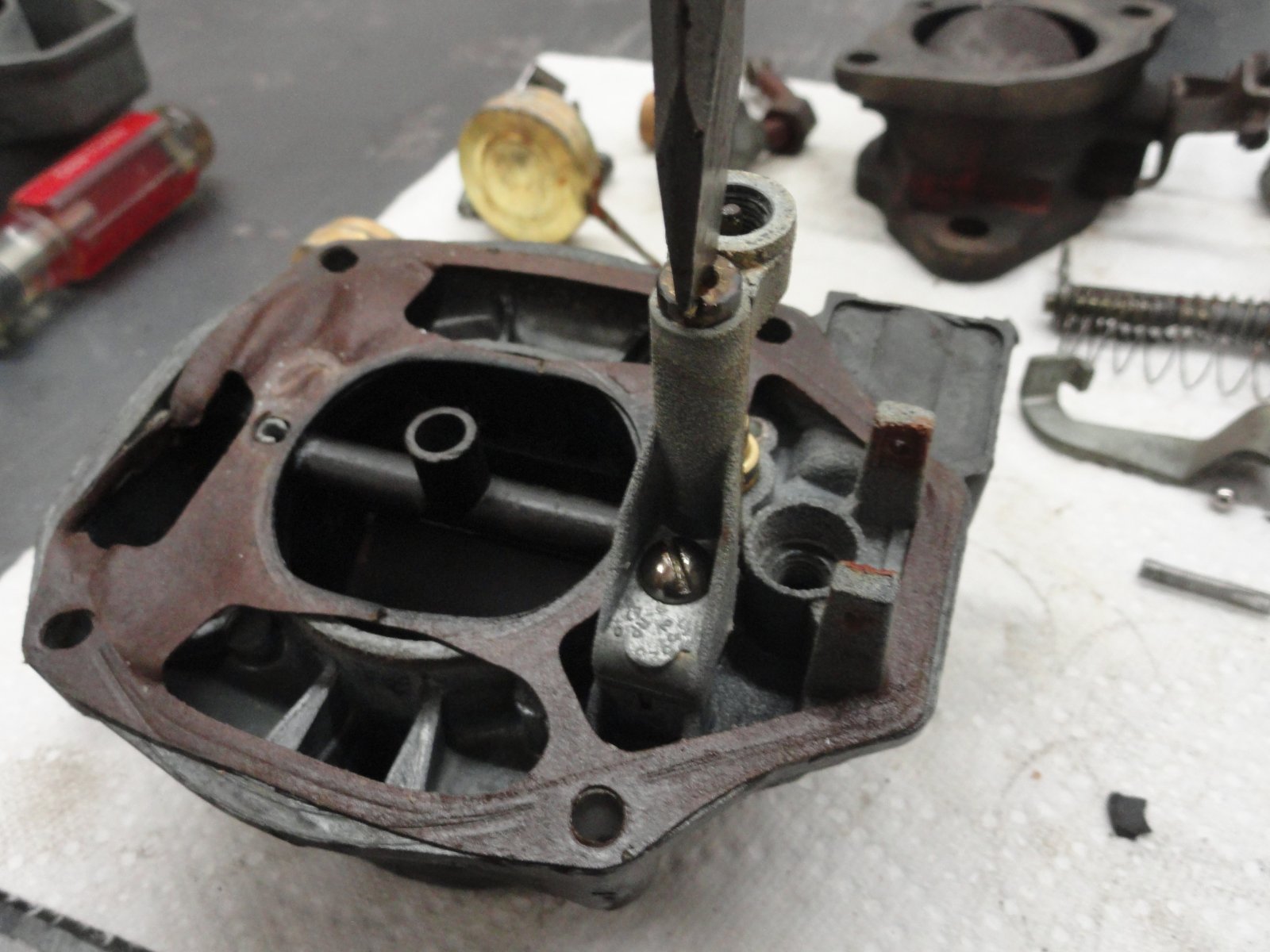

    I thought I saw it on one particular picture from that website, but it almost looks like a shadow to me as well 0B5BA994-80B6-418E-94E7-30460A8CEEA6.jpeg 0B5BA994-80B6-418E-94E7-30460A8CEEA6.jpeg

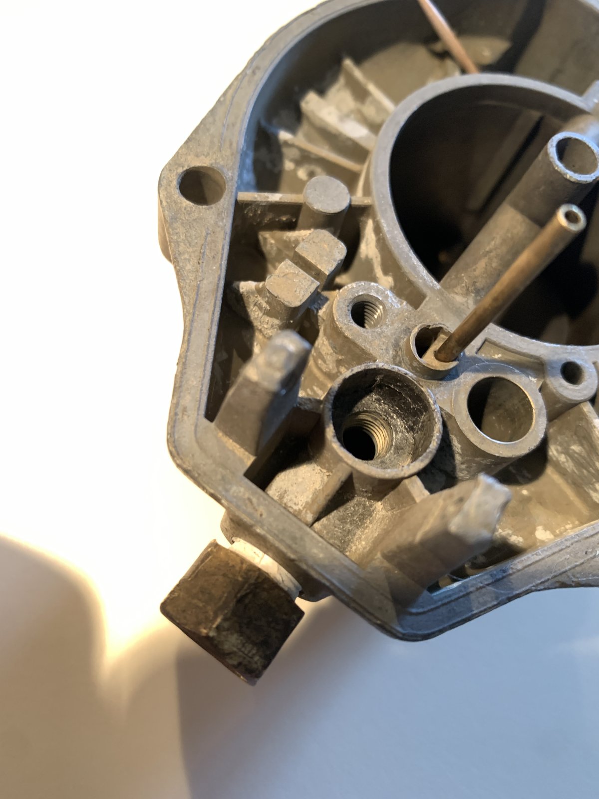

    Here are some others

    There’s no way it’s supposed to be there, in my research. According to the schematics, it should be causing poor fuel metering due to a vacuum leak to the fuel bowl, and causing the fuel sloshing stumble issue. I took apart another Rochester B and it’s not there. A few pictures online that seem like they have it must be shadows. I had a hard time taking this picture without a hard shadow.
    I ordered some Marine-Tex, here tomorrow. I’ll give it 48 hours to cure.

    I got the small hole patched up and it cured my issue. I was able to set the float height to spec and the car will not stumble at all when sloshing the fuel. The throttle is a touch more crisp off idle, too.
