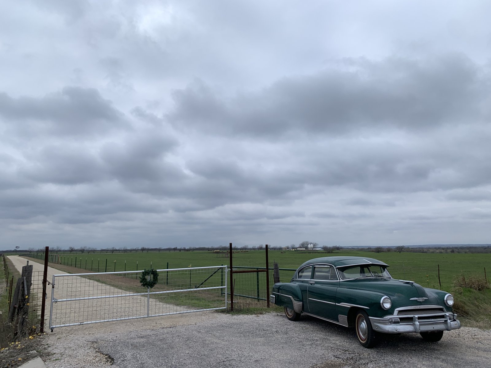

    I don’t want to blab too much about my customer’s personal business, but the history is too interesting. The car was bought new at a dealership one town over, about 10-15 minutes away. The original owner had it shipped to Japan twice on military boats during the Korean War. He had it undercoated before each leg, and it got a new coat of lacquer every time it came home. It still has stickers on the windshield from the Japanese base, and a p*** on the bumper from the local base about 30 minutes away. The car is as original as it can be and rust free. A local 6 banger legend (he’s faster than you) stopped by a while back when I first got the car, he noticed it in the driveway. He helped rebuild the engine with the original owner decades ago and warned me about the solid lifters and “wrong” flywheel, and a little timing advice. Small town kind of stuff. The original owner sold it to his great-nephew. I went to school with him and his brother. My parents went to school with his parents. His parents are my only neighbors out here in the country. I’m 40 years old and I still can’t get away with a damn thing around here.

    It’s running great!
