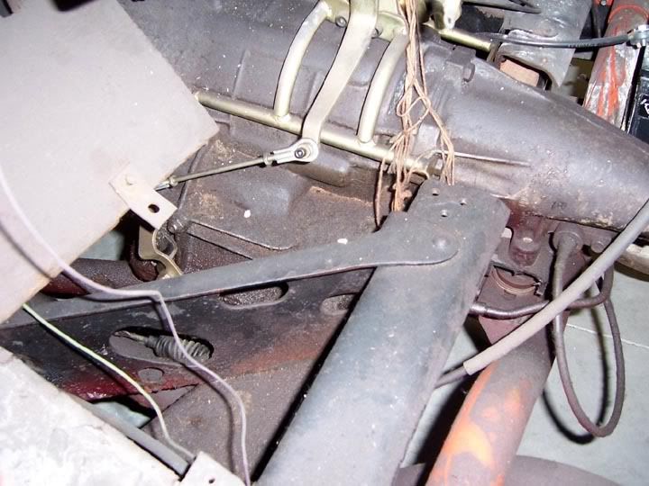

  4. HOTRODSWE
    Joined: Aug 13, 2003
    Posts: 314
    HOTRODSWE
    The motor is installed on the original Ford motor mounts. But the Chevy is still in place just hanging loose from motor!!
    Sorry bad photo
    The transmisson didn,t fit the K-member, no problem just cut it!!
    But hey, what about the wishbone? OK just make a small bracket, weld it to one of the cutted parts and voila!
  5. Cool car... scary engineering!
    Back in the 70s it was common practice to reverse the spindles on T buckets with suicide front ends.

    Can't imagine anyone driving the car like that, but who knows. That k-member hatchet job and wishbone mount are just f*cking nuts.
