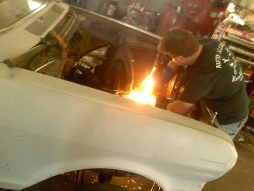

    shaved about another 50lbs off the nose by hacking out the inner fenders on this beautiful 80 degree day.
    tomorrow we're gonna clean up the frame rails "all purdy like" and brace the motor mounts up a lil better. we plan on getting some down tubes made up to connect the firewall to the front subframe.
