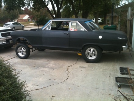

    8FLEET9 , here's an update with my Nova (Street Freak part Deuce). First I pulled out the 1 inch blocks in the rear, then I put longer shackles on and added some old traction bars that I cleaned up (to give it that freak look). I took off the front suspension and mocked up the jeep axle and springs just to see what it looks like and I must say WOW!, what a difference. Now I don't have a drivetrain in it yet hope it comes down a bit but man it freakin rules!! Here's some pictures of the mockup , Im getting ready to blow it all apart but thought yall would like to see it

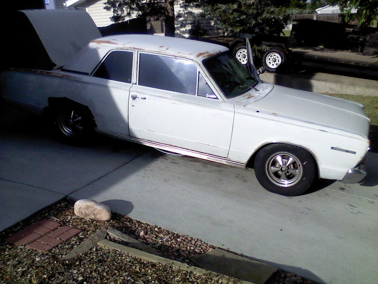

    Couple of shots of my car, got the rear axle flipped this weekend. Getting the jeep tube ready for next weekend.

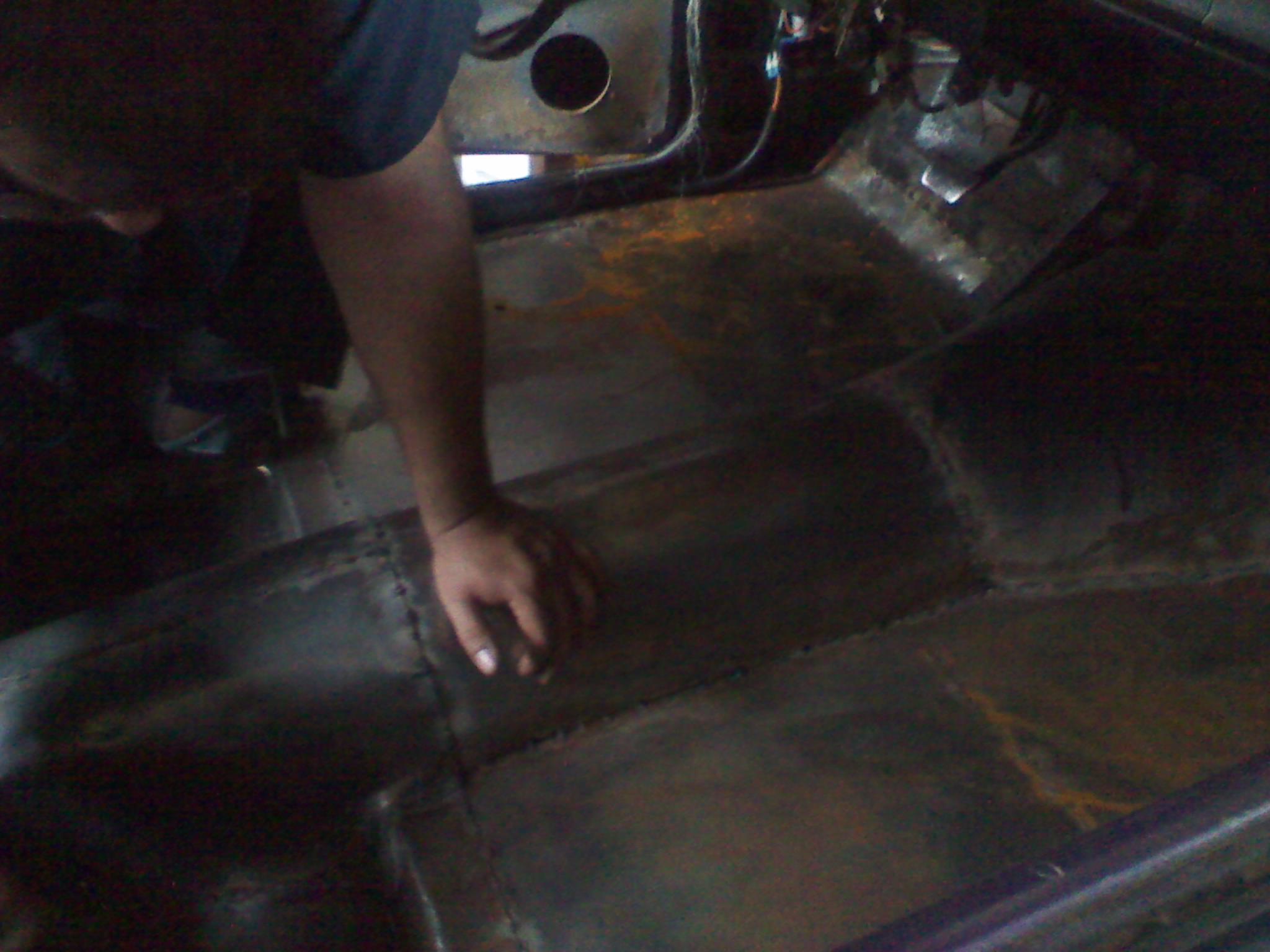

    A few more pics, I'll take some close ups of steering soon. Simple cross steer, as a serious offroad jeep would be, simply ligghter duty. I've put 200 miles on it in the last week, its my only car now. Also finished the new floor this weekend, no one makes pans for this one, haha. Street freak for sure now, Grannys are scared.
