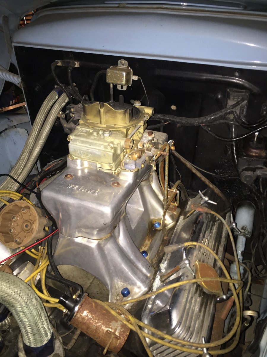

    Bought Street rodded ‘40 Ford pickup a few weeks ago. Good advice here got brakes straitened out (portioning valve issues) . Moved to engine 383ci Mopar in storage for 23

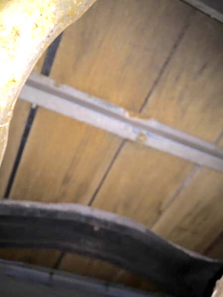

    Yrs & fired up today. Brings me to now, knowing Engines good now moving on to ch***is body issue. I Know ch***is is an F1 ‘48 -‘53. Cab & bed sitting higher than stock ( looks like a lifted 4WD) & want to lower. Found 2”X 3”X24” milled oak, (very square & perpendicular all faces)at all mounting features spacing the bed & body on the ch***is. Very solid. Could tell it was hard wood so cleaned up a section 2 check & is oak. This was done 25 yrs ago when built? Trying to figure if early attempt at lift for the look or done for some tech reason? All look 2 B fairly easy to remove & use shorter mounting bolts to get lower. Gotta check all clearance going down 2”. ***uming steering u/joint will take it? Anyone have Model A pickup cab/bed F1 tupe ch***is? Any insight before I start to remove oak spacers?

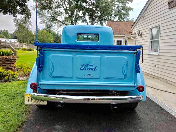

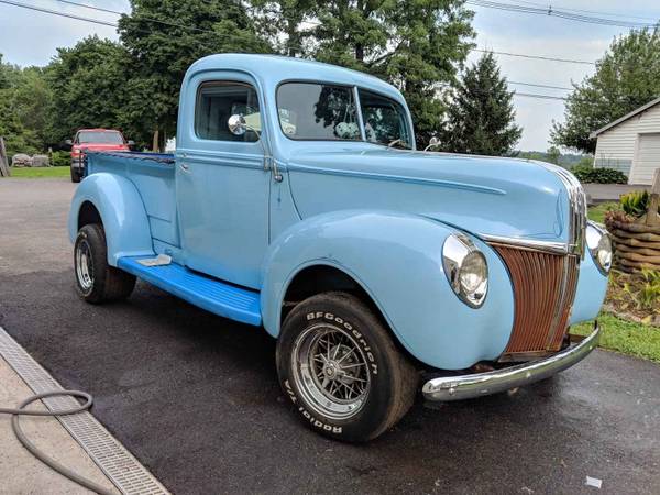

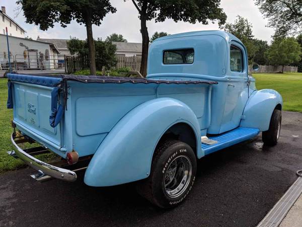

    40 pickup with a 48-53 cab & bed? we need photo's. HRP

    Sorry about that, missed period between ’53 & bed. It’s a ‘48 -‘53 frame under a ‘40 F pickup

    Impractical & too expensive to modify ‘40 frame to accommodate BB Mopar in it.

    Thx, will check Drake Catalog to check on whether there was stock wood interface between cab, bed & frame. I bought this as modified street rod. Not interested in stock ch***is for this project. It has a modified BB Mopar which would rip stock ch***is apart. ‘48 & newer frames much stronger & will withstand torque better. I have a mainly stock ‘35 Ford Tudor, different animal. Fun 4 parades & shows but not fun to drive! The only way I’d change frame would be to buy an aftermarket “Fatman” type frame for high Perf. V8 which would be prohibitively expensive. Same holds true 4 stock ‘40 frame by the time U boxed & strenthened, put different rear, Drive shaft, modified the X, modern brakes to accommodate modern V8. Will stay with this & replace wood mounts with rubber body mounts I’m gonna lower suspension after checking all clearance issues.

    Can't tell , but would think they stuck the wood in there because the frame contours don't fit the body. I think you'd have to just raise up the body off the mounts , remove wood and see how far off you are at each mounting point.

    Checked & seems to be exactly what builder did. While I believe it to be a replacement set they R the wood body/Bed mounting blocks & what’s pictured online catalogs, they’re in perfect condition so will leave as is. Ordered aluminum lowering blocks from speedway that lower axles @ shackle leaf mounts. 2 Kits has 8 shackle plate u bolts & different thicknesses aluminum blocks allow 1/2” to 4” lower.

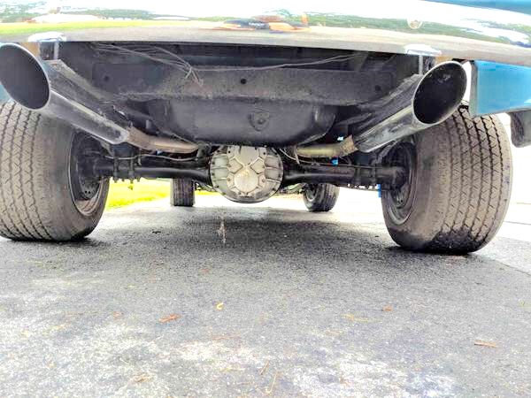

  20. Normal lowering blocks won't do it. The rear end is underneath the rear springs, I'm pretty sure the fronts will be the same. IF you want to do some fabrication work, you could move the axles to the top of the spring packs, that will get you lower. You'll have to watch for frame clearance, and ensure everything welded and bolted properly and safely.

    If your BB Mopar is so hipo that it would tear up a non-boxed 40 frame, arent you worried that it will be too much for a rear end connection that utilizes lowering blocks?
