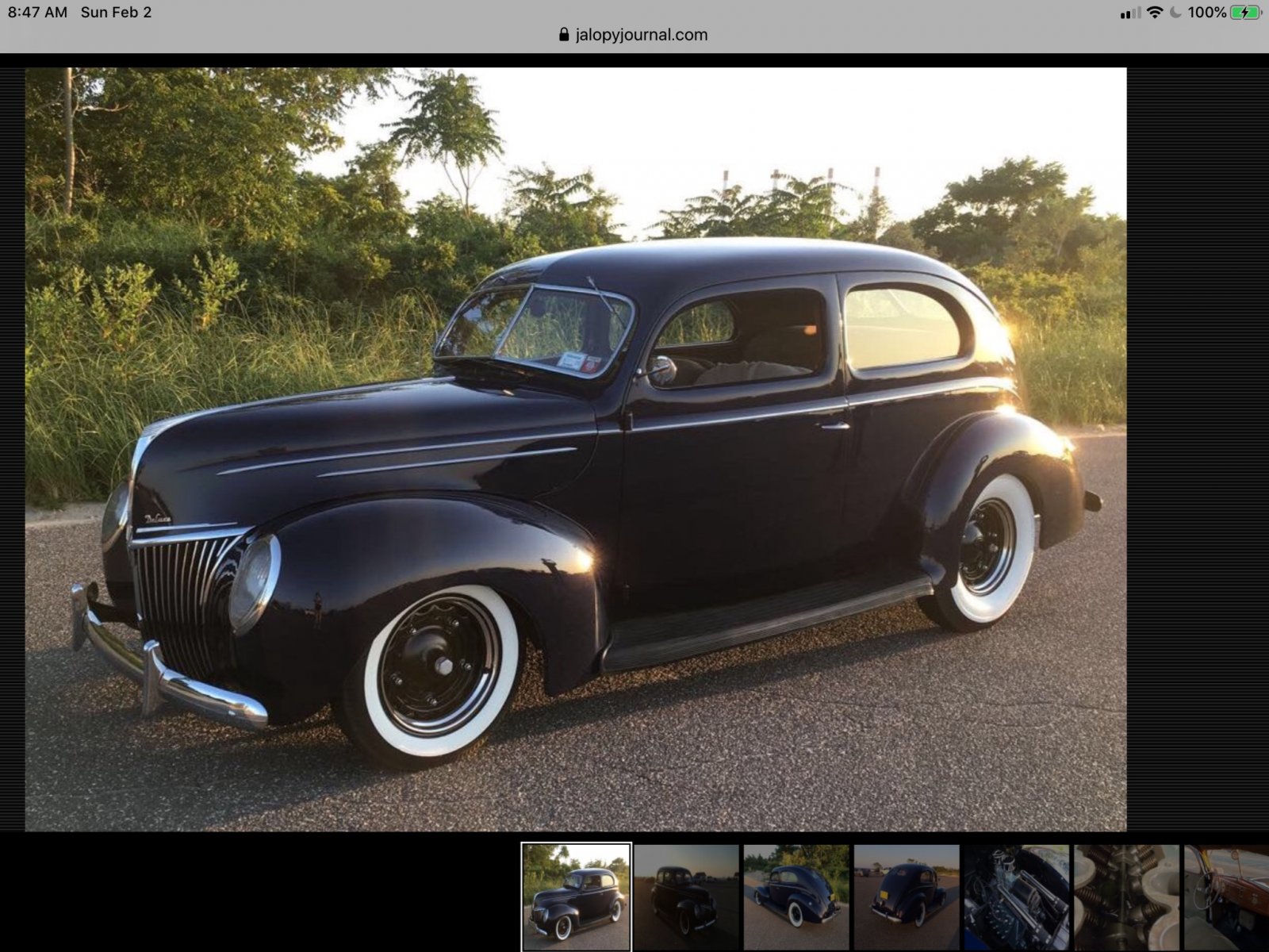

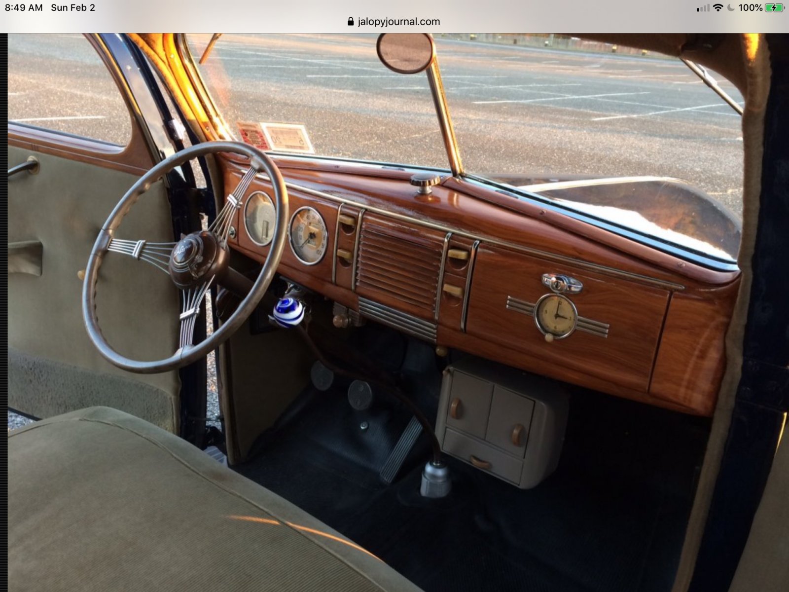

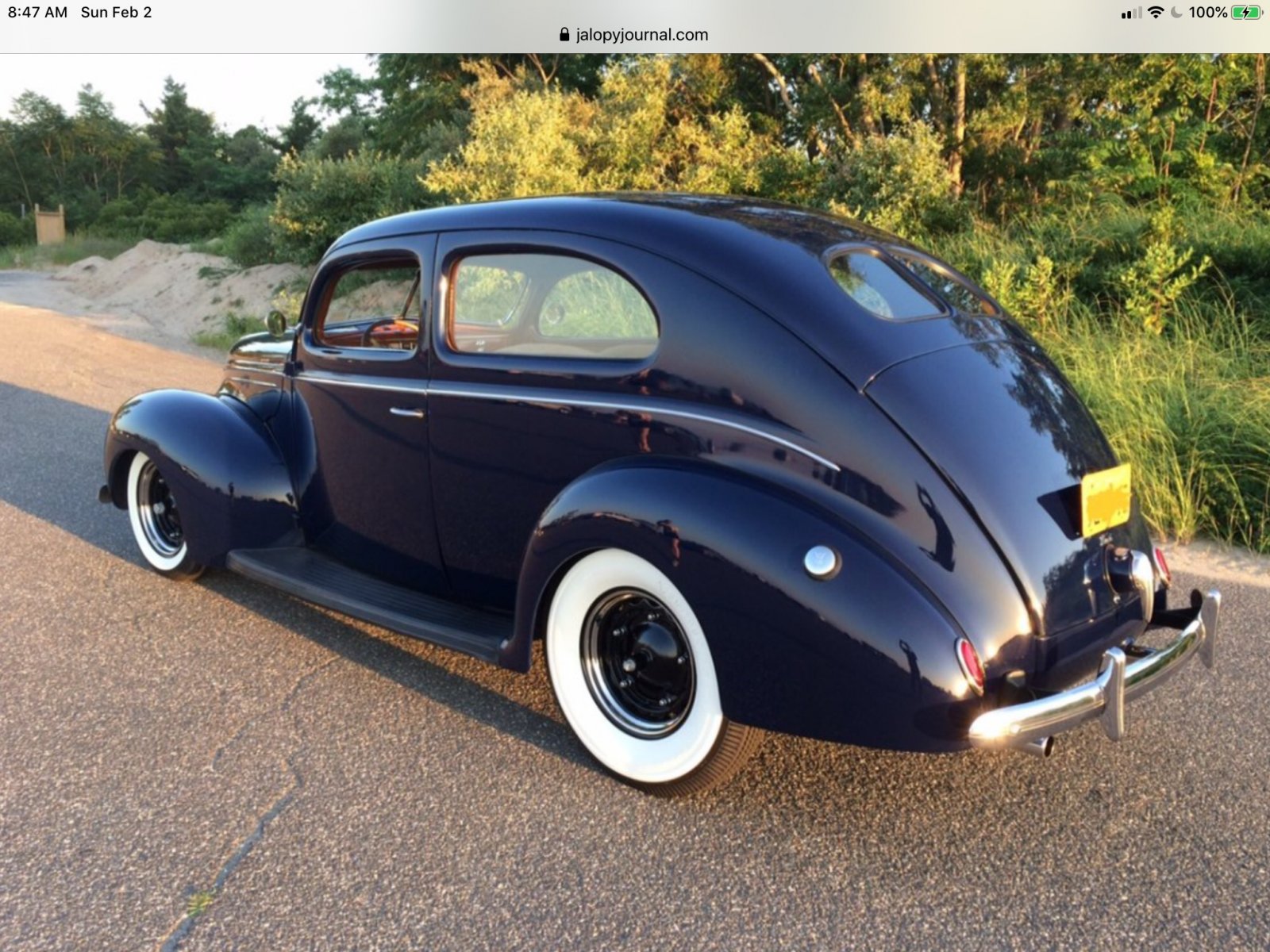

    T/Y to the HAMB and members for all the great info available around here.
    T/Y to the previous Caretakers of this nice car I was able to obtain less than a year ago. 521B4287-9E7B-4B8E-8A83-221F2BF83DF4.jpeg 2424126F-E97A-4713-9118-939A579BC6E2.jpeg 3FDD77C8-5EF2-40DA-9C0E-E721A9CC6594.jpeg 3731F046-FEE9-46A5-988E-087A85B1C2F0.jpeg
  2. Really nice 39. Man the hood fits good! What size tires in the front? 550's, or 500/525?

    solid looking ride. love the heater box

    Purchased from a HAMB member . FH and 3 spd rebuilt not many miles ago. Good compression. Suspension rebuilt, lowered. I changed front spring, got another Posies to raise 1 3/4”. Fun to drive.
    Wiring harness is bad, really bad, like 82 years old bad. I just received a new Cloth Wiring Harness from Bauer Electronics, Chris Olsen.
    Cloth 12V harness adding turns and fogs. Chris included for possible future use fuses, wires & relays for Pusher Fan, elec fuel pump & 3rd brake light.
    So, battery cables, grounds, voltage reducers for dash gauges and heater, bulb sockets for heads , tails & turns, new headlight switch, USB charger in dash harness, fake wires to voltage regulator . . . All I one box. I should not have to order/ wait on any other parts.

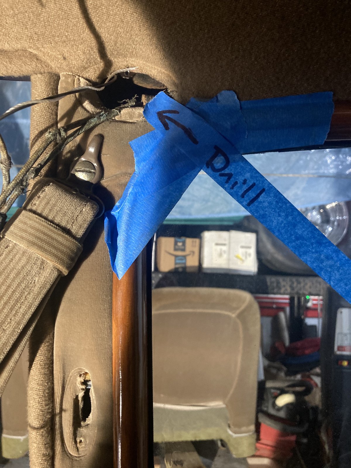

    Couple questions for you guys .
    ) Windshield Crank. When closing at the end of travel, gear wants to slip. Think I have located a new gear. Seller says he has no more Rivets to go with said gear. Have you guys been able to bolt in right side gear instead of rivets ?
    ) Dome light wires. Feed from glove box up A post to B post switch. And light to light across the roof. Have you guys been successful in snaking/ pulling new wires with Headliner in ?
    T/Y. Stretch

    3E3F4C76-FA07-40BD-BD87-E068596ED81A.jpeg 901E7AEE-D6DB-4B73-B903-C638F8515760.jpeg Update on Post #10. Trick to this job was to barrow a Inspection Camera from neighbor. Pass side light, center punched a hole at a angle. Drilled a hole . Fished a mechanics wire up to pass side Sun visor hole. Then another mechanic wire from there down to dash.
    Light to light wire . Used a very small electric fish tape to wire wire on top of headliner.
    Once again trick was to use a Inspection Camera
    Stretch

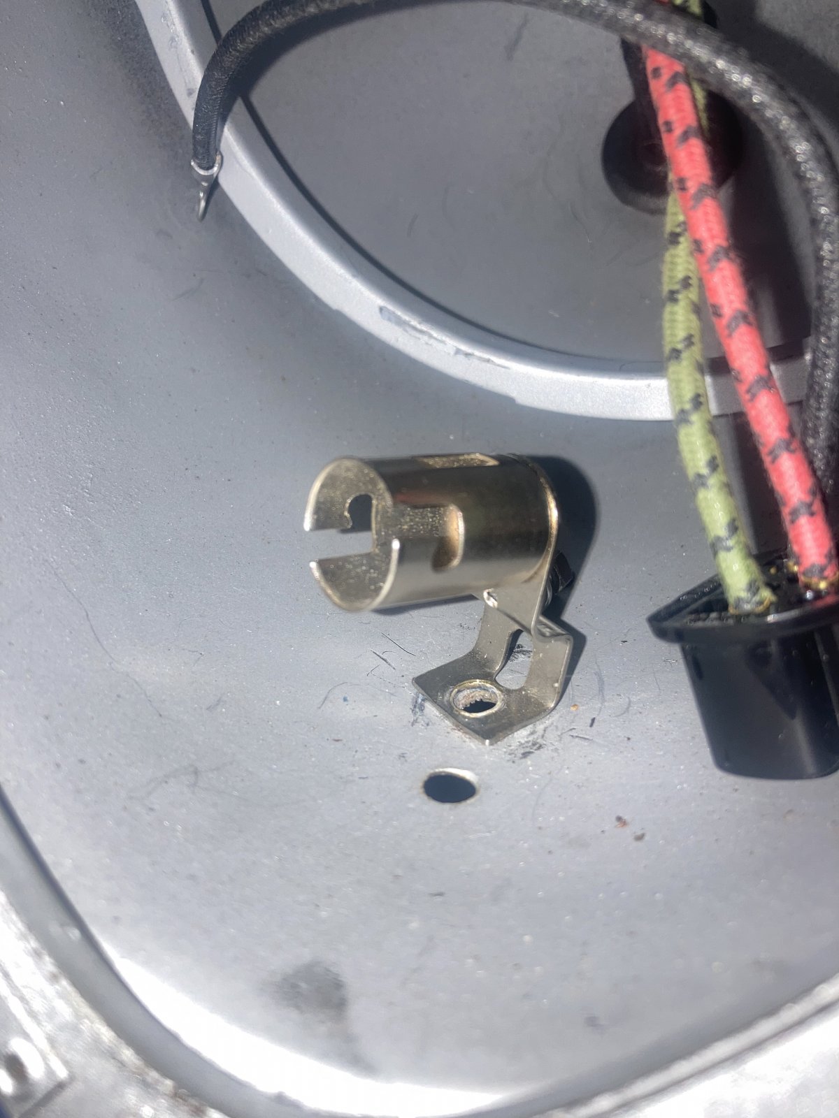

    Hello. Adding turn signals (#1157) to a parking light (#1156) only car. Have you guys been able to source a #1157 fixture with a mounting tab on the bottom ?
