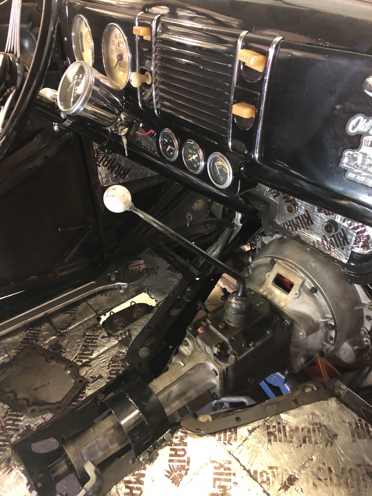

  11. I researched all aspects of an OD for my 39. I even tried to figure out how to put a Lincoln OD trans in it. Every avenue required rework of the floor and shortening the torque tube. In all honesty your easiest ( and cheapest ) path will be a world class T5 adapted to torque tube. There are several sources for that. I believe @thunderbirdesq has done some for guys and he is in PA so not terribly far. The X member is the real problem with any overdrive upgrade in a 35 to 40. I ended up swapping everything out from the trans back and using a 3.03 ford 3 speed with a Jeep shifter and 9 inch rear. I will be swapping to a mustang t5 in the spring. Here is a shot of mine after the trans swap. It’s a ridiculous improvement.

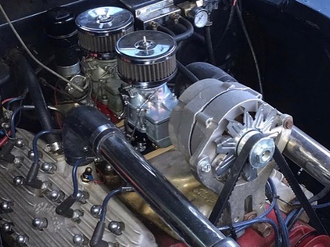

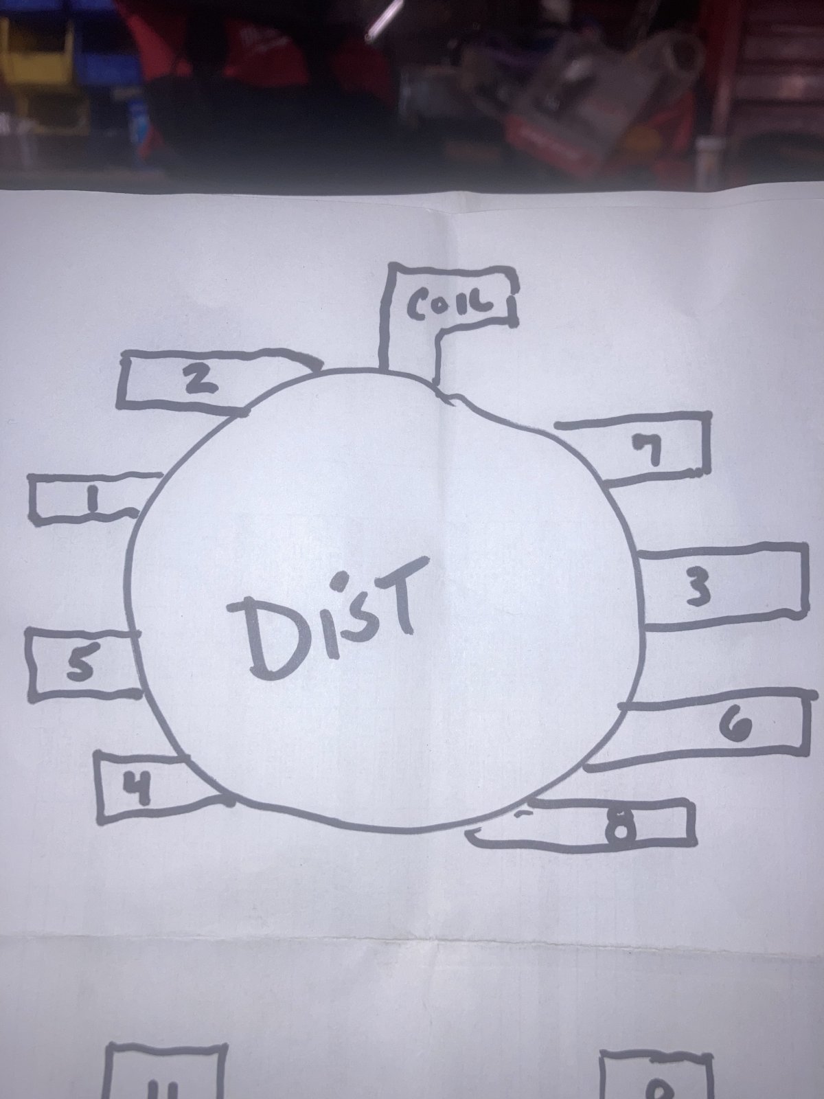

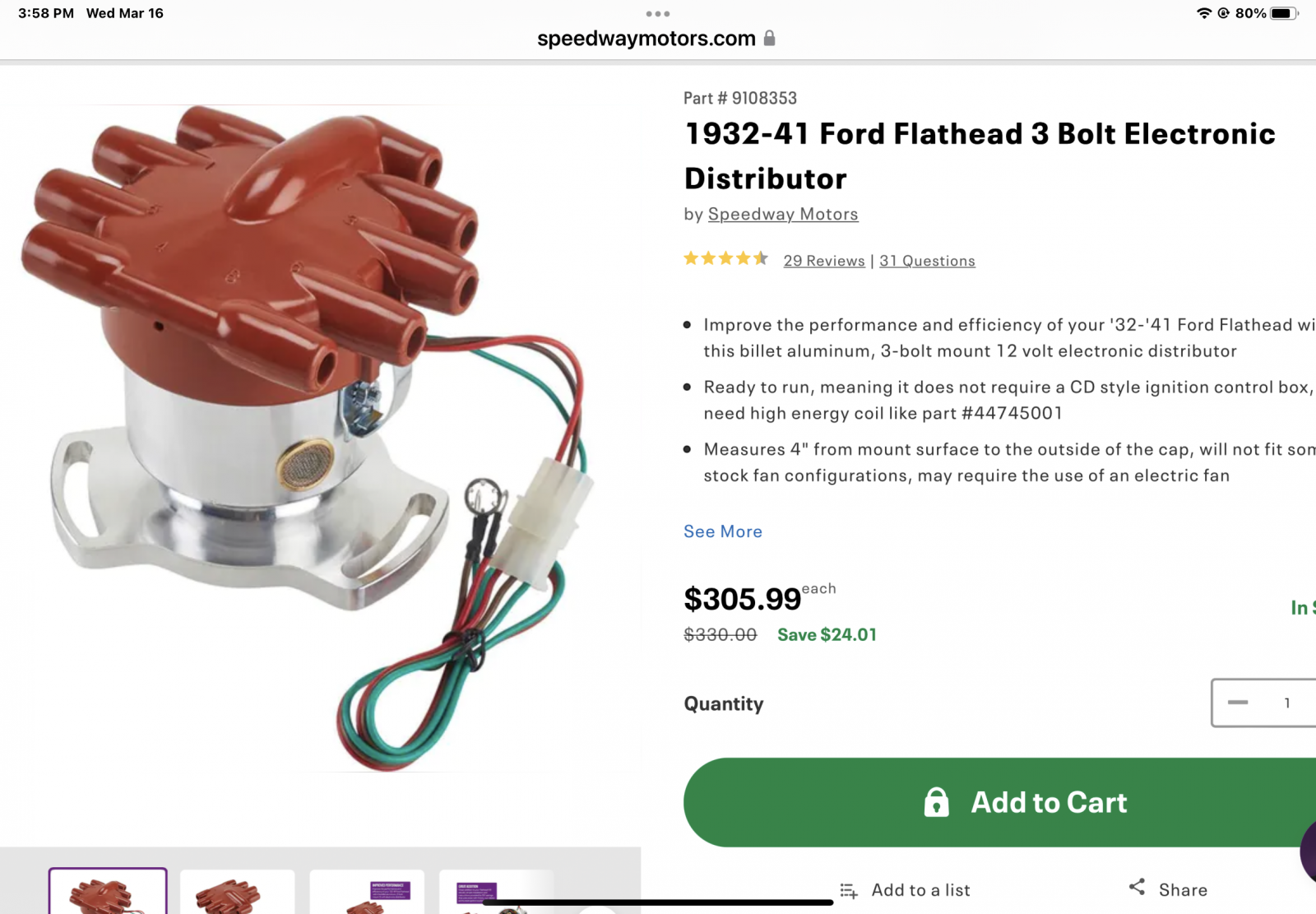

    Hello. I could use a little help with Plug Wires. Motor is a 39. Converting to 12V Alt & Electronic Distributor. Does this Plug Wire lay out look correct ?
    Stretch 31366CE0-FF7A-41A1-ABAA-F3B2142DB61D.png 569688AD-72C2-4277-9659-E713E12703EB.jpeg 37694BE8-DC4B-4FDD-8F94-92AFD0BC1171.jpeg
    Dave G in Gansevoort likes this.

    Firing order is firing order, looks are secondary IMO. I too have a mallory crab (dual point) on a 59A. Looks right, firing order is right.

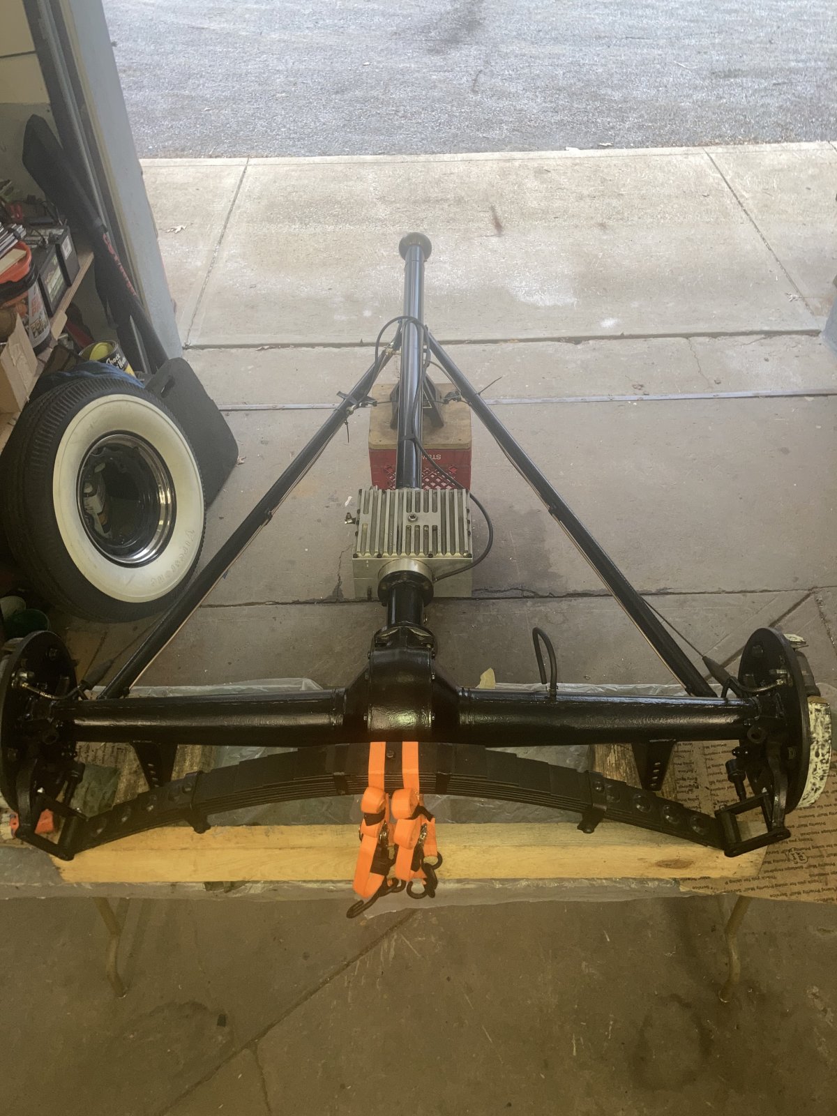

    Joel. I slid the Torque Tube out, temporarily put Mitchell in . Jacked spring up in location and OD clears floor pan. It will not effect the Trans shift into 1st gear. Still have to almost come to a stop.

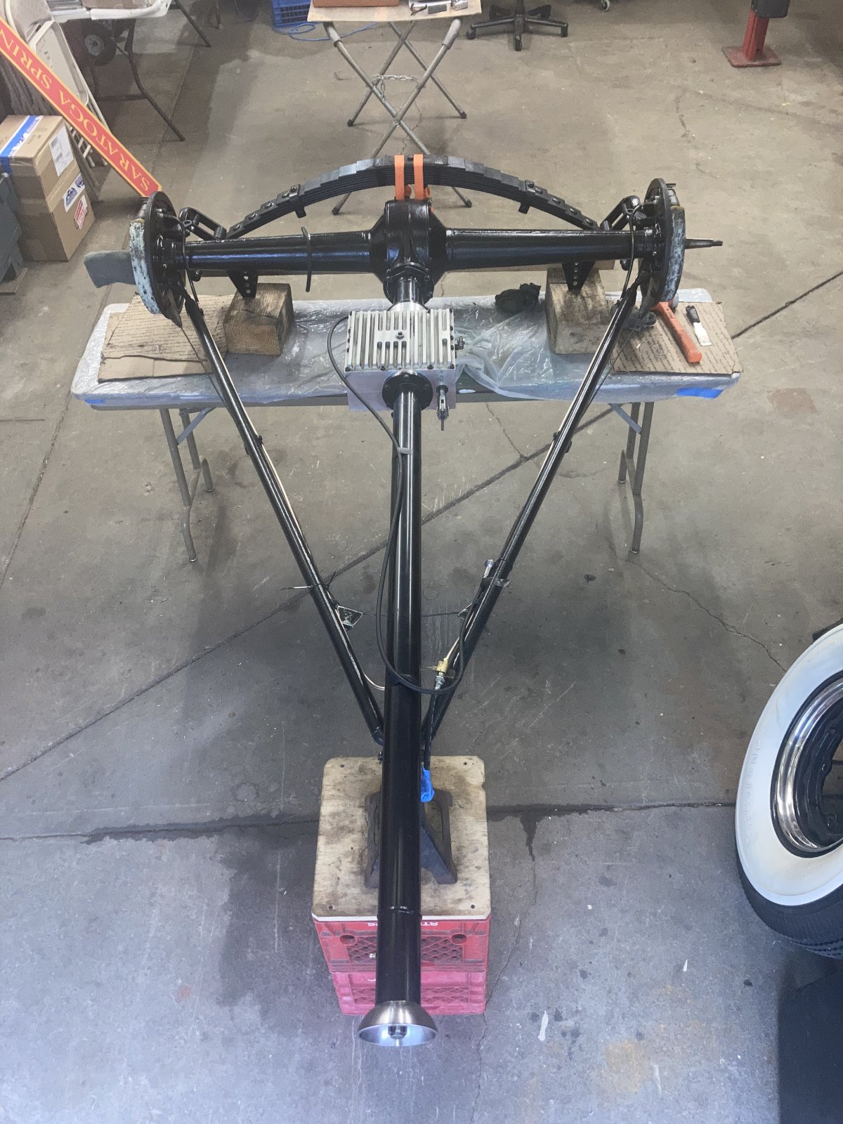

    3D8C8FB5-ABEF-4C2C-8E8F-B3C2A55D3495.jpeg 7CE2970D-5CF8-4AA1-B974-340F8497C46C.jpeg Well, transplant is ready . New Brakes, Brake Lines , Shackle Bushings & a Mitchell OD unit.
    Hopefully tomorrow evening. 2-3 neighbors and a couple young kids from the job stop over. Has to go out side one door, back in next door , up under 39’ on four post set at hip height .
    Stand By . Stretch

    I know this is late but someone may be able to use it. I found it on VanPelt's site. There is an awful lot of useful information on his web sight pertaining to our old Fords. That Mitchel OD looks like a great piece and should install very easy. Hope that easy comment doesn't jinks you!

    39Guy, yes . The #3&5 plug wires go to opposite side.
    Thanks for double checking me, I usually need it .

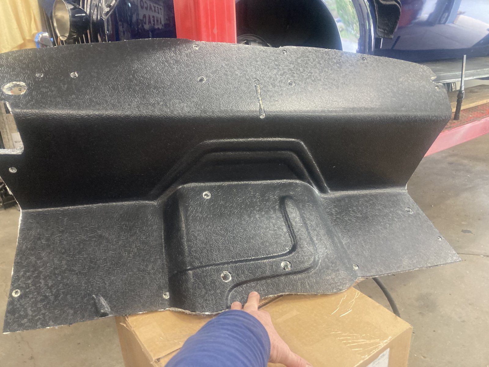

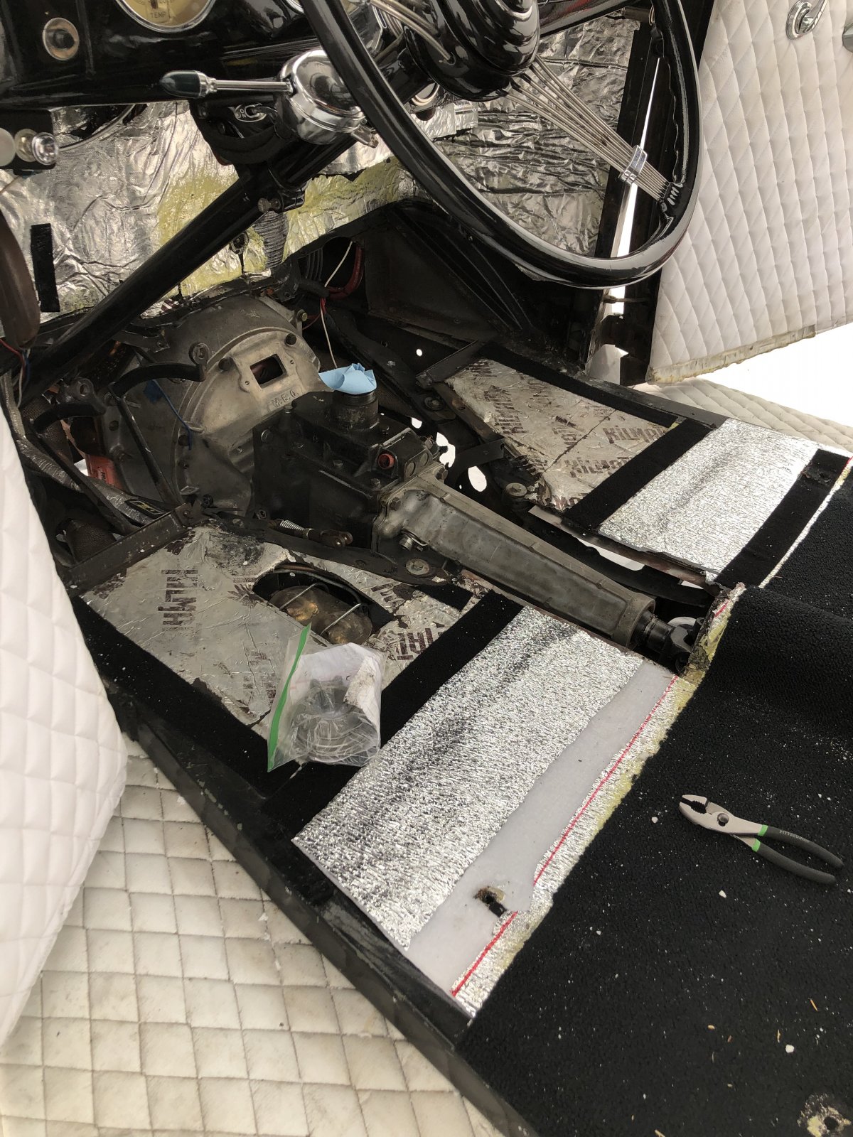

    Good Day around here . Quiet Ride Firewall Pad arrived . The Dash & Ford hot water heater are currently out during new wiring harness project. Snowballed into the new Pad.
    Stretch

    Install firewall pad, dash , garnish mouldings , floorboards, OD cable, finish dash harness, new front brake lines, bleed brakes from scratch & 12 volt fire up for the first time .
    Other than that, not much.
