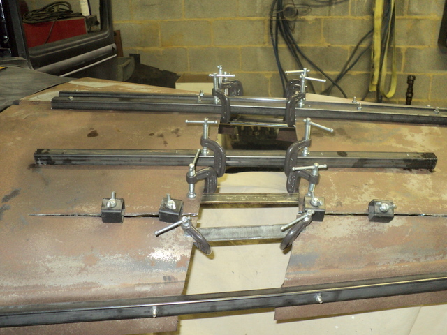

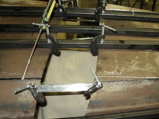

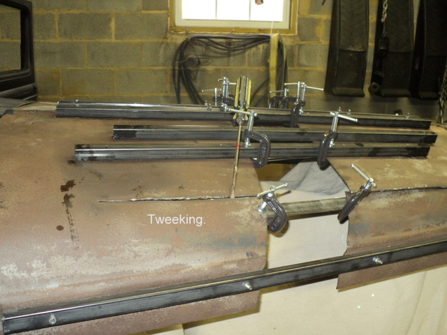

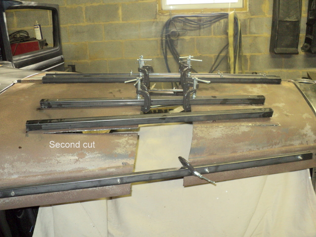

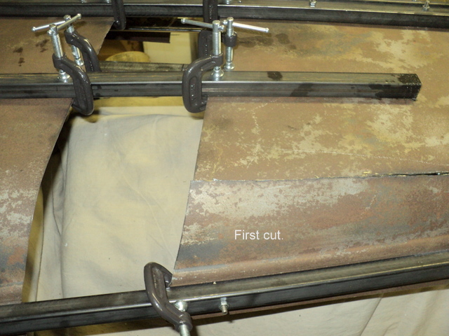

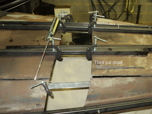

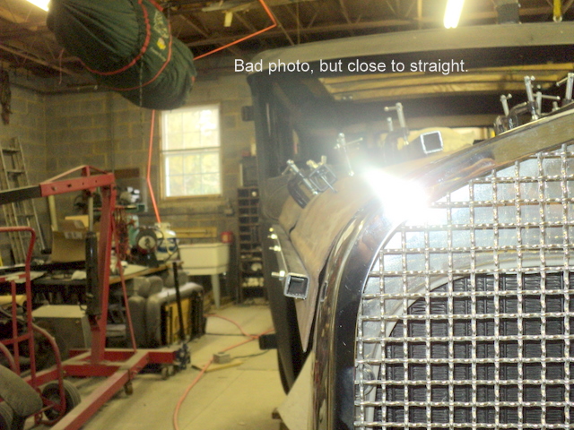

    Let me start by saying that I never before got involved in such a long, and sometimes contentious, thread. I started by asking for some guidance and did in fact get some. None of my previous posts were designed for boasting, it's not my style. I am simply a hobbyist that enjoys testing his limits.
    In line with the above, I jumped in with both feet today, and made some cuts. I am getting closer to believing I can accomplish this. Things are starting to line up OK, not perfect, but OK. Check the photos.

    oh, and looking at pic #6; I think I see that the rear cut is not all the way to the back? If you try welding that without cutting it into two pieces, the area at the end of the cut will be raised up like a crown.
    You can visualize that by taking a piece of computer paper, and making the same very narrow pie cut and stop before you get to the other side. Then try to spread the seam. It will cause the paper to not lay flat anymore. Hope this helps.

    Very, very good advice from F&J and LK32Hudson. I've been thinking about the resistance while clamping this together, not too much, but some. I'm concerned about heat warping, I'll have to go very slow. A question though, would wet towels over the surrounding area help or hurt?

    weld an inch then quench it with a cold wet rag.Then ,move the opposite end of the panel

    I'm not on board with the water quench of the weld...that will shrink it even more :confused:
    as you weld, you need to stretch the area at the weld, because the welding has shrunken that immediate area.
    Hence the term "hammer welding" which goes back to gas welding.... where you weld a bit, then hammer/dolly it out, then weld a bit and repeat.
