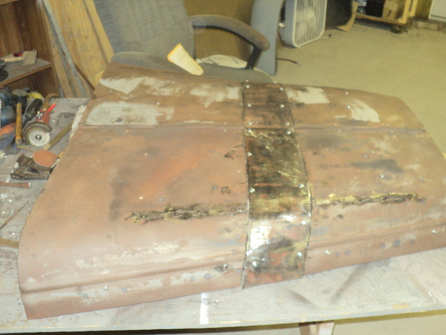

    Yes, I'm still working on it. I don't get too much time to put into this hood, a hour here & there. All braces are welded to the underside & the pie cuts have been welded closed. I will be making the panels to fill the void tomorrow, maybe even tack them in place. These postings are not a vanity thing for me, I'm just staying with this thread because it's interesting. If someone is actually interested in what I am doing, and would like to see some photos, just ask.

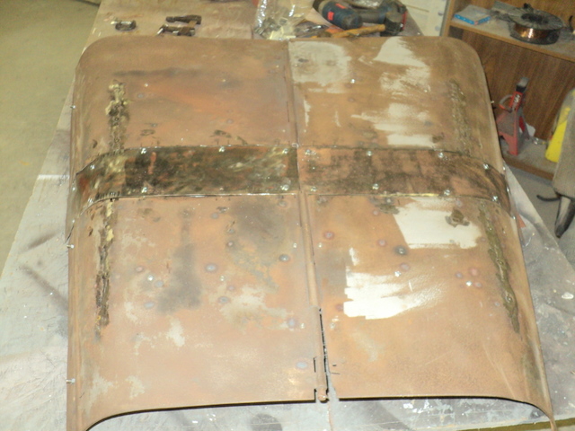

  18. Bob 1743
    Joined: Jan 1, 2006
    Posts: 447
    Bob 1743
    I got the patch panels cut to size & screwed into place. Screwed into the square tube that has been relocated to the underside. The panels are actually flush with the two original hood sections. Next will be a lot of slow & careful **** welding, I would hate to have this thing warp from heat after all this work. After the **** welds I will pull the screws out & weld the holes closed, this should also weld the panel to the square tube underneath. I must say, it's been an interesting challenge. By the way, to those who think I am bragging about my great metal working skills, I have to admit I have none. This is my first attempt at sheet metal. Never did a patch panel before.
    Bob
  19. the metalsurgeon
    Joined: Apr 19, 2009
    Posts: 1,237
    the metalsurgeon
    from Denver
    Show some pics with the rule along the length of the hood sides .
    My metal work blog www.themetalsurgeon.com
  20. fleet-master
    Joined: Sep 29, 2010
    Posts: 1,780
    fleet-master
    think you should make sure your hood profiles at each end still match the radiator surround and the cowl. Looks like the front has spread out and the hood doesn't taper enough.
    Also, are you goin to put roll hinge sections in the middle or?
  21. the metalsurgeon
    Posts: 1,237
    the metalsurgeon
    from Denver
    Are you happy with the results?
  22. Bob 1743
    Joined: Jan 1, 2006
    Posts: 447
    Bob 1743
    Still not sure if this is going to work Ok. The devil is in the details. I still have a little bit of weld grinding to do & then see how it fits on the car.
  23. the metalsurgeon
    Posts: 1,237
    the metalsurgeon
    from Denver
    Details? I can see from the last pictures it didn't work.
