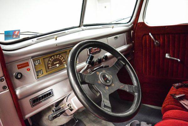

    Yeah, I was gonna say 1992 called and wants its steering wheel and plastic floor caddy cup holder back too.

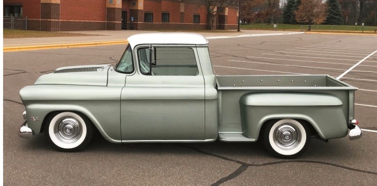

    Not the best picture but three inches in the cab 2 in the doors. Really nice proportion. Too bad I don't have a better

    Looks good. I wonder if the stretch would work better on a cameo bed. Stepside beds look really utilitarian behind a customized cab.
    Maybe take one inch out of the door and add it back behind the door. I don't have Pshop or I'd try it.

    Really like the black A.

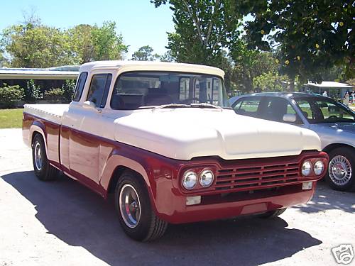

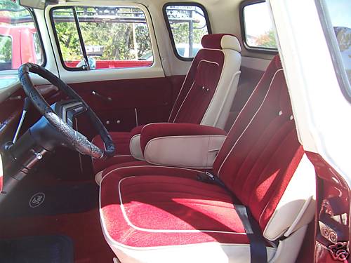

    I liked this effort down in FL and had hoped to buy it several years back, but missed out.
    Not the best pic's but all I have now...
    1morecarIpromise! likes this.

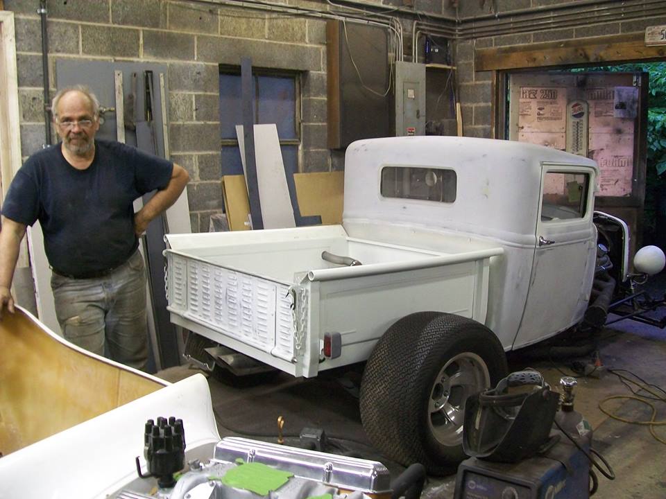

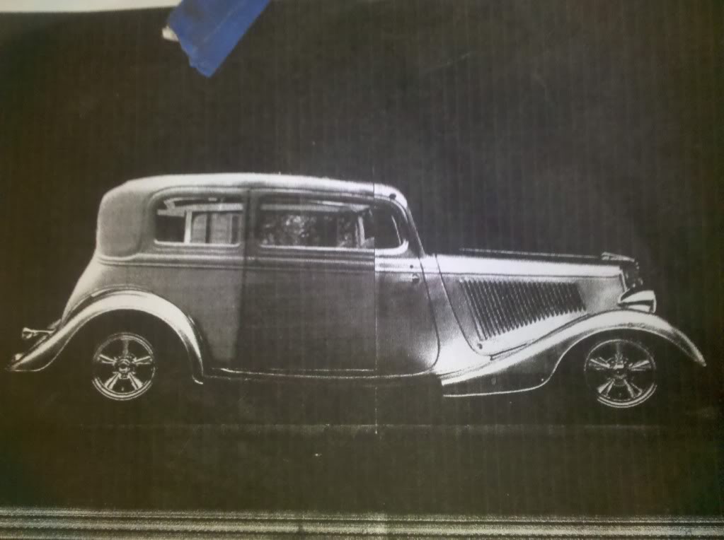

    Cole Porter chopped the truck that I snagged the photo of years ago and drove it for years. Jesse James ended up with it and did a few mods and then sold it on Ebay.
    Thanks, I have all the pieces to do it and if you look close (not actually that close) you can see the seams where I cut the 4 copies of the print of the truck apart and did did the stretch and section. I've never found out how much Cole Porter actually chopped the truck but it comes out just right for what I need and with that chop I don't have to spend a couple hundred hours reworking the tops of the doors.
    I posted the photo to show the OP that Hey, take some side shots of your truck, print one or two out with several prints and cut them apart and fit them together to see how it might look. Needless to say I am not good at photo shop but can do cut and tape.

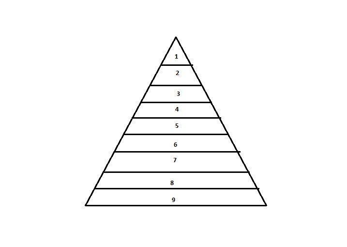

  16. There's a whole bunch of taper in the cowl,
    aBIG bunch and curves and sections of cones in the cowl.
    So print this out 3 copies
    Imagine it's the Cowl of the truck
    Say 9 is the door jambs
    7 is the firewall
    4 is the grill
    123 is imaginary out in front
    If you were to cut amd move 7 further away from nine
    Everything between needschamges
    Hnstray and Blues4U like this.
