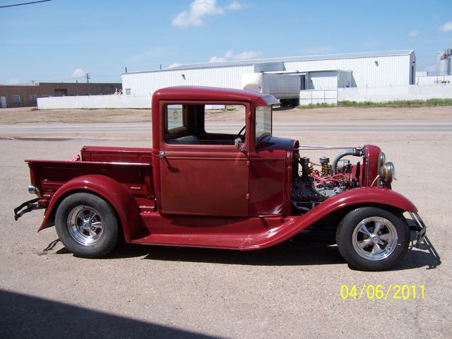

    I built my model A about 15 years ago. Stretched 4 inches in the middle of the doors, wheelbase stretched 4 inches, running boards stretched 4 inches. All else is stock. No chop, although I think the stretch makes the top look as though it might have a slight chop.
    I drew it up on graph paper, stretched behind cab without window and it was **** ugly. Same with window, as far as I my tastes go. This was the only stretch that appealed to me. That's how I did mine. Not my truck any longer. 100_2557.jpg 100_2563.jpg 100_2565.jpg

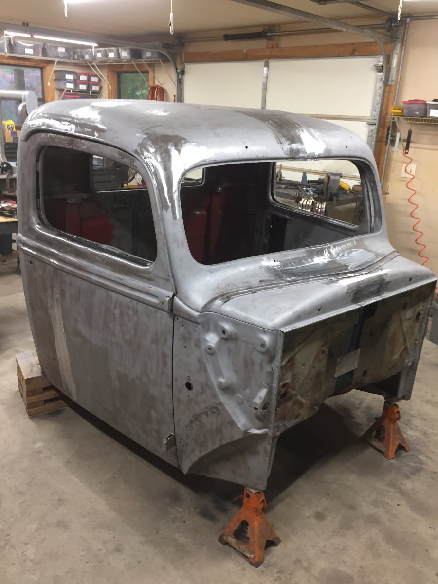

    Here is a 40-47 Ford cab under construction. Doors have been stretched 6 1/2" and the cab widened 5" (6 1/2" in back to maintain the slight wedge shape). I think proportions would be better with 1-2" added behind the doors ... but I'm not that ambitious!

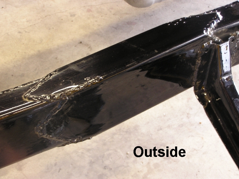

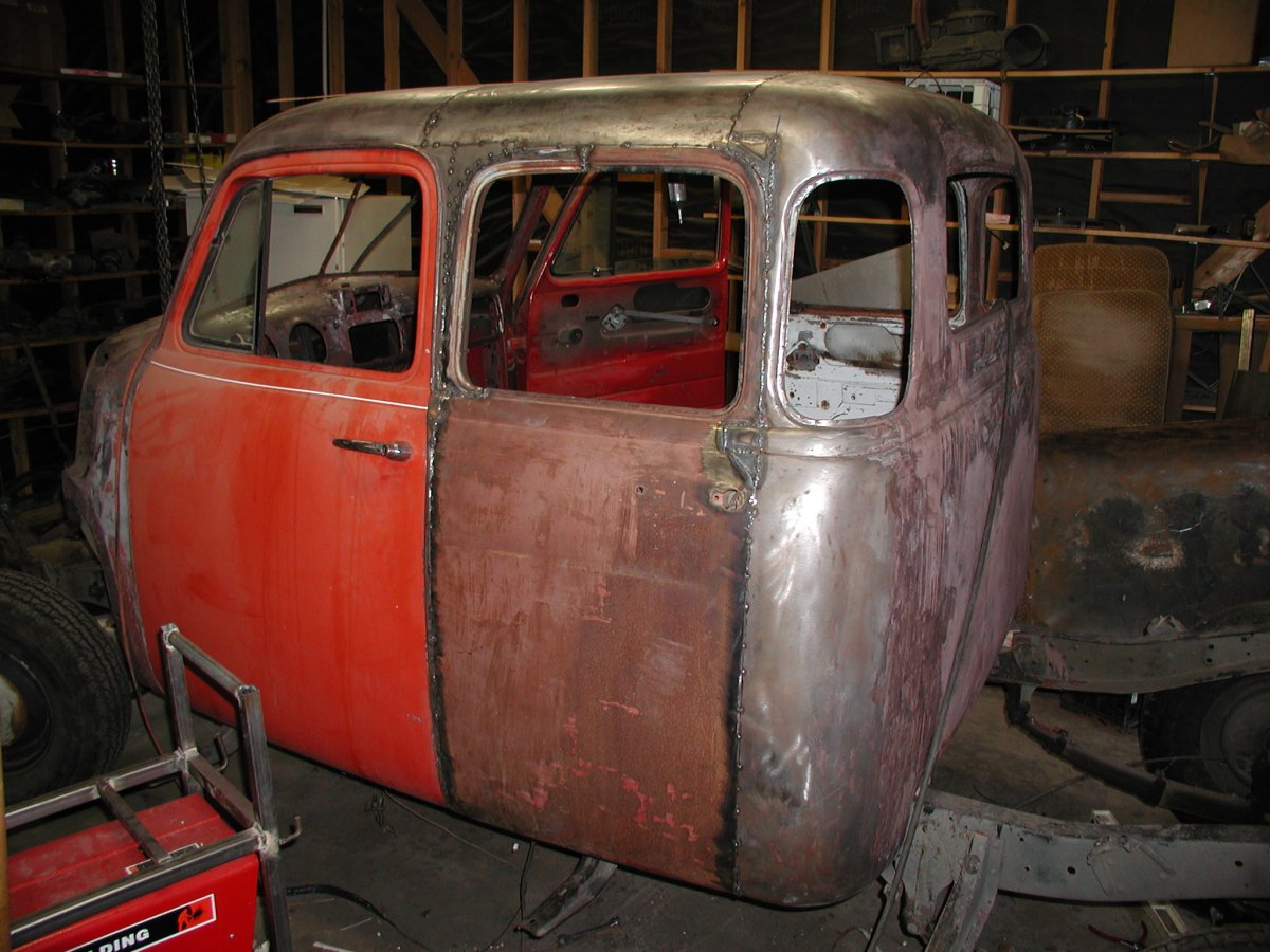

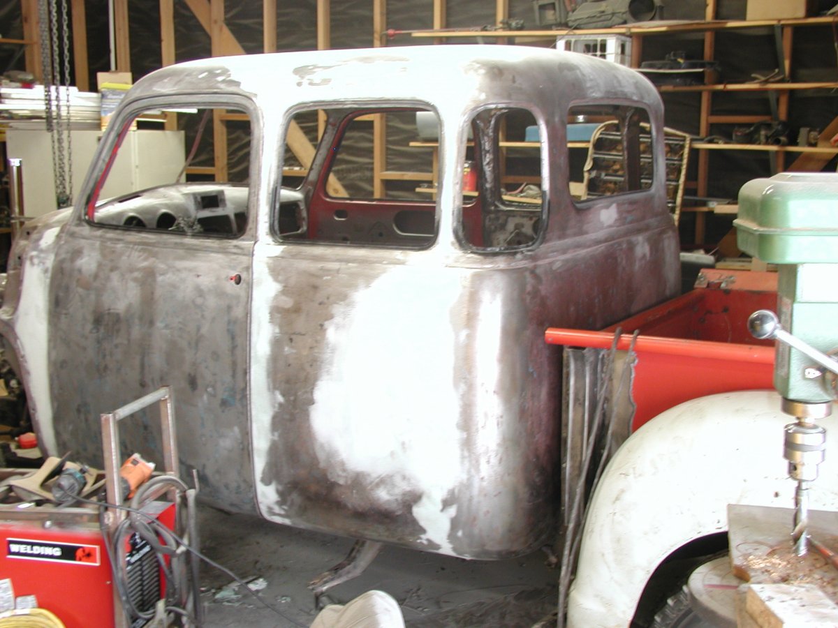

    I added 2' to the cab on my '53. I shortened the bed 1' and lengthened the frame 1'. Also lengthened the running boards using a second set.
    P1010559.JPG P8070017.JPG P8070019.JPG PA130002.JPG 3-1 frame ext.jpg 3-2 frame ext.jpg

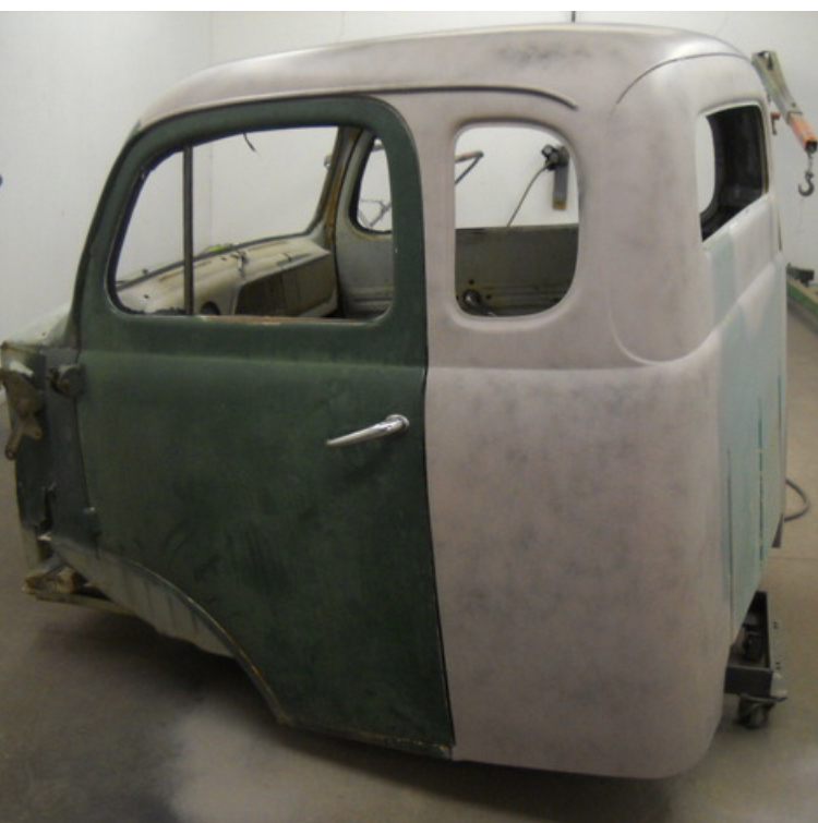

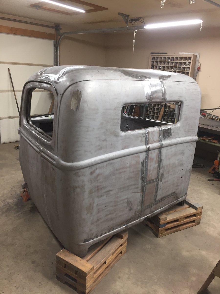

    i like this extended COE cab
    The window detail and cab “drip rail” sells it

    Brand Apart
    from Roswell GA
    I've seen several with a couple inches behind the driver that where we'll done But that cab in post 101 looks so cool, like a bigger version maybe like a 1ton instead of half ton. Reminds me of something Ian Rousell did but I can't remember what.

    from NW Montana
    Thanks. That's mine....
    gimpyshotrods and anthony myrick like this.
  24. Ya did good.
    Found it looking for 48-52 COE pics.
    I should be trading for a bunch of parts for one.
    Well, front end and doors, no cab. Was thinking about converting a regular cab. Don’t see why I couldn’t mount the doors and build that dog leg/cowl area to fit the pieces.
    gimpyshotrods likes this.
  25. RMR&C
    Joined: Dec 26, 2009
    Posts: 5,053
    RMR&C
    from NW Montana
    I'm sure you could. Having the doors to work off of is a huge plus. The COE cabs are basically the same as a regular truck aside from the lower front/floor.
